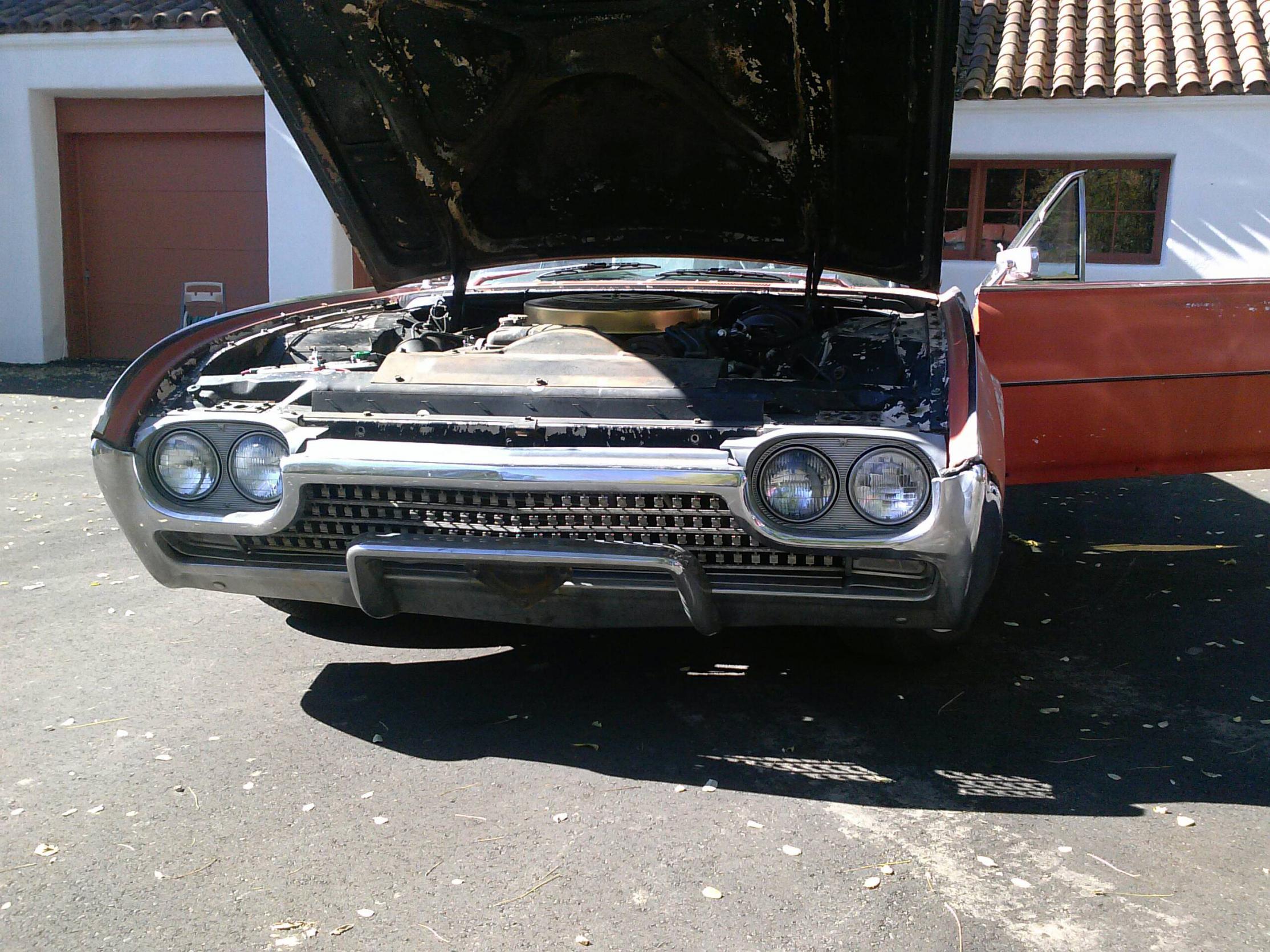

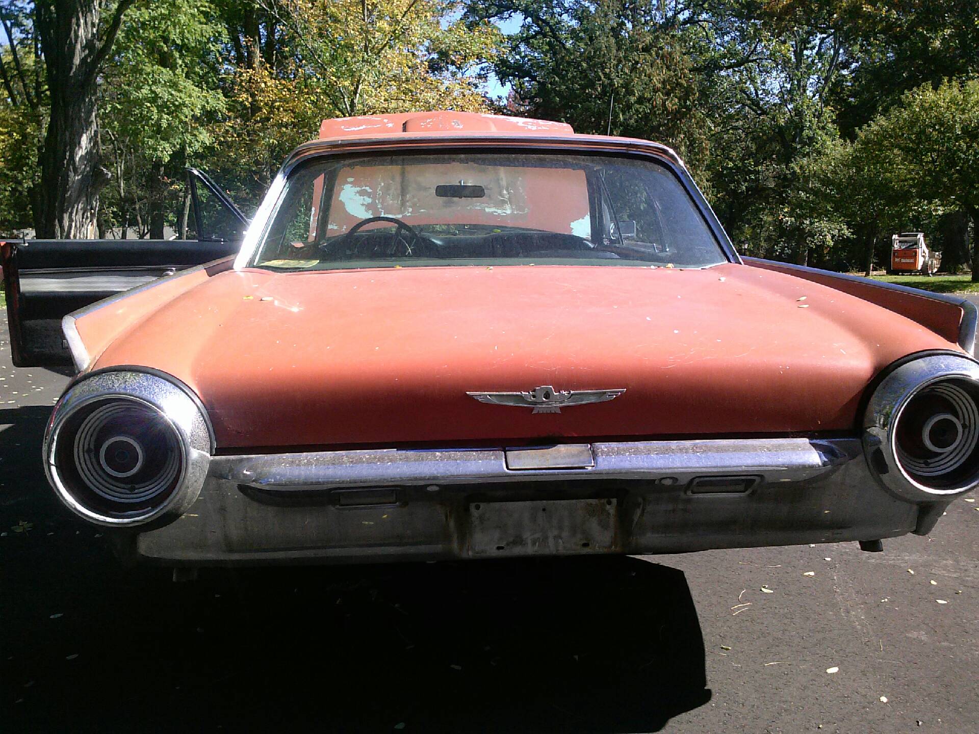

    I recently picked up this 62 tbird project. Currently I am replacing the fuel pump and attempting to get the drivers side exhaust manifold bolts out to replace the gasket.
    Plans are to order a new set of 15" 2.25" whites for it in a couple of weeks, and add a set of lancer hubcaps to it. Lowering it a little is a must and a good detailing of the interior. Hoping to shave it and replace some of the chrome parts.
    I know this car belonged to a fellow hamb member before the guy I bought it from. It already has new window motors, trans pan, heater cable and valve.

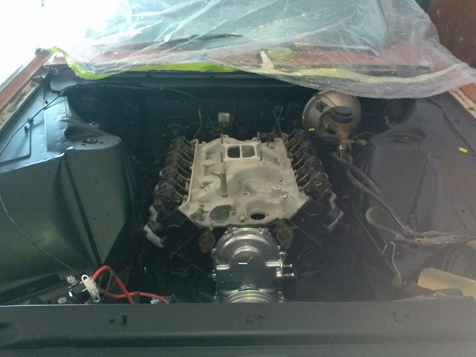

    Got the engine back togeather today. Next step is to get under the hood sanded down and painted to get it prepped to drop the engine back in. 1505393_220365624823144_1233429656_n.jpg

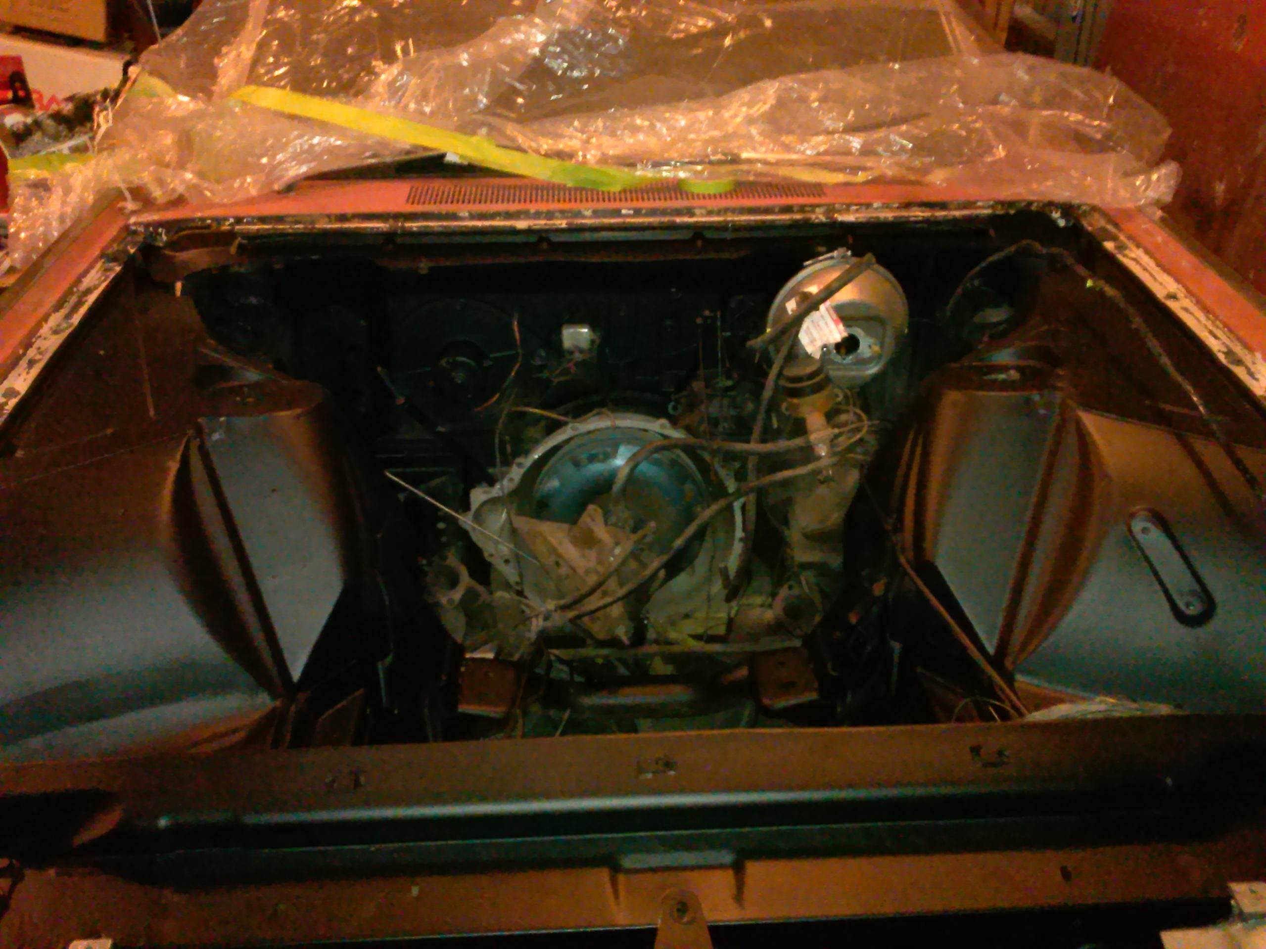

    Made a patch panel for under the battery this week and got it welded in. Finished stripping all under the hood down to bare metal and painted it with eastwood's underhood black. Next steps are to make an alternator bracket and get the engine back in next weekend.

    Got the engine sitting back in the car today. shooting to have it running again by the end of the month.

    The engine is back in the car this weekend. Now to start putting it all togeather and get it running. Cleaning up things to make it more tidy as I go too.

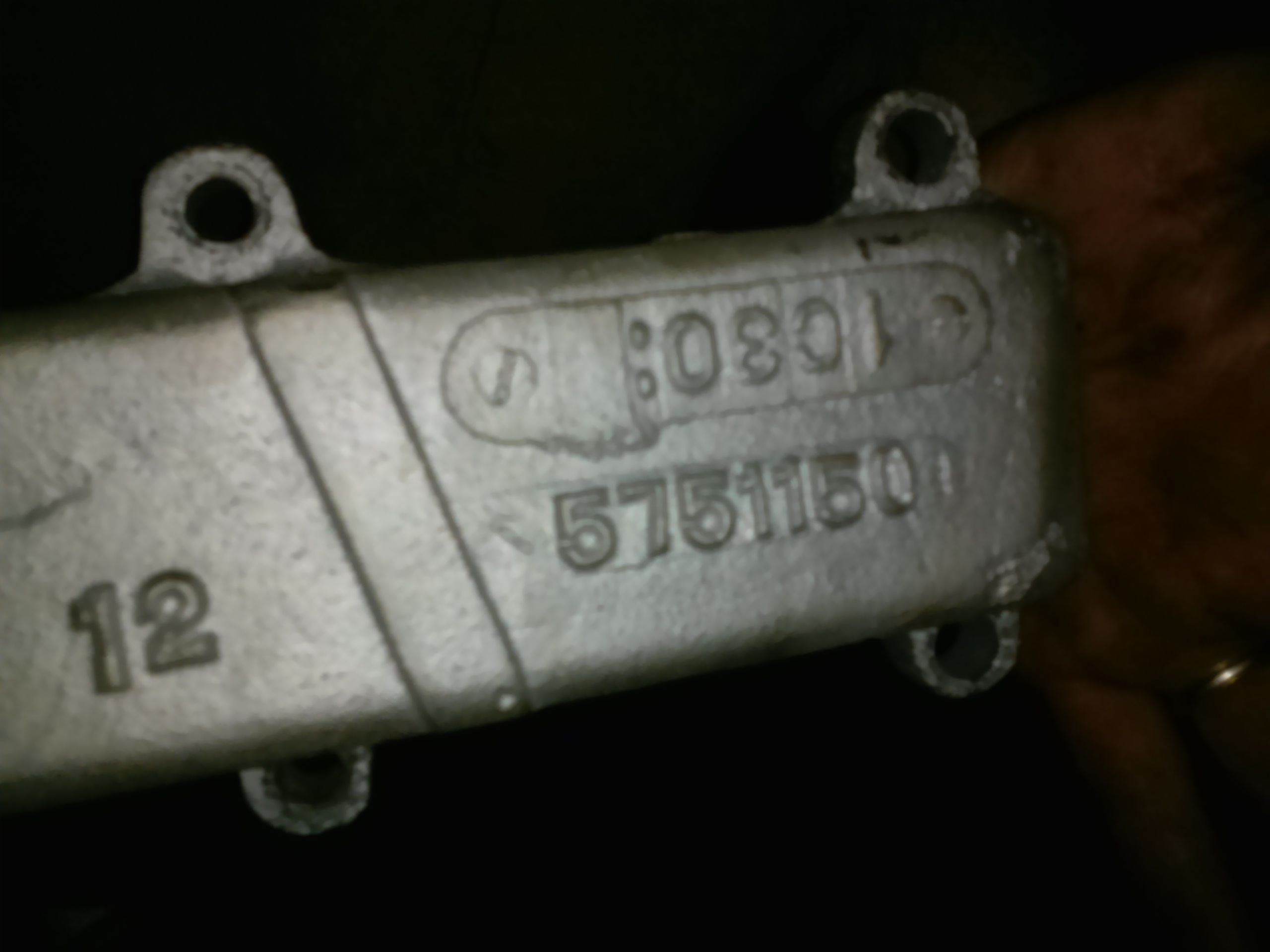

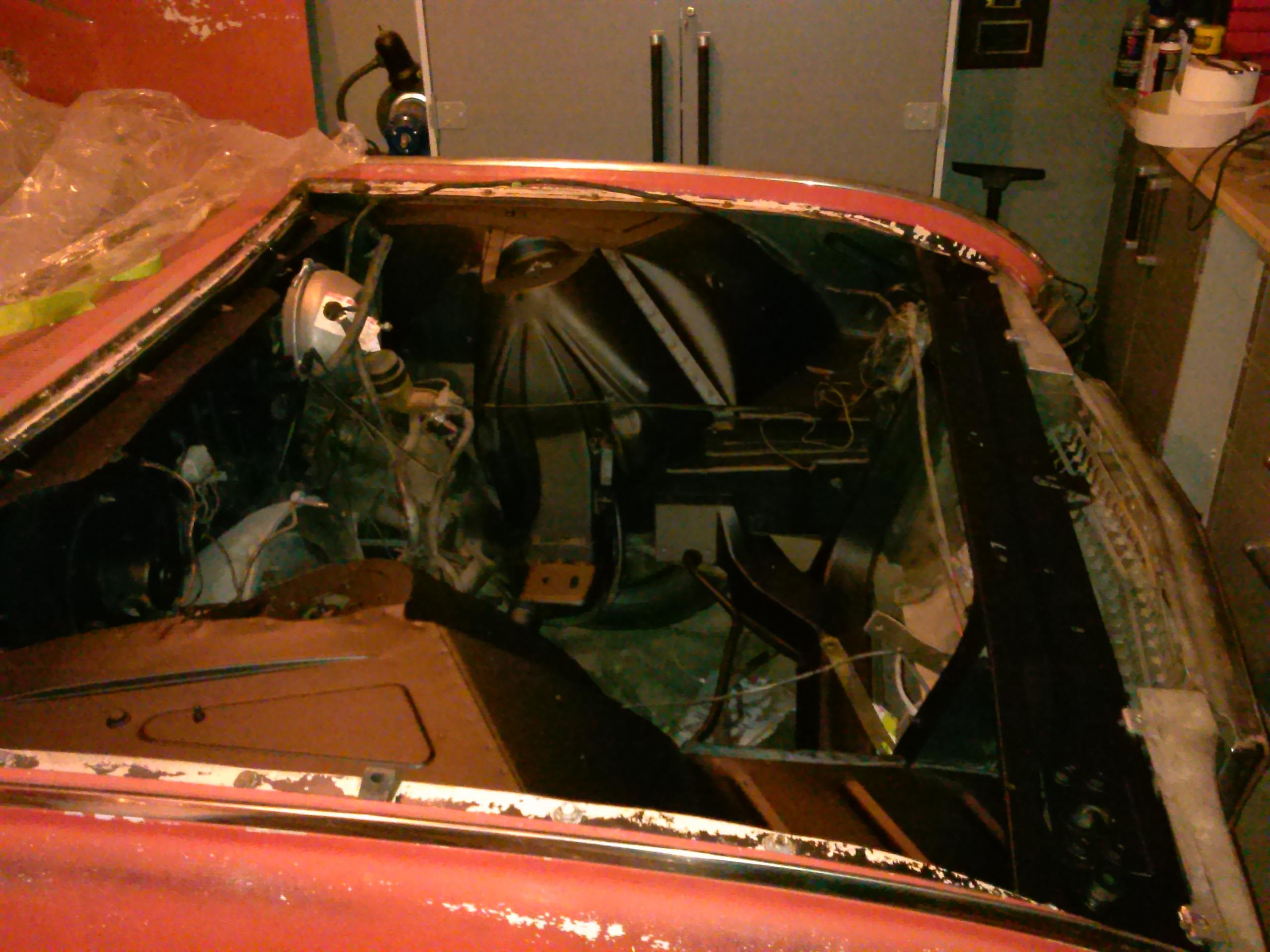

    Havent updated this in a while. I got the engine back in the car and running, converted the front end over to disk brakes over the winter too. Found some great buys at a swapmeet a couple months ago for the car, and the car made the 535 mile round trip with no issues to Symco. If anyone has a passenger side exhaust manifold they would like to get rid of with the numbers like the one attached I am looking for one. Mine is pretty cracked. Customizing pics to come soon. I am getting the bug to start shaving and customizing this thing.

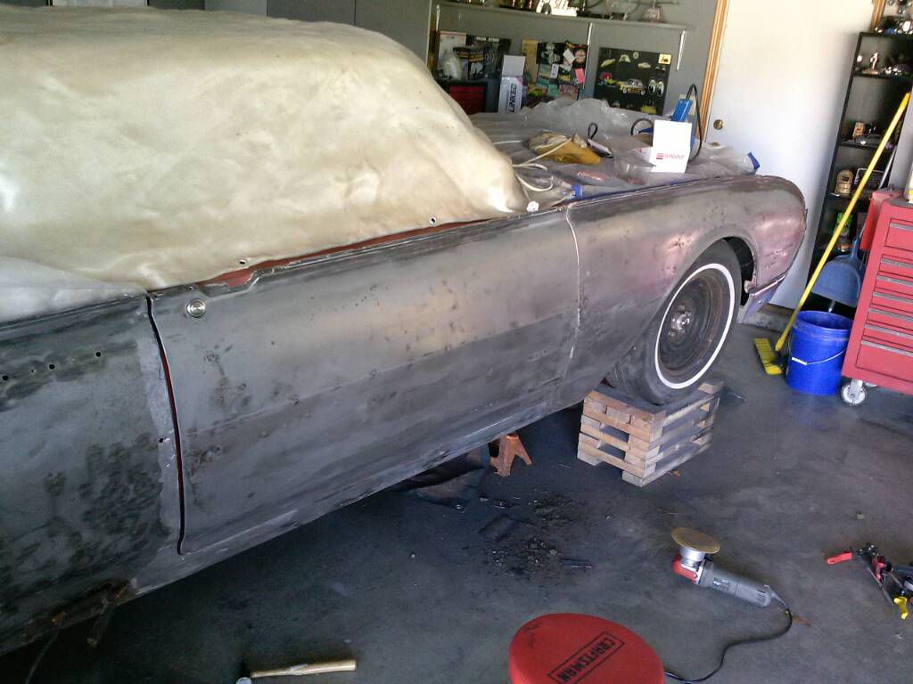

    Decided after iron invasion to start tearing the car down. Got the passenger side stripped down thinking this is the worst side. Started filling trim holes and using up logs of studs for the stud gun to get all of the dents out.

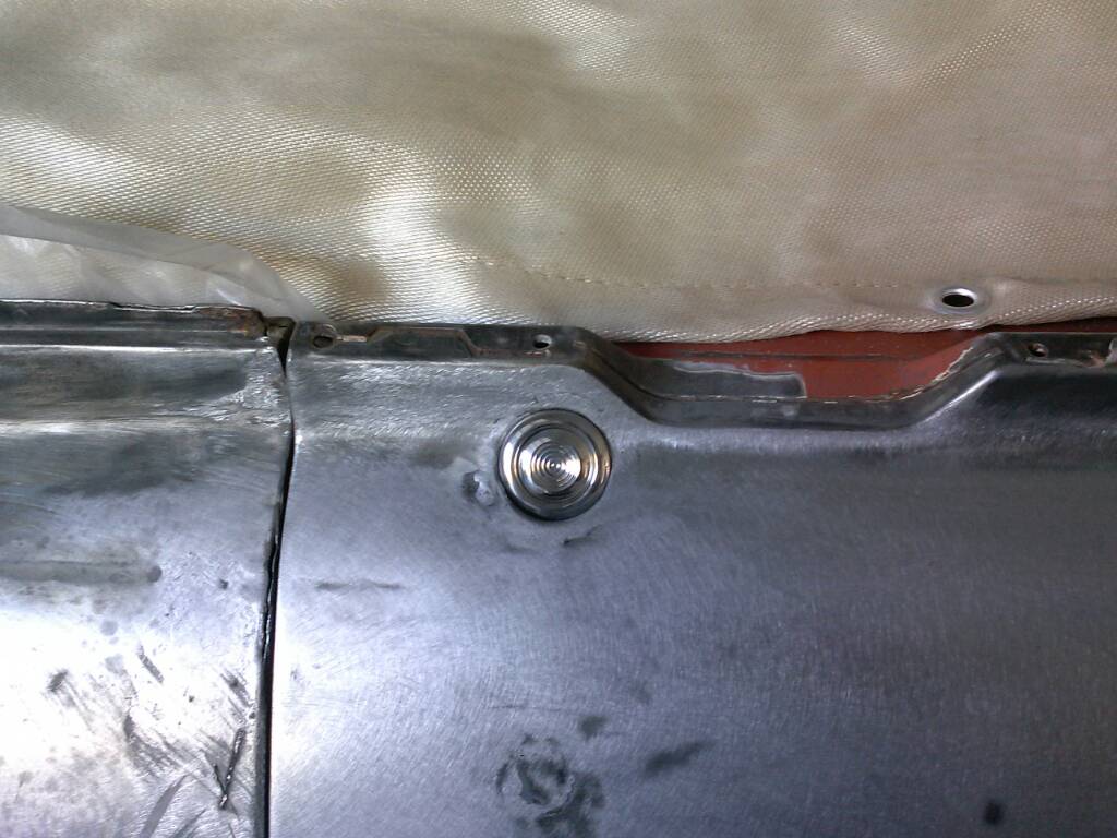

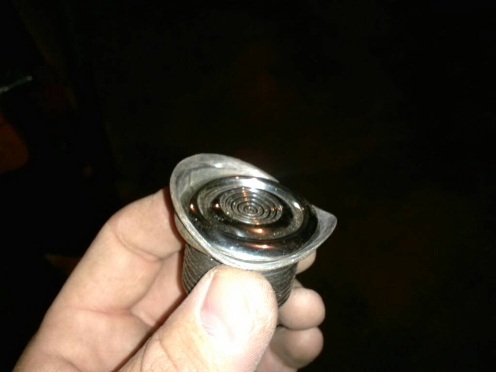

    I got the metal work pretty much done on the fender and the door. Made a frenching up for the Lincoln push button and got it welded in. Hoping to finish up metal work on the quarter this week and start sanding some filler.
