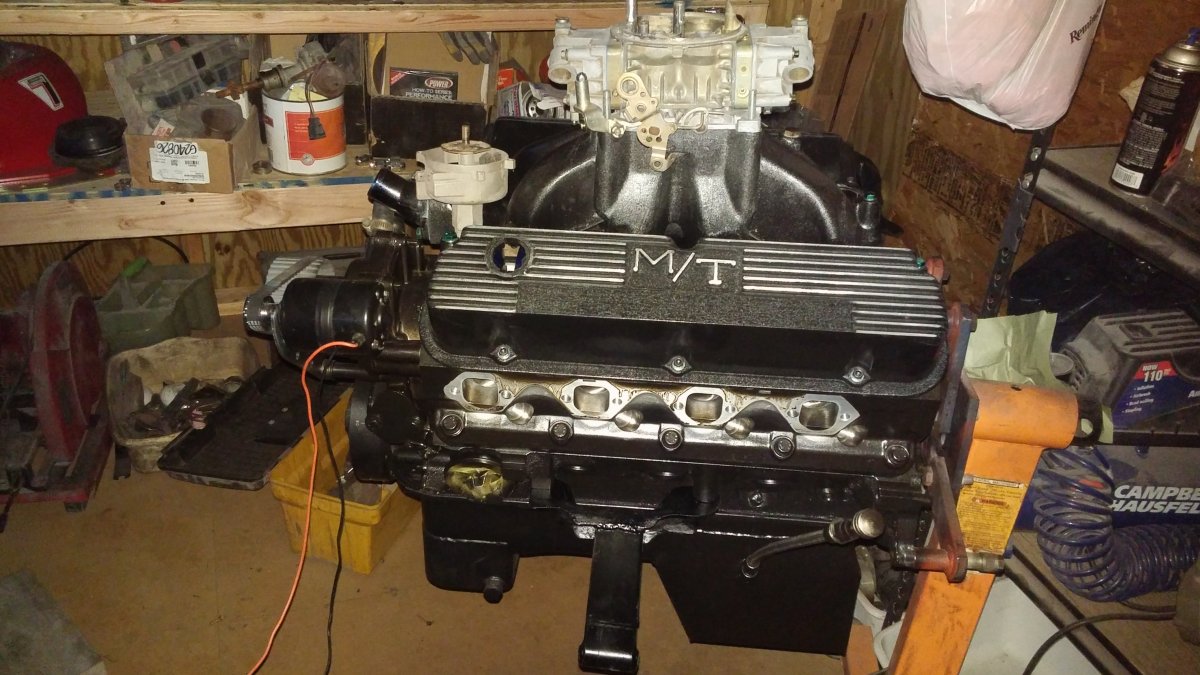

  14. southcross2631
    Joined: Jan 20, 2013
    Posts: 4,413
    southcross2631
    This one 20180409_201413.jpg will. Would need a front sump pan, but it would get your attention.
