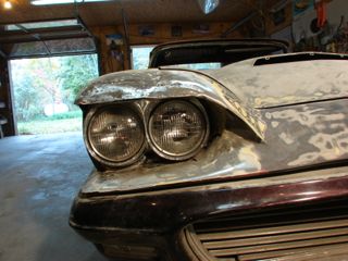

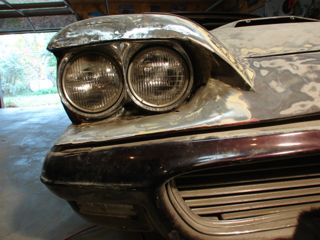

    In order to keep my build apart from the other (GREAT!) Squarebird build here, and keep it up to date on the new format of the HAMB, here's an update on my '59.
    As a brief refresher if you haven't seen my other build thread about the car(somewhere on the "old" HAMB), it's a '59 coupe, turned "roadster" with the original hardtop now removable and the windshield sunk into the cowl 2". I never liked the original headlights, the way they "droop" to the outside, and the flat bezels, so I recently got a pair of '63 Caddy headlights, complete, and today got the right side roughed in.

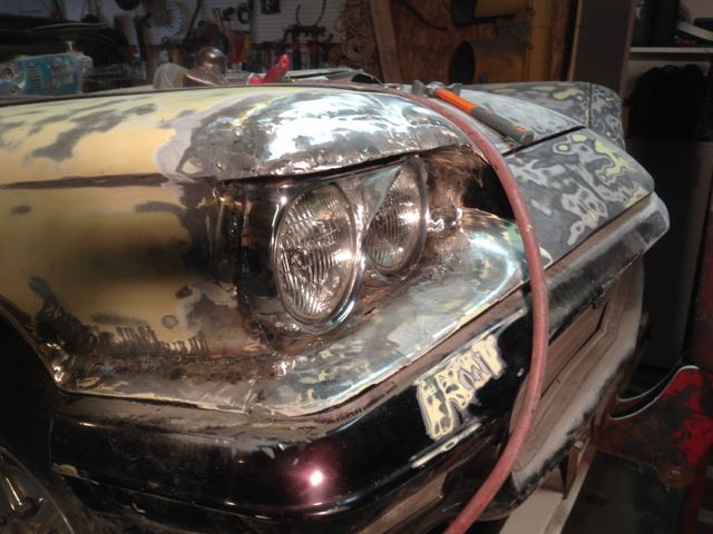

    I leveled the bulbs with the ground, which meant raising the outer edge about 3/4" and dropping the inner about half an inch. I extended the front fender eyebrow, and gave it the same "widows peak" as the Caddy bezel. I think the effect is significant, but subtle.
    Here are some photos of todays work.

  2. lukey
    Joined: May 27, 2009
    Posts: 668
    lukey
    That's a subtle but impressive change! Most people probably won't even notice. I like it
  3. flynbrian48
    Joined: Mar 10, 2008
    Posts: 8,246
    flynbrian48
    Thanks, that was the idea. Different, but not "in your face" different.

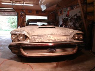

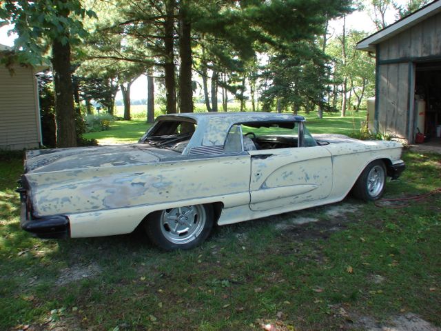

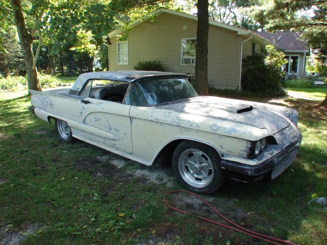

    Thanks. Here's the car outside last summer, which gives a good view of the top chop and shortened "C" pillar. I may have to re-think the tonneau cover a little, as it's now outside the rear edge of the top by about 6". With the top off, of course it doesn't matter...

    You need to be careful when you cut the top off a unibody car, I have read several articles about this and there is a loss of structure which lets the body flex too much. Convertibles had more bracing. I like the tonneau cover looks great.

    Model A Gomez, I appreciate your comment, and usually that is very true. However, turns out these first square-birds had one body shell, the convertible. To make a coupe, the top assembly is an addition, spot welded to the w/s frame and rear wheel houses (via a rather long bracket). The car is as rigid as it was before the lid was pruned off, and much more rigid than most converts. I know, it's been "road-tested" for about 10,000 miles, which what I put on it before putting it in mothballs 8 years ago.
    I think the tonneau is the best part of the car, and it's the very first really BIG sheet metal panel I made, using a conduit frame skinned with 20 ga.

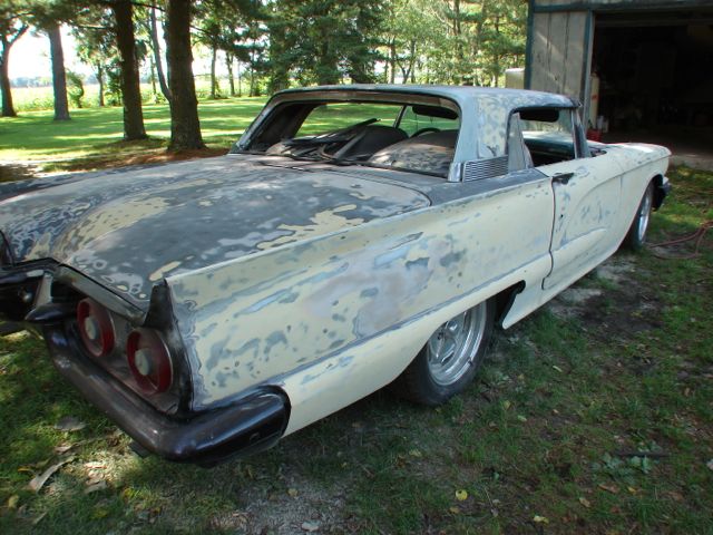

    I proudly showed my wife the headlight treatment last night, and she approved, but she looked at the rear bumper line where it meets the body (HUGE gap and WAY out from the body) and said, "Can't you make that fit the body better?"
    Yes, I can. The bumpers are getting trimmed and tucked, and I've also decided to modify the rear quarters to carry the "jet spear" character line all the way back to the bumper. This is what Hollywood Hot Rods is (sort of) doing to the '59 project they have featured in this months "Street Rodder".

    Never noticed the downward slant of the stock headlights until you mentioned it. I must have been blind as now it is so obvious. Nice redesign that really looks great.

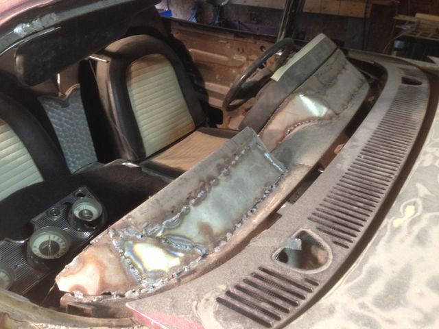

    I thought I'd get the left headlight done this afternoon, but it ended up taking all afternoon to finish up the right side. I "tucked" the fender around the new Caddy headlight, it took quite a while to cut filler pieces to fill the resultant gaps in the fender. The result is subtle, but the fender now matches the curve of the Caddy bezel.
    Taking a step back in time, there's also a photo of the dash roughed in. When the w/s frame was dropped into the cowl, the dash mounting lip went with it. That made the dash 2" lower, which meant the gauge panel didn't fit around the steering column, which stayed in it's original location. So, I cut the instrument and glove box "pods" loose, raised them, and while it's nowwhere near finished, I think it look pretty nice. More defined, matches the humps of the tonneau cover. I'm planning on ditching the foam extensions, rolling the edges of the metal and painting the dash. Body color or interior color, not sure. I may re-do the interior in red and white, as opposed to the current black and white.
    Anyway, here's todays work...

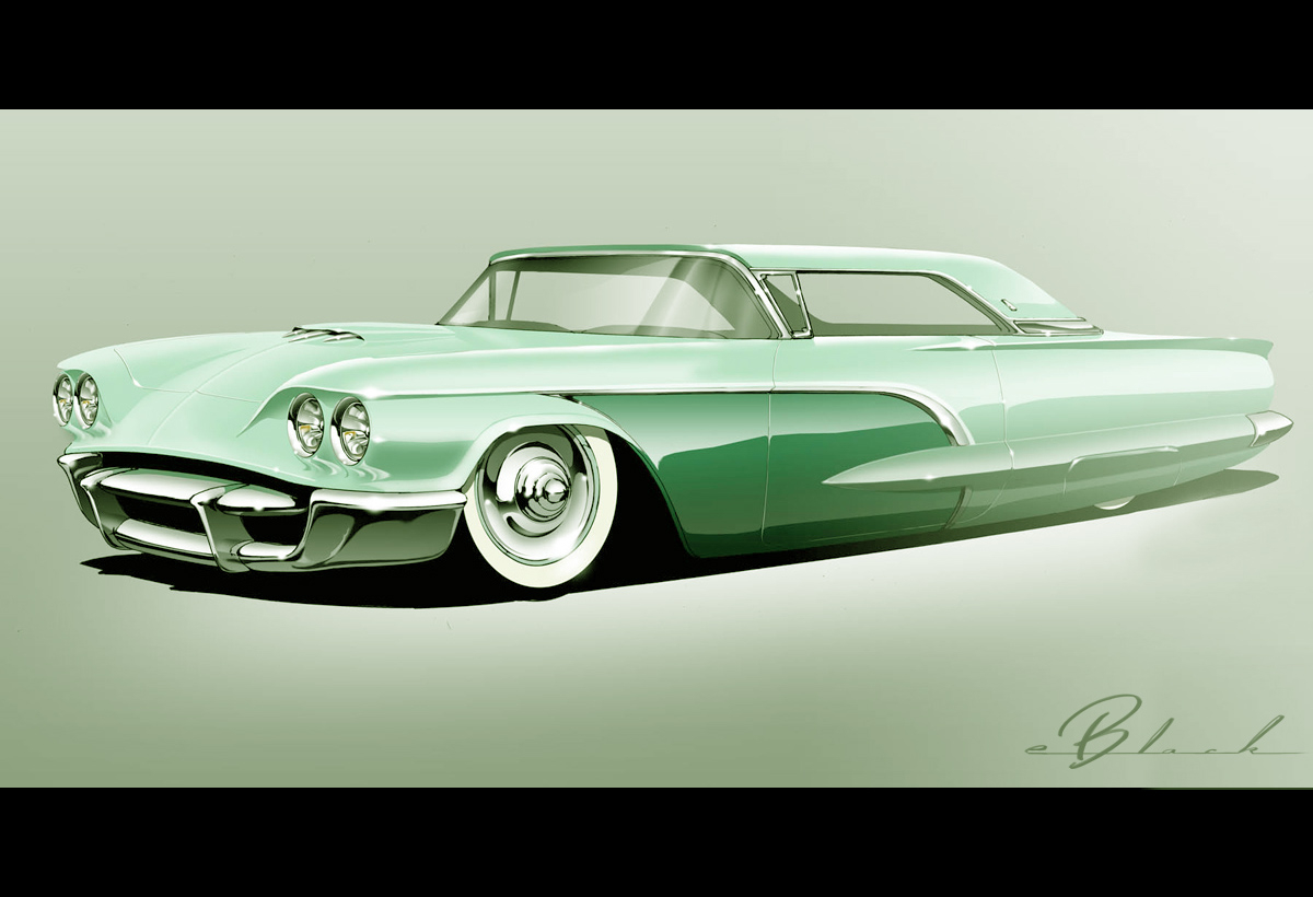

    Thanks! Speaking of inspiration, the car that inspired the Eric Black artwork that led me to re-do the 'Bird, is in my own backyard (well, 2 miles from here) at the Gilmore Car Museum, "American Legends" showing. Curator Dennis Lesky managed to get this car, along with several other ground breaking, iconic customs and hot rods, for the show.
    Check out the Hirohata Merc, and see how that interpretation of Merc lead to the T'Bird I'm cutting into little bits.http://flynbrian48.wordpress.com/2013/10/27/inspiration-answer-the-door-when-it-knocks/

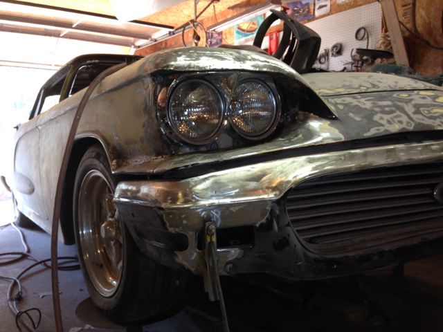

    Sectioning the front bumper ends to tuck the bumper closer to the body. One inch off each side. There's quite a taper on the upper face, which is why the cuts are stepped. Next, mount the bumper to the car and tack the ends back on, so they end up correct!

    I spent the morning out in the shop (it's too nice to stay out there any longer!) and got a bunch done on the 'Bird. After hanging the center section of the front bumper on the car, I welded the ends back on, minus one inch on each side. The sides now tuck right under the (rather odd looking) lip on the front fenders now, instead of hanging out on each side.

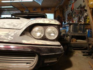

    Standing back and looking at it, I thought the headlight was still a little low on the outside, in fact, the bezel didn't quite meet the fender eyebrow underneath, so I took the bucket out, welded new mounting tabs, and rotated the whole think up half an inch in the fender.
    Viola! It's perfect now!
    I'm still deciding whether or not to cut the rear quarters up, and tuck the lower part, behind the wheel, to carry the side spear line back to the rear bumper. It loses it's shape behind the wheel as it is now, I think it'd look nice, like the Eric Black rendering, to carry it all the way back. That might requirer skirts, which would look odd with the Salt Flats.
    Notice the new rear quarter treatment in the Eric Black art, the next to the last photo, and compare that to the picture of my car in the driveway, the fender behind the wheel. This is what I'm talking about...
