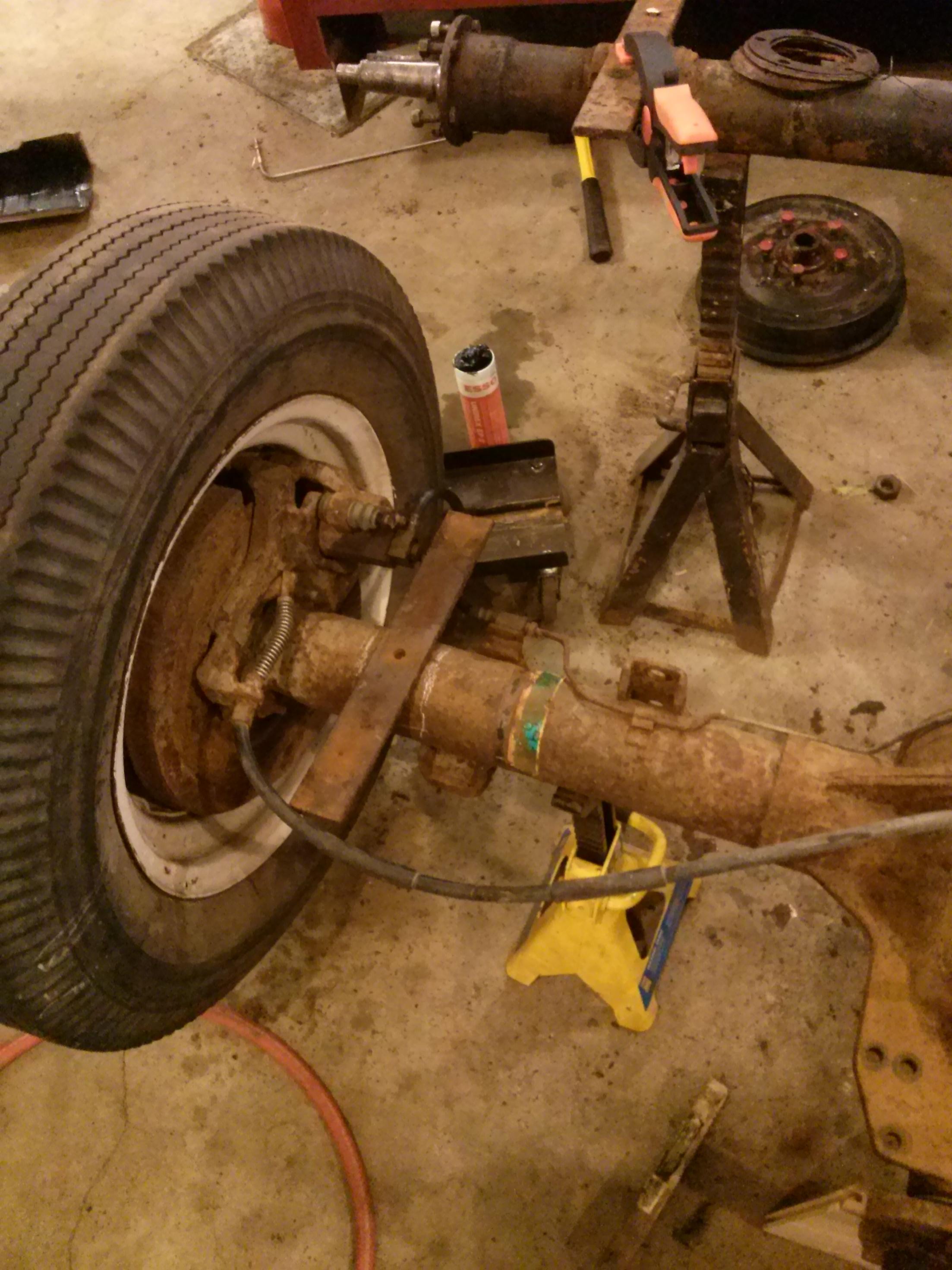

    All i plan on doing with this truck is driving it once or twice a week 3-4 months out of the year because the rest is too cold and snowy up here. Strength is not my biggest concern, parts availability, cost and not having the machined hubs and drums. Disk brakes would be a bonus but i could live with a good set of drum brakes in the rear. The 8.75 that i have now has the large stamped X and messures 59" 3/8 flange to flange. Im kind of lost to what rear end i want to go with.
    All i need is a reliable amount of strength, not too pricey considering im an 18 year old student who works an 11$/hour job, certainly not the pressed drums and hubs and the width being near 59"3/8.

    Stamped X on the housing.

    Yeah I meant 57" not 53, actually it's a little wider then 57.

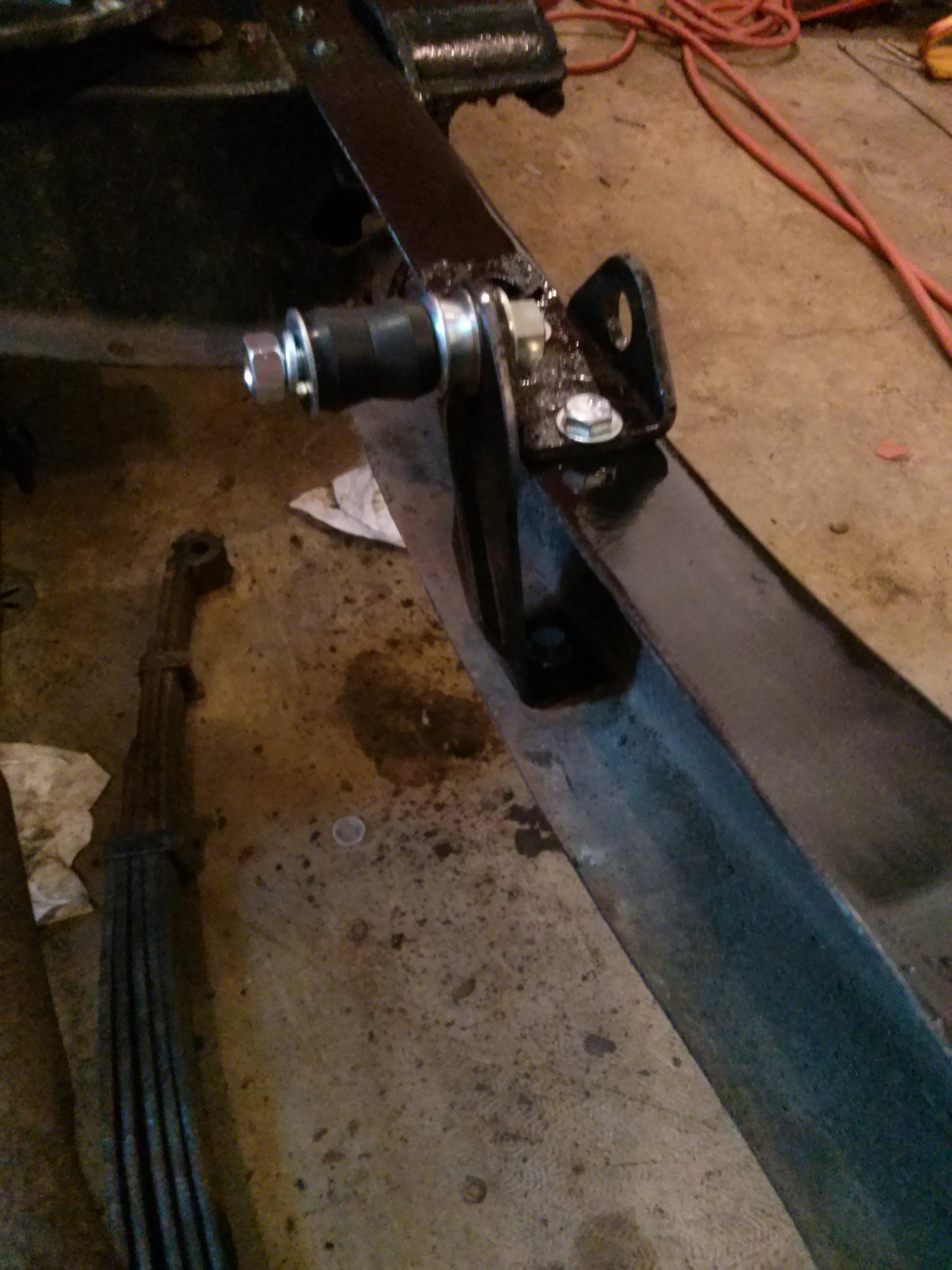

    Well, the end of another day. Early night working on Ole Red, straightened out a couple bent spots on the frame and bolted in the new shock mount on the frame. I used the same plates and brakets but cut and punched out the old bolts/pin. I bought a new one at Napa for 10$ and bolted right on. Before doing any more major work to the rear section of the truck i will need to decide on a rear end and get springs from Eaton Detroit springs. They offer many different springs for cars and trucks with an option of up to 3" lowering or lift for a small extra charge.

    The new shock mount painted and bolted with stainless nuts and bolts.

    Before

    After, easily done with a torch, vice grips, C clamps and a piece of angle iron
