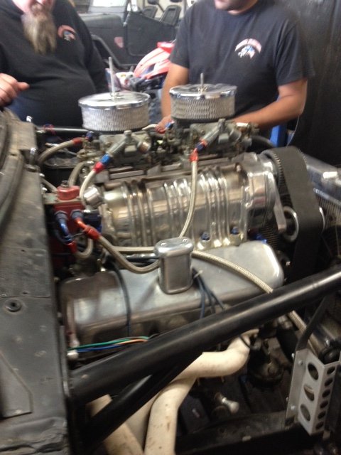

  12. Looking good, need more motor pictures

  17. Car looks great, love 55 gassers! Is that a hampton blower? How much boost are you set up for?

    The motor is a 454 b-bolt main a block with a Mooney -ham blower, two Holley 750 carbs. The motor is detuned for the street, guessing 13-15% under-driven. I did not build the motor.

  21. nice engines picts !
