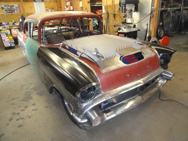

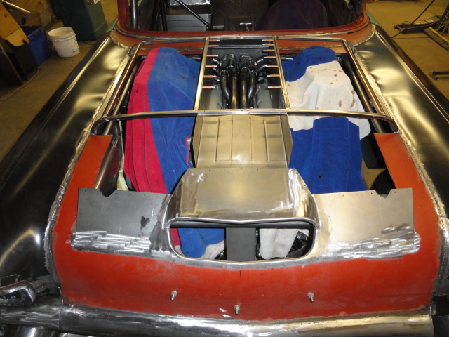

    Here are a few of the latest pic's of the 57. The "opening" in the front of the hood is to allow cool air in,to take the heat away from the top 12 exhaust pipes, thru a series of louvers (yet to be built) in the center of the hood. The air to the carbs will be introduced with 2 openings, one on each side of the rear of the hood, in the high pressure area near the windshield. The other shots, show the worlds biggest fender skirt, needed to remove the 22.5x35x16 Hooser tires. The upper seam is hidden behind the top stainless trim piece.
