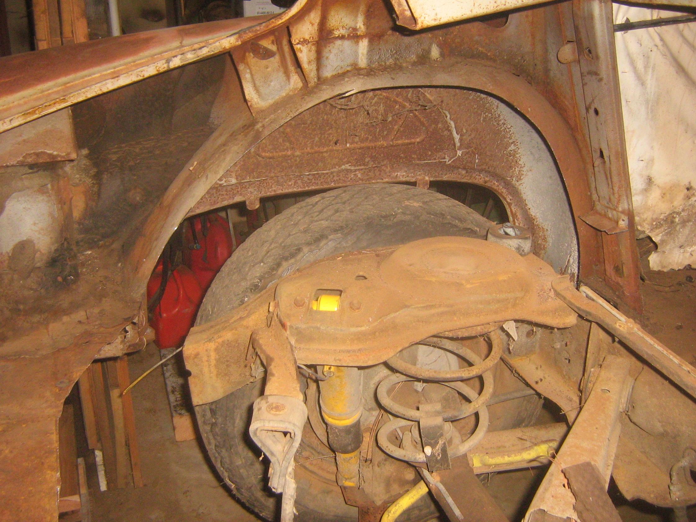

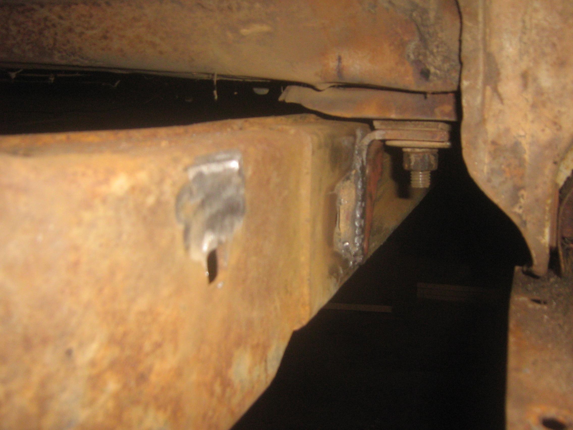

    Just putting the rear frame clip (to retain factory bumper mounts) and trunk floor back in today. Front is done for now and other than times spent fabbing decent bumper mounts for the front, it was pretty straight forward. I'm not much of a welder, but with a Home Depot Lincoln welder and a 4" angle grinder, it hasn't been bad at all. The '79 El Camino frame I am using was complete and free and 2" longer than the 115" of my hardtop. Cut it in the middle and boxed it in for 18". Minor trimming of a couple floor support crossmembers was neededm but they were a little rusty anyway and needed patching.
