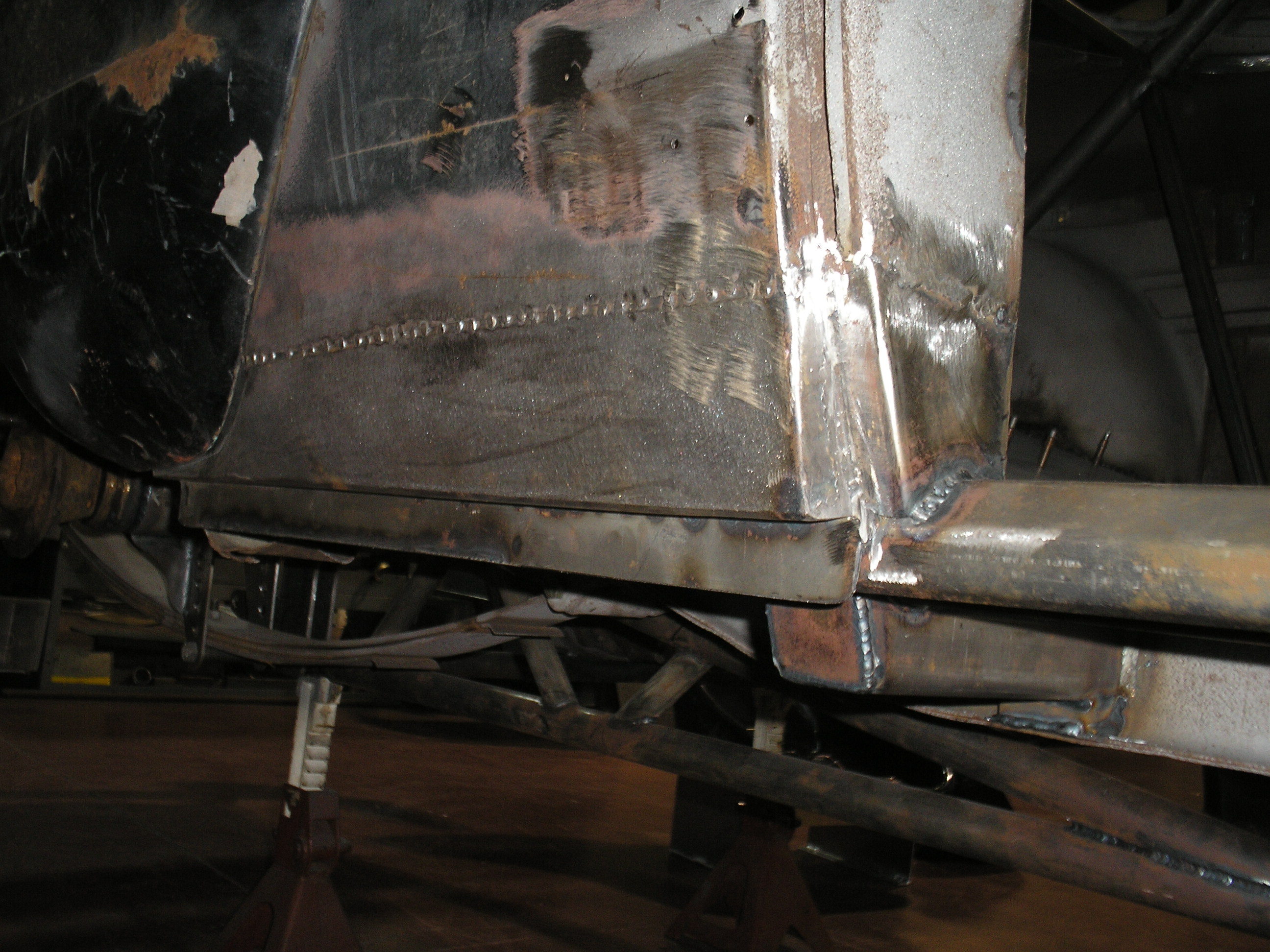

    This one is from the front bottom of the car (passenger side ) looking back. studebaker 002.JPG

    From the front outside looking back. there is another sheet metal piece that bolts over this, I may have to make it also, the ones we have are bad rusty. studebaker 018.JPG

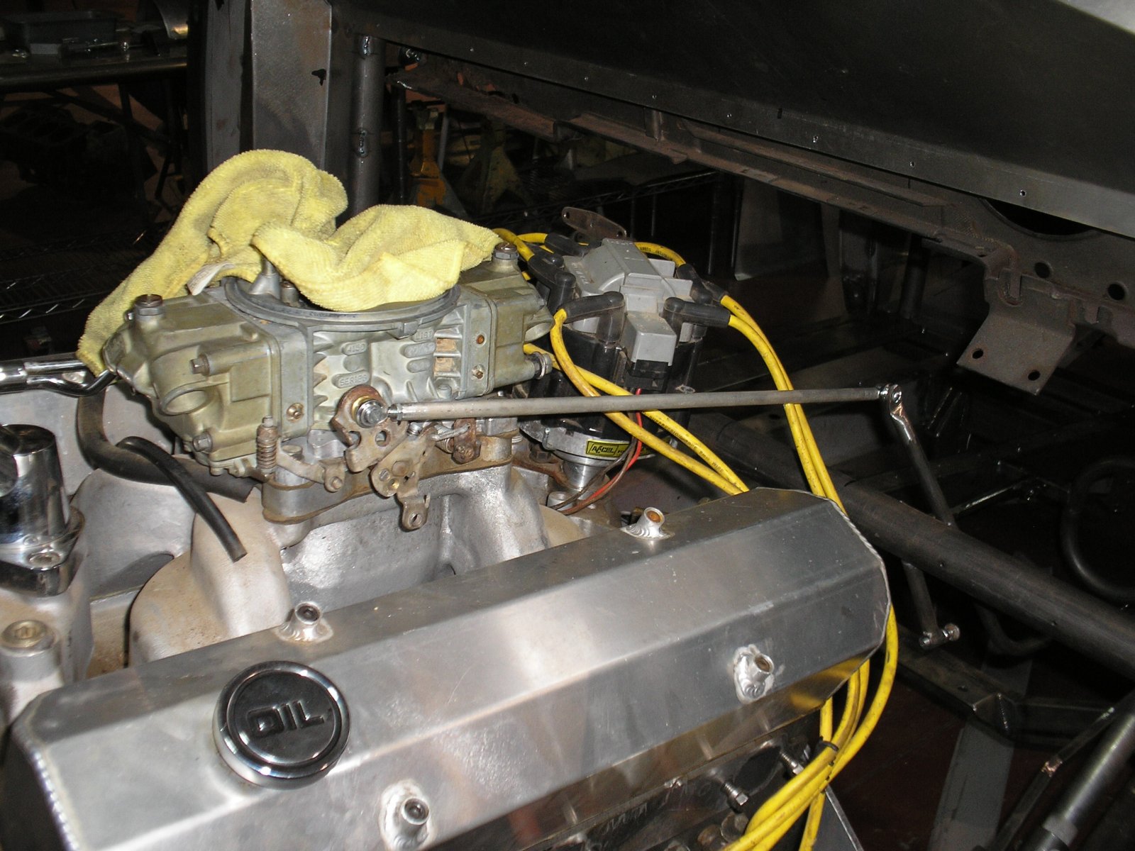

    After measuring David for throttle position we made the linkage to the carb. Real simple just aluminum tuning threaded for #10 rod ends with bushings for the big hole in the carb. Of course the valve covers and not era correct distributor will have to go to be South East Gasser legal. studebaker 002.JPG
    AHotRod likes this.
