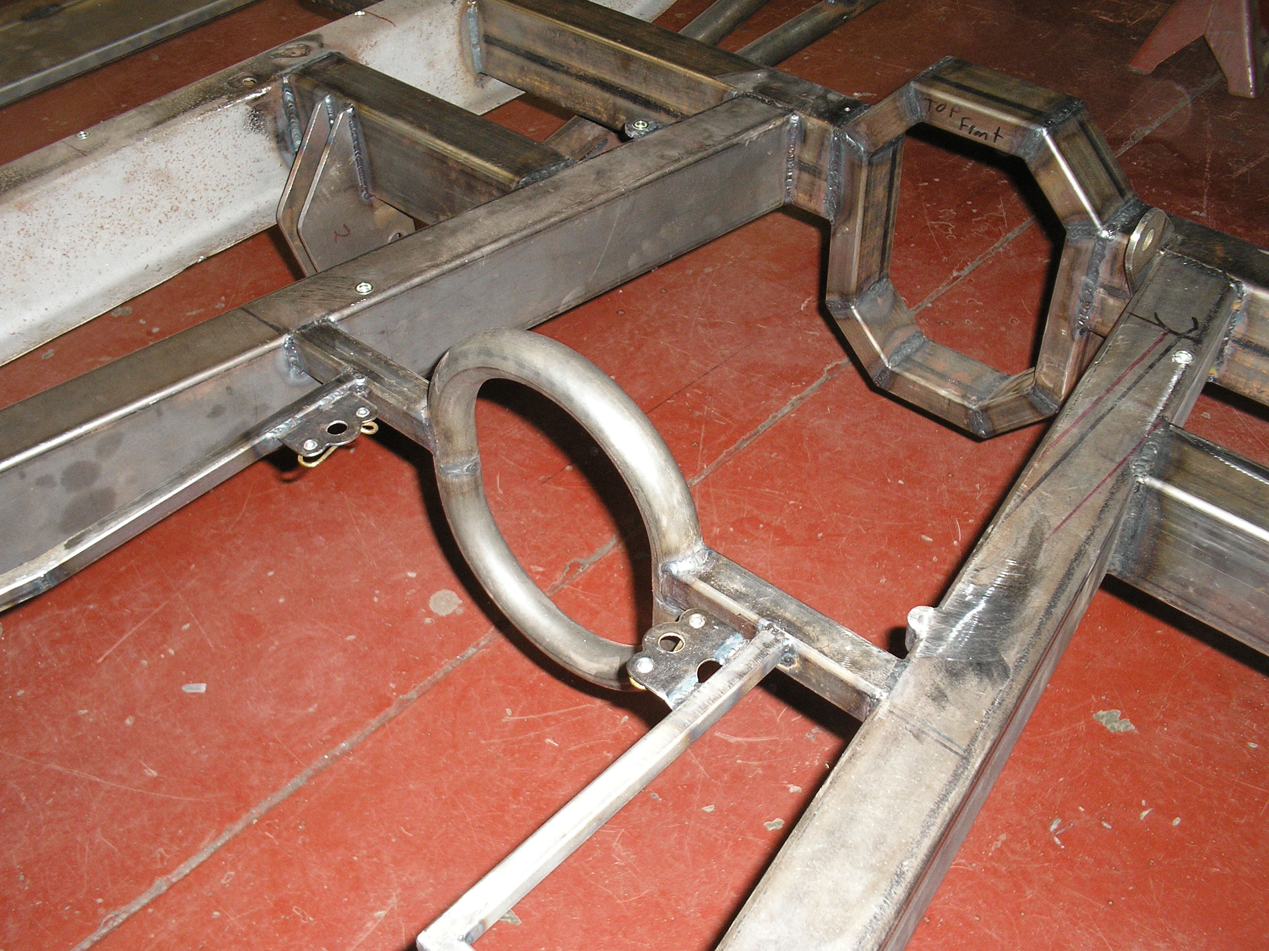

    A shot of the drive shafts loops. something to think about that most don't. When in high gear the trans is 1 to 1 with the crankshaft. So if the engine is turning 8,000 rpms so is the drive shaft, with only a thin piece of sheet metal or aluminum between the driver and the shaft. Most brake in low gear so not much damage but if it comes out in high gear, it will be hell too tell the captain. studebaker 003.JPG

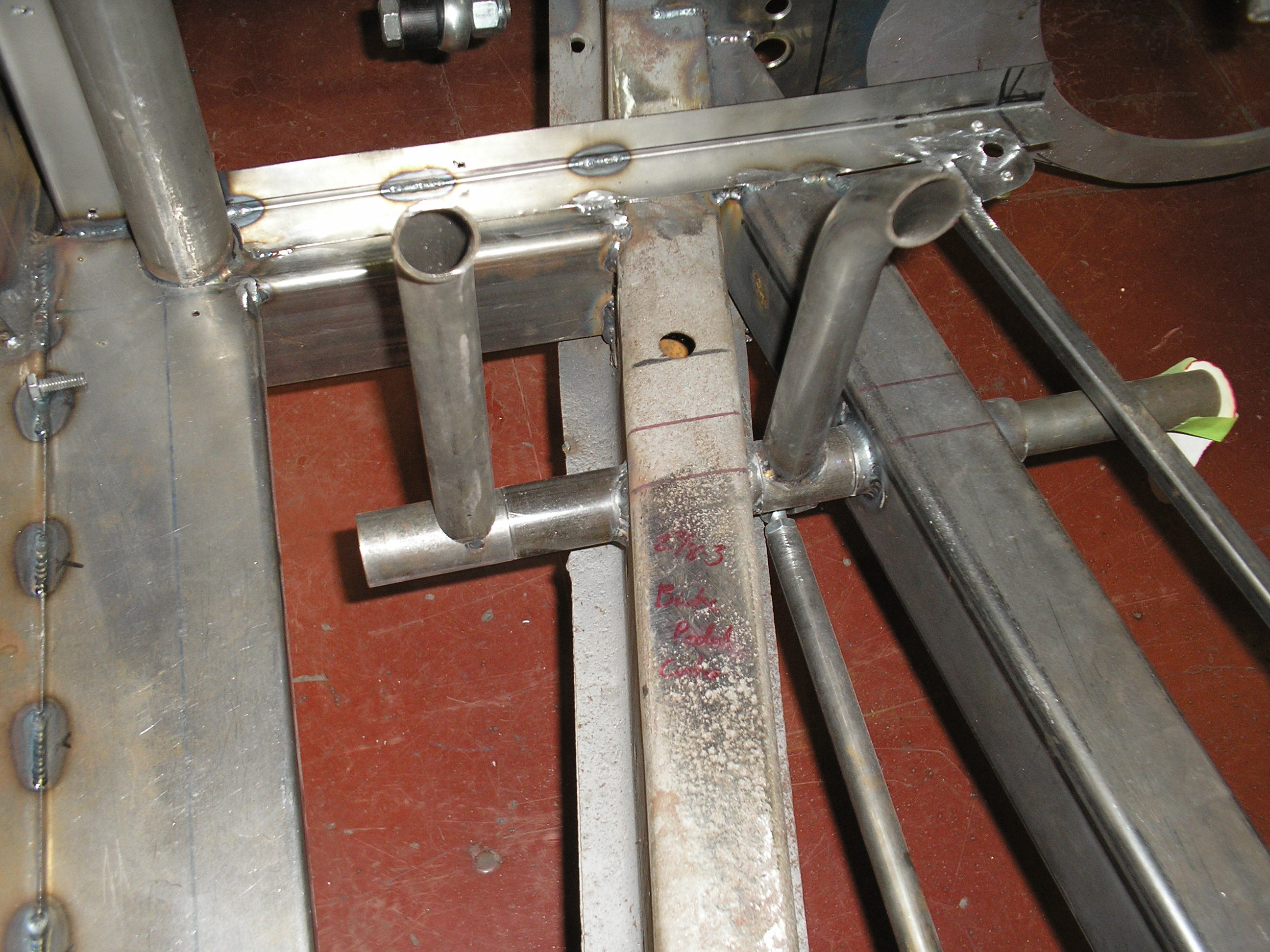

    Several post back I posted the sheet metal cowl area where the upper part of the aluminum firewall will attach, here's how I'm going to attach the bottom of the firewall to the chassis. Note the dzus fastener plate incorporated into the firewall mount for the removal trans tunnel. You can also see where the extra frame brace ties into the mid mount bracket. studebaker 006.JPG
    lawman, AHotRod and volvobrynk like this.

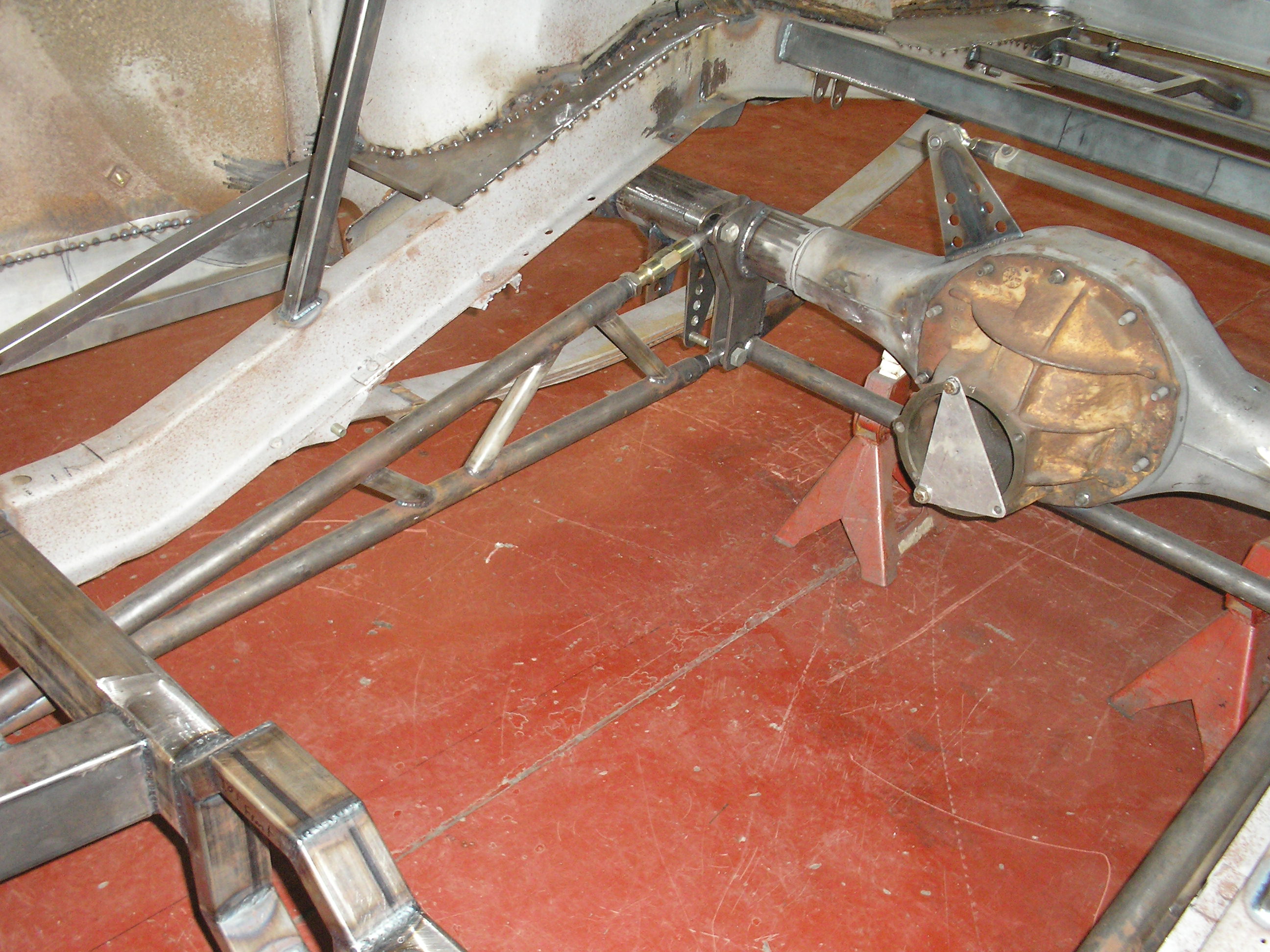

    The rear suspension set up, we make our own ladder bars. The last few cars I have done are 1" 1/4" x .120 wall to be more old school looking. I was doing them 1" in the past. I also started putting the adjuster on top so it won't be seen when looking under the car. The solid rod ends that are in there now are just for line up reasons, it will have heim joints in the end. I made my solid rod ends .010 wider than the heim joint so when the heim joint goes in to will just slide in with out a hammer. I do this every place on the car where something is removable. No hammer needed to work on it. studebaker 002.JPG

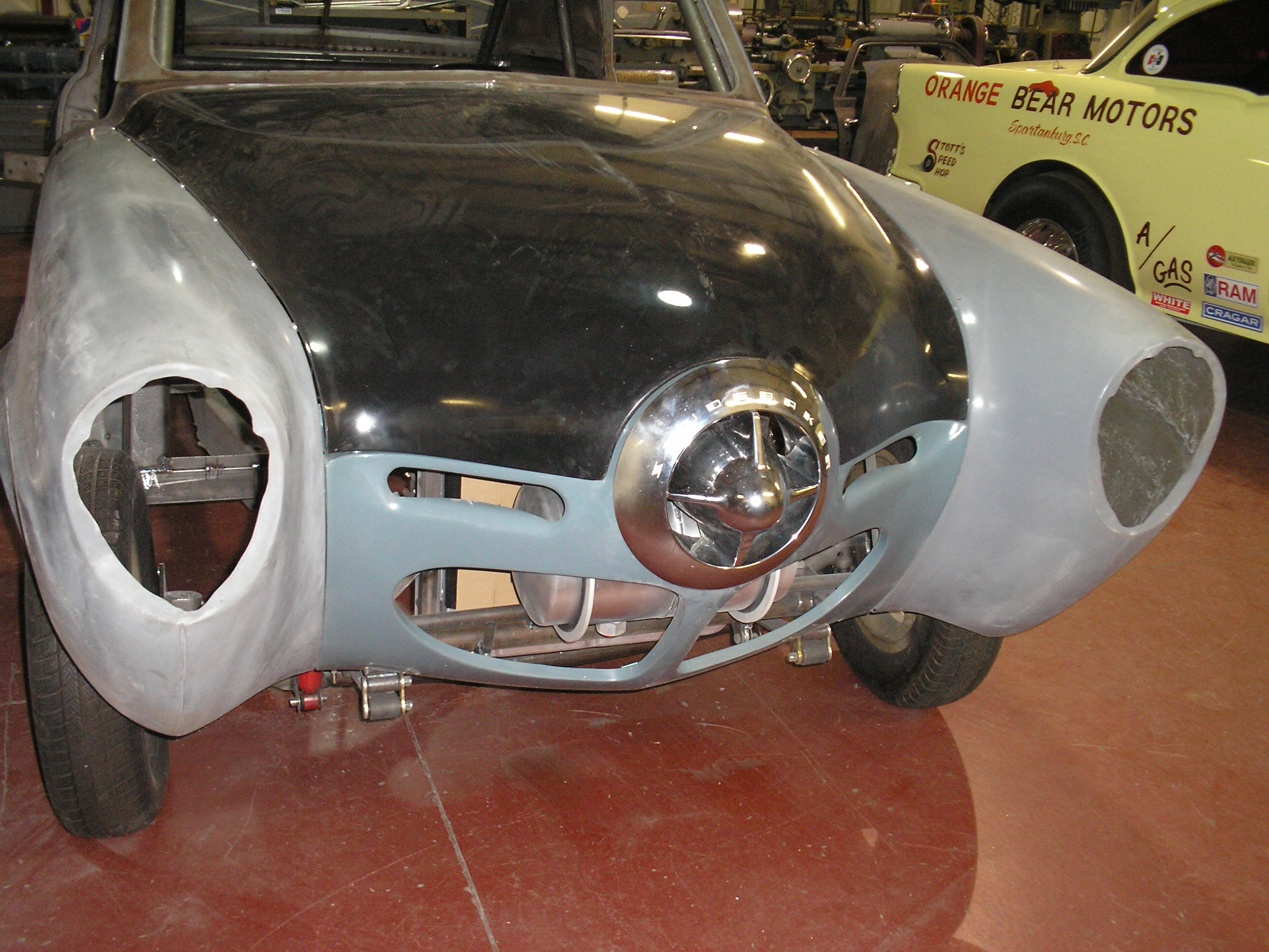

    Peanut 1959, I'm not up on my Studebaker history I know he has both combinations this is the bullet nose he is going to use. I think he said the other one is not chrome around the outside. He also has both year model lower grills, we are trying to talk him into leaving them out. If we use them they will have to be cut for the gas tank which would look cool. We was limited on space for the tank because the front end rolls back so bad. studebaker 001.JPG

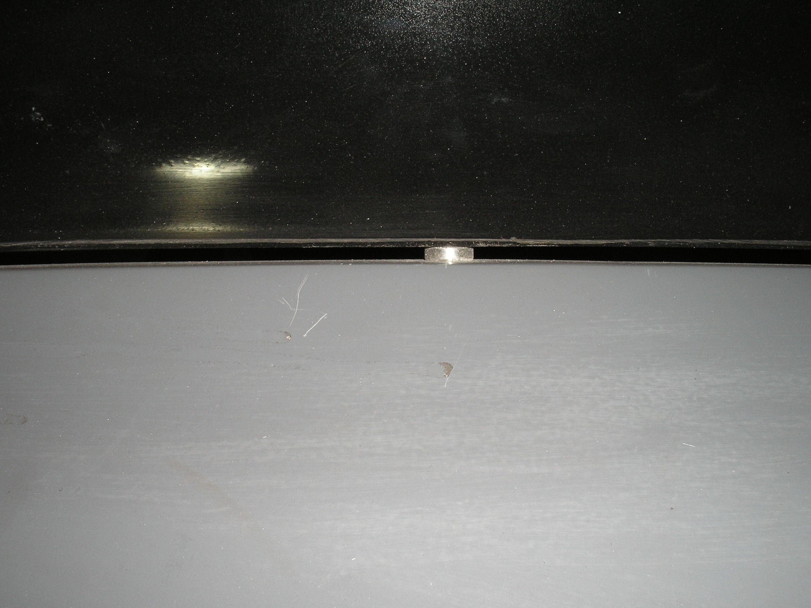

    Since I have posted the front end pics I show y'all this. David wanted to keep the hood gap factory instead of glassing them together so we made perfect size aluminum bushings for spacers. I don't have C and C equipment, it took a long time to turn them out on a manual lath. studebaker 001 (2).JPG studebaker 002.JPG

    That is the '50 front end. I, generally prefer it to the '51, though they are both winners in my book! :)

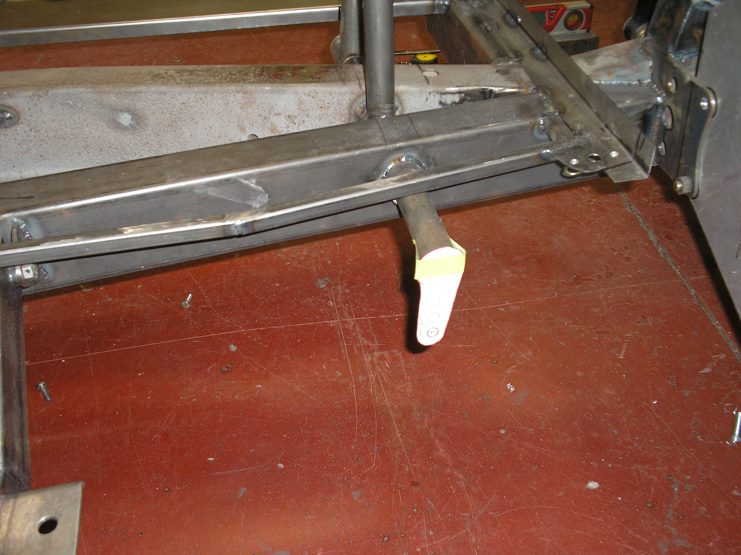

  16. Hi Quain - what is the pipe diameters and thickness that are needed so that one slides inside the other? The pedal itself looks like 1" ? I need to do this next. Thanks for the details on this stuff!
  17. Quain Stott
    Joined: Nov 21, 2006
    Posts: 2,058
    Quain Stott

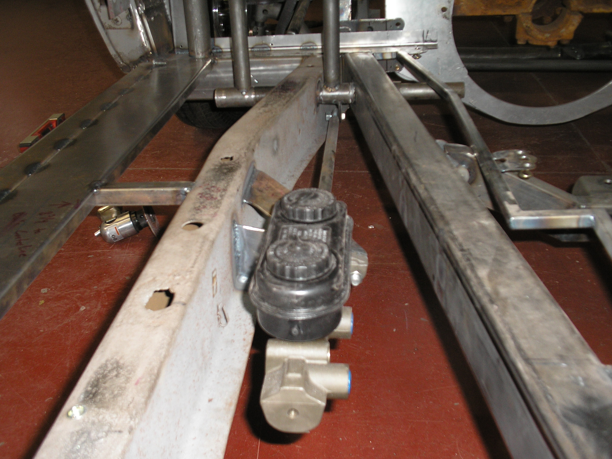

    Tony the main shaft is 1" x .083" chrome moly, if it's braced good, if the clutch pivot arm is going to hang way out from the frame with out any bracing you should use 1" x .156" This can be seamless mild steel. The bushing's that weld's in the frame and the floater on the brake petal is 1" 1/4" x .120. When you weld the bushings in the frame put a heavy coat of anti seize on a thick 1" pipe and have it running through the bushings while you weld and until it cools. Also weld a little bit at a time. I don't mean let it cool then come back and weld more just weld one side then move to the other then come back. Don't forget thick pipe and heavy anti seize or it will be in there and never come out. If you have a 1" reamer and it's where you can get too it you won't have to worry about any of this.

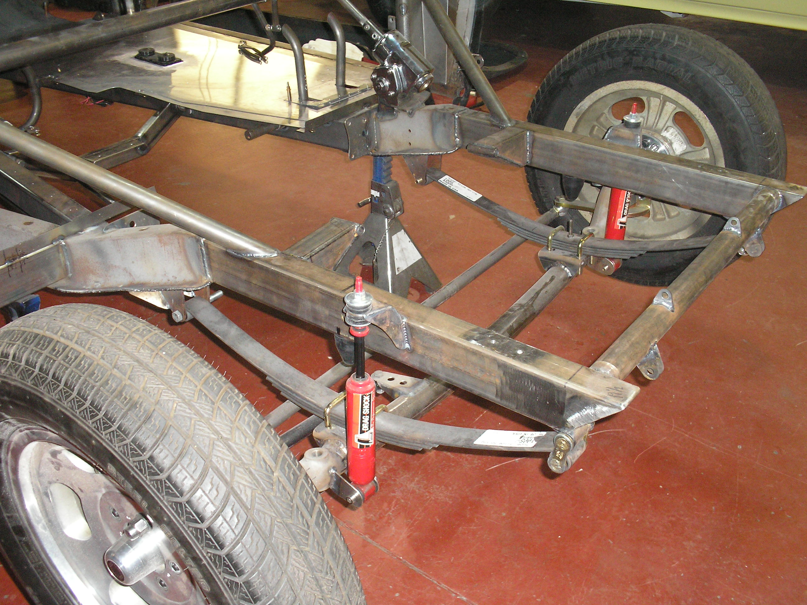

    The front suspension finished up just needs a little adjusting. studebaker 007.JPG

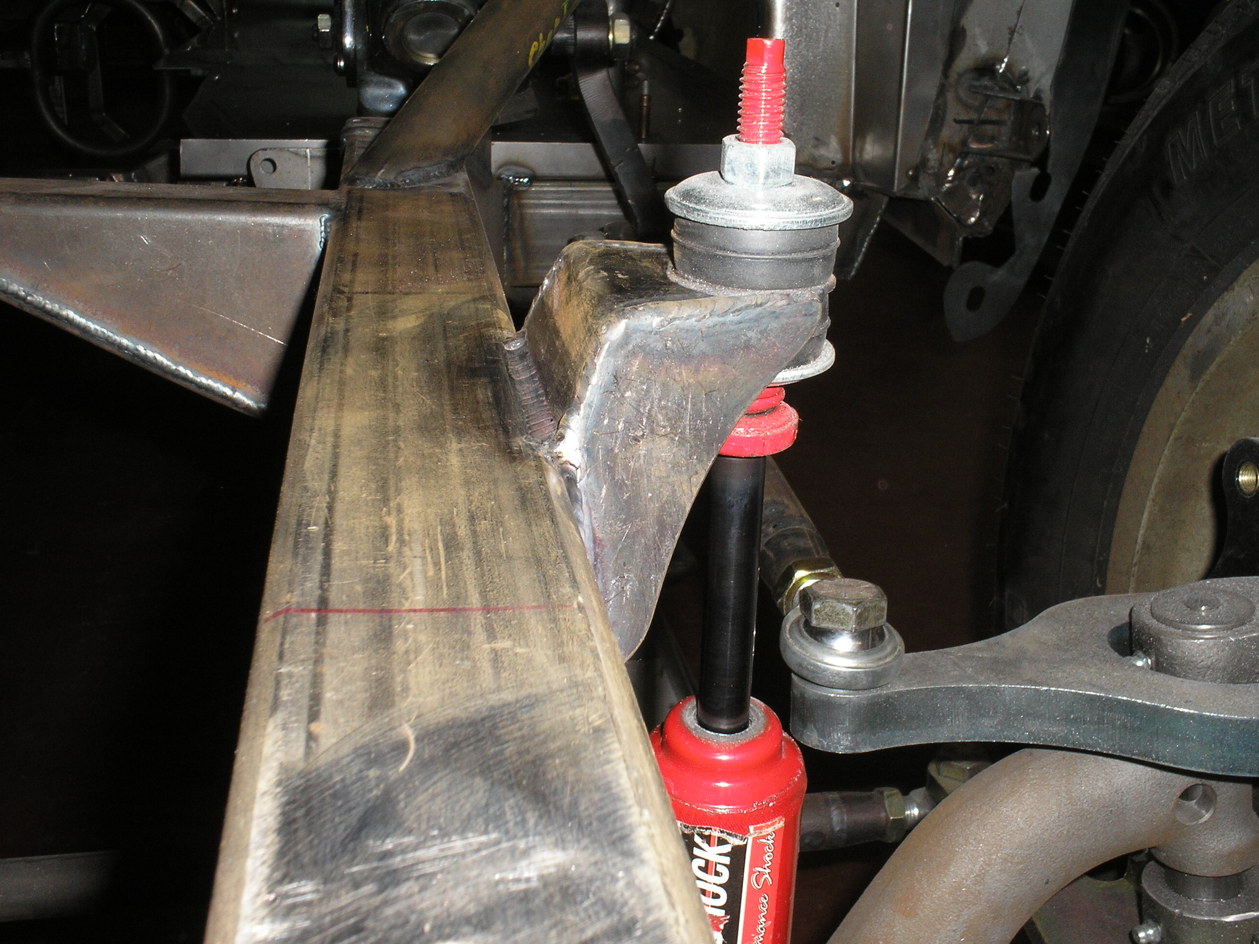

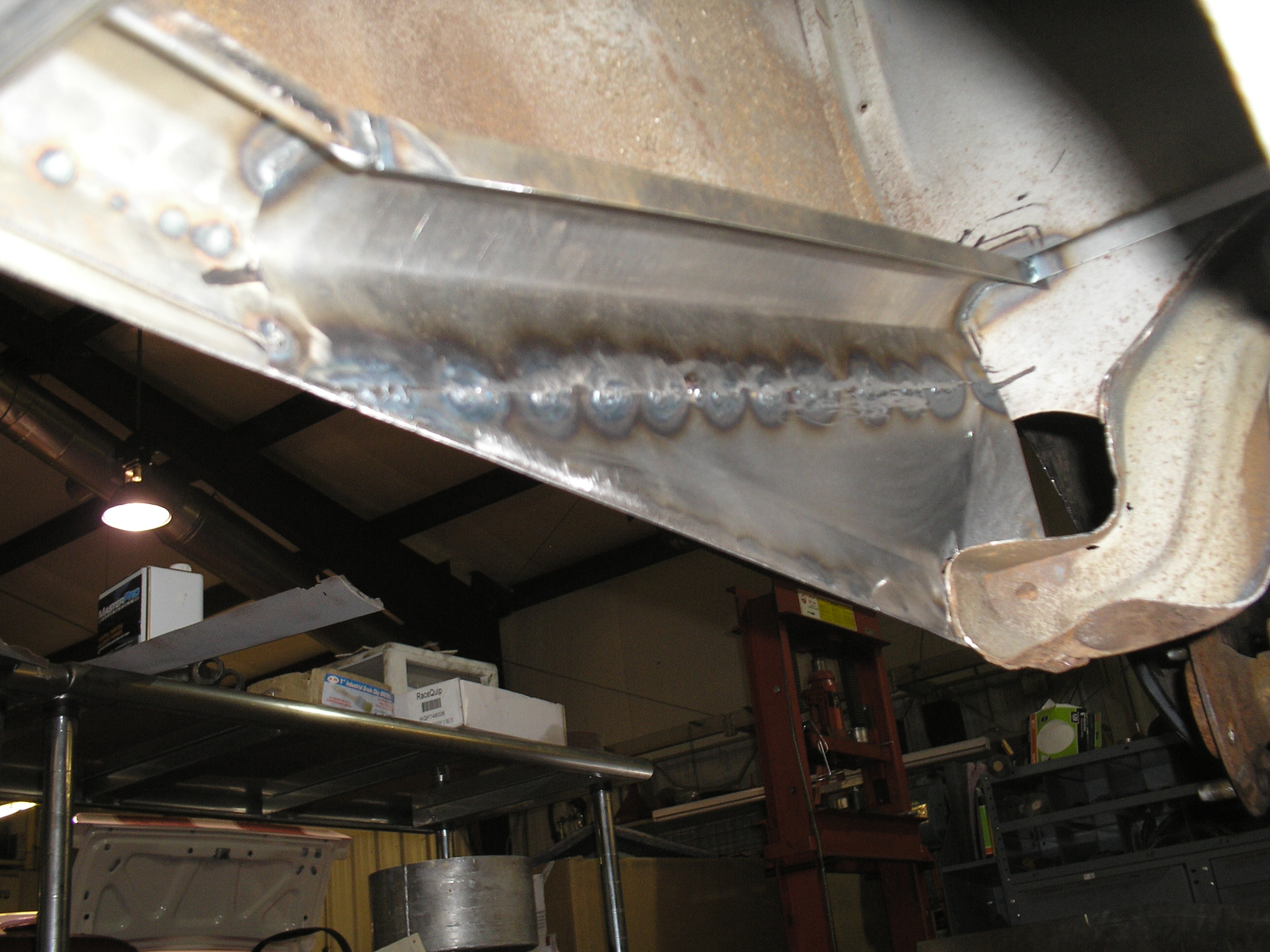

    Marcus here are a few more pics of the rocker panels. I wish I had know you needed them and I would have made pics while I was making them and you could see more details. This one is from the bottom passenger side looking back to the wheel well. The part that kicks up is where the little aluminum panel mounts that is pictured earlier in the thread. It's made just like the front part but this part kicks up. studebaker 001.JPG
