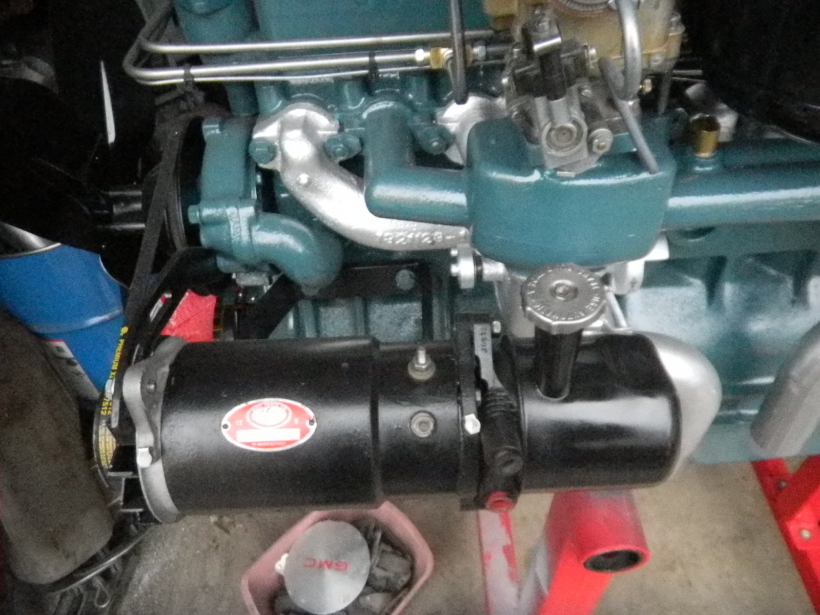

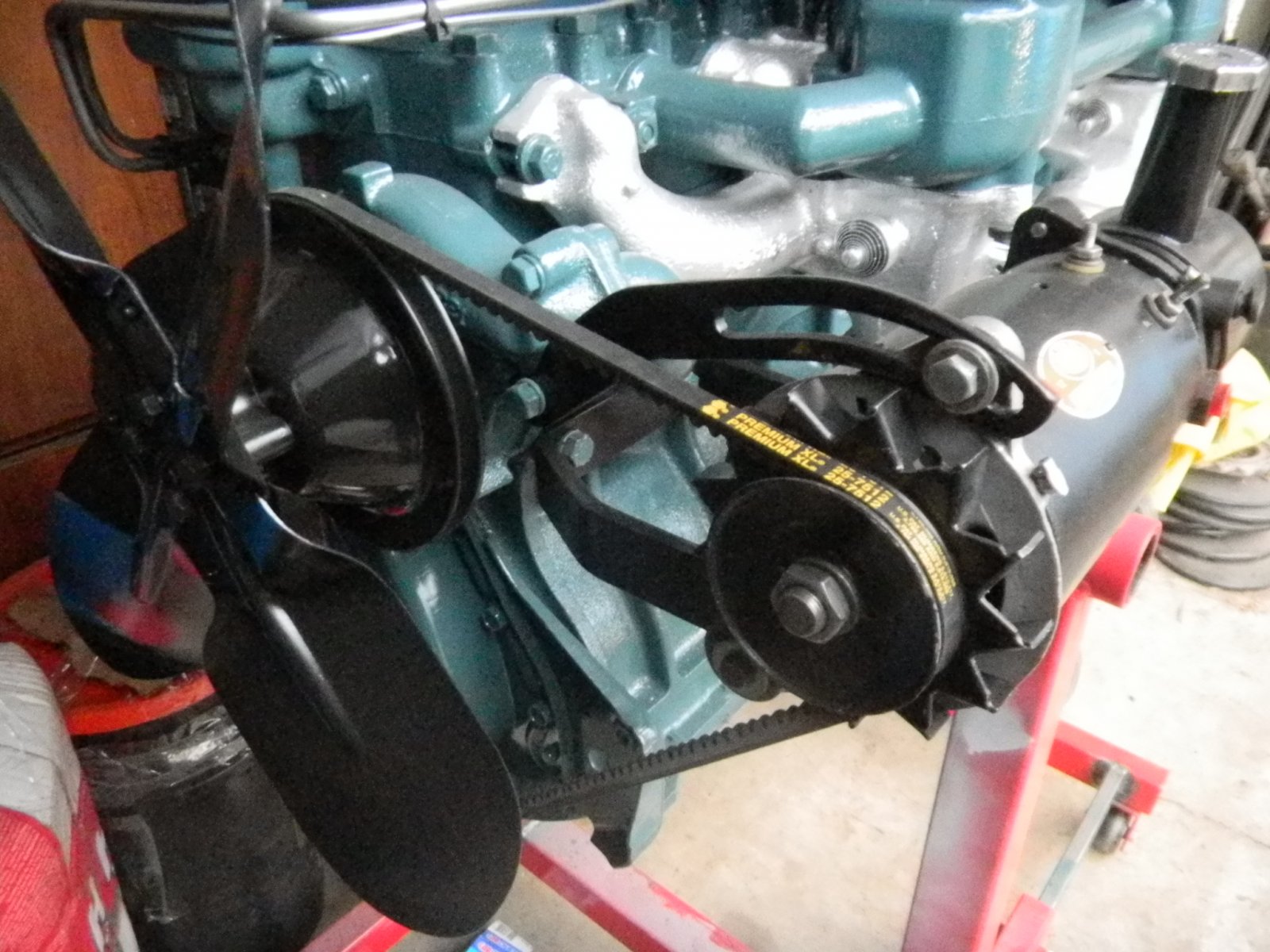

    We have a 49 Sedanette that is stock bodywise but thoroughly modernized drivetrain. I mention this because until I did so the car wasn't much fun to drive in modern day traffic. In fact it was sometimes down right frightening! After the upgrades it is a joy to cruise in. We log a couple thousand miles a year in it. For this reason I would like to offer you this advice.
    When I did the upgrades, the first thing was a front disc brake kit and a dual vacuum-booster master cylinder. That made a remarkable difference in stopping ability. Next, I installed power steering, because my wife could barely manage to maneuver it around sharp corner with the "armstrong steering". The power steering setup was simple and inexpensive. I utilized a 58 Chevy Generator/power steering pump and its valving ram adapted to the Buicks pitman arm and tie-rod. We can parallel park with one finger turning now. That conversion cost us about $250 total. Next we installed taller gears in the rearend. You can get those gears from later year Buicks (57/58) to fit your housing. Then you won't get run down by a little Dodge Neon like I did, Most embarrassing! I also installed a compound carb setup with synced carbs on it for a considerable boost in power.
    I'll try to upload a picture of our motor to show the simple power steering mount, (no complicated bracketry required.
    Best Regards and good luck with all your endeavors, KB.

    I forgot about that gen/ps pump. I haven't seen one in 25 years. Thats a real sano
    Setup and looks perfect
    On the straight eight.
    Some thing I will consider in the future. I ve been looking for a factory power steering setup for some time.
    Maybe mating that pump with a mid fifties power column.
    I'm not a fan of the ram assist setup. Nor ever been a Chevy or ford guy either.
