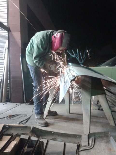

    In 2011 my friend Skratch had me helping him around his shop, and one day we had to transport a car up north. but we had the trailer for an extra day. he said that the truck should come to his shop so it might actually get done sometime soon. that was a offer i couldnt refuse and as long as i was working on it with him and did all measuring and cutting, he would do the welding on the truck since he has a tig welder and is much better at welding than me. So the truck met the chopsaw. Since low is the name of the game, the frame got a huge 13 inch C notch in the rear and 7 inch Z up front and is completely boxed.

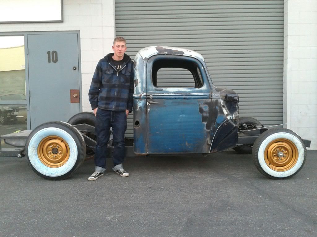

    when first at shop:
    what it went to:
    then we dropped engine into it and upgraded the suspension cut two coils(hate all you want) added disk brakes and many many more fixes to 1947 technology
    and got it to this:

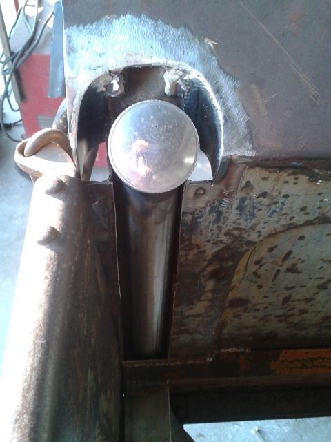

    the stacks bracket:
    stealthy fuel filler in stake pocket:
    and more on the C notch

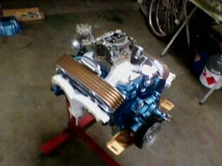

    a fresh picture of the engine with headers painted and installed

    thankyou. lots of time went into the engine. i think i went through about 4 head sets before i found a good useable one. then the finned valve covers and oil pan came with one of the engines i got. then the rest has all been fun finding. the clear distribitor cap was at a local hotrod parts store. i think thats one of favorite pieces. then carb spacer got drilled along with front motormount, that took some time. skratch modified the headers and made the huge collector/fenderwell dump from diesel truck tubing. the plug wires ran under the header so they are hidden. its the little things that count. there will be a vent in the side of the hood so the engine doesnt get hidden too much.

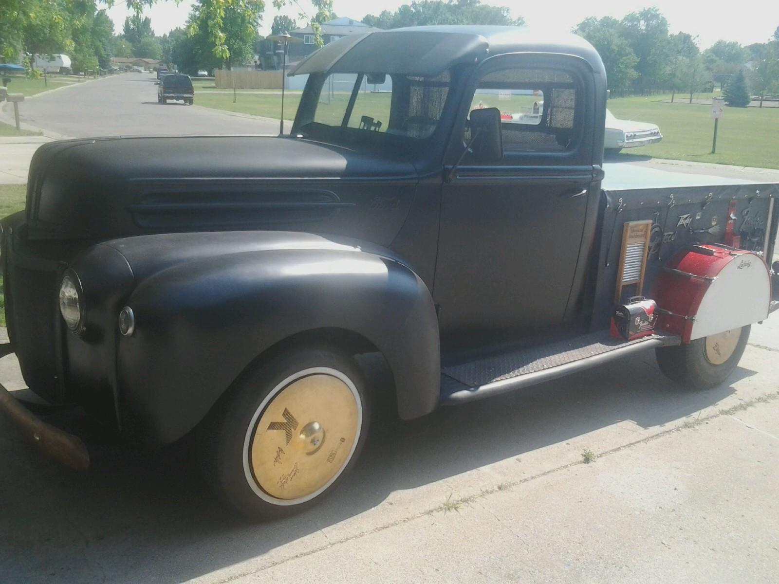

    here is my 47 ford pickup me and my dad built, hes a drummer
