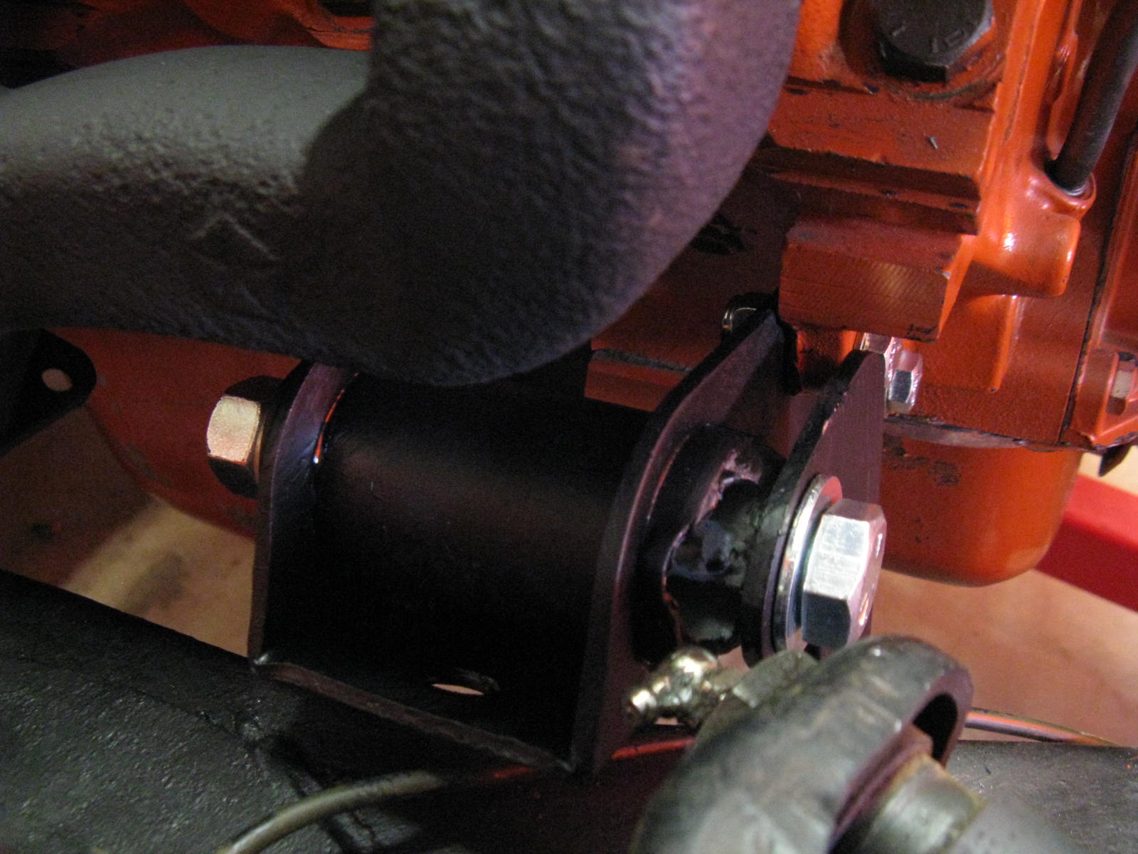

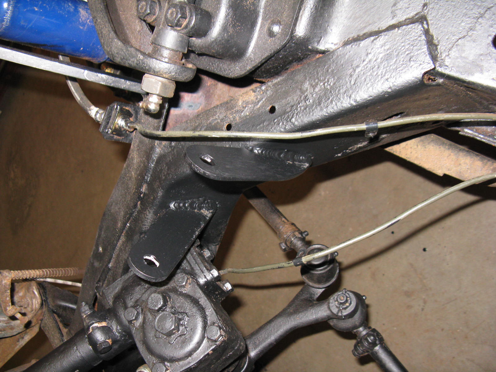

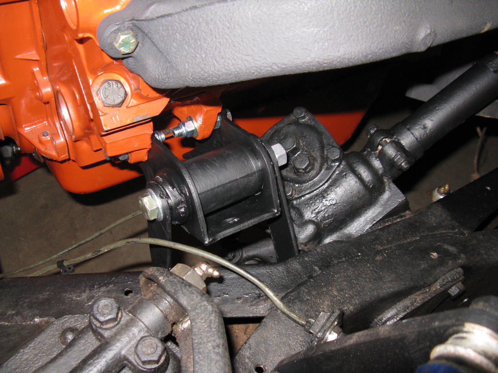

    This weekend, I finally made some progress. I purchased a 360 a couple weeks back and this weekend I made and installed the mounts. First, I set the engine in place a couple of times and after making a relief in my firewall, I settled on a position for it.
    Once I didn that, I created some paper cutouts of the engine mount brackets, then transferred the design to some 1 1/2 X 3/16 flat stock. After cutting them out, drilling them, etc., I bolted them to the motor mounts and made some small adjustments.
    Next, I tacked them in and double checked the fit all around. The engine is offset about an inch to the passenger side and I'm using 340 exhaust manifolds to wrap around the steering column. This is one of the tightest areas.
    Hopefully, the pictures will tell the rest of the story.

    The swap is looking good! the only thing I might add, and you might already have this planned, why not "box" those mounts on the inside open sides to give them a bit more fore to aft rigidity. 340 exhaust manifolds are the way to go, rare these days though, so good score! You'll love this thing when your done. These are the most comfortable pre 48 cars ever.

    Looking good! Definitely box those mounts- it is SOOOO easy to make some good power with the LA mills- I've got a 360 based 415 in my Falcon gasser build.
    Yours should be a comfy, smooth, cruiser with some nice power. Not every car must have unreasonable power, but I would never put up with a wimp that is only a pretty face. If I put my foot down, shit better happen now. So I make sure it wont break itself with its own performance. (box mounts,lol)

    "Box the mounts" - Damn, I knew that I should have dones something else before I slapped paint on those. :) Oh well, I 've got more paint.

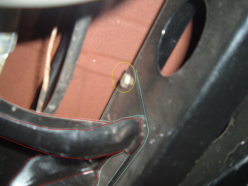

    Looking good! For the trans mount, I used a 91 Dakota 2wd crossmember and a couple plates. Bolted it up to the trans, marked and cut it to width with the plates held to the X member, then welded the plates to the cut crossmember. A couple bolts on each side finished it.

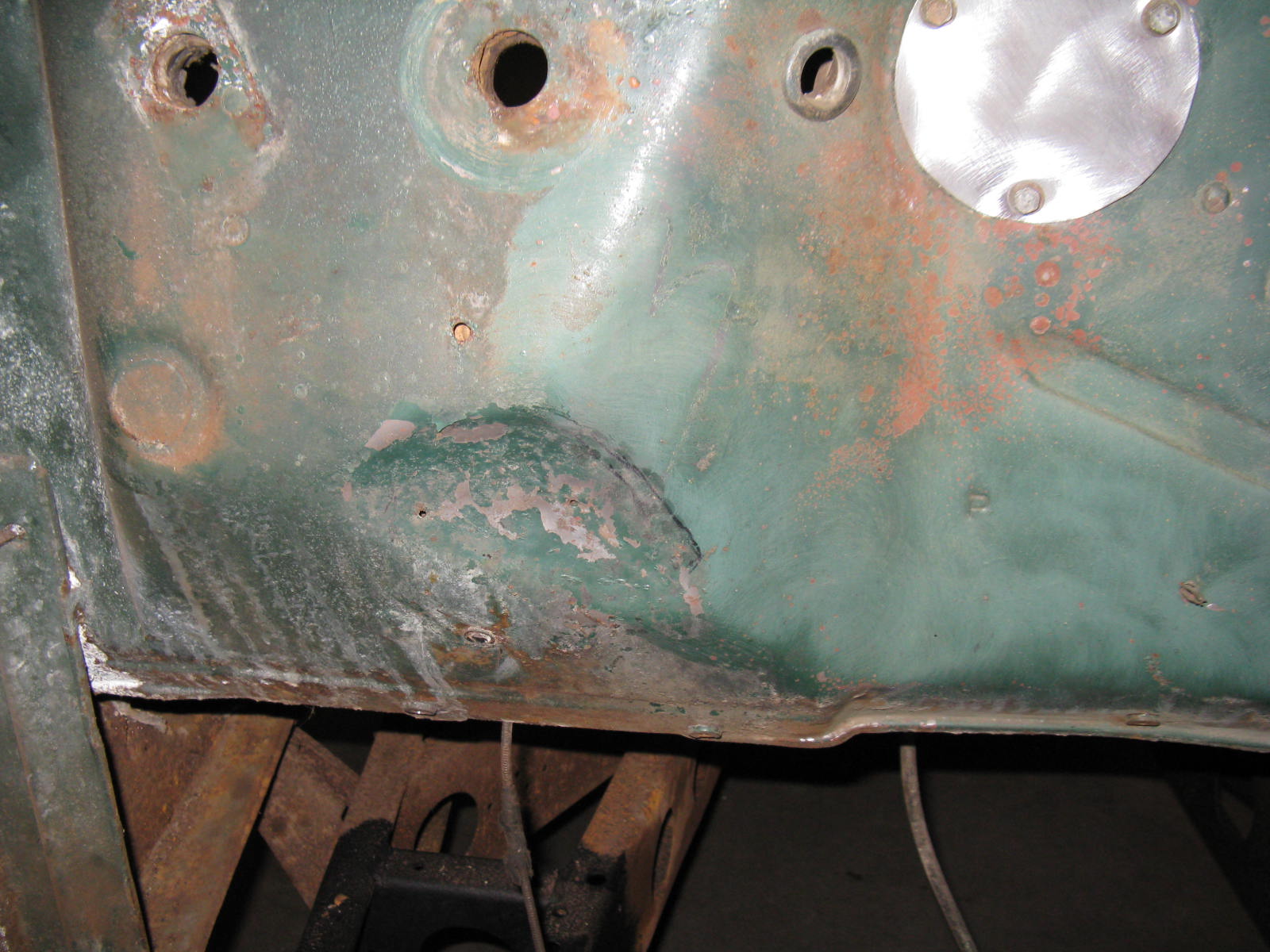

    I know that the passenger side of the firewall usually gets dimpled with these swaps, but I don't understand why it is only that spot on the passenger side.
    Is the engine set at an angle to clear the steering column, and that puts the passenger side closer and the driver side farther from the firewall?

    just the way it works out, 1 dent & both inner fender cut a bit.

    4woody, I didn't have to ding mine. Right side head is further back than the drivers side, like a SBC. SBF is opposite. Firewall is pretty even on both sides. There is a bit of an angle, but the tailshaft is offset some too, so it's not much.

    The head on the passenger side extends back further than the head on the driver side. Plus, I'm trying to get it back as far as I can for radiator clearance and better weight distribution.

    The 41 does have an X in the chassis. I have removed the original cross member. The new one will be substantial enough. I like tubing.
    The motor mounts do not lend themselves to boxing, as the rears are welded to a straight section of frame and the fronts welded to a section that is turned in. Therefore, they are in different planes. Do I really need to stiffent them front to rear? If so, I can gusset the front mounts but I don't really want to.
