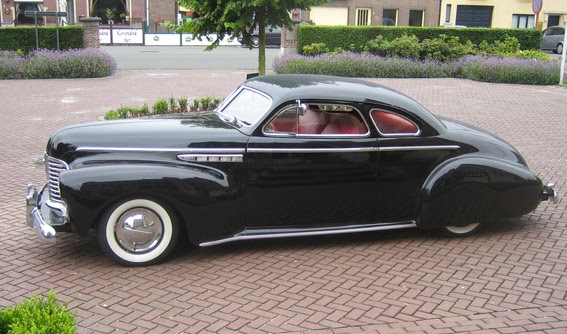

    For a long time I have been dreaming of building a inspired build of this barris 41 buick. Not an exact clone but my way with the hambs input. Something pre 52 customs by the sea friendly. Clean and classy

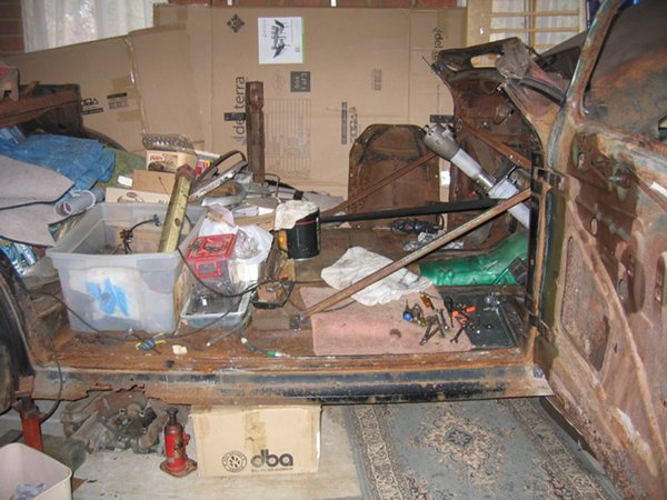

    m_IMG_4352.JPG m_IMG_4322.JPG m_IMG_4400.JPG m_IMG_4441.JPG Hi K13 .... You are spot on with the strengthening in the rear quarter.....its not only the quarter panel post its the whole rear tub needs sheet metal fabrication right around behind the rear seat swab that seals the trunk for strength as well...Hacknwack needs to find some photos of a striped out convertible to see what to fabricate.....My project is the same 41 Caddy 4 door to a 2 door Carson top.....big job but worth while when finished...just need to be patient and think a lot before you cut anything....I've used cut down 41 Buick coupe doors and sections of the Buick quarter panels to help assemble my car....

    Thanks morac41. Thats a huge undertaking you have for a home shop.
    I can see myself getting that deep in a project.

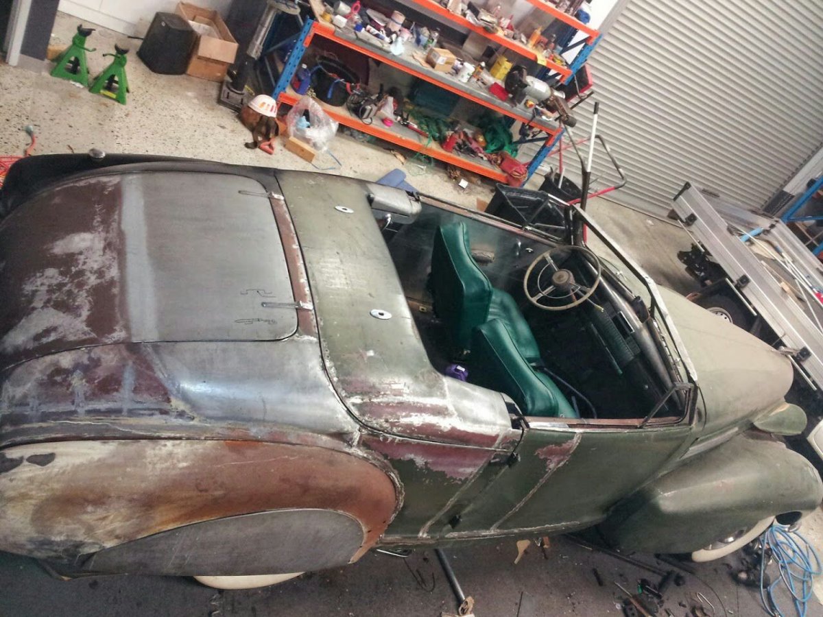

    You need an english wheel. Just a cheap Chinese one is all I have. $400. sellit once you are done. Great thing about a custom is that there are no rules. Just solutions. If it needs strengthening. . . strengthen it!. The X member on the 40s and 50s convs usually had a bit more beef. I know on the late 30s coupe vs conv it was just a bigger plate top and bottom. Steel is cheap. Great thing is that you can rollunder most factory cars and have look. . . . so long as some bastard customiser hasn't dropped in a bloody speedboat stance.!!

    Hi Hacknwack....I've been building hot rods and customs since the 50s and have only used hammers..dolly's..sand bags...large wood stump and an anvil to shape metal ..any one can do it ...... it just takes practice ... learn how to lead wipe..use a file to find the highs and lows..... practice ...practice

    Hi hacknwack...Have been researching the chassis on my 41Caddy more door to a Carson top 2 door conversion ...It definitely needs to have a X member up grade...Took a while to find the photos...the Caddy convertible defiantly has a reinforced X member both on top and bottom ...probally 5mm plate......I will do this to my chassis to up grade it to convert spec's.........

    The Ogden buick is a roadmaster. Seems that the shorter bodys wont have the same feel.
