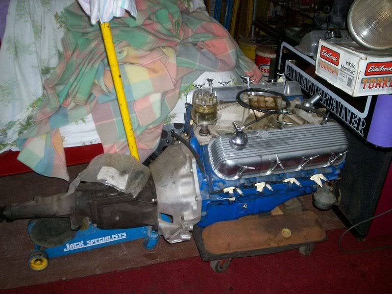

    Hi guys in my recent tavels I have been offered a 402 chev motor and know nothing of these. Is there something I need to know prior to purchasing this? Here's a snap of the motor, thanks.

    I'm no expert by any means, but I thought the 402 was one of the W head engines? To my decidedly untrained fryball that looks like a prettied up Mark IV Big Block Chevy. I don't know though.:confused:

    basically it is just a overbored 396.

    Big Block Chevrolets came in two very different ways. The standard, everyday oval port head with 2 bolt mains ... and the High Performance square port head with 4 bolt mains. The square port main engines came with solid lifer camshafts ... :) better crankshafts and parts.
    Look at the engine number/VIN code ... to know what the engine originally came in and the horsepower it was rated at ... :)
