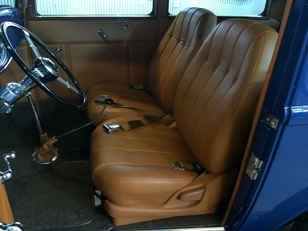

    Dont think it will be any different but in my 32 sedan Im using Toyota Echo two door seats. Passenger seat has a nice little glove box under it and it moves forward and the back folds so you can get in the back. I found these in an Import wrecking yard, when I had the trim guy do the Interior I had him shave a bit off the lumbar so it would look a bit more old skool. They fit like a glove in a 32 so I wouldnt think you would have a problem. IMG_0344.jpg

  6. Those are good looking seats. HRP

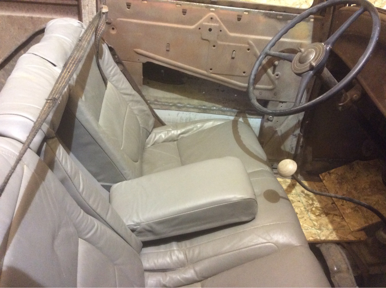

    Early 90s honda civic with headrests removed are good looking and very comfy. Ive got a fourdoor front seat in my deuce tudor,just made the whole thing flip forward for rear seat access.[​IMG]

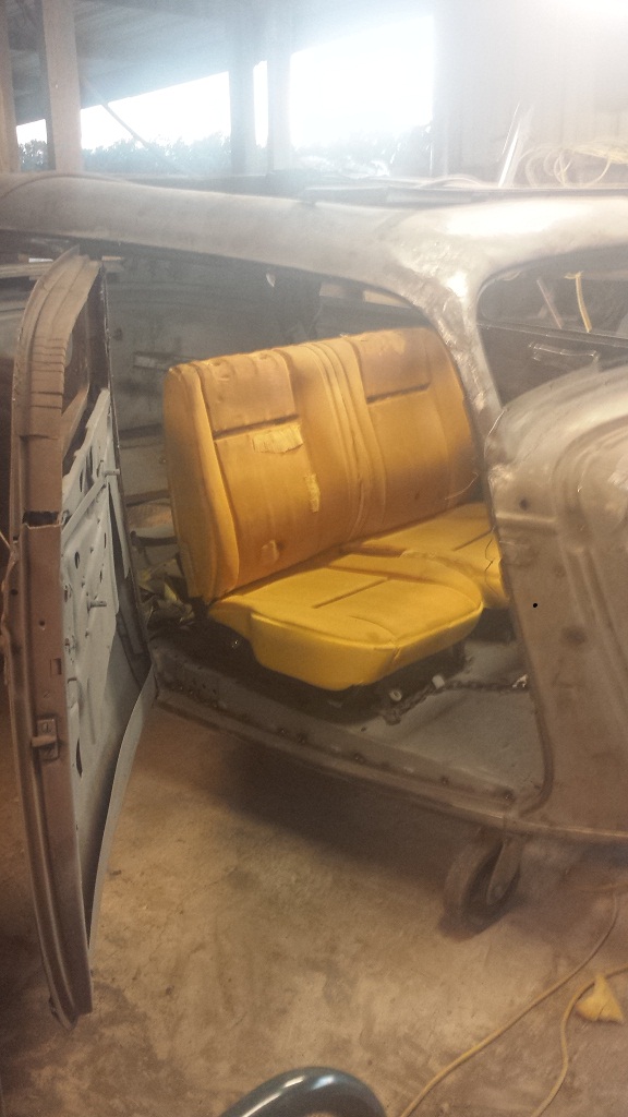

    I used a bench seat from a 90's Isuzu truck.....cut 7" out of the width and welded the frame back together. Covered with Army Canvas. I used this because it was one I had on hand..
  12. These seats are out of a '90 Pontiac Sunbird or Chevy Caviler 2-door.
    I regret not putting a little more foam in the bucket.

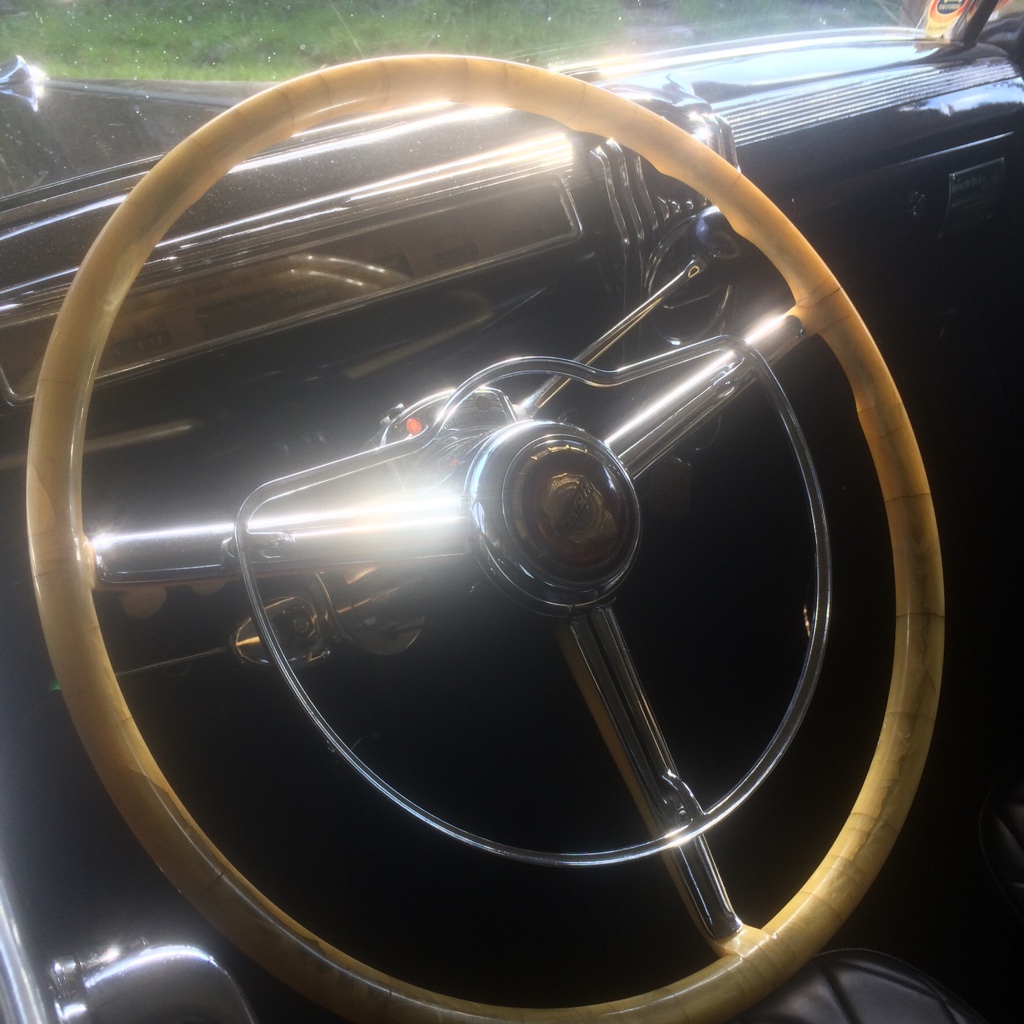

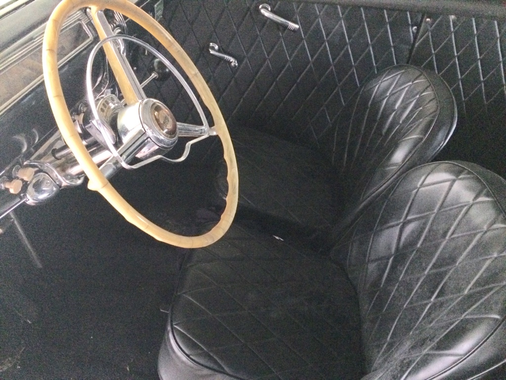

  15. Not to hi-jack the seat deal; but do you have any more pics of your dash and shifter?

    Sent from my iPhone using The H.A.M.B. mobile app[​IMG][​IMG]
    The dash is a 41 Ford and the shifter is a 53 hydramatic and the wheel is a 50 Chrysler
