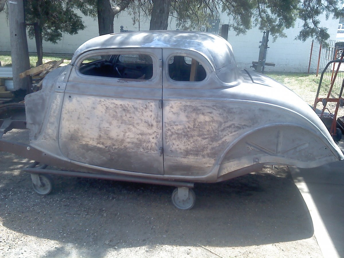

  1. I need some help finding good directions on chopping my '34 sedan. I've done extensive searches on this and other forums, and haven't found much. I've searched the net and found numerous examples of coupes but few sedans. I need examples, pics and directions. I want to do this right.
    Here she is....aint she beautiful
    the shipper picks her up early next week and I should have her by the weekend.
  2. Make sure the doors shut good and straight,body mounted solid,weld bracing to keep it true.Can't have too much bracing.Good looking tudor.
  3. Thanks Texas.........I familiar with the bracing and securing the body and the door closure. I've done model A's coupe and sedan but this is different. I need specific examples, pics ,drawings, directions......on how to do this. This is way too nice to screw up.

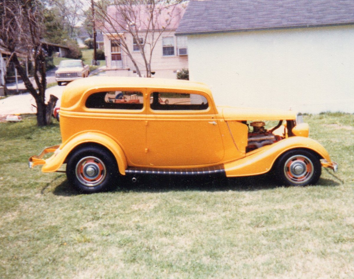

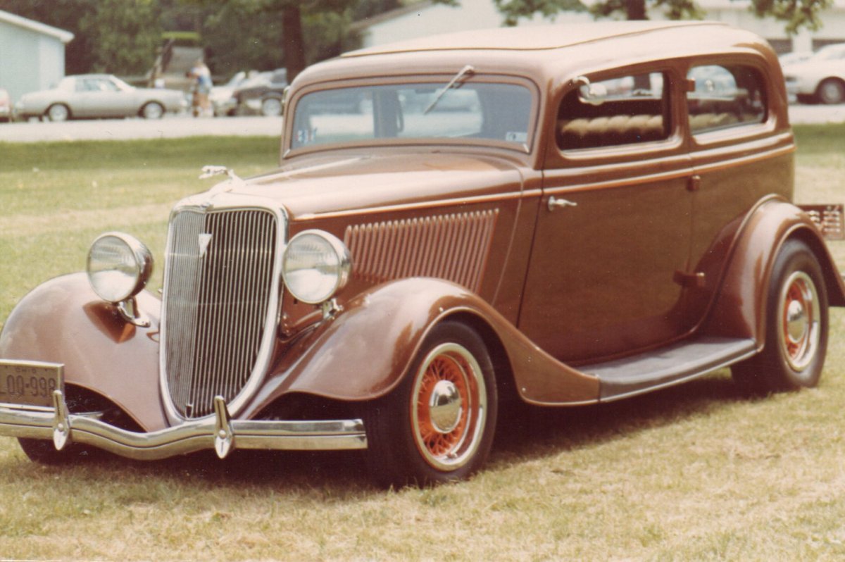

    That's a real nice looking body !! Definitely worth chopping . I chopped my brown tudor 2 3/4 on the front posts and 2 1/2 in the back. My yellow car was 3 3/4 on the front posts and 3 1/2 in the back . The reason for more in the front was the length measured on the posts is not true vertical. A 1 inch difference is a lot more than you think when chopping a top. I agree with others , over 3 1/2 inches makes the car look quashed because the top is so long. A 1 inch or 1 1/2 inch chop is so sneaky looking, I always wanted to do one like that. Also the more you chop the more work ( like splitting the top in the front and also in the back) it is to put her back together. I hope you got the magazines I recommended and that they will help you. Happy chopping . Bill

    Definitely heed this advise. Look at the dramatic difference 1" makes Ragtop's Brown vs. Yellow Sedans.
    You have a great solid Sedan to start with. I'd say cut it 3", place the top back on and have a look. You can always trim another 1/2" at a time off until it looks right.
    More is not always better on chops, especially with Sedan's. You can get away with a lot more on Coupes.
    IMHO, there's been a lot of cars chopped too much lately many times with too much angle.
    RICH B, patterg2003 and 47ragtop like this.
  29. good advice Hot rods ta hell......I like the yellow sedan chop, better than the brown. So I'll have to modify my lines.
