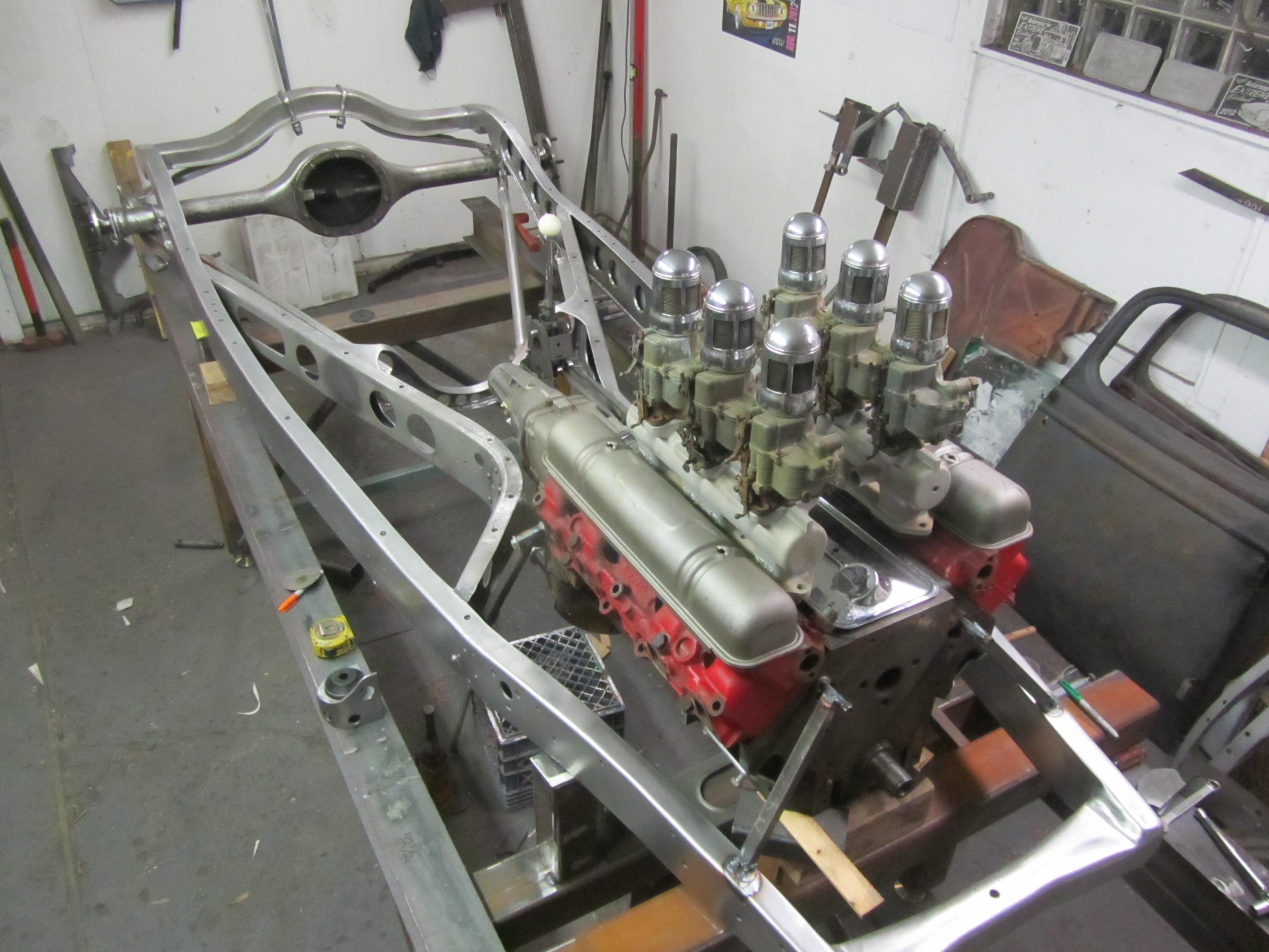

    Chassis is ready to start the motor and tranny mounts.

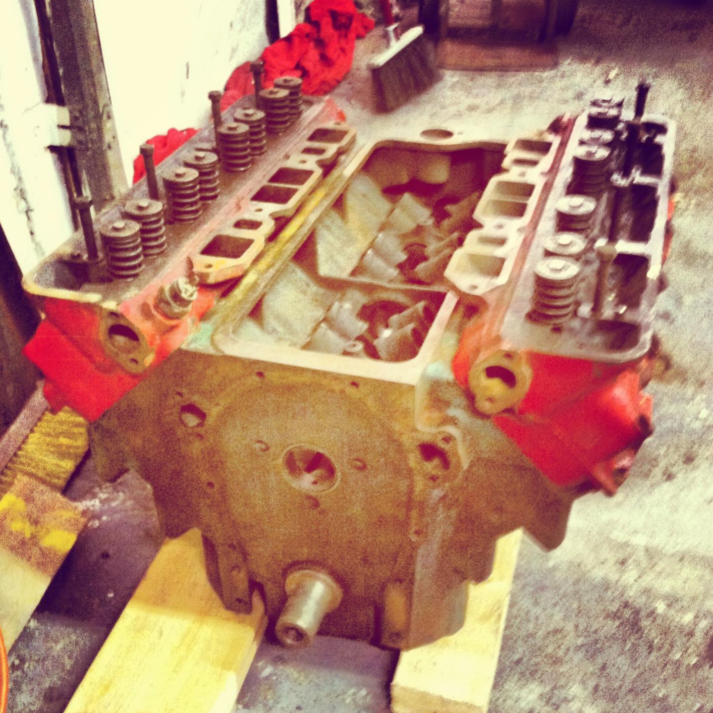

    Engine/muncie, 401?
    Cheers,
    Drewfus

    Just curious, why not use the original front and rear crossmember?
  12. donut29
    Joined: Mar 6, 2006
    Posts: 1,518
    donut29
    from canton MI
    Rear is going to get a quickchange someday and the front needed to be lower and with using a stock undropped axle and stock spring the original wouldn't have worked out

    Stroked Nailhead 486ci and a AutoGear M22 wide ratio

    Got my mockup block and trans up in the frame. Now I just got to figure out Motor mounts, Trans mount, Clutch pedal, Brake pedal, Clutch linkage and Shifter linkage should be fun packing 20lbs of shit into a 5lbs bag

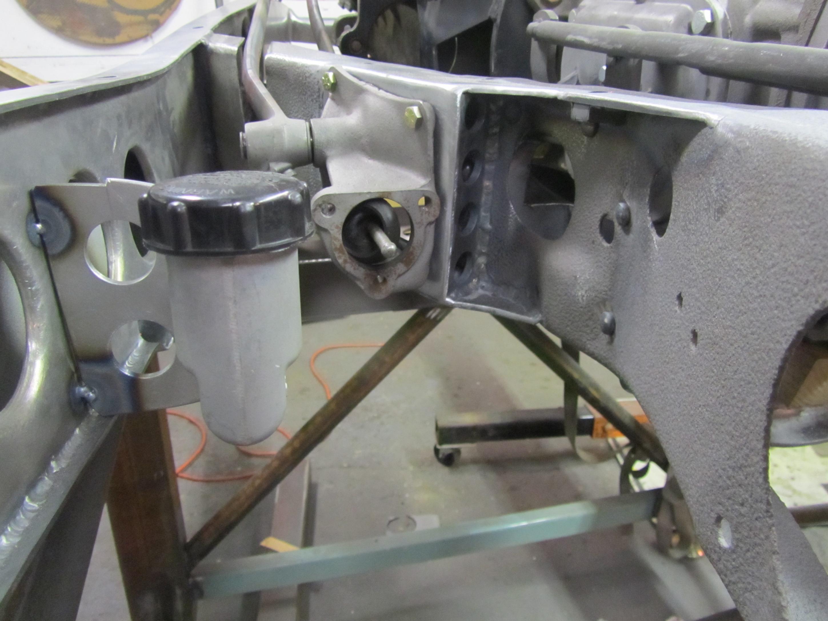

    Here's some pics of how I did the brake and clutch set up. I used what I think is a 40 bracket and brake arm with a 38 clutch arm. I still need to do some welding on it once I pull the motor and flip the frame over. I'm also waiting for some new bushings to come in before I weld the little master cylinder bracket I want to make sure It in the right spot. I plan on making some gussets for the bracket to I don't want it flexing at all. I had to cut the reshape to center x member to clear the shifter linkage so once the motor gets pulled I'll fill the hole I had to cut for clearance. The shifter is a NOS Hurst Push-Down

    Got the frame side motor mounts made tonight. I plan on mounting them down low behind the rail
    And I just had to put my motor parts on to see what its going to look like
