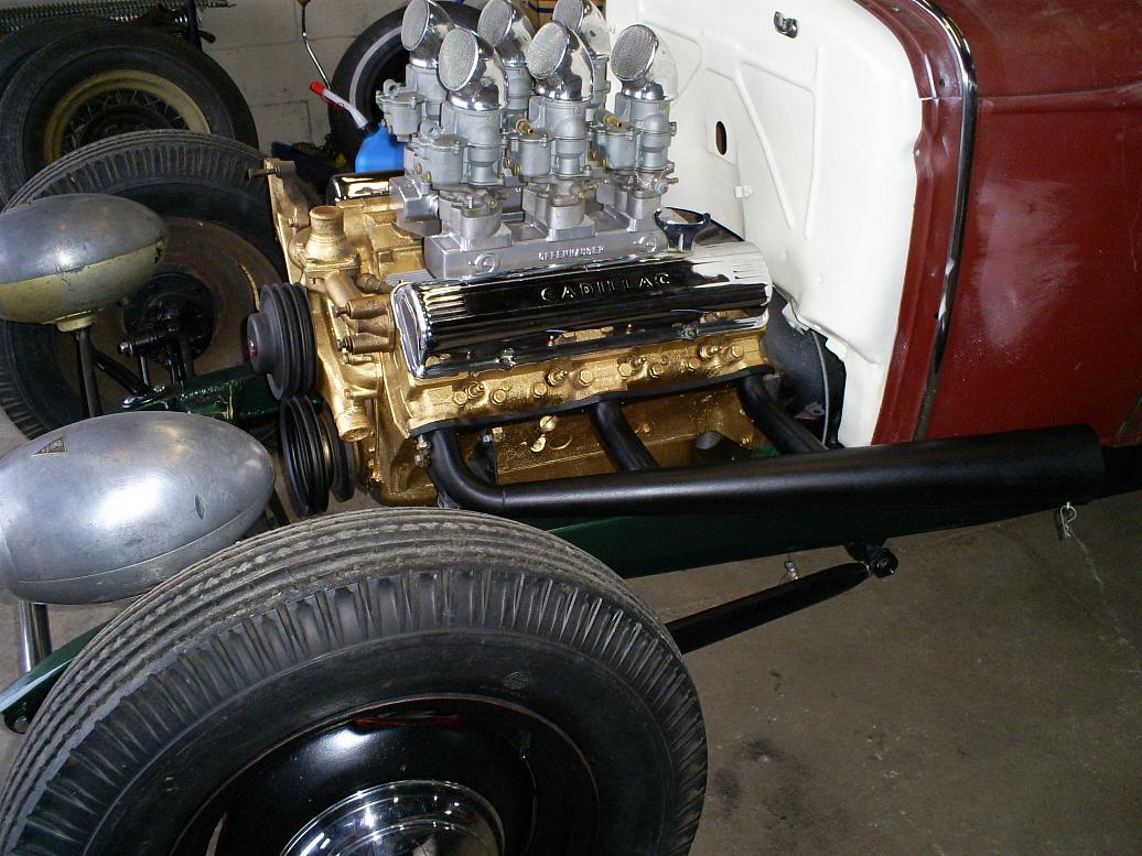

    Mine and a few friends :D

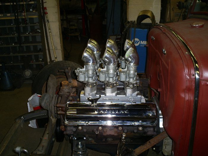

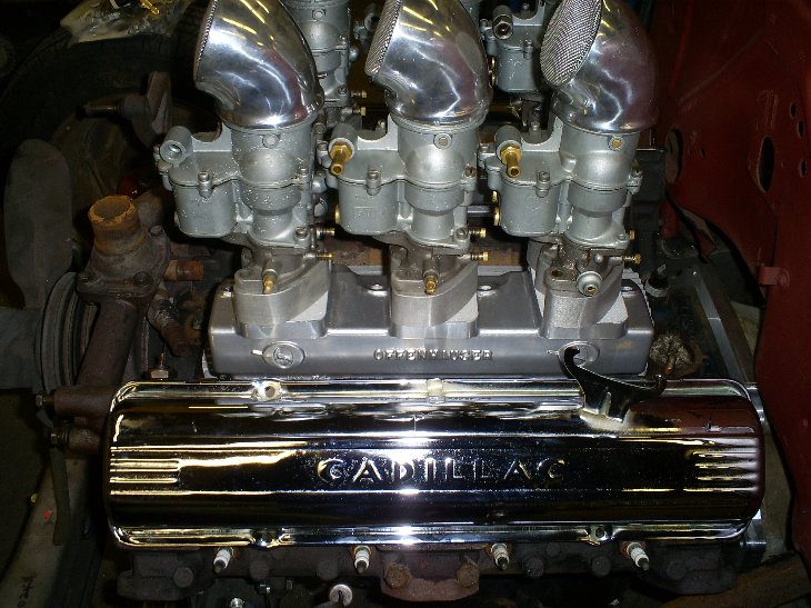

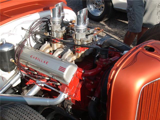

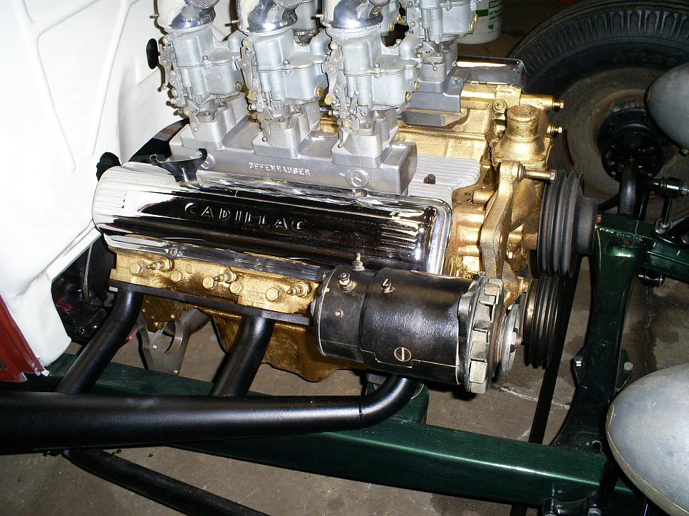

    Just to add more pics of well done Cadi Motors !

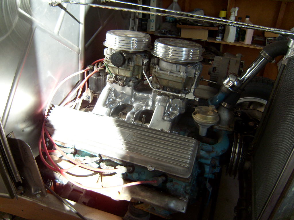

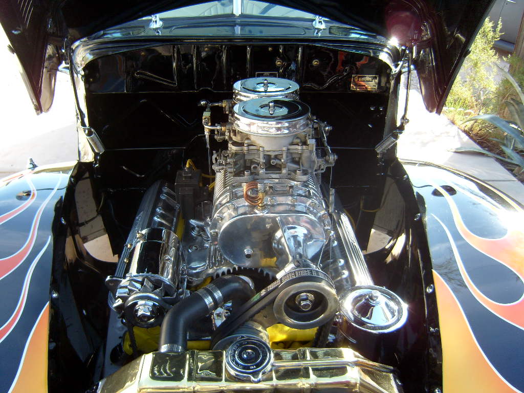

  27. A couple more Caddys, the one in the Coupe is a 53 Cad El Do 331 with a S.C.o.T. on it and the other is a 390 with dual 4s in my Roadster.

    31modelo
    Love those Edmunds VC's, the only ones woth running over the stock ones in my opinion. Thanks for the pics
  29. Your welcome!! Thats and Edmunds intake too.Dave
