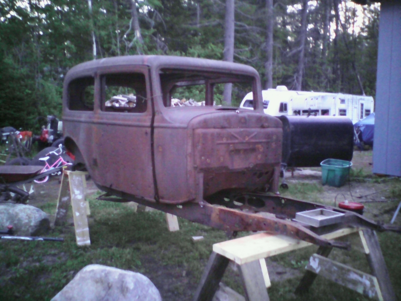

    just thought I would post some on my 33 Teraplane I'm building. There was not a whole lot to start with. Made lower patch panels by hand with plywood bucks to shape them. I chopped the top 2 inch's. IMG_20150620_182826.jpg

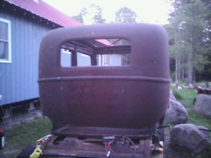

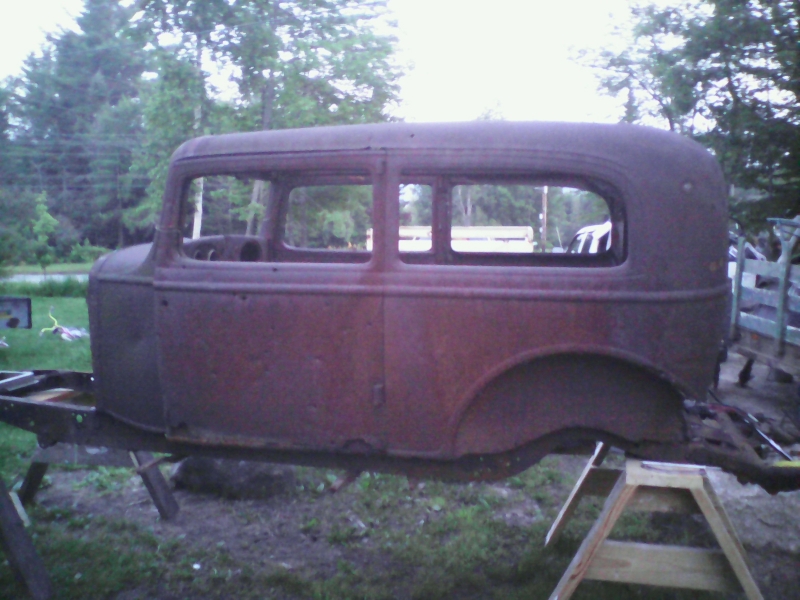

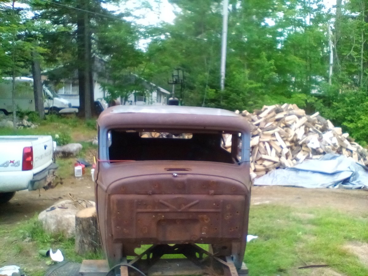

    here is a pics 2881_output.jpg 2880_output.jpg 2882_output.jpg befor i did anything

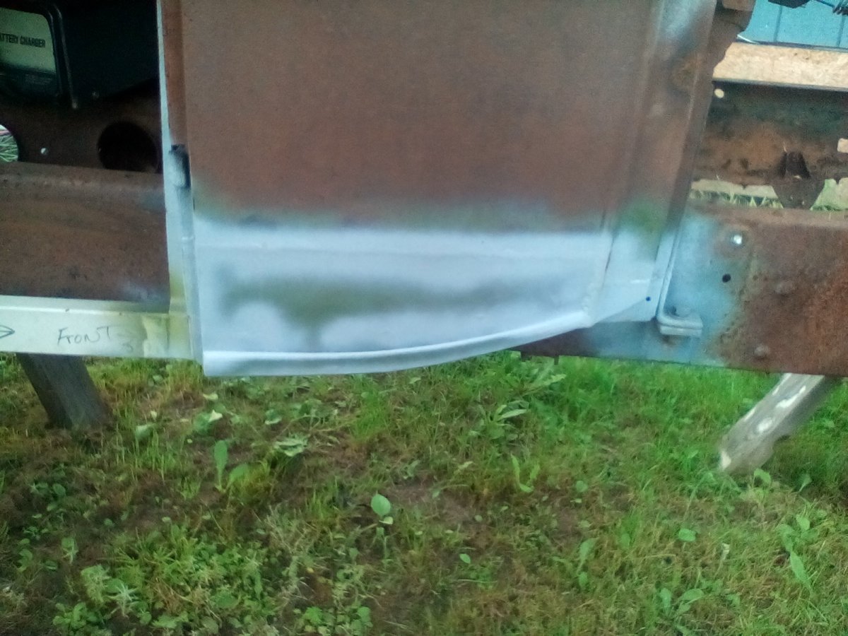

    Hear are pics of plywood bucks and pic of panel made from buck. First will be lower cowl panels. Lines are for switching left or right . IMG_20150826_171842.jpg IMG_20150826_172159.jpg IMG_20150826_172144.jpg

    Thanks for the pictures very interesting . How did you make the beveled edge on the buck and what did use for a tool to pound into the recess ? I am thinking you made your own by grinding a piece of stock to fit in the recess. Did you use 18 ga for your patches ?
  27. 33essex
    Joined: Aug 21, 2015
    Posts: 171
    33essex
    I used 20 guage theres not much difference between 18 and 20. The 20 guage takes much better to shapeing than 18 guage. What I used for shapeing was a 1 inch wide by 1/2 inch thick chunk of flat stock. I rounded one end.I also used a peice of the same flat stock that had been beat into a nice curve shape. I will have to look around for them and I will take pics. You have to slowly work into shape. As far as a bevelled edge there in not one. The pic for some reason makes it look like there is. Also the metal is screwed to the buck for shapeing to hold I place.
