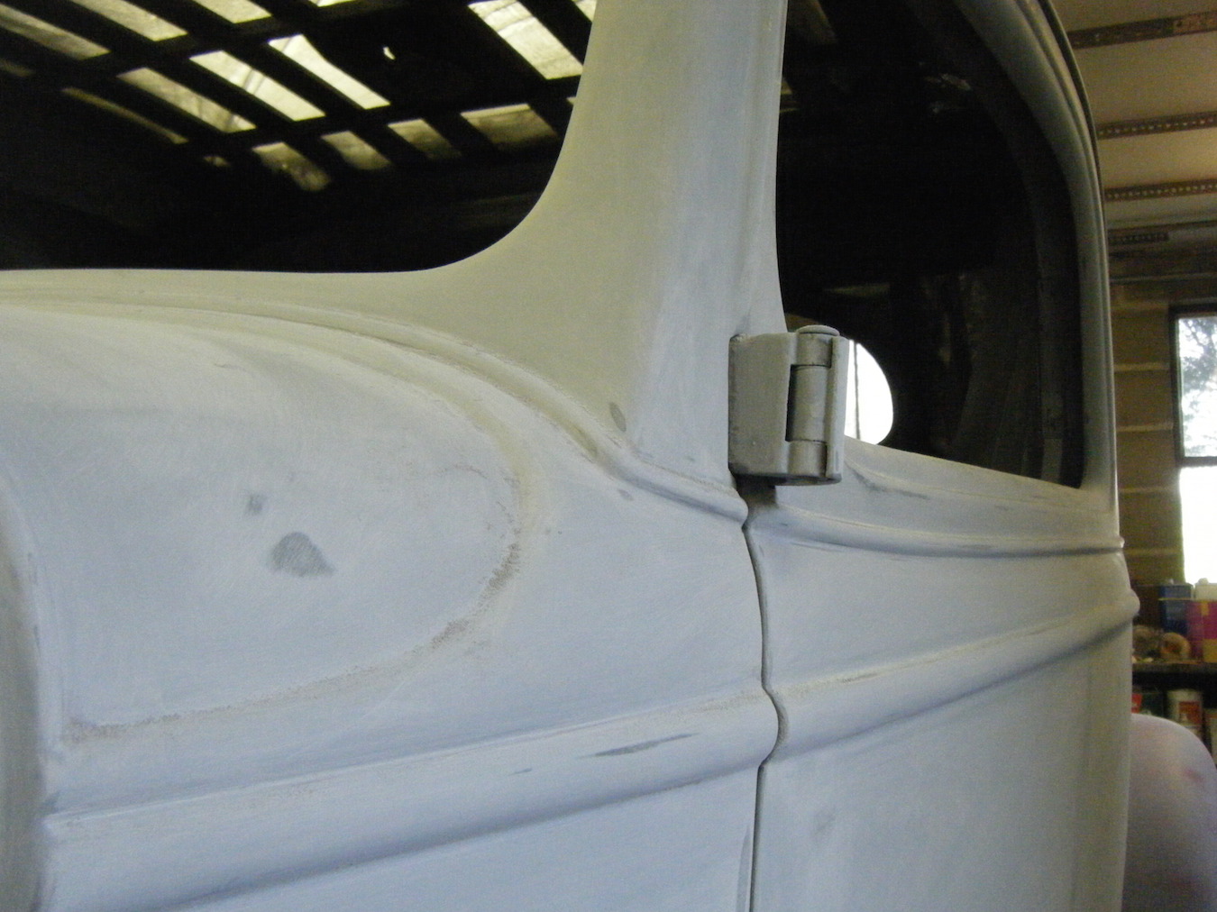

    finished sanding the body and running-boards, had a hard time making time with family picnics, mothers day, mowing my dandelions......

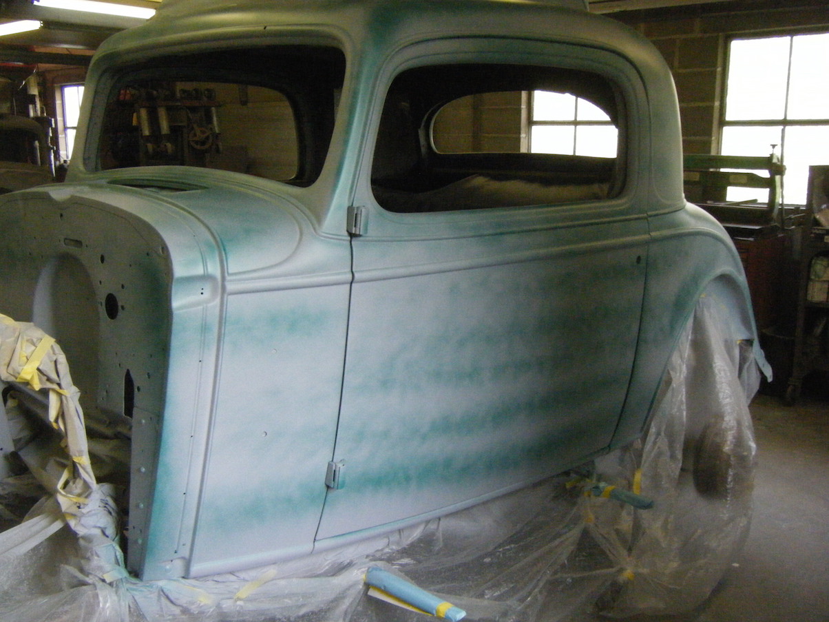

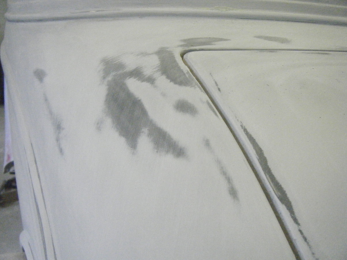

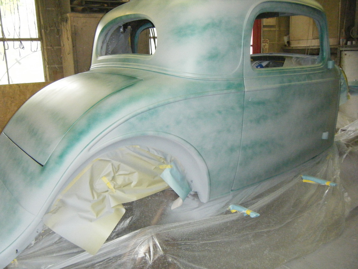

    final coat of primer on the body with a green guide coat. DSCF3960.JPG DSCF3961.JPG

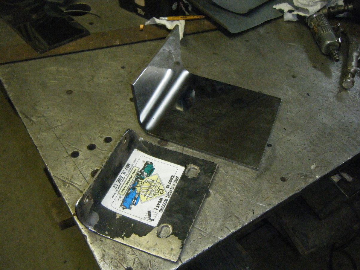

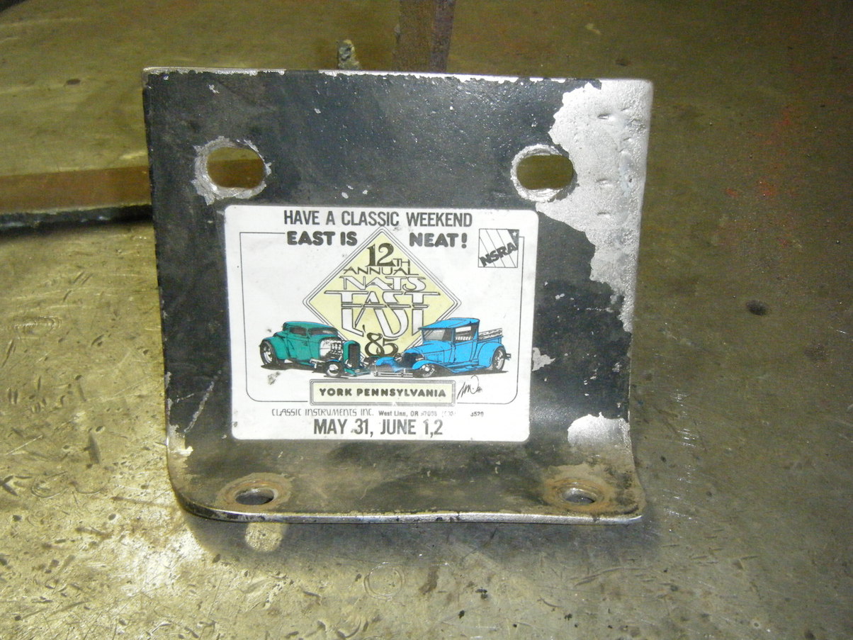

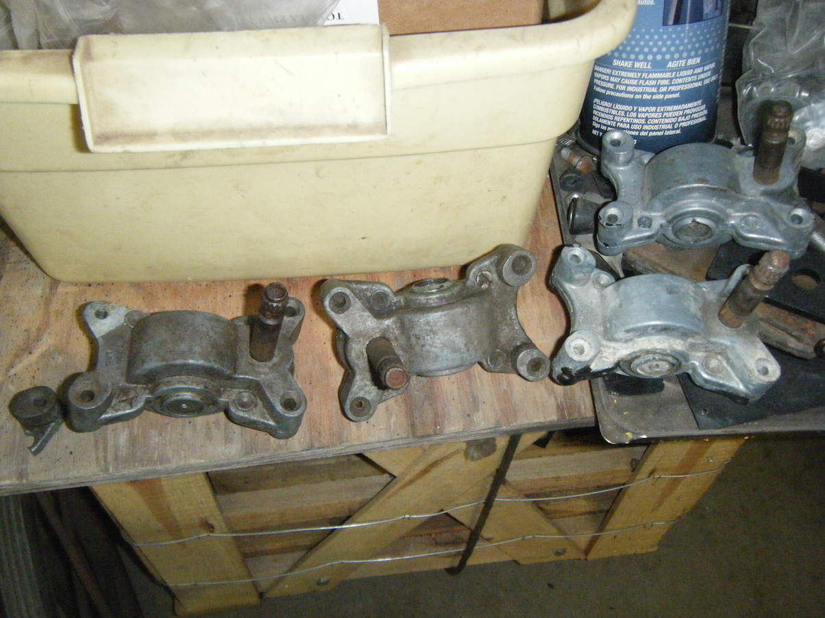

  11. my dad had made a bracket to mount the generator up over the valve cover. it bolted to the header but moved the generator inside the hood. he bent a piece of plate and then had it chrome plated. i had switched over to an alternator and at that time the chrome was rusty and flaking so i painted over it black. i decided to make a new bracket out of stainless and polish it to look like chrome. DSCF3965.JPG

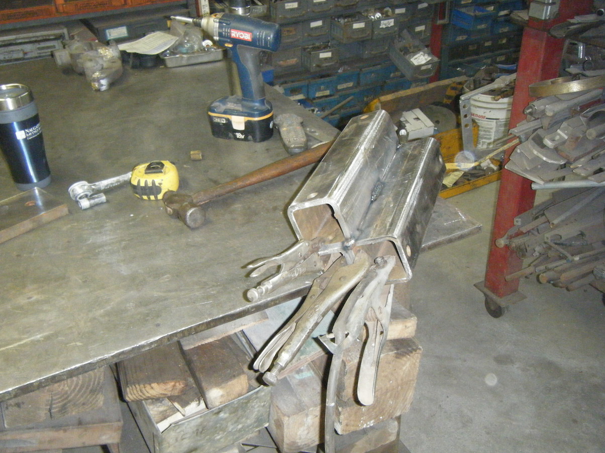

  12. to bend the stainless plate i decided to make a tool for bending steel in my hydraulic press. i started with some scrap pieces mallomike took out of his scrap pile at work and an old piece of a international A two way plow. I welded the square tubes together and capped the ends with a thick piece of bar. i then welded a rod to the top of another piece of bar and welded the tractor bar across the bottom. DSCF3962.JPG DSCF3963.JPG DSCF3964.JPG

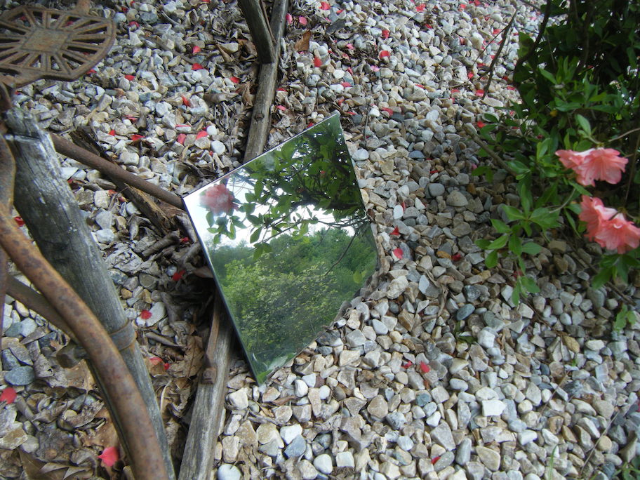

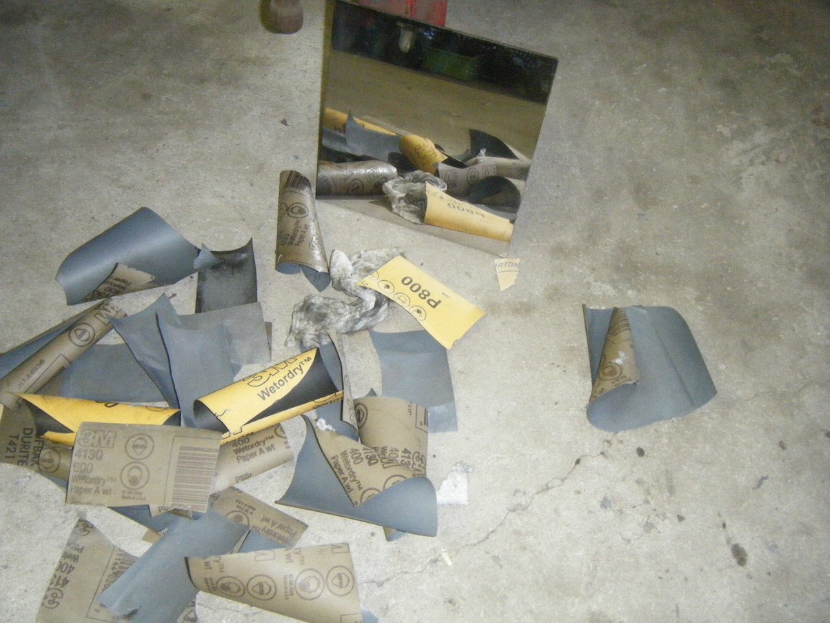

    today i started with the chunk of ss plate, it had a "sanded" looking texture so i sanded it with 180 grit, then 320, then 400 then 600, and finally finished sanding with 800 grit. a quick buff and it looked like a piece of mirror. DSCF3970.JPG DSCF3971.JPG DSCF3974.JPG
    falcongeorge likes this.

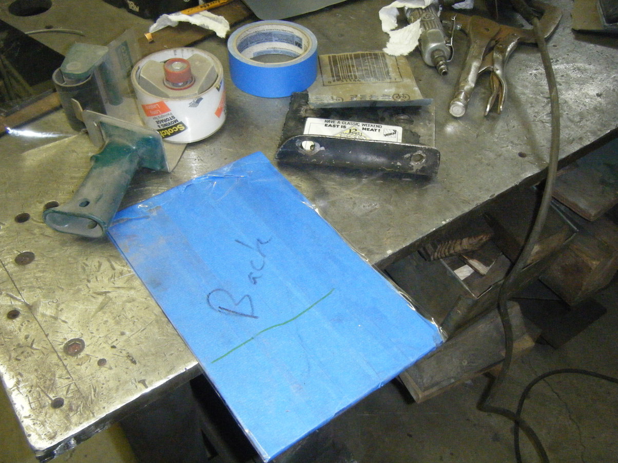

  17. i then cut the piece to width and covered it with blue tape and packing tape, then stuck it in the new press. it is amazing how easy it bends this 1/4" ss. once the holes are drilled and it is trimmed, it should look like it did in the magazines. DSCF3981.JPG DSCF3982.JPG

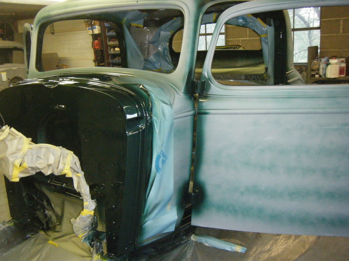

  18. i also sanded the jambs and edges in preparation of some color.

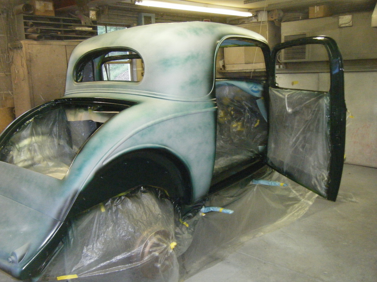

  21. '55 caddy arlington green! this is the color my dad and uncle painted all their cars; DSCF3983.JPG DSCF3984.JPG

  22. That is the color I remember!:cool: I can't wait to see it all painted. Makes me want to go out and get a 49 rag top!:cool::cool:

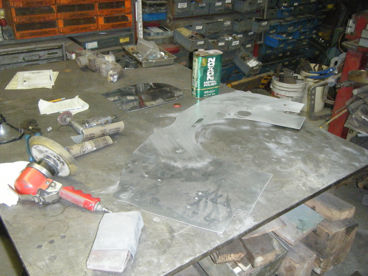

  26. Color looks great! Sorry about the mexican wrestler, I just really like your car.:)
    tb33anda3rd likes this.
  27. Looking forward to the outcome! Love the color choice :)

    Not a big green guy, but damn that is really really nice! Now for the shinny firewall. Will be watching.
