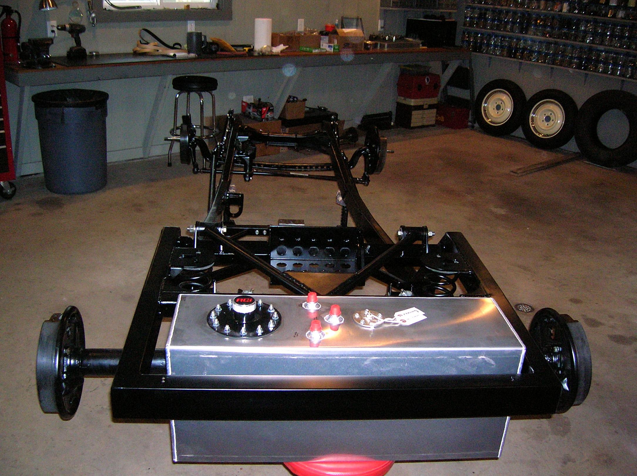

  3. DSCN9131.jpg DSCN9133.jpg More pics, 15 Gal. RCI fuel tank, new rear end, got rid of the 3.70, went with a 3.08.

  26. DSCN9303.jpg DSCN9271.jpg Update on the chassis: I've rebuilt the front spring mount, 41 cross-steering box, brake pedal assembly and brake lines. I've modified the tranny x-member, moved the rear springs back 1", mounted the new RCI fuel tank and red Holley pump. I'm now waiting on the TH350 tranny from the shop. The new 322 Nailhead is finished, waiting on Steve Wenzel (Mankato, MN) to dyno it, should have it in a few weeks. Looking forward to Back to the 50's, MN Fairgrounds, June 20-22.
