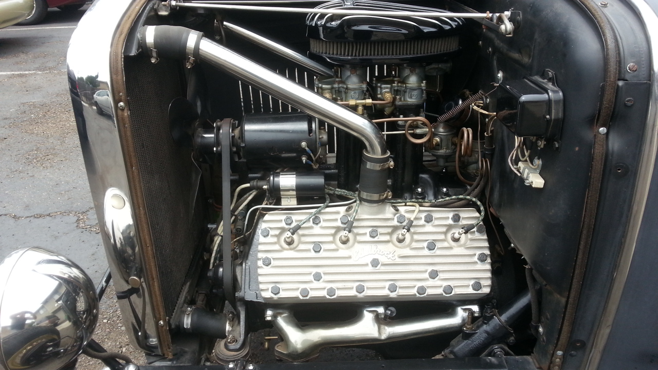

    Starting a thread not as a build thread, but as a place to document my progress to help keep me motivated. I bought this complete 1930 roadster in the fall. Been picking at it over the past few months doing what I can, picking up some parts, getting some work done by others. 59ab flathead with some speed parts, 39 trans, stock model a rear. 16" KH bent spokes. Chopped top and windshield and fancy interior
    I fell in love with the overall look of the car and the reason why I bought it, but some of the mechanical things I felt could improve upon. Nothing against the original builder or previous owner, just making mechanical upgrades to suit my tastes as time and money allow. I do what I can and call in the ringers when needed.

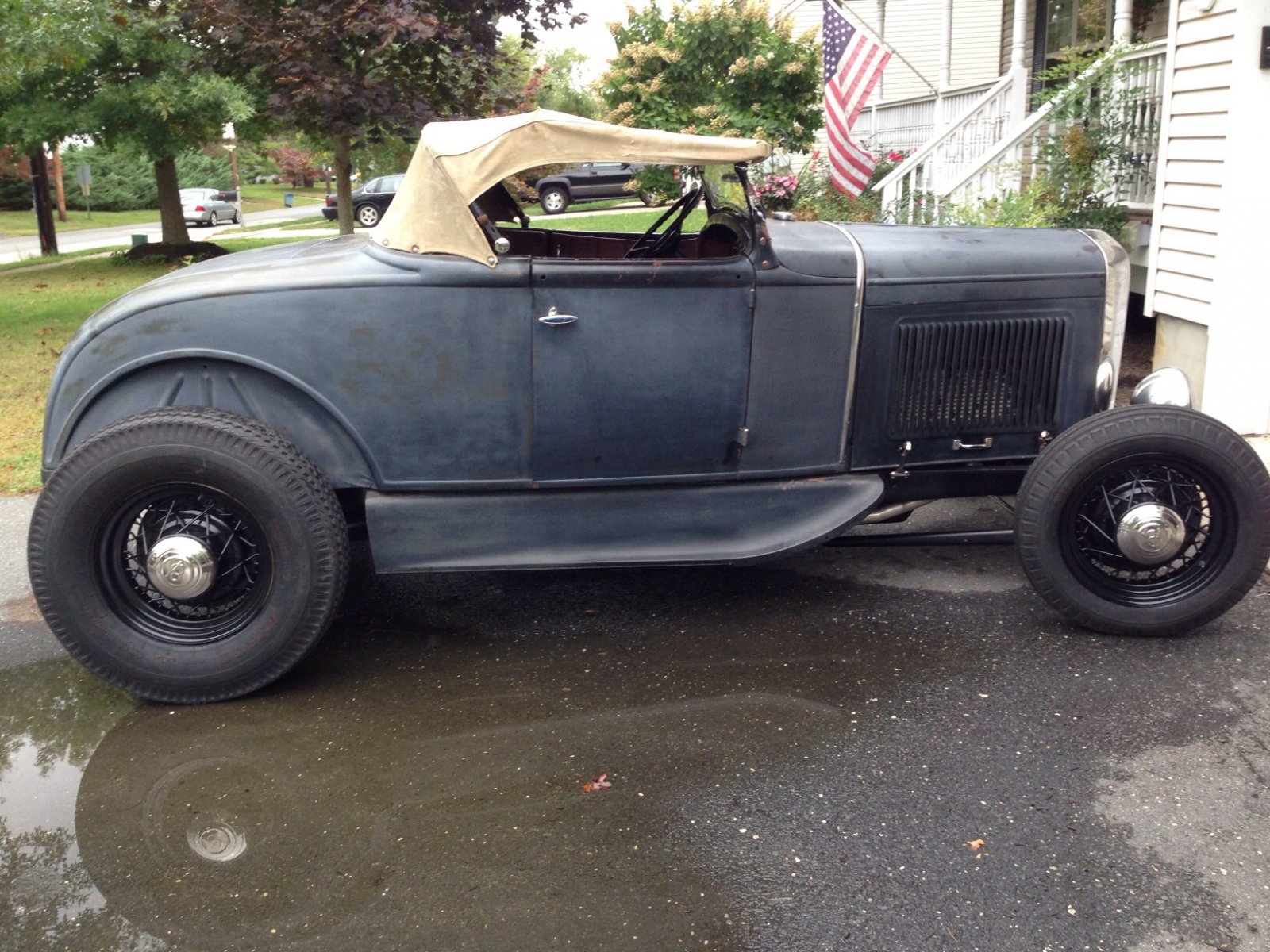

    Bought the car for the look. Not changing that at all. Top and splash aprons sold me on the car.
    So I got the car a week or so before trog. Yellow wheels and trim rings attracted my eye too much so I painted the rims black and put the trim rings on the shelf.

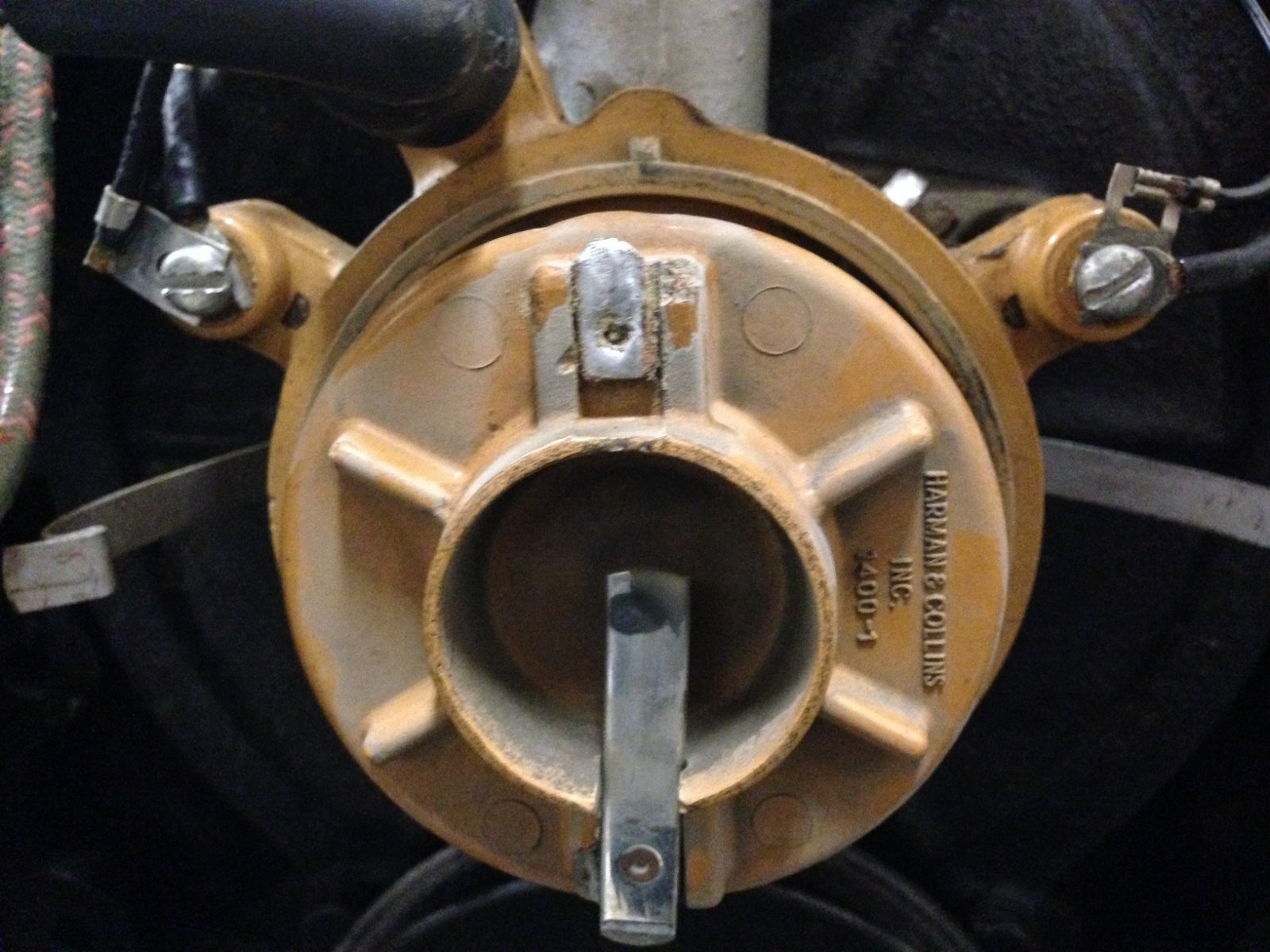

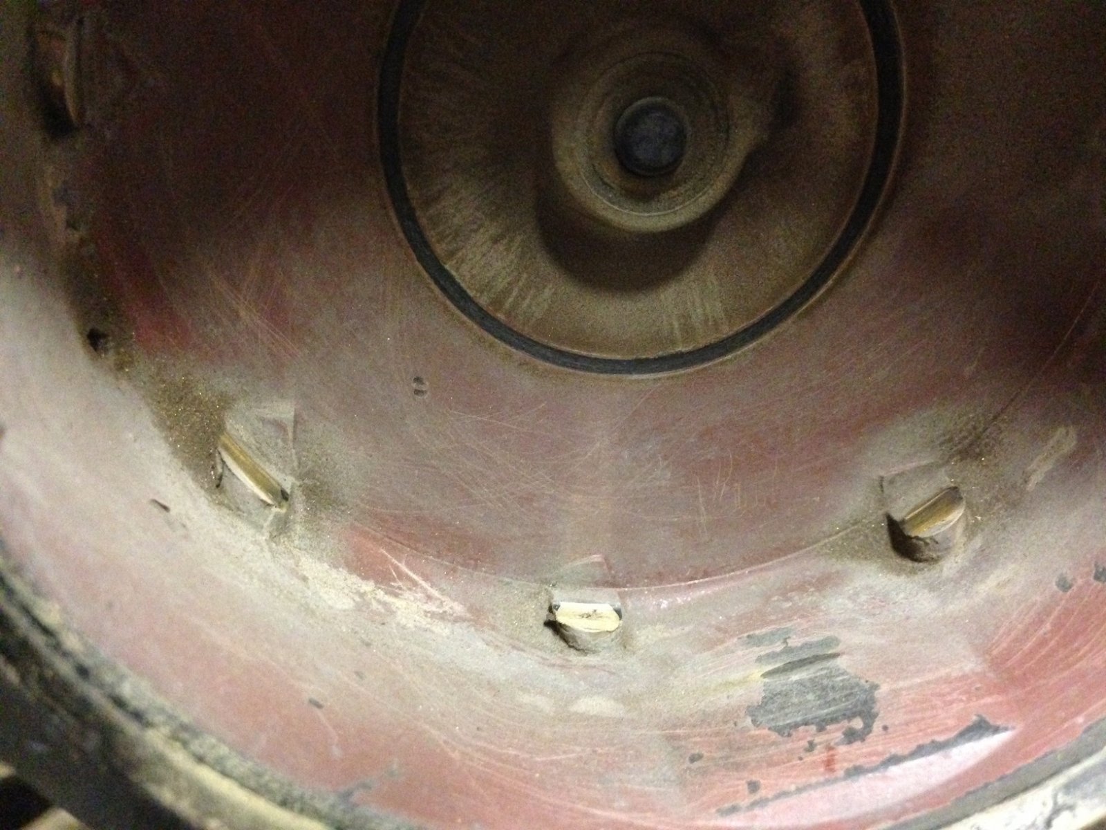

    In the fall brought the roadster and sedan down to The Race of Gentlemen. Had a great weekend but the car just wasn't running right. Valves were real loud and it had no power. Got home and started looking into it. Car came with Harman Collins dual coil distributor and was only firing half the cylinders. Tested the coils and condensers by switching them between sides but the miss was consistent. Got into it and the rotor and cap were shot. Vintage "speed" parts make the car slow when they are broken.

    Ordered up a GMC Bubba rebuilt stock distributor. Put it in, changed the firing order back to stock and she fired right up and was much better. Has plenty of power and I think the noisy valves were due to the cylinders not firing. When I have all the parts to rebuild the Harman Collins, it will be going out to Bubba for a full rebuild. I have his distributors in both my cars and couldn't be happier with his products. Sorry, no photos of it, I was too excited when it got here that I put it right in.
