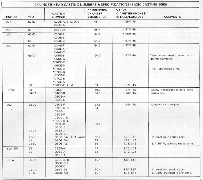

    I went with 1.94/1.60 valves 10.5 cr and 54cc comb chambers. I kinda had a piston valve clearence problem.
    All cleared up with a thicker Fel-pro head gasket.
    try and check out this book..How to rebuild your small block Ford...it is buy HPbooks
    I referred to this book when i looked for blocks and heads to combine..check out page 28. Barnes and Noble has them still.
    69-70 C90E-B,D castings 60.4 cc's
    1.84/1.54 valves. stock setup. Remember this when using stock valve relief pistons.
    I used these heads and had them shaved and didn't need to shave the intake manifold.
    but hey each can be a case by case basis.
    plus this book has a very detail compression ratio/cylinder head interchange chart.
    With bigger valves added 1.94/1.60 and one helluva port job my 306 pumped out 396hp and 398 .lbsTq. It would run 142 mph at Willow springs on the road course after 18 years of life. Turning 7000 rpm with upgraded balancer and aluminum flywheel.

  4. the 69-70 351 heads used to be the best, milled .060 they were good. the 289 heads will give you a smaller comb chamber= more comp.,but all the machine work will = the cost of a pretty good set of alum heads, esp if you shop. still want iron heads, go with the late model gt-40 heads. they work well.much better than any of the other factory heads.just my experience.

    If you're dead set on running stock early heads, I'd look for:
    69-70 351W heads (biggest ports & bigger valves)
    71-74 351W heads (same valves as 69-70 & slightly smaller ports, but bigger than 302)
    69-70 302 heads (the ones with the heart-shaped combustion chamber)
    Any early 289 heads for the chamber size (but you'll have small ports & valves w/all that CR)
