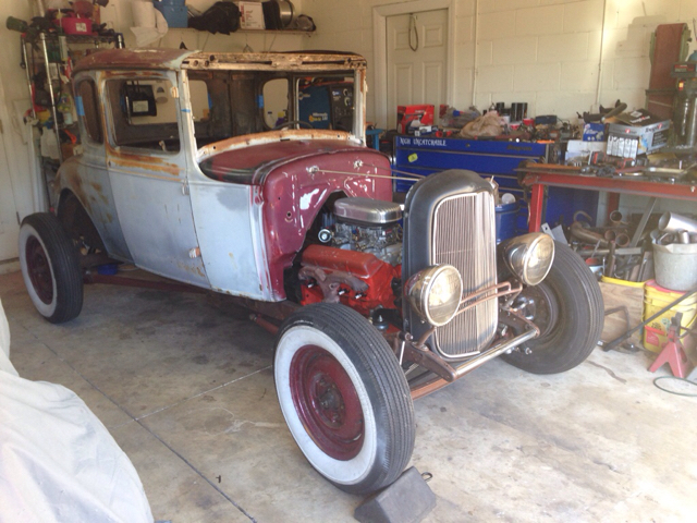

    IMG_2086.JPG My dad is 73 years old and has built more hot rods than I can remember. As a kid growing up he took me to car shows and the drag races regularly. Together we have built everything from full out drag cars to all kinds of hot rods and muscle cars. He taught me there is nothing wrong with diversity . This build will be themed around a late 50s car that he would have built if he could have. We picked this car up on a Craigslist ad . A lot of work has been done , but some of it is crude ,so we will refine it a bit , but remember this will reflect something built in the 50s in a home garage. There will be some aftermarket parts but mostly it will be stock or modified original parts.

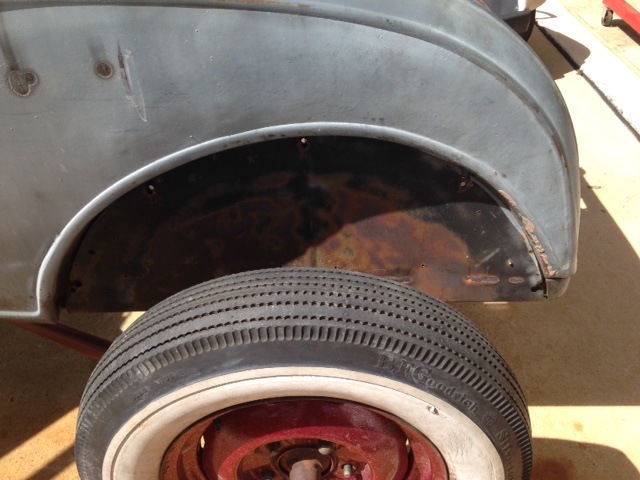

    IMG_2101.JPG As I said there are some crude repairs done. Someone thought it was a good idea to just screw the new wheel well onto the rusted out old one. They did this on both sides

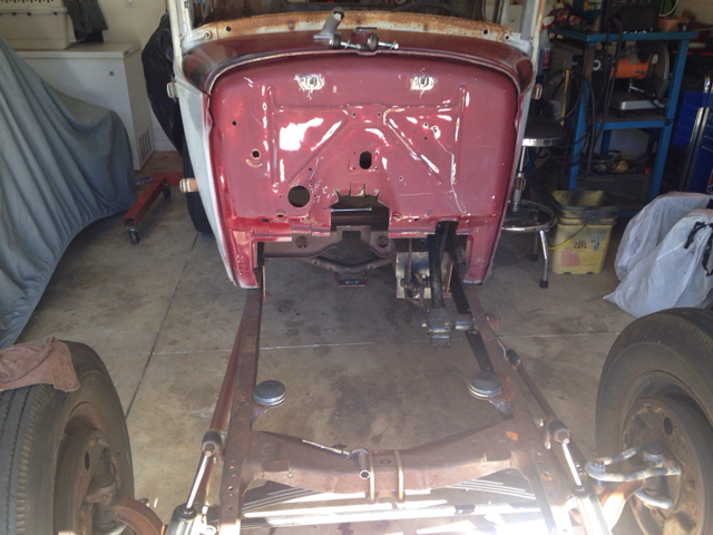

    The firewall is more work that needs to be addressed. The pedals are 40 ford .steering looks to be 50s ford truck.

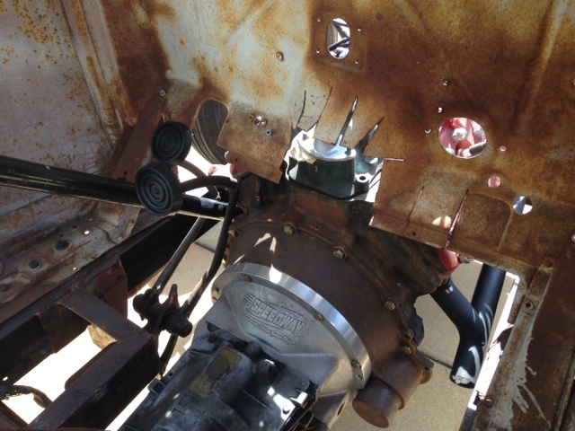

    At first I was gonna flip the firewall but changed my mind because it was all jacked up by the prior owner in order to get the merc in . So I figured I'd just recess it
    Used a hurst mount I picked up at a swap meet a few years back. I didn't even need to move the frame mounts for the flathead, which was a time saver
    A little tight on the fuel pump but nothing I can't fix easy

    Going to have to recess about 3.5 inches which is pretty standard

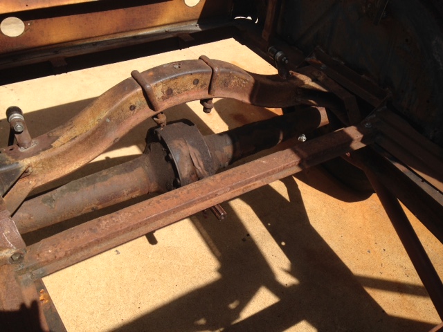

    Still need to work on the transmission crossmember. It's close but it has the engine angle all wrong. The rear end will need attention as well , whoever installed it has it about 4 degrees up at the pinion. The clutch/ brake pedal mount is too far forward , should be an easy fix too. I'll post more as we go. Thanks for looking.

    Edit. Changed the name of this thread because my son was born on October 25th. He was a huge part of our shops success , he loved hot rods of all kinds Unfortunately we lost him in a car accident 7 years ago when he was 19. My dad dedicated the number on this car to him. So it's now the # 25 coupe.
