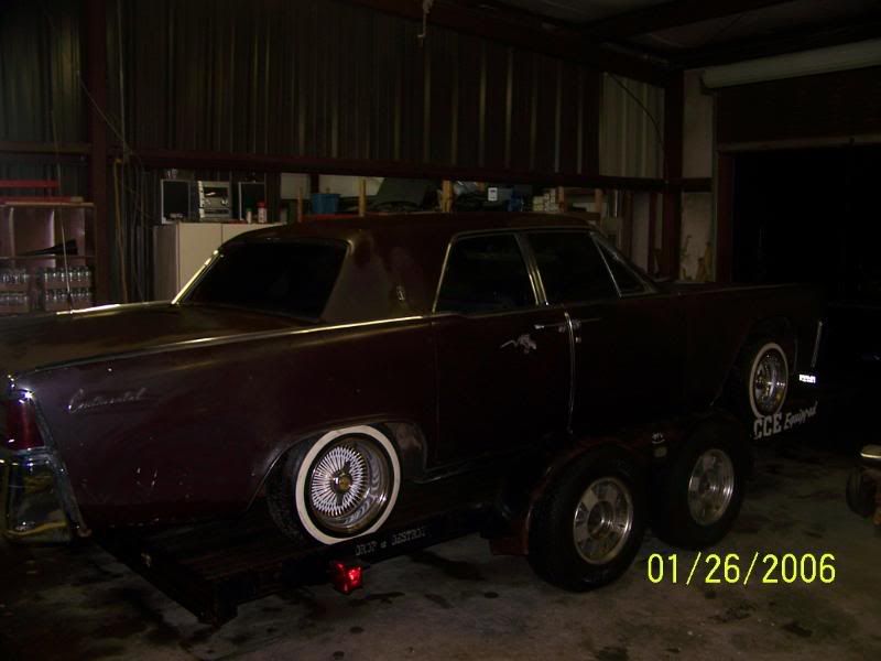

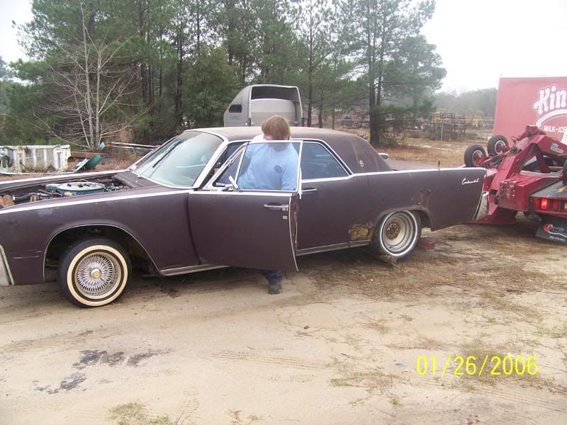

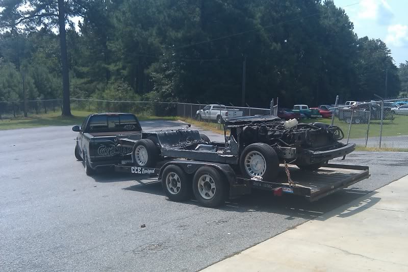

    now I found that car like that in early 08 heres the description of the pickup:
    picked her up today! put some knockoff wires on it so I could get it out of the dirt and load it up, while it was jacked up I got a good look of the underside, wich is very solid, no rust through, full exhuast still intack and no driveshaft wich is another thing im not worried about. Got it rolling and my freind came and helped me out (hes the REPO man) he used his snatch truck to pick it up and push it up onto my trailer with the greatest of ease, the next 2 1/2 hrs was spent trailering this beast back to the shop wich was only 70 miles away, but we had stupid torrential monsoon craazy storm today and it stuck with me all the way there, 45 mph tops....IKK! so here are some pics of today, more will follow durring teardown and work!

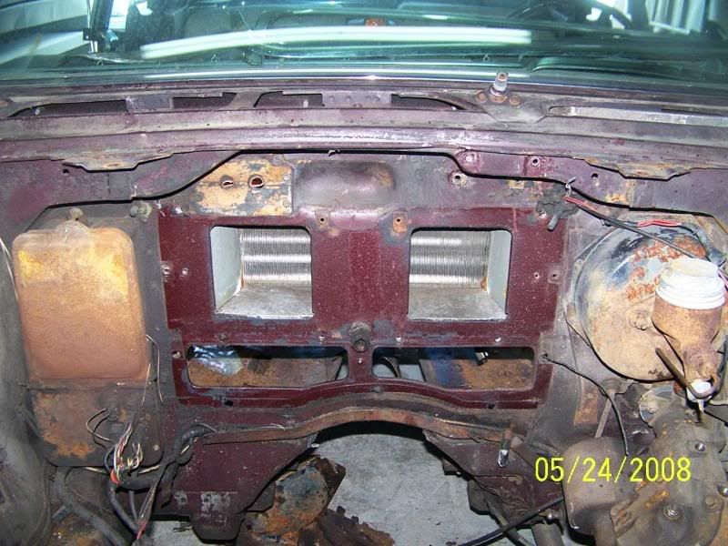

    so next.... onto the ac! and wiring box!! got those ripped out and a good thing to... MAN the inside of the ac box was NASTY! omg like influfreakinenzablackplauqe up in there! ewww city! :dpuke: then I got the elec box off... horry for lincoln enginers!! who decided that putting plug ins on the back of the box instead of having every wire in the whole car made into the fuse panel!! :smt006 Also the ac box is not going back in, going nice smooth firewall right there.....Vintage air or southern air for AC later.
    then I busted out my mini mite 3 inch side grinder with 36 gritt roloc pads!! and got crazy! :shock:

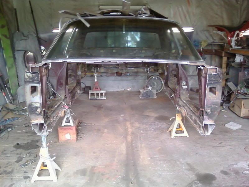

    and he we are working on putting the the halves together, we had to finish up grinding the surfaces on the 99 and trimming some metal out around the A piller and the top of the cowl so the windsheild will sit flush.
    all and all we had it up and down about 20 times it took us only about 5 hours to get from two parts to one
    here is where we used a porta power to stretch the 62 wider to fit over the top of te 99 inner rocker as it did a .90 out and a .90 up once stretched open we could set it down all the way and when the pressure was released it snapped tight under the edge and fit perfect
    here it is sitting together all on its own

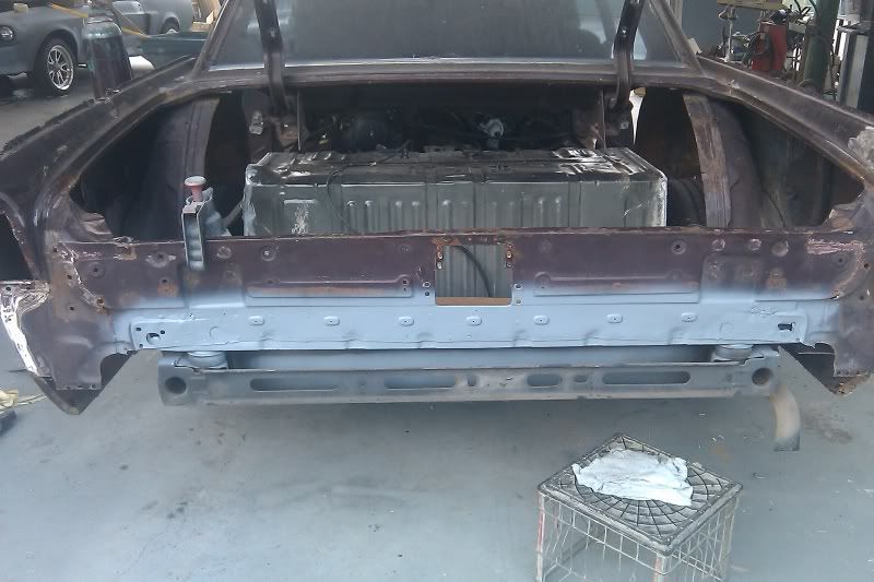

    here is the rear body panel area the 62 lapped the 99 body panel reinforcement perfectly enought to punch in some spot weld holes and firmly weld up the rear body panel, there is a few welds needed to be completed on it but for the most part its done.
    this is the body panel trimmed over the 99 panel notice the frame reinforcement of the 99 below overything. went ahead and welded it up after spraying weld through primer between the panels.
    had a bit of left over primer from a job so I sprayed it to cover it up right now but the back is nearly finished except for some good seam sealer

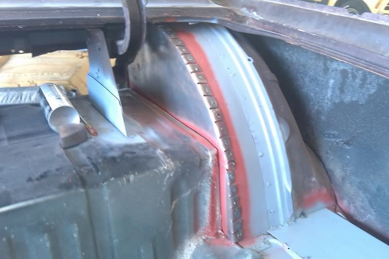

    now it was onto the back deck trunk reinforcments I only have a small amount of 16 gauge for the heavier stuff I need for this car
    bent up my brakets with my little trusty sheet metal break
    hole punched my spot weld holes, weld through primed them down both sides and welded it up
    solid as ever!

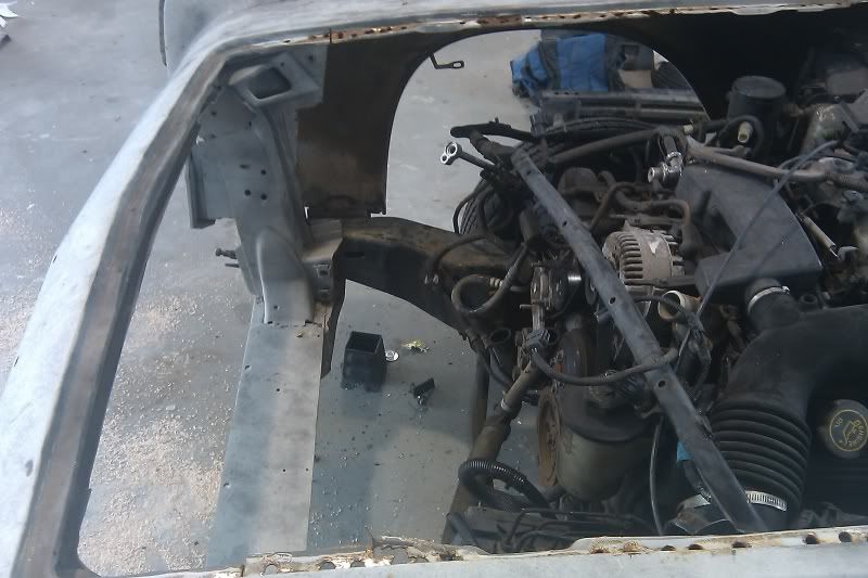

    I had a hour after work friday and decided to see how bad the front end will have to be modded to make work so I went to town on the front of my car. Now this by no means is nothing more then just a mock up right now I want to get the main body and the suspension doen before I get to the front.
    first I had to cut the front cross reinforcement off the 99 frame and notch alittle bit of the frame to make the front of the 62 slide in.,
    heat saw at work
    then I slid the front end on and clamped everything together to see how everything fit
    I got tons of room to put my radiator/condensor and fans back infront of the motor, plus some other stuff...lol

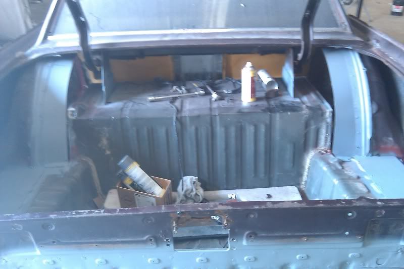

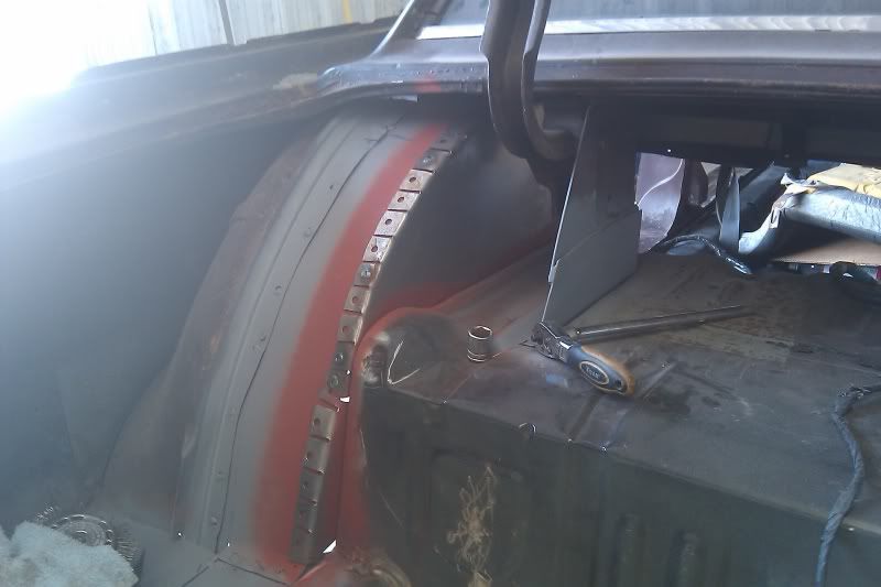

    still working on the trunk making the filler panels came out looking good and everythign fitting tight
    here is the inside tubs, I dont have a metal shrinker so I had to do the next best thing but since it will be all seam sealed up the finished product will look like anly factory job ;)
    here is the rear seat BOLTED in to test fit the front tubs wich cant be straight up and down but curved so that presented a problem first here is the seat
    ahhhhh yeaaaa beutifull!
