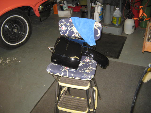

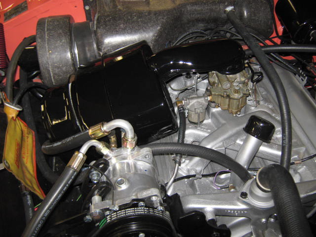

    Mark, OLSKOOLRODDER, came by this afternoon and did some polishing on my air cleaner. It had lots of orange peel before, but it is smooth and shiny now. Thanks Mark.
    desoto work 239.jpg desoto work 240.jpg desoto work 241.jpg desoto work 238.jpg

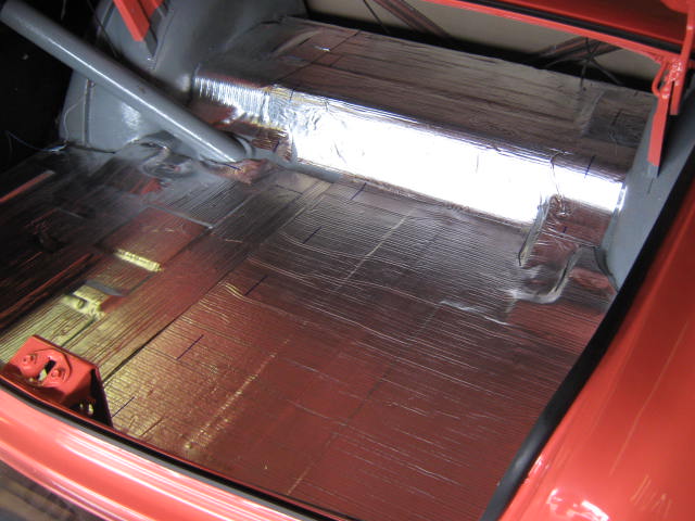

    The upholstery shop is moving along on the Firesweep. They have the dynamat all installed and also the interior carpets are installed. I also mounted my old DIXCO tachometer that I had in my first Firesweep back in '62.

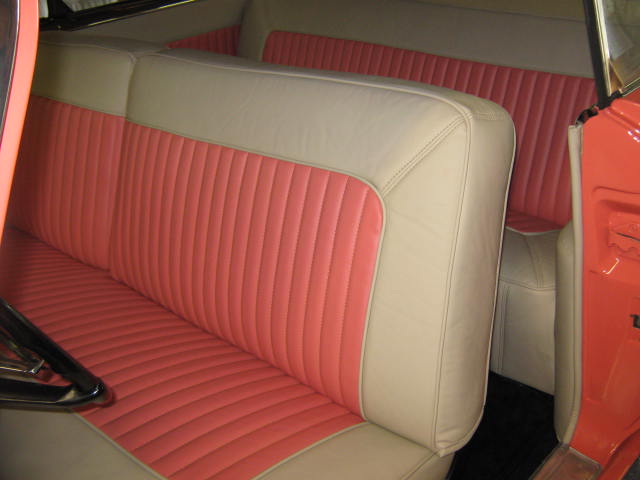

    The upholstery work is just about done. They still need to make a cover for the spare tire and cover the lower portion of the trunk hinge mounts with carpet. I'll pick up the car in the morning. I attached some pictures below.
    desoto work 261.jpg desoto work 254.jpg desoto work 255.jpg desoto work 256.jpg desoto work 257.jpg desoto work 258.jpg desoto work 259.jpg desoto work 260.jpg

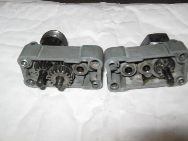

    Finally got around to correcting the speedometer error I was having. It was showing 90 MPH when I was going 70 MPH. I had an old S-W speedometer gear box, but the gear ratio was wrong. It was 1.202 to 1 unit and I needed to slow the reading down by about 20 percent. I ended up taking the S-W box apart and reversed the input and output gears which were pressed onto their respective shafts and also flipped the idler gear over and ended up with a gear box with around a .8 to 1 ratio. I installed the gear box between the speedometer output on the transmission and the cable that runs up to the speedometer. It landed right on the money; 70 mph on the GPS and 70 mph on the Desoto speedometer. Happy days...

    I had changed the tires and they were not the same diameter as the originals. Changing the third member gears will also do it, but I think the 3.54 to 1 gear set installed in the car is stock.
