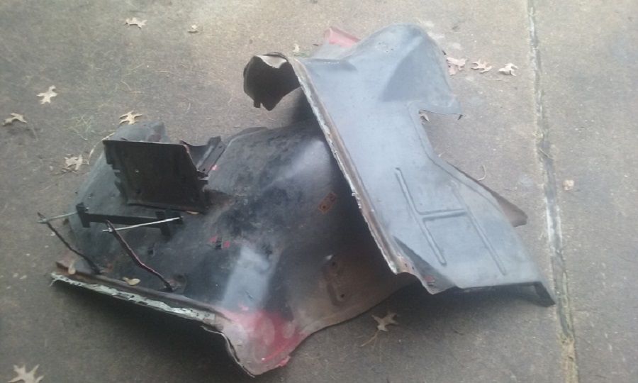

    Back to work on this thing, took out the inner fenderwells and moving battery to trunk so taking some weight off the front end. Bought sub plates, headers flanges, pipes and collectors and building a set of fenderwell headers. Will be 1 7/8 off the head than stepped to 2", these 1 5/8 headers aren't helping much. Moving up to a dana60 as well and taking out the 8.8 explorer rear before my next engine top end combo goes on.. I need to rewire under the hood now also taking the fenderwells out.

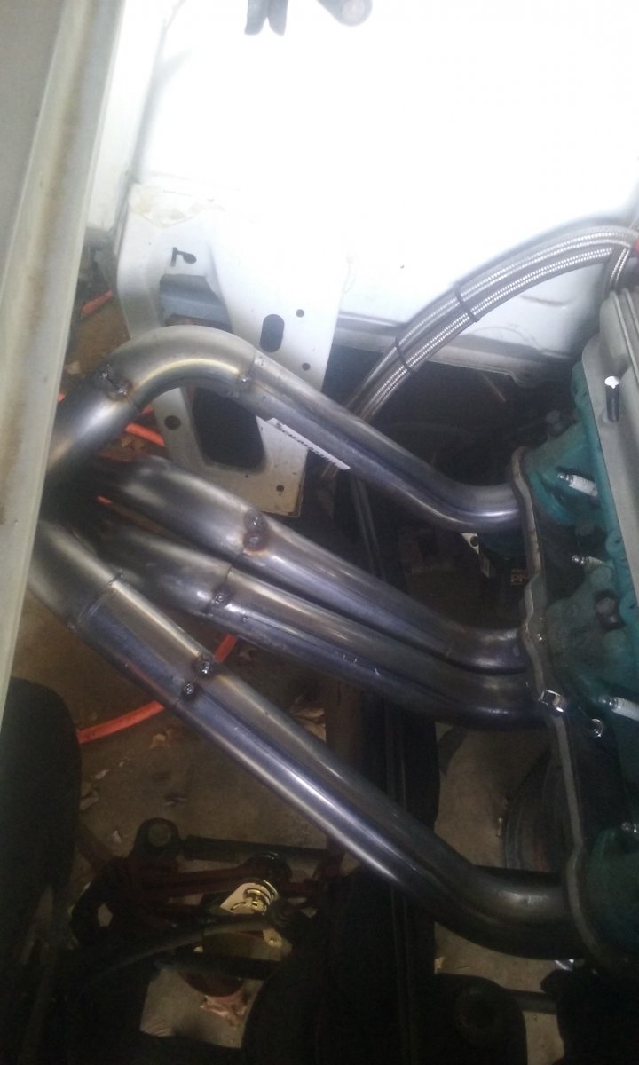

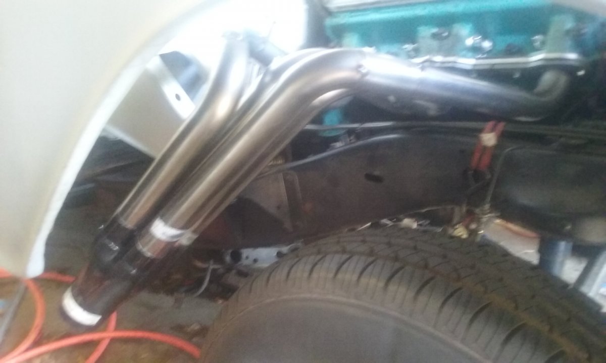

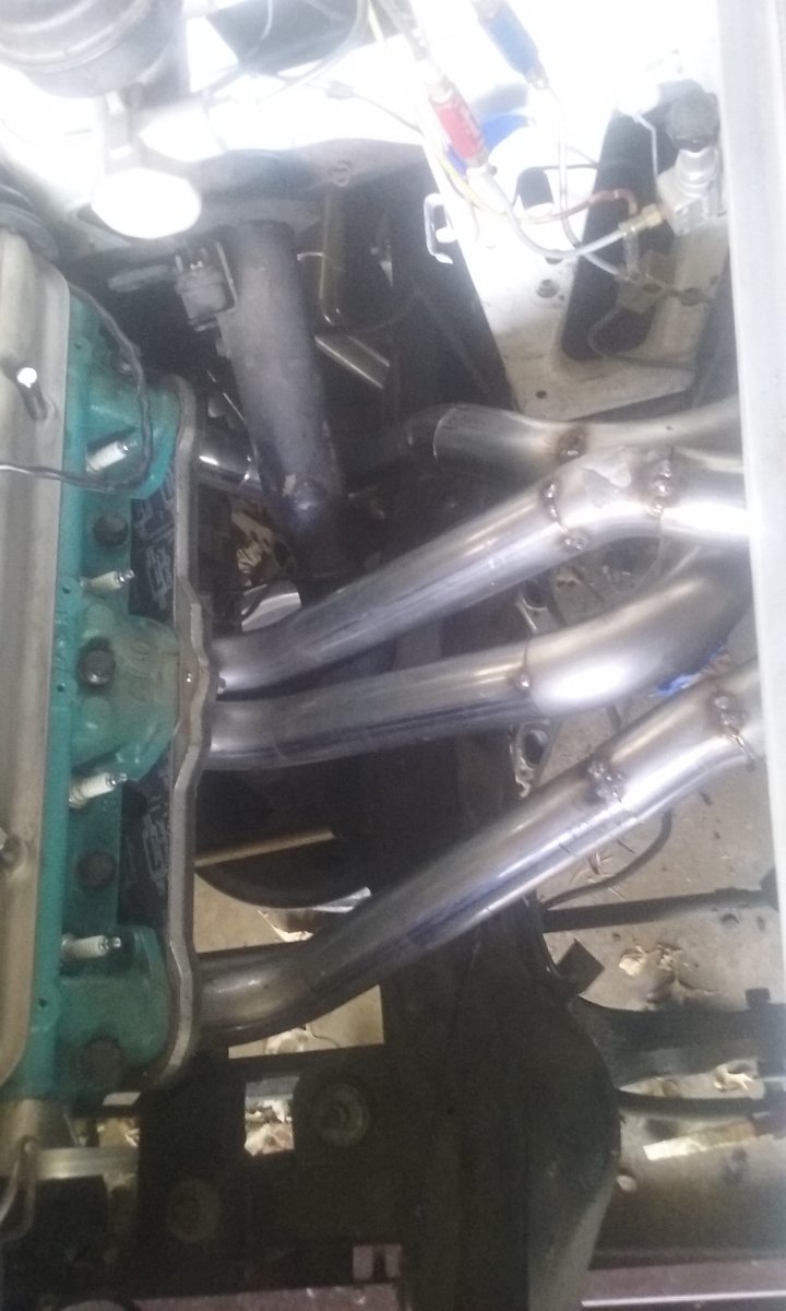

    I got both side headers tacked together. I also have to reshape the center flange tubes into a d shape and build up the center port. Also need to rewire , and reroute brake lines and install line lock

    Wild, to say the least. can you mount some ballast to rear of frame, or something, to get wheels up? some earlier cars ran a large diameter steel tube filled with concrete, etc, as a rear bumper to get frontend up.

    Cool. I have to go here as soon as we get the frame finished. I've found them but I'm just curious.....where did you get the flanges and collectors from?
    I have a local guy that hopefully will cut me a set but I haven't asked how much yet. LOL

    I think between the dana 60 and moving the battery to the back should help. My next engine combo should help out also
