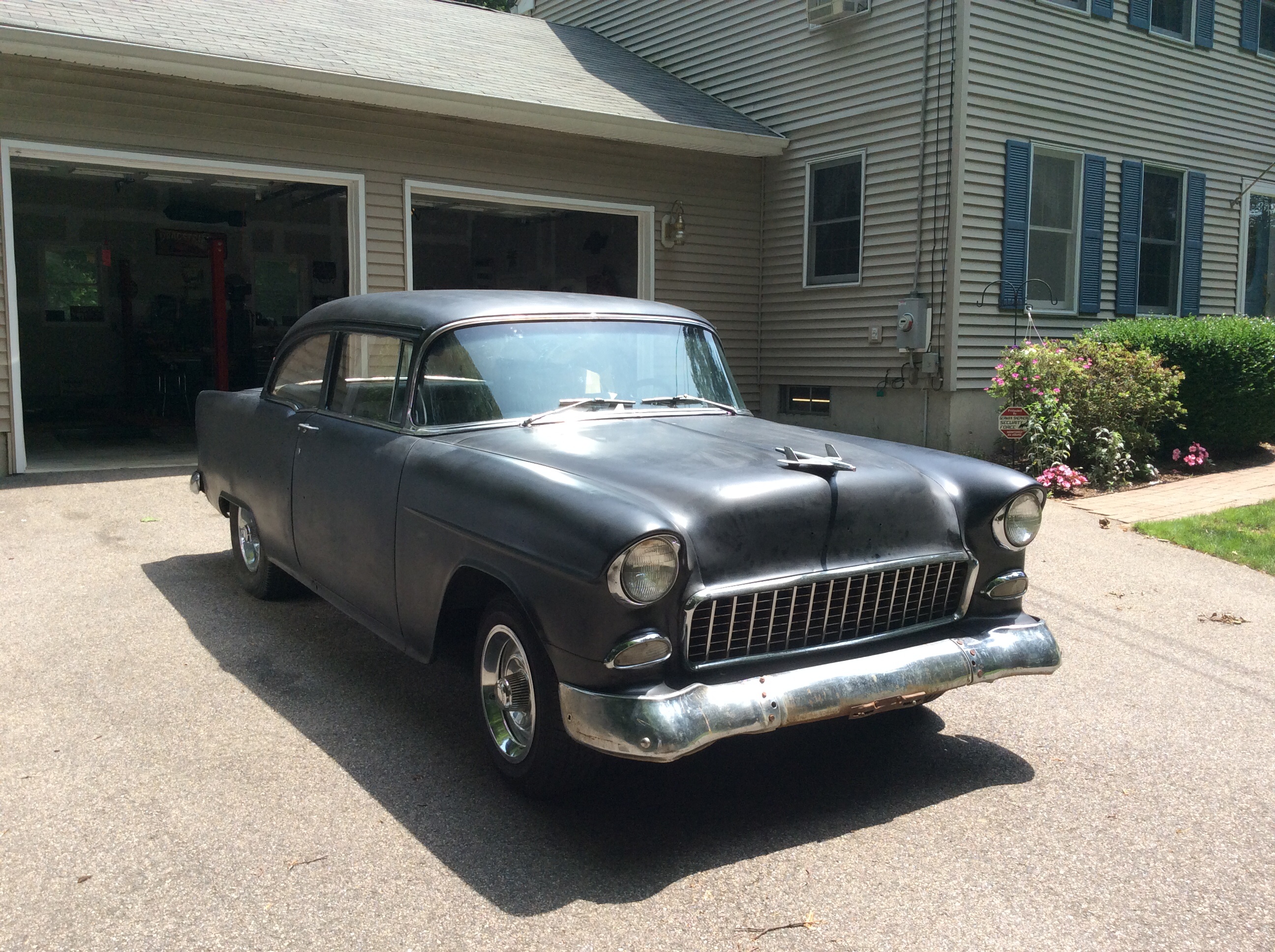

    image.jpg Hey gang,
    I recently sold my finished coupe and truck and decided it was time to get back in the garage and build something! I just dragged home this 210 this week. It has a 302 4spd with a 4:11 rear, 64 impala power seats, and pristine muffler bearings! The previous owner built the 302 from an early 60's 327 block. It wouldn't be my first choice as I like the 327 as is but it should be fun to wind it up.
    Initial plans are to put some front disks on it. Any recommendations?

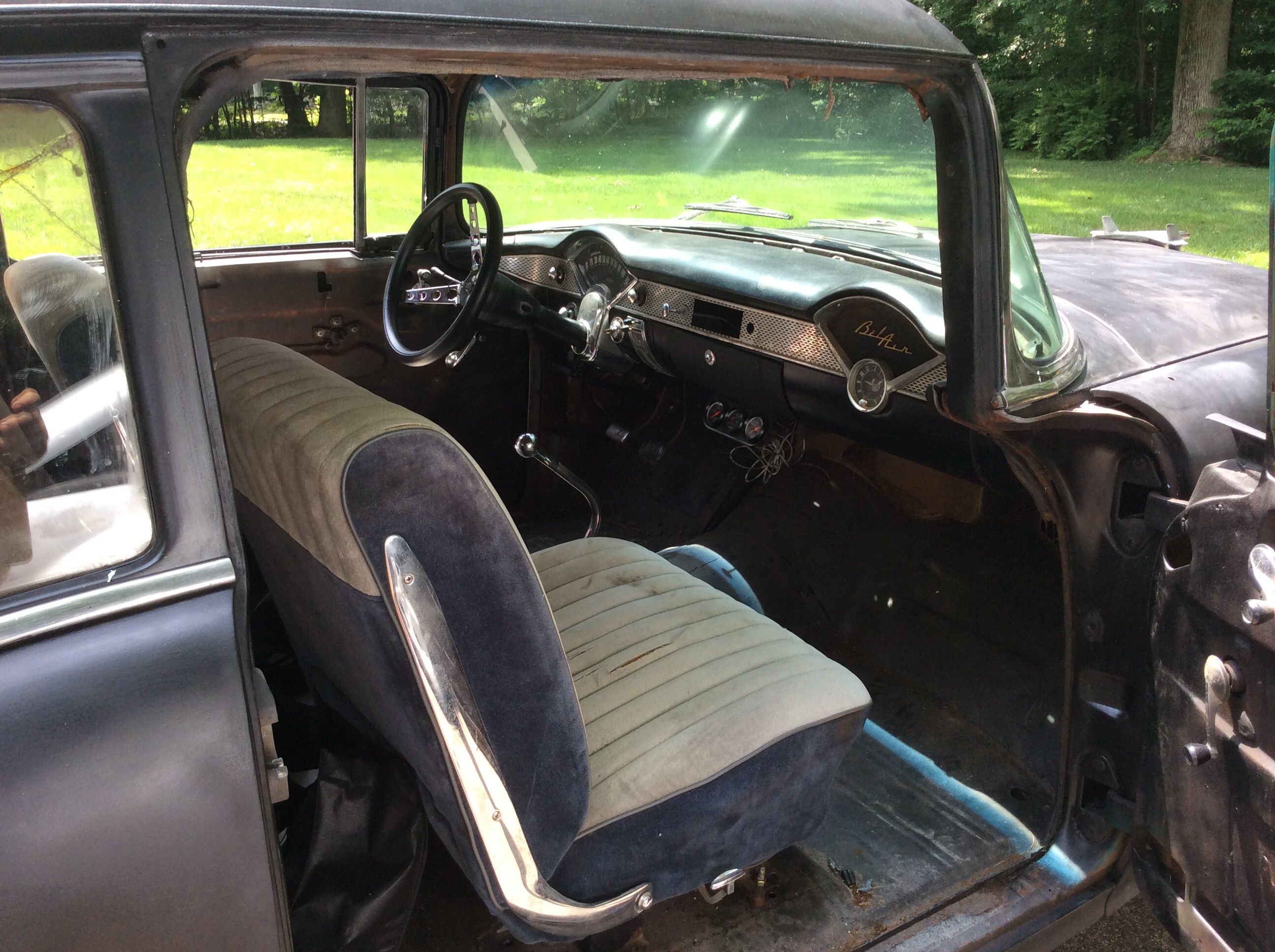

    Are you shure it's a 210 it has a Belair dash. Doesn't get much better than a 55 2 door post.

    It looks like a 150 to me, except for the dash trim. I would definetly do the disc brakes. Ol' 55 in Doylestown, PA sells a great, complete, front disc kit. It comes with everything you need and has the large rotors and calipers, hard and soft lines, nuts and bolts, master and booster, etc. All at a very good price and step by step installation instructions. I used their kit on my 56 and was very happy with it. And for you die hard American parts fanatics..... most of the components are name brand US of A stuff.

    ...150 '55's don't have stainless trim around the windshield and backlite, just rubber...

    I also noticed the belair trim on the dash but I figure someone just added that and deleted the 210 side spears.
    The vin will start with "A55" for 150.,"B55" for 210, and "C55" for belair and will have a V before that if it came out as a v8 car.

    ...............the belair dash trim would be easy to add, Someone could have taken the belair trim off from around the side windows,filled in the trim holes there and added the 210 beltline trim back to it but I doubt it.

    True, the 150 was the baseline model and had no stainless trim around the windows, only the black rubber seals. My 150 did come with the stainless window trim and the piece along the bottom of the side windows. I removed the window stainless when I replaced the glass. And of course the 150 and 210 did not come with the dash trim. Most guys added it because it was easy to do and looked nicer than the plain painted dash.

    The trim code on the firewall says 1011. I think that's a 210 sedan according to a quick google search. Either way..not sure it matters for what I'm doing. It's missing the door panels, are those hard to find items? The repos seem like big $$$.

    Yeah it sounds and looks like a 210, Your vin # should be on the driver side windshield post and it should start with B55 if it came out a 6 cyl or VB55 if it had the 265 v8.

    neat car, probably a 210, the 1011 style code was used for the 210 and the belair, but the 210 was the only one with stainless at the beltline below the side windows, but not above the windows. changing that trim takes effort, so it's usually a good indicator of what the car started life as.
