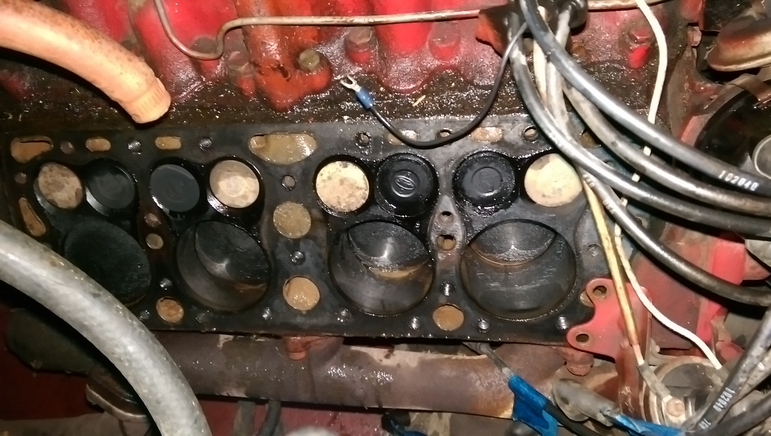

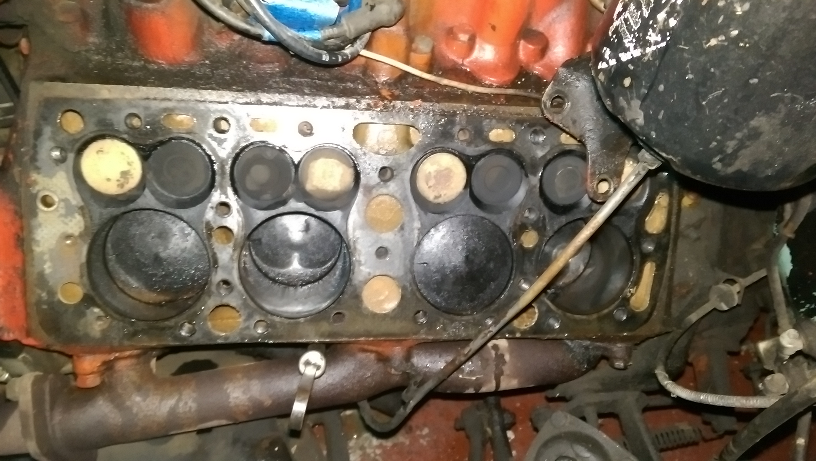

  1. Hi, I'm new to this forum and have a question about a head gasket job I'm doing on my 53 Ford Customline. I found a lot of carbon buildup on the pistons and wanted to know if its normal and can I do anything about cleaning them?
    Thanks, Steve

    Pretty much normal ,I'd leave it alone. Chase all the head bolt threads in the block before reassembly.

    Some Marvel Mystery Oil in the tank and the oil every couple of fill ups will keep the carbon build up in check.

    As for the carbon, a little clean up with WD40 would do nicely.

    It is OK to clean off carbon. Use a brass scraper so you don't gouge the aluminum piston. A wire brush in an electric drill works well too.
