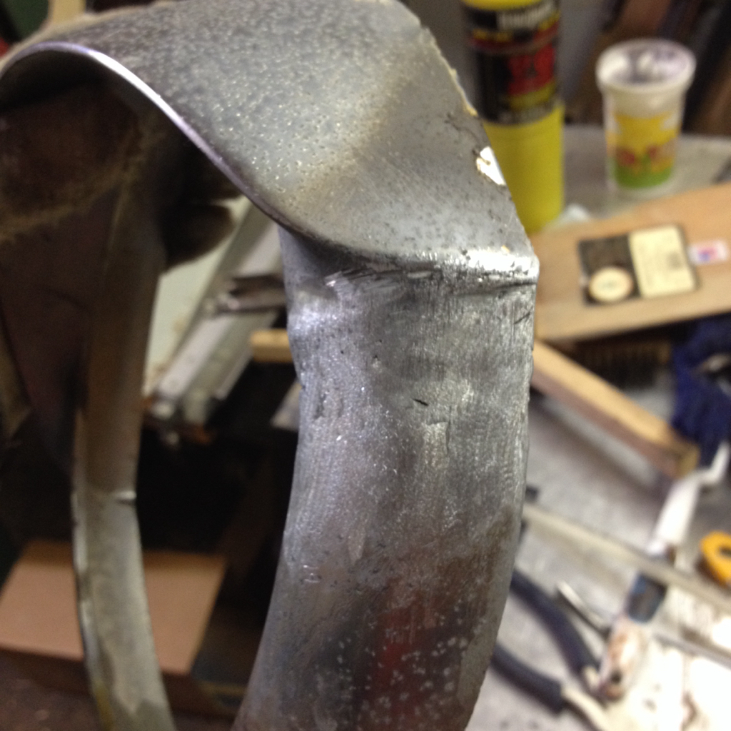

    This is a little out of order but this is the repair I did on the light bezel. Was told it couldn't be welded and thanks to someone in a Facebook group that guided me through the process it turned out pretty good.

    Yup, Ya cant weld that stuff. Looks like a good job though.

  16. Any more info on how you did the light bezel! Great job so far!

    (please note i'm no pro) the light bezels were done with aluminum brazing rods. there are ones advertized online but were quite pricey. these (the ones in the picture) were from a local hardware store. standard propane torch. i use the yellow cans. don't think it makes a difference though. make sure to to keep the metal clean with a wire brush or wire wheel on a grinder.once any parts are blackend the rod wont stick so its a lot of 'weld' clean 'weld' clean. the metal has a low melting point so its a delicate dance of heat, braze, clean, repeat. you can go on you tube and search "pot metal" (i had no idea thats what its called) i really hope this helps. someone was kind enough to walk me through it and i really want to pay it forward.
