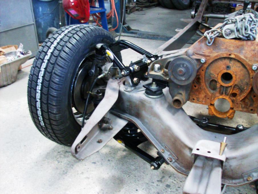

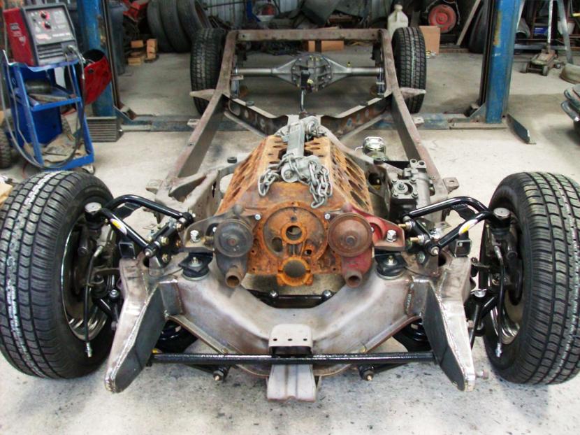

  11. I got these pictures from another web site. This is the Jamco setup that I am planning on going with.

    This is the fatman fab Mustang II set up with rack and pinion and slam specialties re6's. Pardon slddnmatts rear end in the pic; he's the brains behind this thing and he nailed it. Good luck to you.

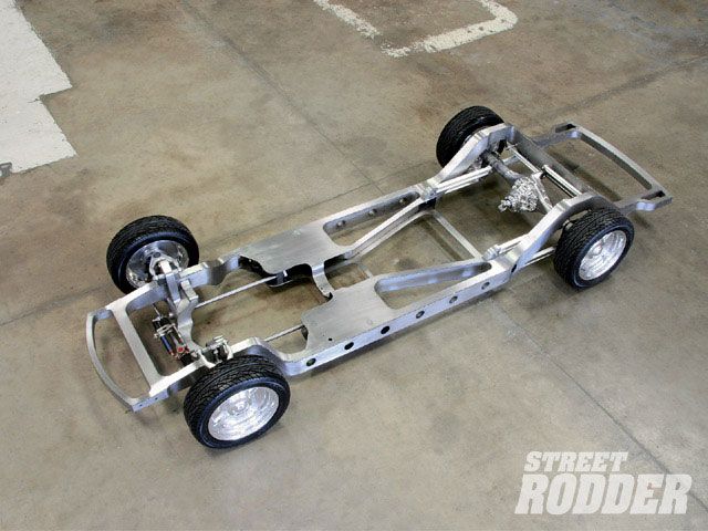

    If you can afford Roseville Rod & Custom has it...Take a look on Street Rodder Magazine!
