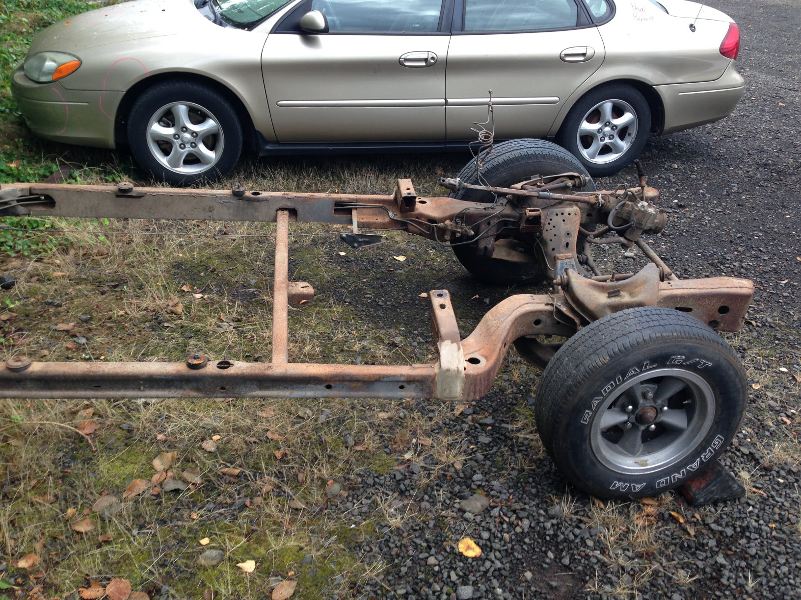

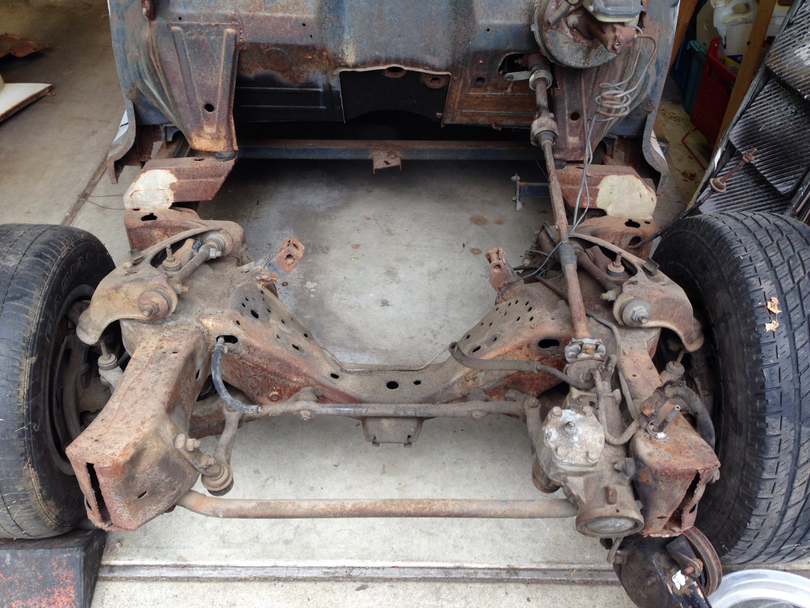

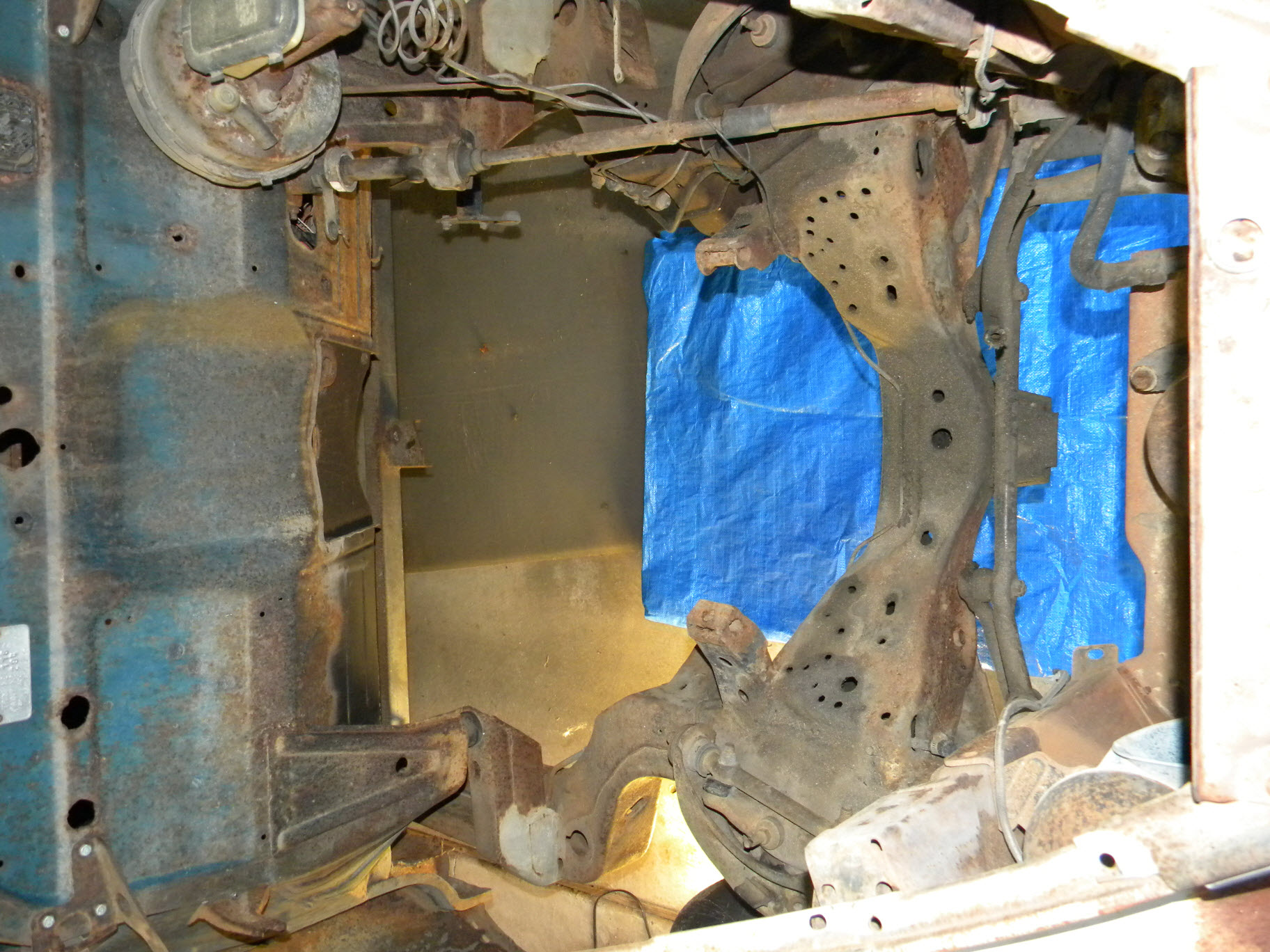

    I do have a nagging question before I jump into purchasing some suspension; I have looked at several pictures on the net of frames (and here too), and mine does not look the same as others. I purchased the car (dirt cheap) 2 years ago, because I wanted to have a vintage rod, and wasn't too concerned about the frame at that time... Now I'm thinking that this '41 unfortunately has a donor frame under it, and have a bigger project that I realize. The attached pics are of my '41 (not very good), and I will post better ones tomorrow. Do you agree it is not stock?
    My frame looks similar to this frame I've seen on this website: http://www.purplewave.com/zoom/120822/B6852/6
  7. Voh
    Joined: Oct 18, 2006
    Posts: 1,038
    Voh
    Sorry, but that's not a stock frame. Not even of the same vintage, but of different GM makes. Looks like a later-model frame.

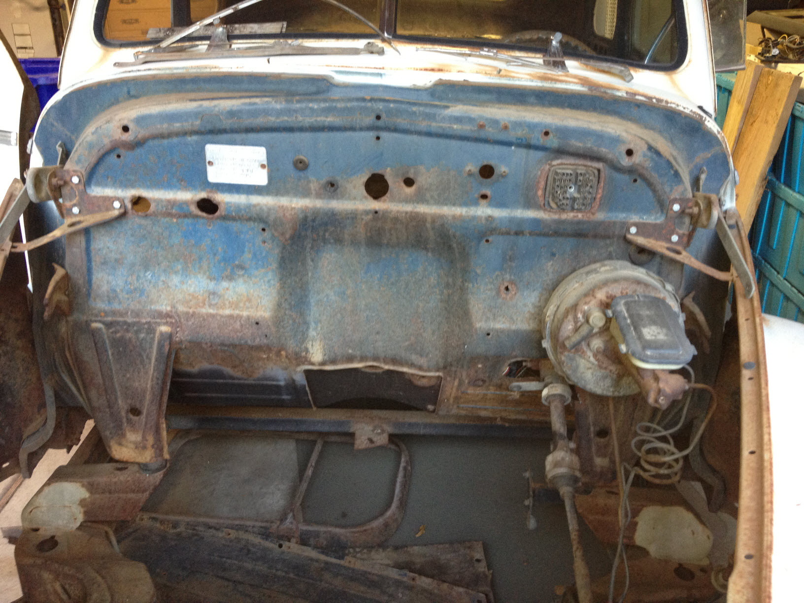

    Your car would have come from the factory with the "top hat" style frame. I'm not at a computer so it's a bit hard for me to see what you have.

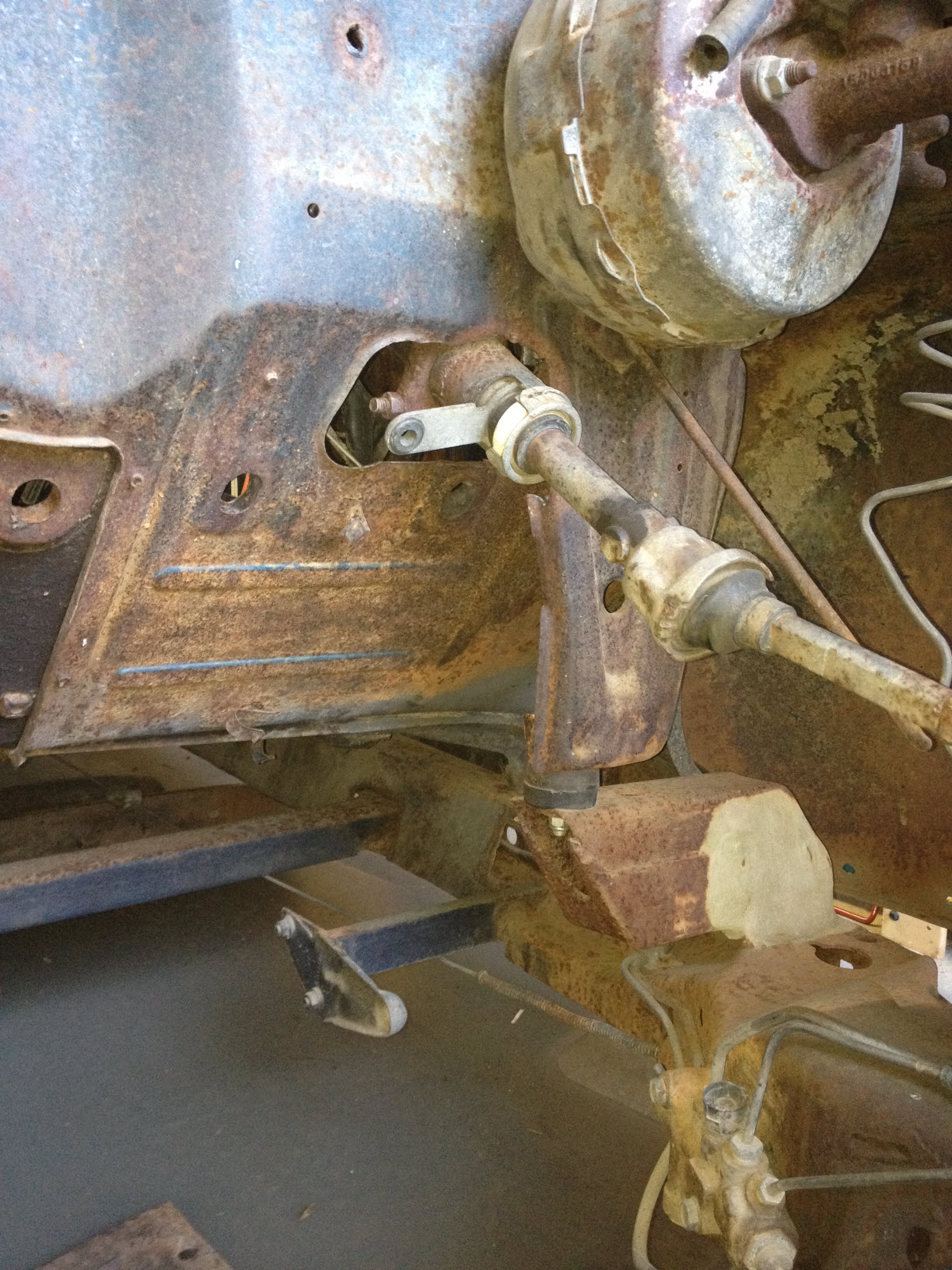

    What Voh said, ^^^^^^. Looks like someone put a later model GM frame under your car. Hard to tell from the pictures what it is, but those brackets/body mounts at the firewall appear that it's too wide for your '41 body. If they did a full frame swap, does the rear end use coil springs, or parallel leafs? Might help narrow down what year/make of the frame.

    Is it a full frame or just a clip? How is the rear end set up, trailing arm or leaf springs, same wheel bolt pattern? I see pendulum pedals and late model column.

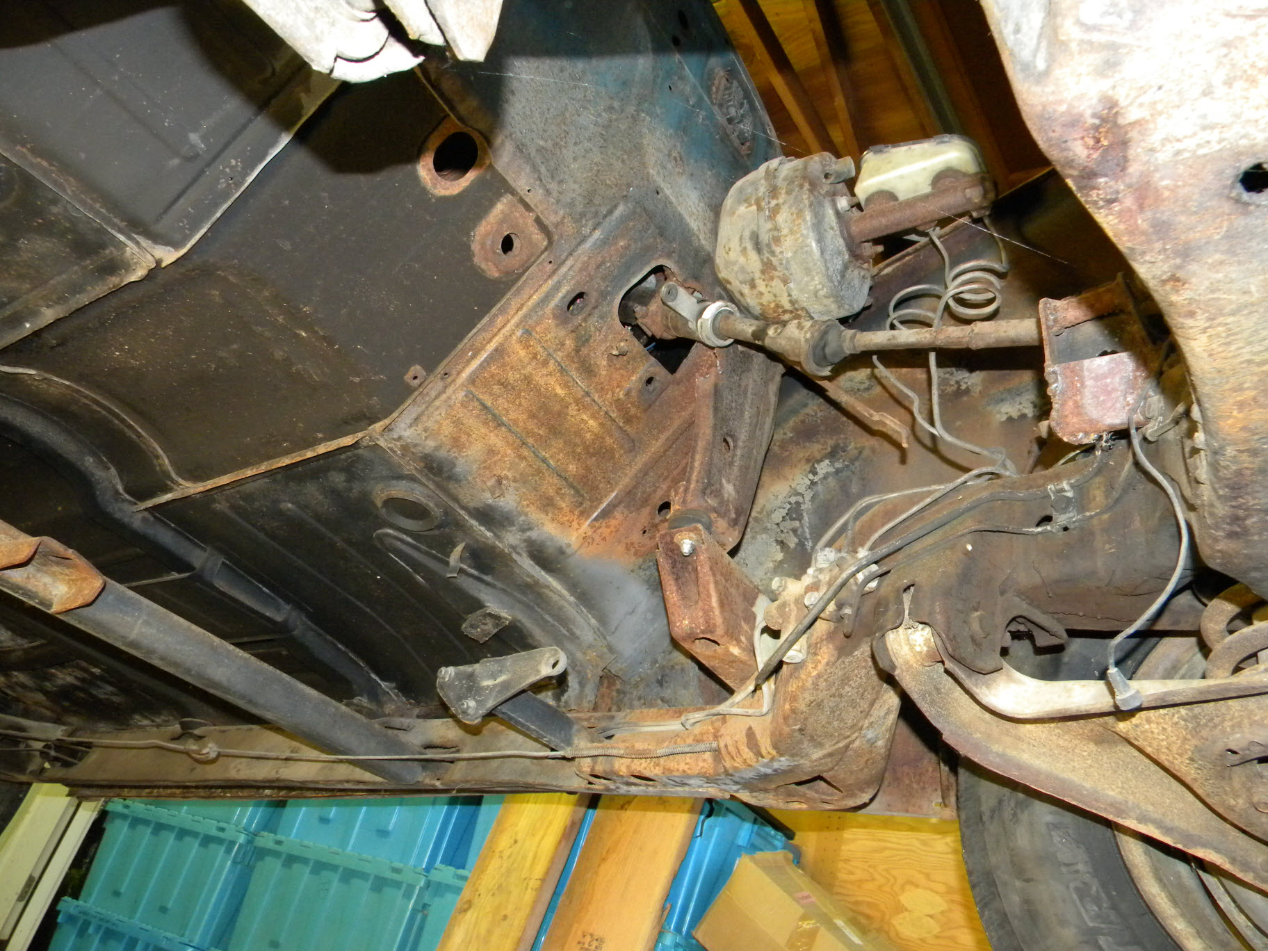

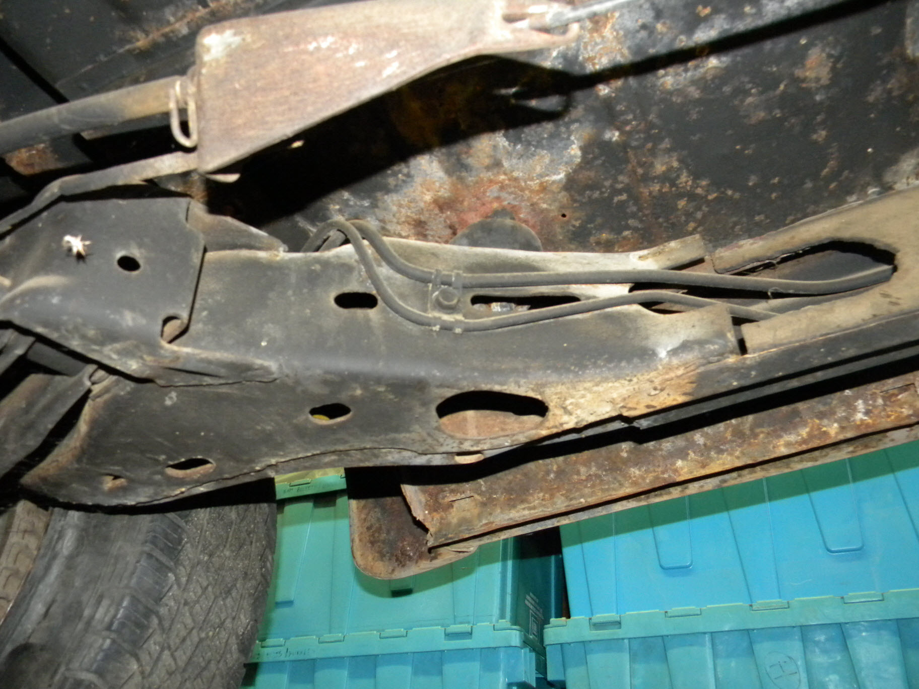

    Looks clipped, and might not be a very good job, from what I can see. Would need more pics concentrating on the area directly under the firewall, inside and out.

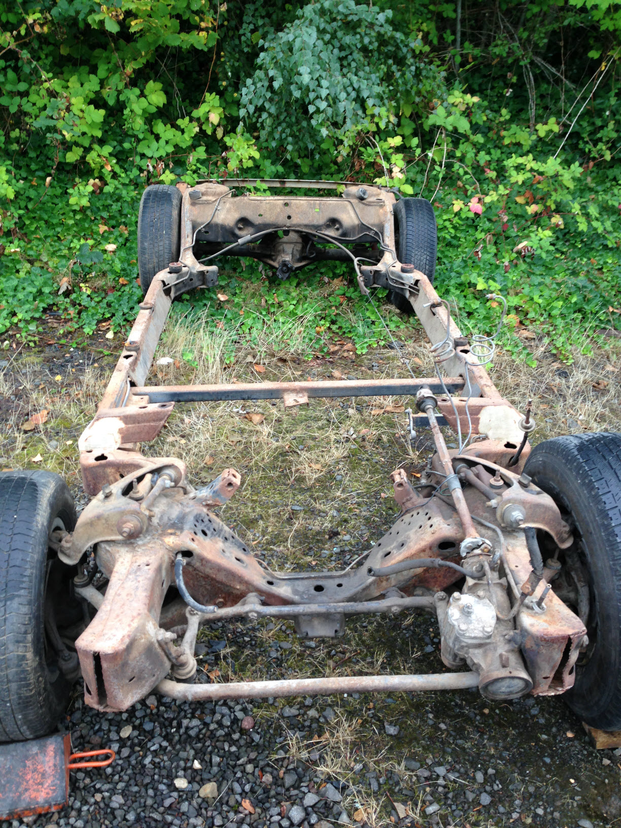

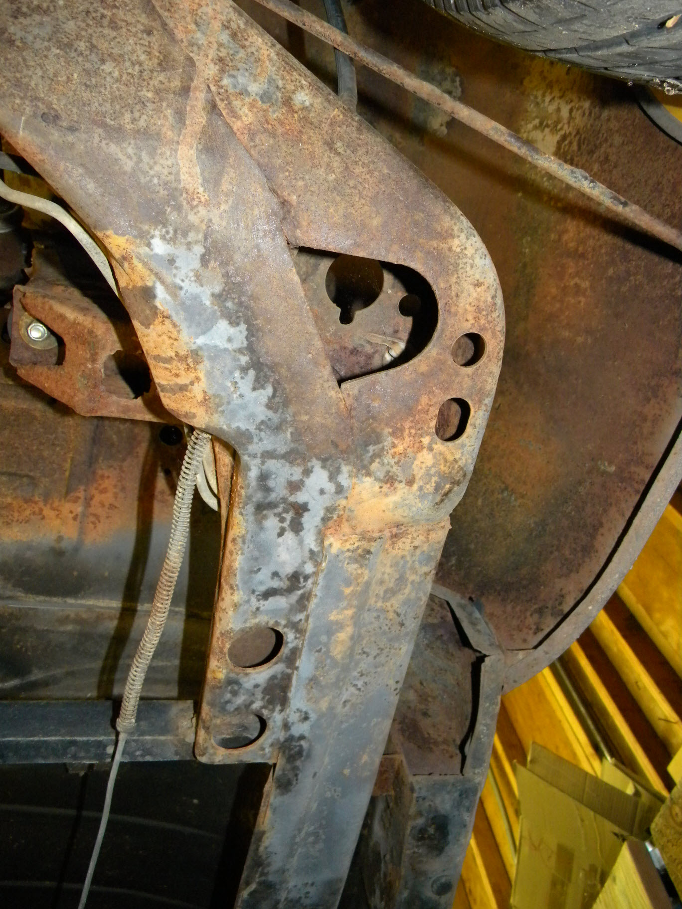

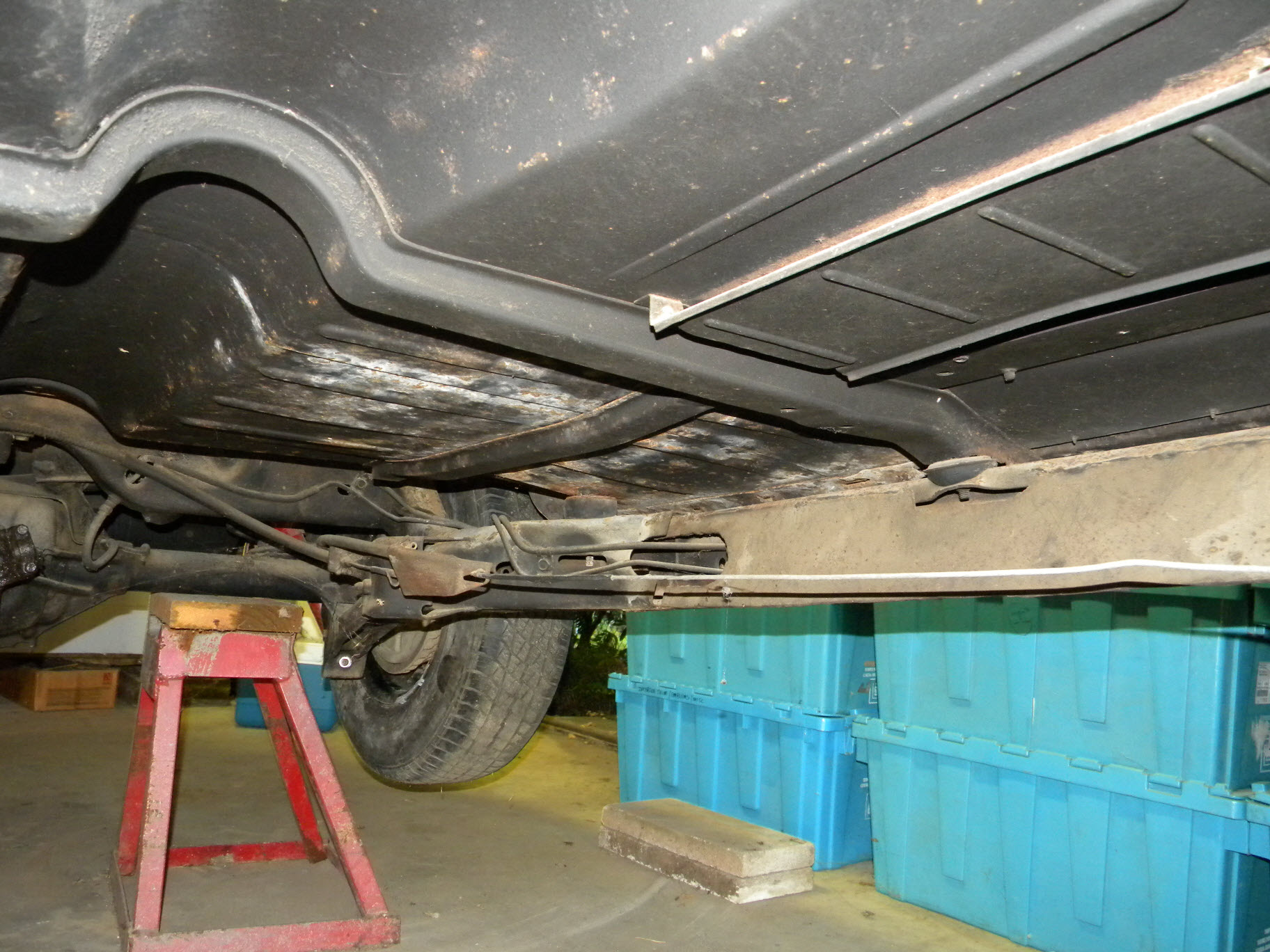

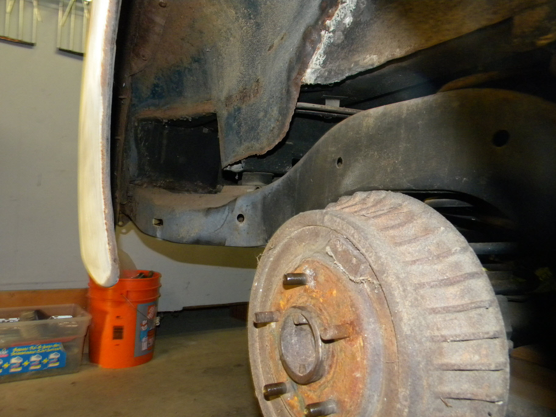

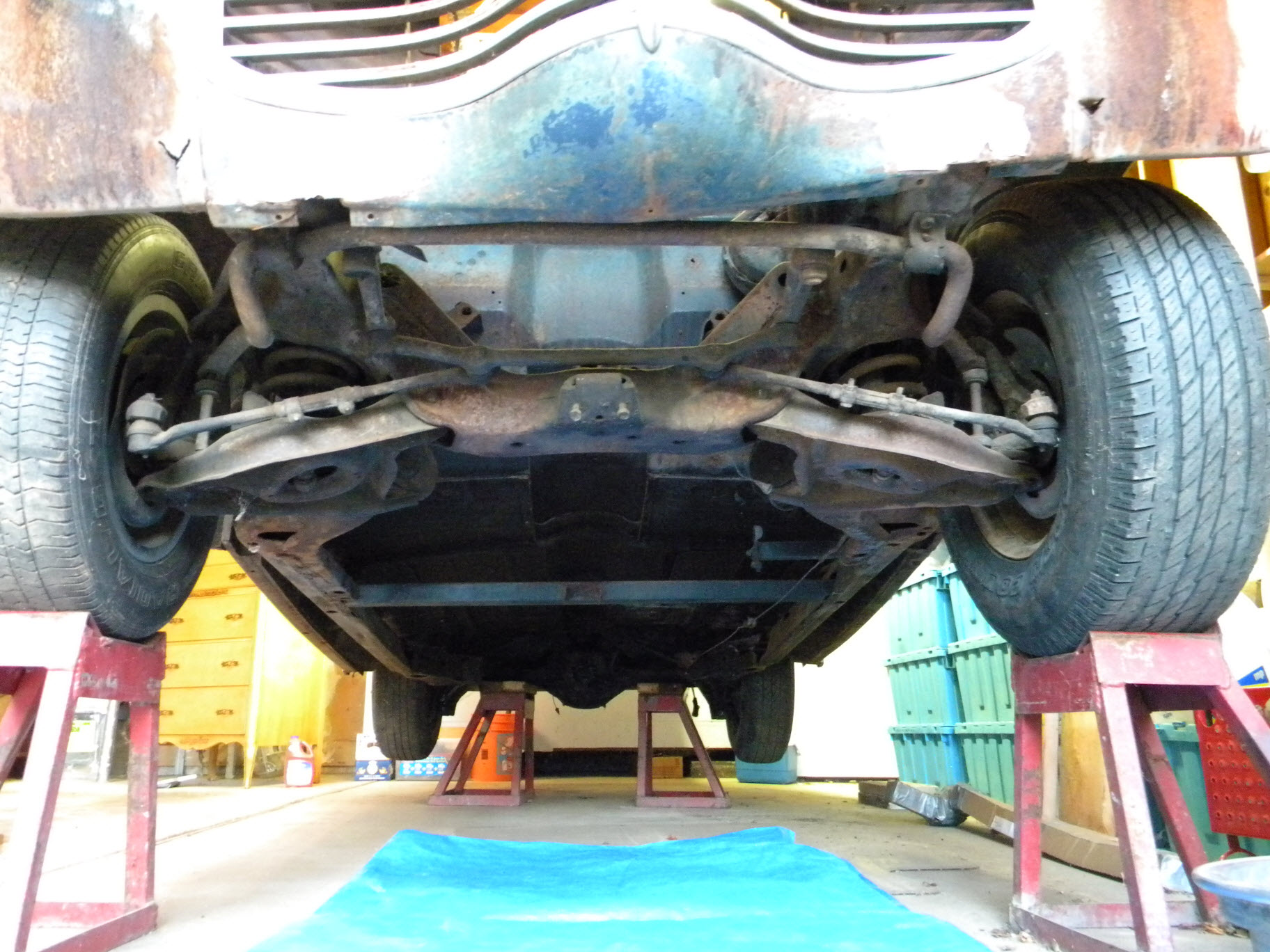

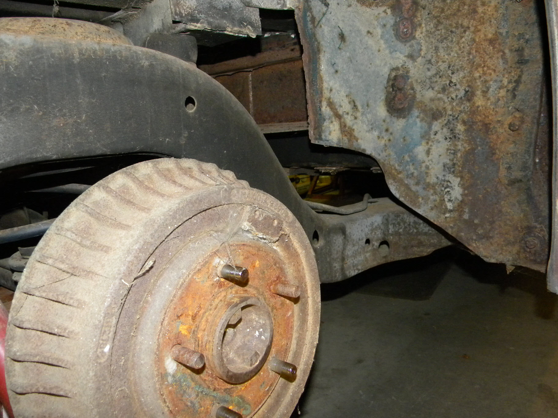

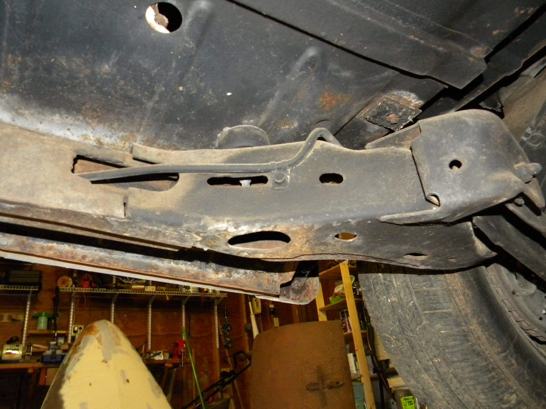

    I put it in the air last night (have it stored elsewhere), and all I can say about the frame is FUBAR. I think it is clipped at both ends? It looks like they used part of the original center rails in the construction; as they seem triangular under the body, with strange floor mounts. Looks like a 10 bolt rearend (maybe a 12), probably a drag car in it's past... I guess I know why it was a super good deal, this frame is a basket case; and I feel I need to rethink the whole approach. My pocket book just let out a sigh...

    That looks like a A-body frame. that rear end is very similar to that (suspension wise) that my axle was from, and that was a 1965 Lemans.

    Or a G body frame. Looks like they used the whole chassis, but probably shortened it at the rear kick in.
    Actually, if the welds look good close up, I'd leave it as is. It will ride, handle, steer and stop better than any old car chassis. But be diligent in inspecting the quality of the chassis splice!!!!!
    Mounts under the firewall looked awkward so I assumed it was clipped. It could have been done better, but isn't bad, just ugly!

    On the front cross member on the bottom is stamped "8 340" in the center. The front frame rail front ends are look like they've been cut a welded. The trunk floor appears to be raised to accommodate the cross-member support for the axle. I found some frame drawings of both styles of frames, where could I tell the differences between an A-body and G-body frame? The look really similar.
  16. studebaker46
    Joined: Nov 14, 2007
    Posts: 715
    studebaker46
    actually this was done a lot in the 80s and 90s . use a chevelle from the 60s/70s cut the frame at the font and back and use heavy wall 2x3 tubing to make whatever wheelbase you needed. a buddy of mine done this with a 39 olds 4door and used everything out of his wifes rusted out73 cutlass 4door and had ahelluva nice driving family streetrod tom

    Not an expert on differentiating the frames, but if you take the numbers off the front brake calipers, it might narrow the type and year ranges down considerably. Run them at your local part supply. They probably changed more from year to year, and body style more than anything.

    Good idea on the brakes. I've concluded (with everyones input) I'm going to stick with the frame. Just working on trying to narrow down what it originally was under, so I know what to order for suspension parts, when needed. Going to get into my buddy's shop in the next few weeks to pick the body off, check the frame over, and start the project.

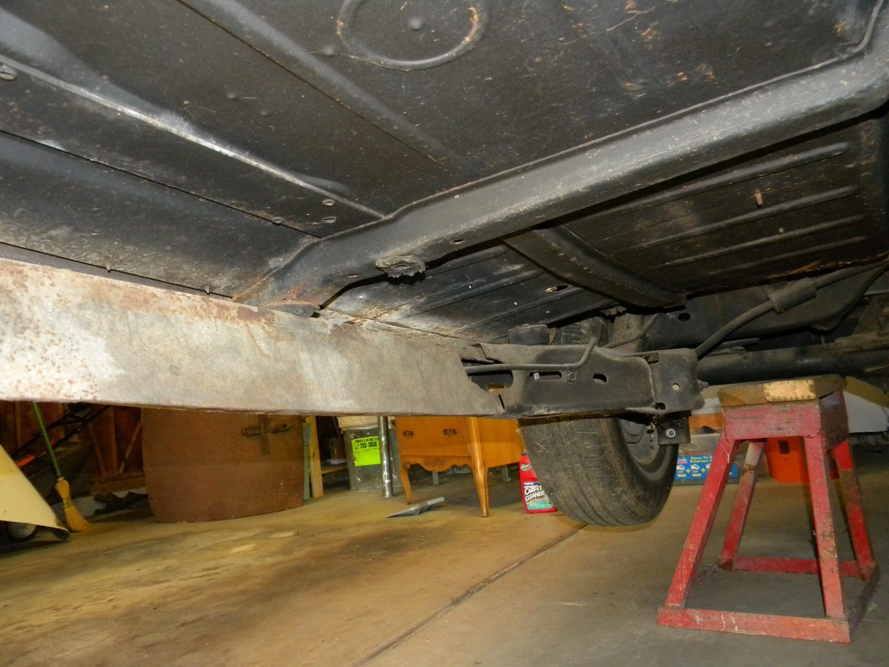

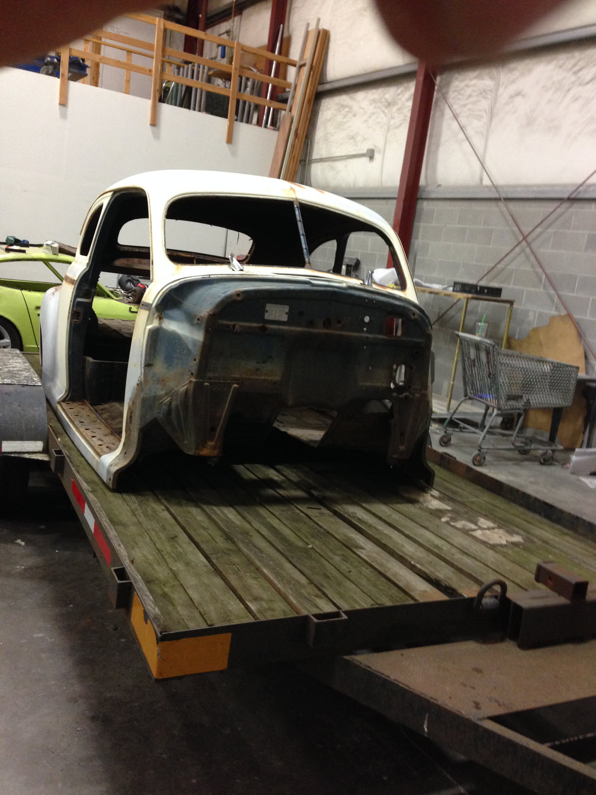

    The body divorced the frame this week. Was a lot of work to separate, appears that the frame is a 5th Gen 78-87 El Camino frame, wheelbase 117.1". The body was bolted to the frame, then the rails were boxed for strength unfortunately covering bottom nuts. Had to be torched off... The rear trunk floor is a section of the El Camino pickup bed floor (waffled shape). Trunk floor was raised to deal with the higher frame rail portion in front of the rear wheels, and gas tank; explains why the trunk lid was hacked off, and license plate frenched in...

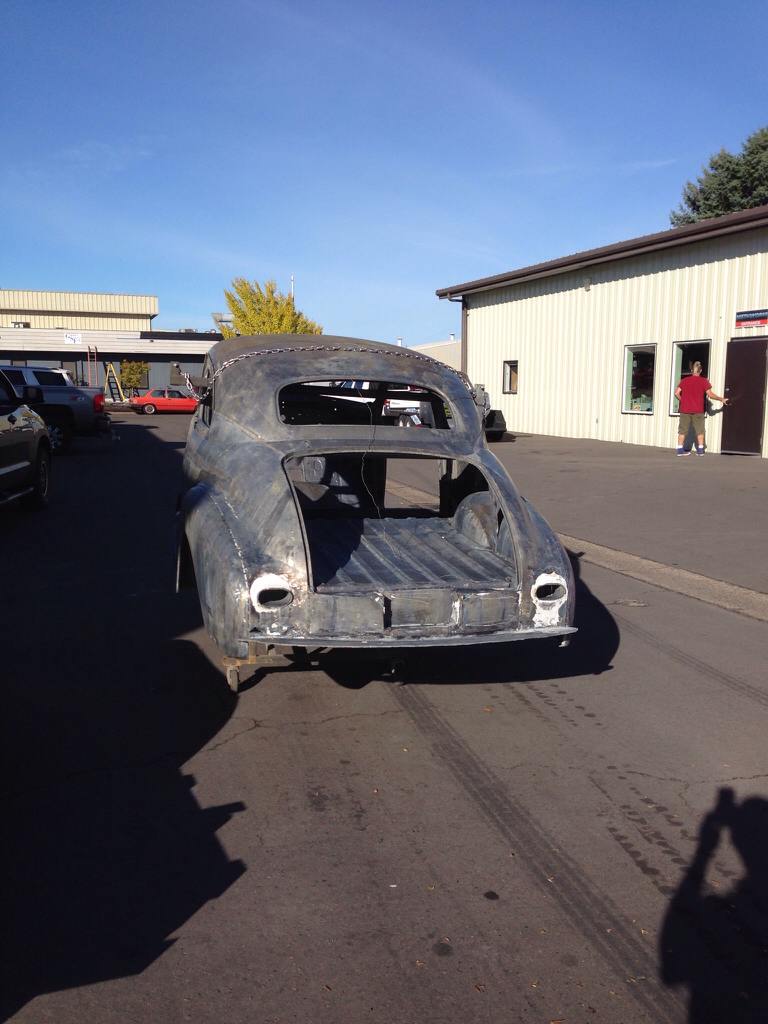

    Got lucky and was able to use a bridge crane to lift the body off, made it easy!
    Loaded back on to the trailer, and headed to be dipped next week.

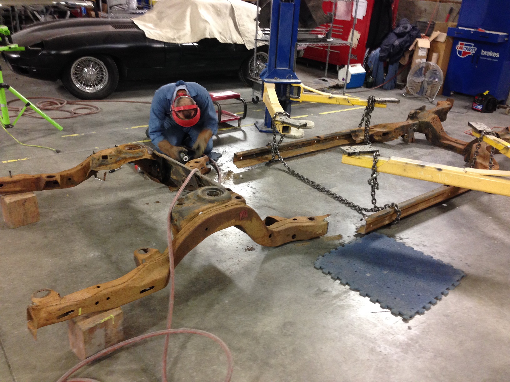

    Progress this week. Decided to stay with the G-Body frame, located a clean one at a semi-local yard for a decent price. I felt that I needed to get the wheelbase close, so I cut the factory welds in the rear, and took out 1", reducing the wheel base from 117" top 116". Next step will be to sand blast the frame and transfer the suspension from the old hacked up frame to the new frame.
    Muscle Rods http://www.brphotrods.com makes bolt in motor mounts, cross member, and modified oil pan to fit on this frame. Once those arrive, I will mount the LS1 engine/tranny, then set the body on the new frame to determine where to make the new body mount perches and box the frame. I also will be adding other structural bracing, since the G-body frames have a lot of twist and flex to them. The frame rail ends will also need to be cut off, as the frame is longer than needed...

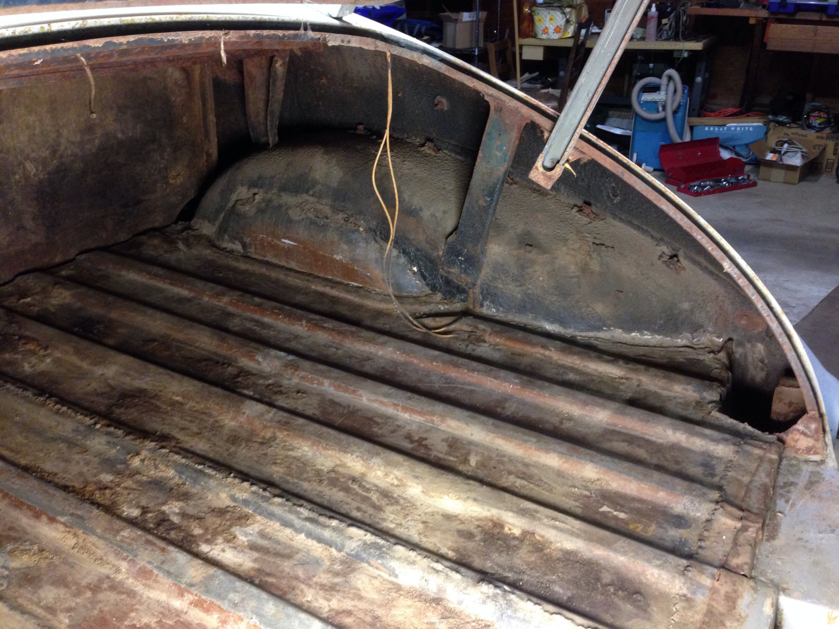

    Body work progress also. Cut off the right rear fender that was poorly welded on. Will re-weld it back on in the correct place, since it was out of position when welded originally.

    One thing that I am still working on is the front frame horns. On my car, they took a pretty good size chunk out of the lower front chin pan so that there was room for the steering gear. I have will have to cross this bridge once I get the body on the frame, and see if it helped any by taking the 1" out of the frame. I might have to consider other steering gear options if it didn't make much of a difference.

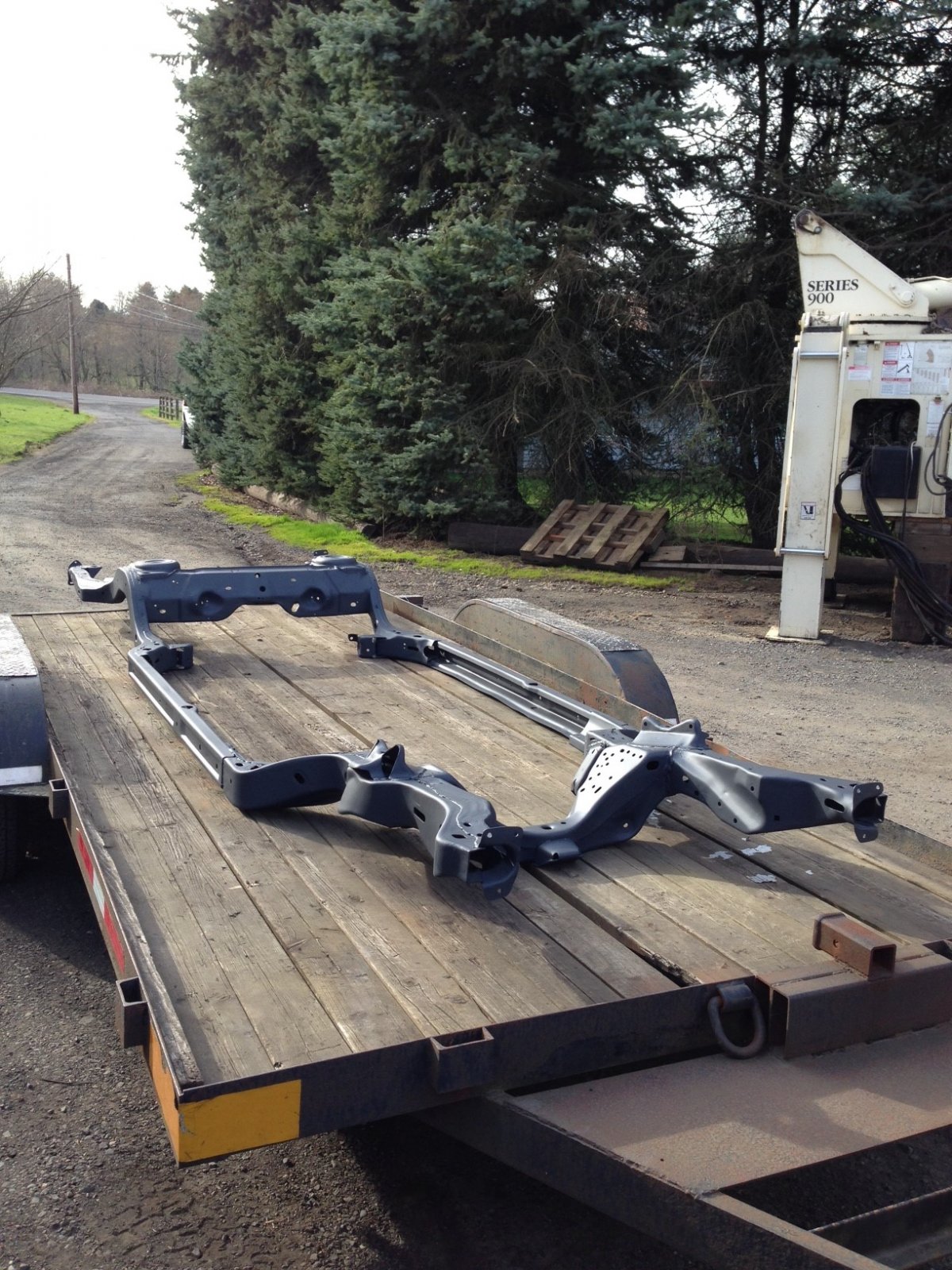

    Here is the new shortened frame sand blasted and primed that I did get done this spring.
