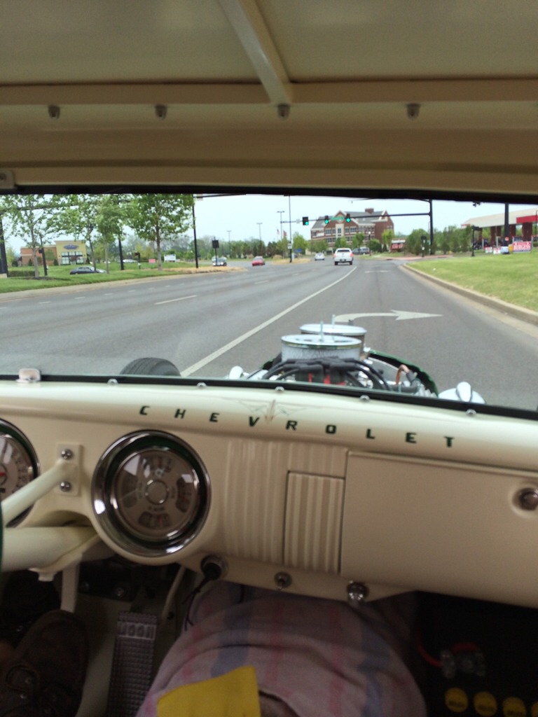

    Anybody have any expertise on Rochester 2G tri power setups? Engine is a 327, .030' over, 10:1 CR, lumpy solid lift cam, power pak heads ported with 1.94/1.60 valves and DOESN'T idle at all. I don't believe it's getting any fuel. An engine builder here at home said he thinks I need a different power valve. I have a regulator on it and it is right at 5 lbs. Any help is appreciated!

    Well...couldn't get the engine to idle right. Had the center carb apart multiple times. Talked to quite a few people about it and I believe I'm running too big a cam and the little 327 won't pull the necessary vacuum for the idle circuit to work properly. And since I'm leaving for a show in Knoxville Tennessee this Thursday, I set me up two fours! And now it runs and idles, at least off one carb. Linkage and dual quad fuel line should be here Tuesday. Wish me luck!

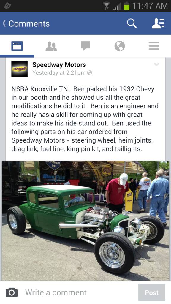

    Hey man looks great. Just saw a shot of your car on the Speedway Facebook page. Looks like it was a big hit!

    Just got back from Knoxville and hung with Ben and crew all. Congtats to him , he was chosen for one of the Pro's Pick awards !!! Congrats !!!
    This thing is really nice !!!

    Car looks great! Did you play with the air bleeds on primary carb? I had to drill and tap mine for little brass plugs to fatten my 6x2 setup to idle too. I can go into more detail. Just let me know and I can PM you my cell.

    Thanks and yes I drilled them out .030" larger with no luck. How much larger did you have to go?

    I think you went the wrong way When I first fired mine I couldn't get it to idle below 2000 rpm because it was too lean. I don't remember what the factory air bleed size was but I'm went down from the factory size to .035 to fatten it up.
    The way it was explained to me you need to cut down the air in the mixture by letting less air in with the smaller hole in the bleed.
    The change was dramatic on mine. I hit the key and it sat there and idled around a 1000 rpm.
