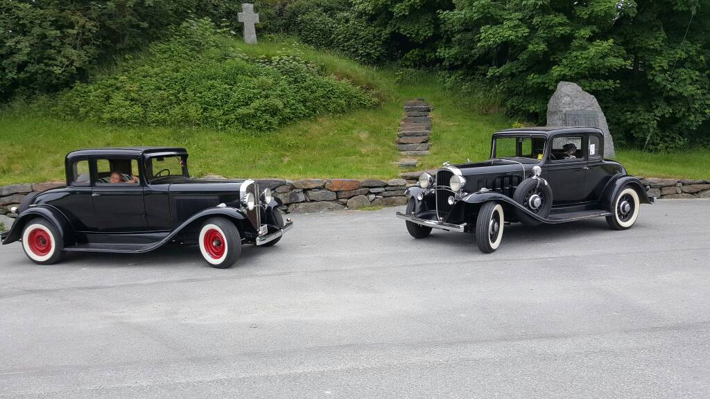

    Here comes pictures :) It is a good projekt.

    Nice looking Pontiac, not something you see too often.
    Best of luck with the build.
  12. That's a great looking Pontiac! Good luck with your project and keep us updated.

    That looks mint! Very nice car!!
    If it's anything like the Chevy it's a fine automobile.

    Wow! Nice Pontiac. Like all GM cars of that vintage it has a wood understructure in the body. So it is a bit more difficult to chop the top than a Ford. Also, I have lowered Chevy front ends by using a Speedway 6 inch dropped axle and their 49-54 Chevy spindle combination. I mounted the axle between the spring and the frame. But I had to notch the frame a little and cut the bottom off the front cross member and move it up so the axle has room to move. Or you can do as already mentioned... replace the front cross member with a Ford member, remove the original front springs and mount the front spring and axle as a Ford. Ralph

    [​IMG][​IMG][​IMG][​IMG]
    Car is finished for now. Now I need to build my new garage before I start building it.
