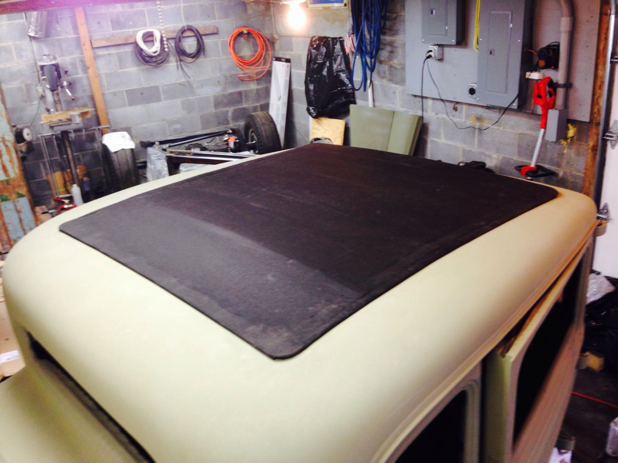

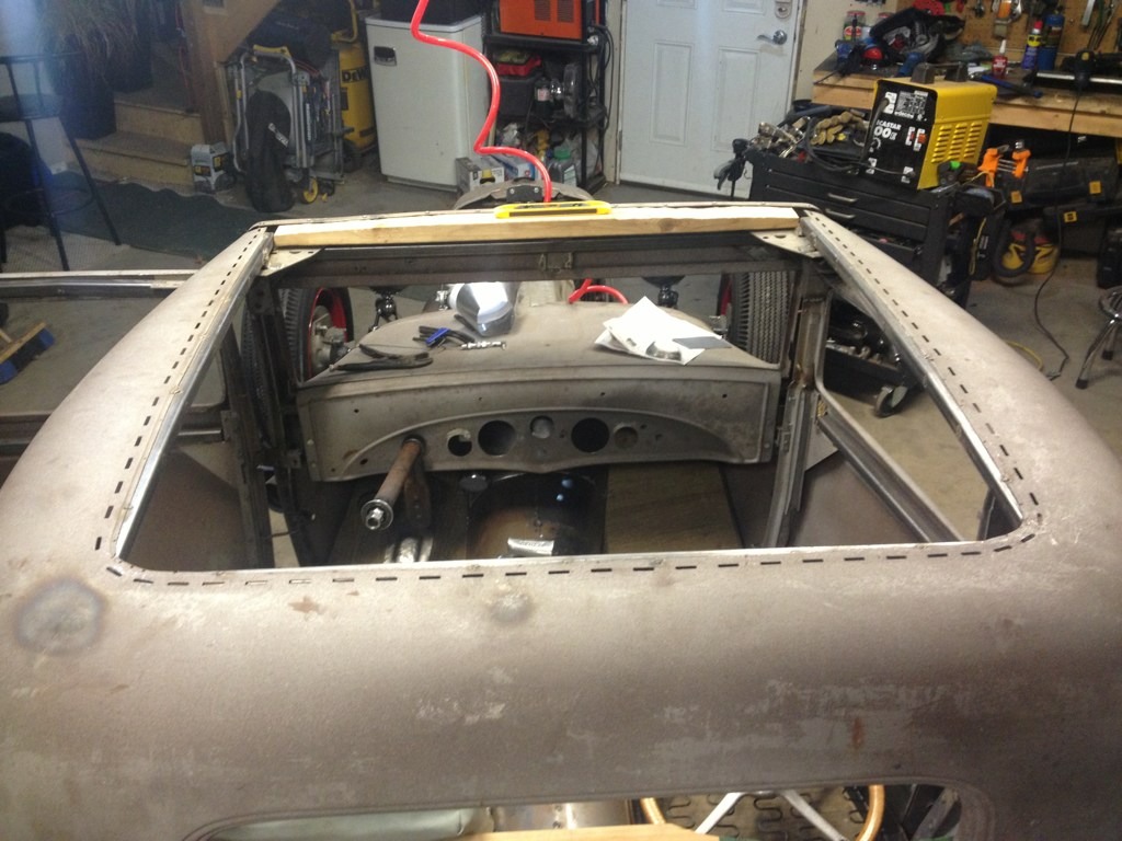

    The roof which I'm considering covering with a sliding ragtop.
    volvobrynk likes this.

    Really? Are you purchasing the unit or making something up? I need to add about 2" to the perimeter to get it to fit a 40x40 unit I found to buy, and not sure how I want to handle that, plus filling in those perforations around the perimeter.

    I bought one from slidingragtops I got the 40x40 unit the size is a little deceiving as the 40x40 is the actuall top itself the hole for the frame is a couple inches smaller. We were already getting rid of the wood so a perimeter made from 3/4 square tube was put in at the correct size for the top frame the the roof was filled in to fill the gap a filler was also put across the front as there is just wood there. The manufacturer can make one any size you want but I decided it would be best to go with a standard size due to cost it is a well made product and these have even around since the 50's so I guess it's traditional. The tech line is very helpfull

    Those are the guys I have been looking at, came upon this idea a little late though meaning if I go this route I'll have to modify what I've done so far, not the end of the world.

    We just cut off the edge where the perforations are

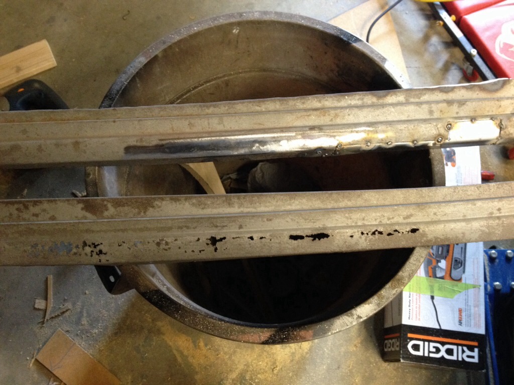

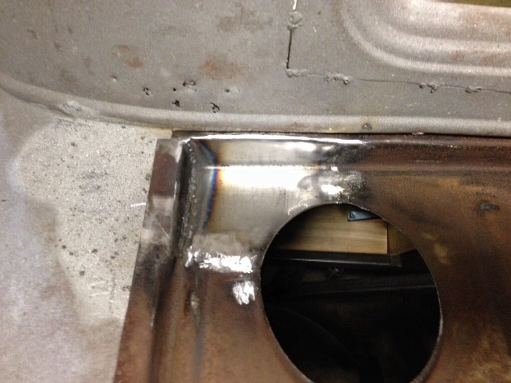

    Some progress today replacing more bad metal in the trunk lid

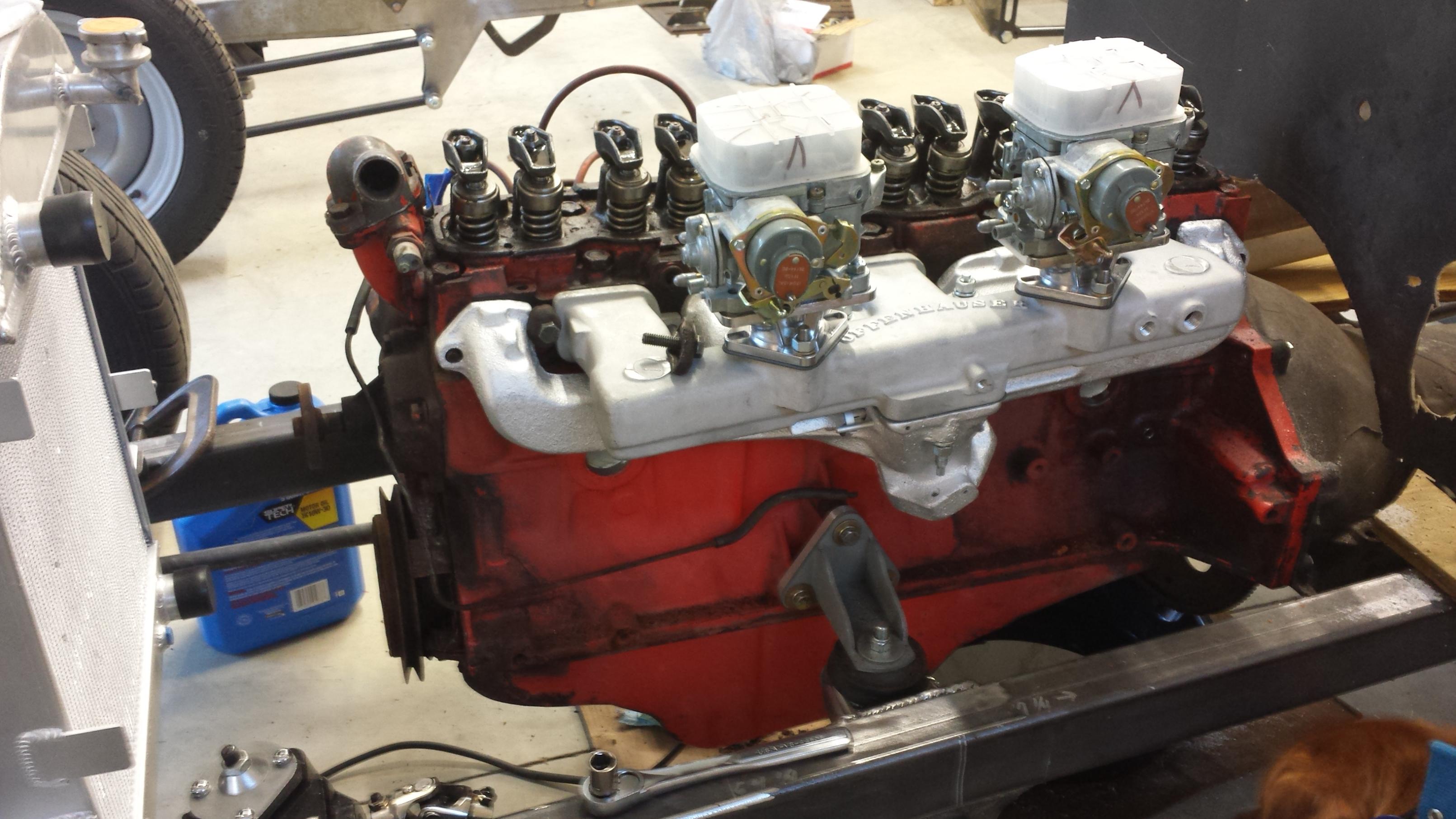

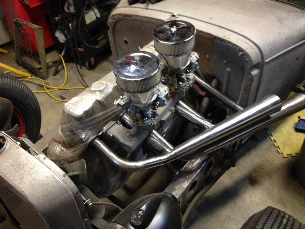

    So did some work on intakes.
    Think it has a nice retro look to it!

    nice build ,I have those same carbs,and manifold on my 230 ,in my t-bucket
    have you thought about heat for your intake..?

    Thanks, No haven't gotten quite that far yet, soon...I hope!

    I like the rag top really has a classic look when closed, a lot like the original might have.

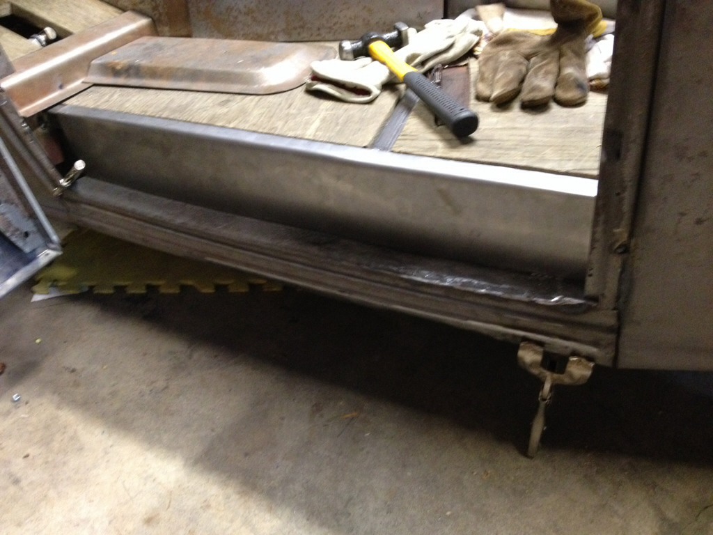

    More metal work, on the olds the door panel doesn't come all the way to the bottom like I've seen on Fords, so the sills needed to be repaired and modified to suit channel.
