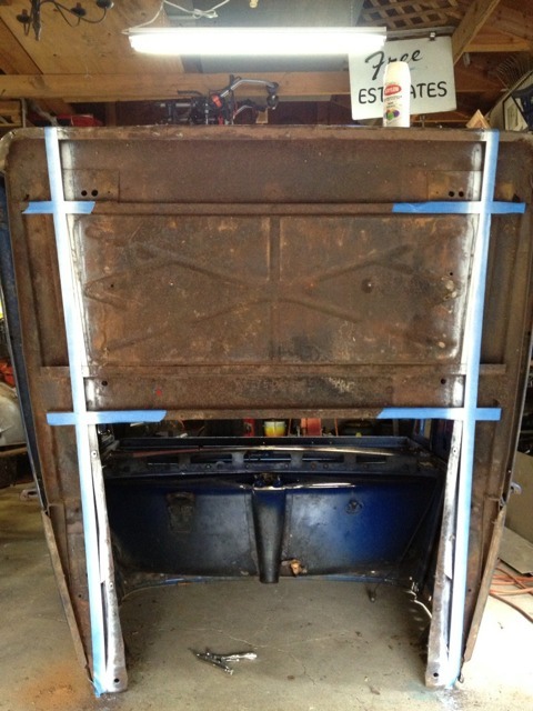

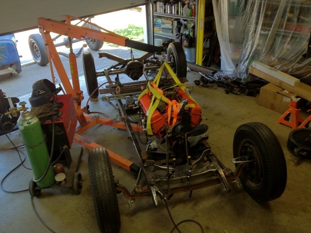

    Hey everyone, bought this in 2011 but started working on it seriously last summer.
    Here are my plans:

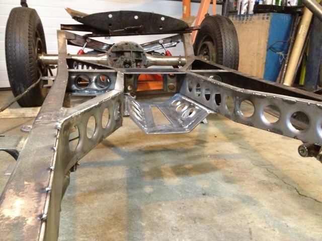

    -I'm using the original rails but 40-ish rear and 32 front crossmembers. There will be a custom x-member of sorts also.
    -6" rear frame kick up
    -4" channel
    -5" or so chop
    -reversed firewall
    -Flat pickup bed. No fuel tank, battery or other stuff back there.
    -The engine is a 55 265 SBC, trans is 4-speed manual, axle is 66 Bronco
    Before really getting started
    Body off
    Frame kick up
    Pancaked rear crossmember
    Starting on the x-member
    Flipping the bones and caster correction
    More x-member work
    Starting on the channel, height of frame
    Starting to flip the firewall
    More pics to follow

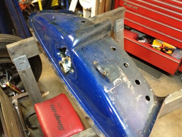

    Chopping up my nice tank *weeps*

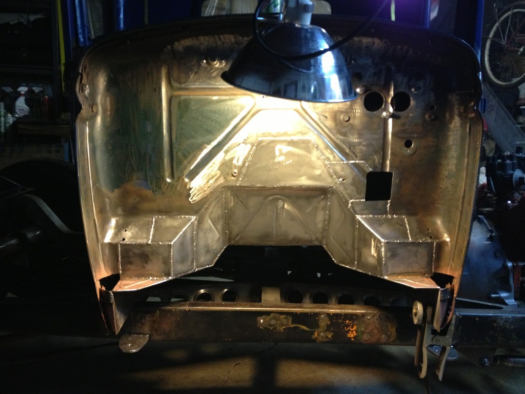

  8. Grudge
    Joined: Jun 26, 2008
    Posts: 436
    Grudge
    Here's the transition. I have lots of sheet metal work to do. I think it would've been easier if I hadn't flipped the firewall; there's just not a natural transition to the frame now.

  14. Grudge
    Posts: 436
    Grudge

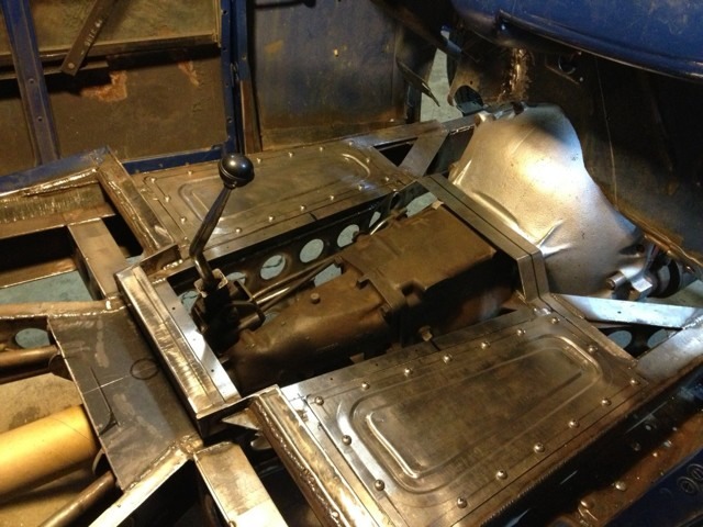

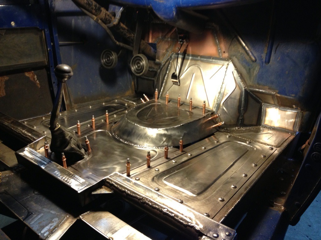

    Finally made some progress on the firewall/floor transition. Sort of a faceted stealth bomber look, since I'm not too great with sheet metal.
    Pieces
    Many welds later (my frame makes a nice workbench)
    And finally back in position.
    I still have all the inside welding plus grinding, sanding, etc., but it's a huge relief to have a foundation I can work with. For a long time I just sat and stared and thought "what the fuck is this going to look like?"
    Today I'll focus on the transmission cover.
    Aaron

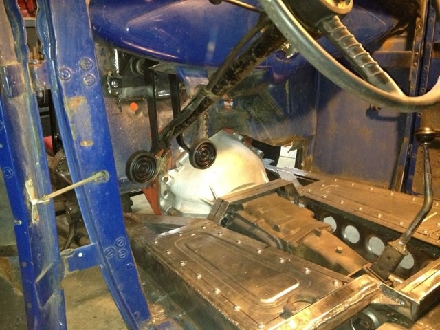

    fleetside66
    Really nice work, Aaron. I like the stance. When you make your trans cover, you might consider working on your seating & right leg & foot positioning in regard to the transition from the gas pedal to the brake. Perhaps you could experiment with a small cantilevered deck in that area so that you could slide your right foot smoothly from the gas to the brake. Obviously, you're going to have to rest your heel on the trans hump to engage the throttle. It's always nice to have a place to rest your heel for the brake, too, so that your leg isn't hanging in the air. Just something to think about. Keep up the good work.
    oneredryderone likes this.
  17. Grudge
    Posts: 436
    Grudge
    Good advice, thanks. Judging by your avatar (pickup) you are probably aware of how cramped I will be, especially because of the flipped firewall. The pedal layout, leg position, steering wheel diameter, shifter and parking brake are swimming around in my head right now.
  18. fleetside66
    Joined: Nov 20, 2006
    Posts: 3,003
    fleetside66
    Yes, you're right...mine's channeled 5," with a flat firewall & I do have similar room constraints. However, if you're not a real big guy, it's all perfectly doable. It's just good (at the stage you're in) to really start fooling around with the ergonomics. If you find that your right hip area might be interfering with the shifter, you can bend the handle to the shotgun side for more room. I got lucky & found a shifter handle in a junk yard that was already formed that way. Also, you could even lengthen your pedals if need be. I see that they're solid, so that wouldn't be a huge undertaking. But, if you're comfortable with their height, leave 'em be. My wheel diameter is 15," by the way, and I do have a floor mounted dimmer switch the the left of the clutch pedal. Everything works, but, man, it's close. As far as the parking brake goes, that would be on the right side of the hump, so not to worry. After all, the passenger should be able to feel what a hot rod is really like, too.
    brEad likes this.

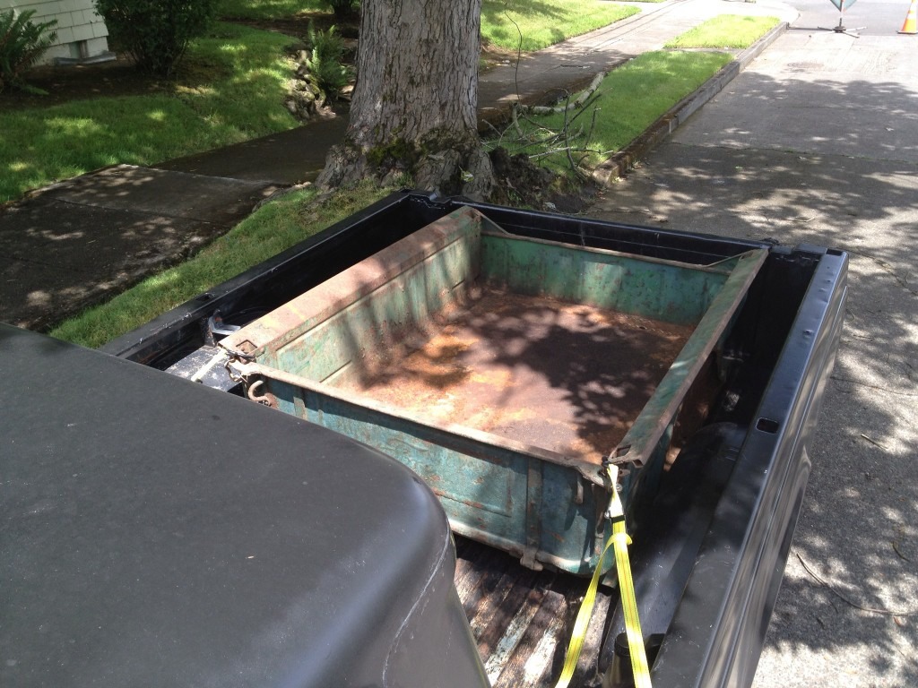

    Here's the bed, picked it up from a fellow HAMBer, can't remember his name though, nice guy.
    Also thought I'd show what the firewall looked like before I started. Somebody put in one of those manifold heaters. Whoever did it did a really nice job for a guy who only owns a hatchet and a torch.
    I actually ended up using part of the heater cover plate as a patch panel, so it worked out.

  27. Noland
    Joined: Oct 16, 2007
    Posts: 1,235
    Noland
    looking like a awesome pickup. I like that you not putting a gas tank in the bed. I always think it looks alittle crappy. Frame looks nice. Good luck

  29. Grudge
    Posts: 436
    Grudge
    Hell yeah!

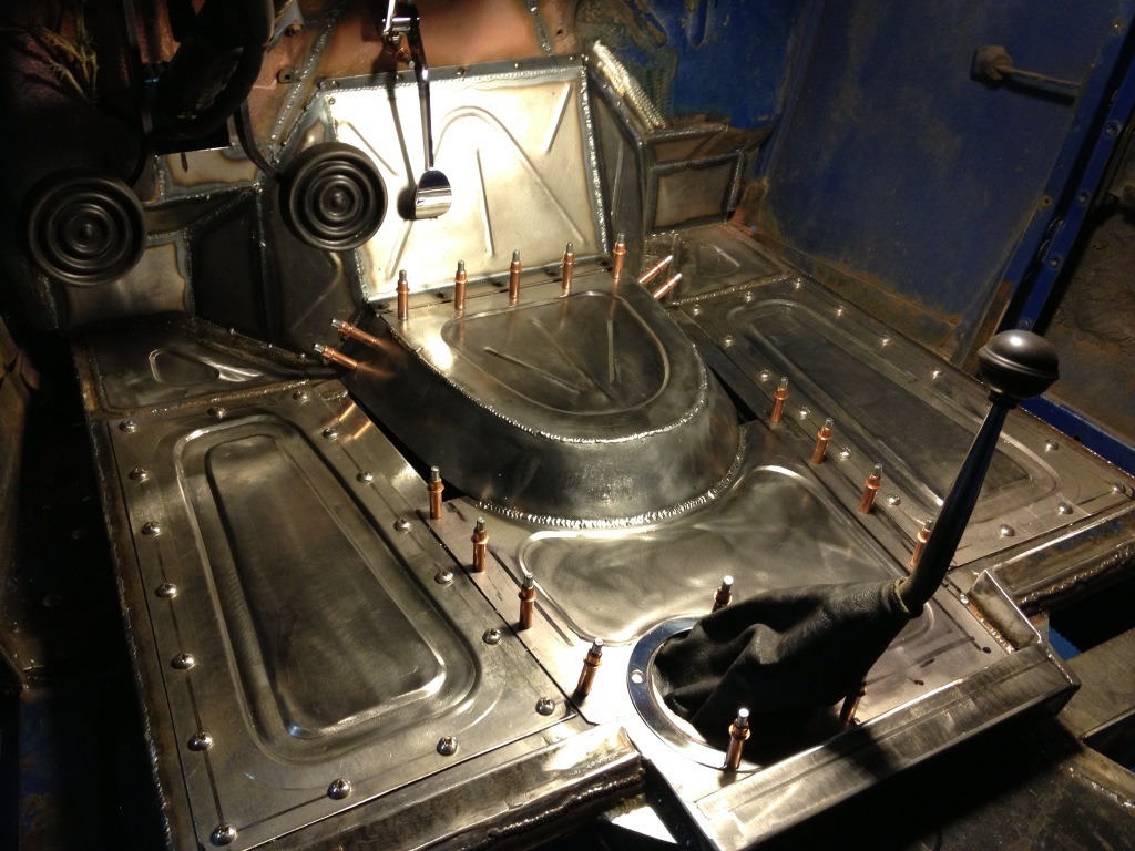

    Quick update, managed to get most of the transmission cover done.
    Turned out ok, still need to grind and smooth it out. Looks a little like a toilet seat. There, I said it, now you don't have to :)
