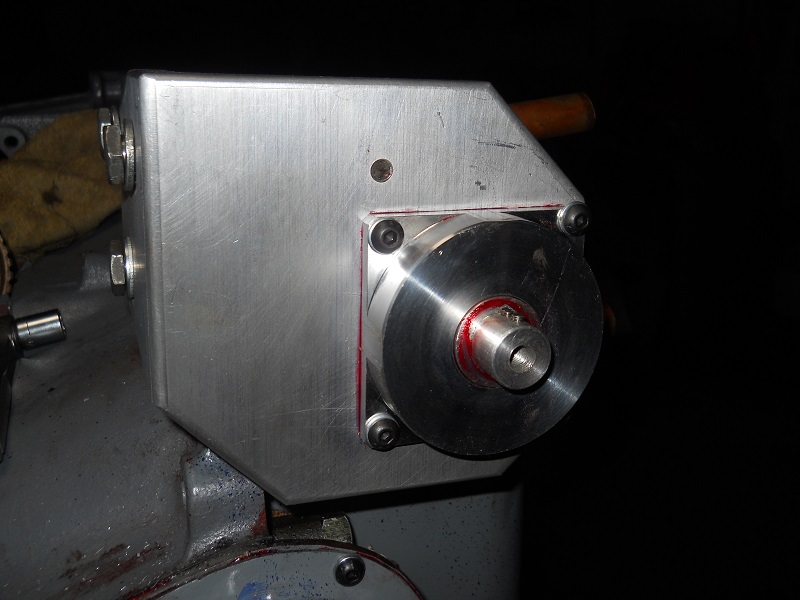

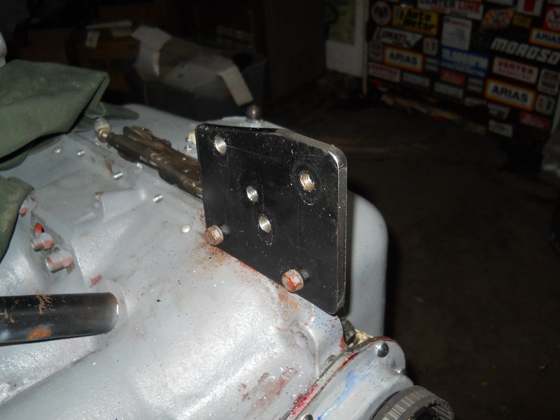

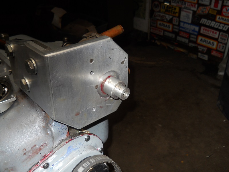

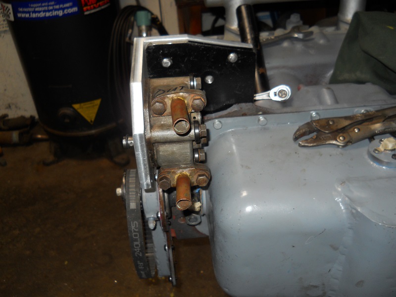

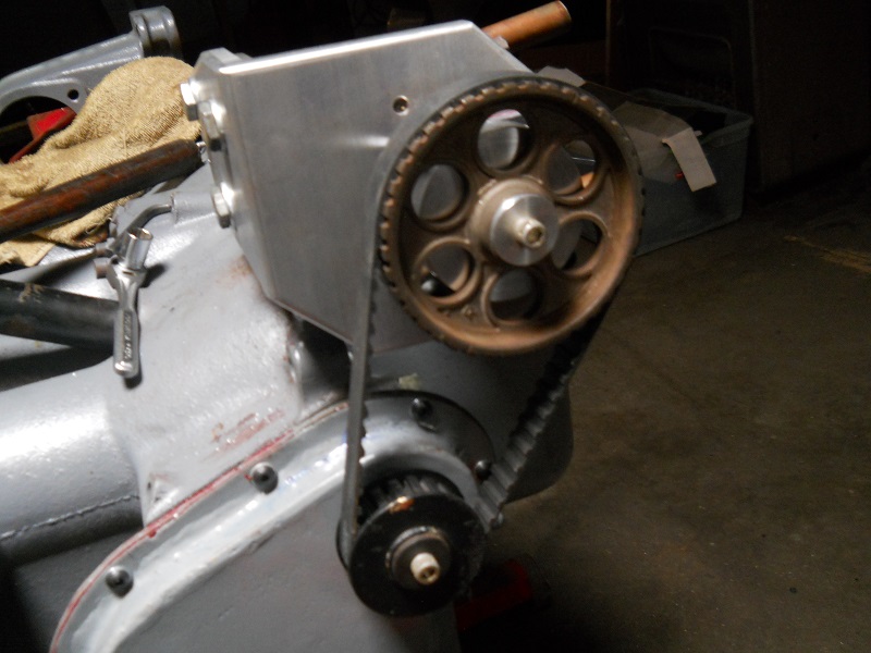

    Don't think many if any will want to do this. But when I got my 28 Chevy motor id had an external oil pump installed where the distributor normally goes. I didn't like that as I wanted to put the distributor there and the toothpick cam had been undercut when reground to the point I didn't trust it to drive the pump. So I cut a piece of scrap steel I had to bolt on where the generator would go. Then I bought an aluminum angle and drilled it to mount the pump and slotted it so that it would adjust belt tension. I made a small extension for the pump drive shaft.
    gas pumper likes this.

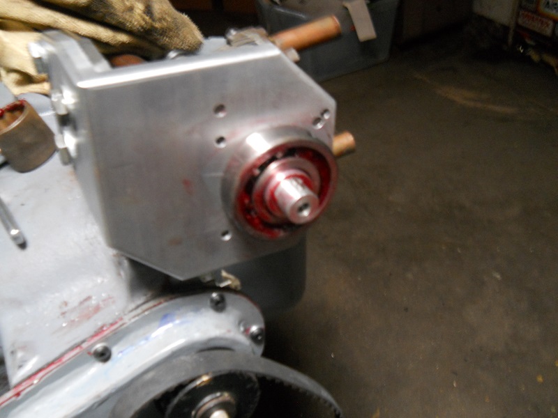

    Then I packed a bearing that somebody gave me about 30 years ago. It was in a Honda box and the pulleys are off of a Gold Wing. So that's cool. I made a bearing retainer and used Loctight gasket eliminator hopefully seal it. I used O rings inside. We'll see. Then I put the pulley on and it's done. I hope. Granted, it's not pretty. But I am trying to use the parts that came with the motor as much as I can.
    Outback, BradinNC, gas pumper and 2 others like this.

    Herb Kephart
    Rich--you comfortable with using a smooth OD copper on the high pressure side of the pump? Rubber hose might slip under "pressure".
    And yes--I have had it happen. I was lucky that I caught it in time--and unlucky that it happened.
    Herb

    No. Actually. I would never use the lines that came with this engine. Those were on the pump when I got it. Now that I have the drive done I can proceed with switching everything to JIC/AN fittings and hose.
    BradinNC likes this.

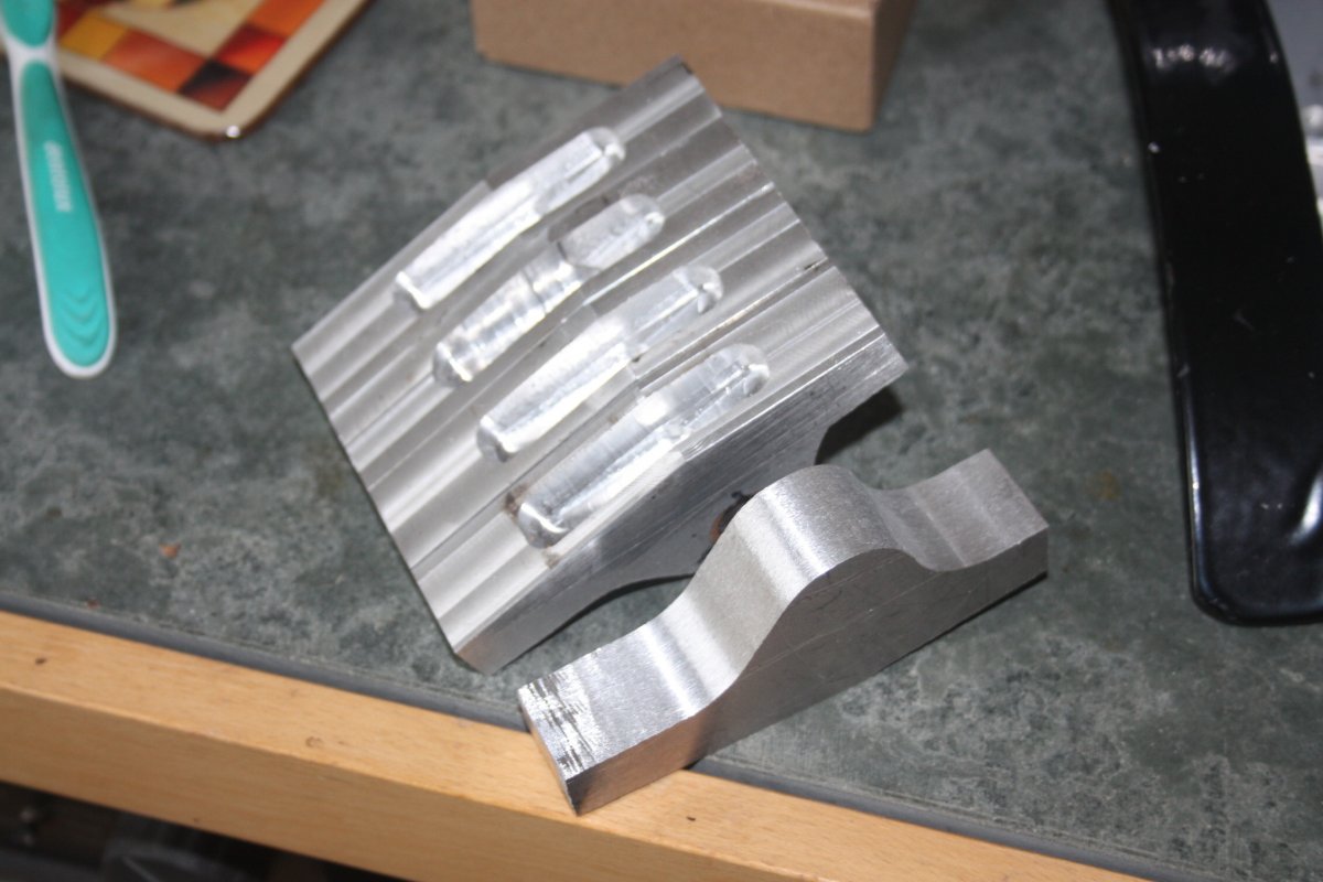

    So been a bit busy making a few bits
    The first is a side draft manifold for an SU probably 1 1/8 or 1 1/4" when I trip over one. I made it according to the dimensions of the cast aluminium manifold someone kindly did some drawings for some time ago upload_2017-2-14_14-0-39.png
    I made mine from 316 stainless as you can buy the 1 1/2" bends from Fla bay . Not sure that I might not make a smaller one in 1 1/4 as I want to run a single carb . I am more interested in the bottom end pickup and torque then outright power.
    Next is a mostly complete set of billet followers in 6082 alloy . IMG_7867.JPG IMG_7865.JPG upload_2017-2-14_14-0-39.png
    Not the perfect material I know but thought it would give me a bit of practice. I have got to make a set for my other head and will use the the 7075 for that and make them with a flat top as they do not need the extra strength
    Still got to sort out the rest of the valve train . 4130 tube for the pushrods is proving more difficult to obtain than anticipated. Several UK suppliers having stopped stocking it as lots of it is made in China and does not do what it says in the tin.
    Sent from my iPhone using The H.A.M.B. mobile app[/QUOTE]
    BradinNC and bct like this.

    Nice job on the rockers, but I would round the ends after the other machining is finished. You were probably figuring on doing that. I like the stainless manifold also. The fact that tight radius bends are available makes construction a lot easier for things like manifolds.
    Keep up the good work!
    Herb
