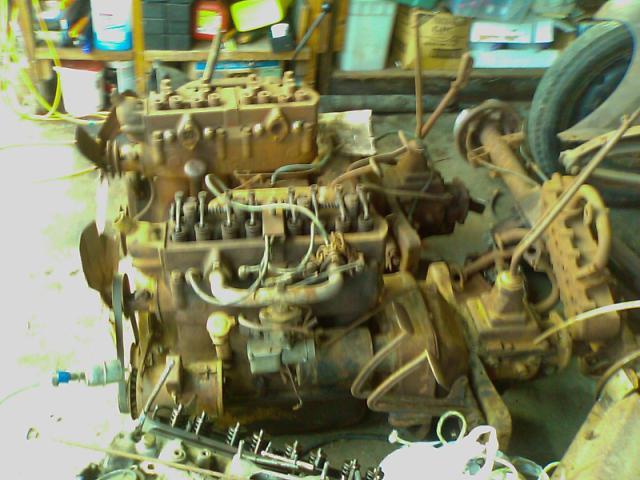

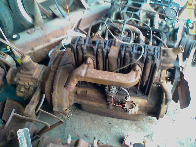

  11. RedRodder
    Joined: Oct 1, 2009
    Posts: 122
    RedRodder
    Some picks, obviously the one with the carb and rockers is the runner :)

  12. Bigcheese327
    Joined: Sep 16, 2001
    Posts: 6,694
    Bigcheese327
    Cool. I say don’t add full-pressure oiling and run it without a valve cover.
    -Dave
