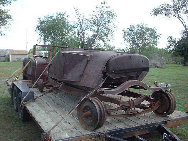

    Anybody have pictures of the differences between 26 and 27 ford roadsters/tourings? I bought a couple and want to ID them for title info.

    I know there are a couple subtle differences. I think in the dash, maybe doors (body lines), and door latches?
    Yes one was a touring-the other 2 are definately roadsters.

    Here is a shot of the cowl/door jamb "Bump" the 1926 bodies had it 1927 or later '26's didn't. I agree the early door latches were square and the later ones were more like a 28-31 A latch.
