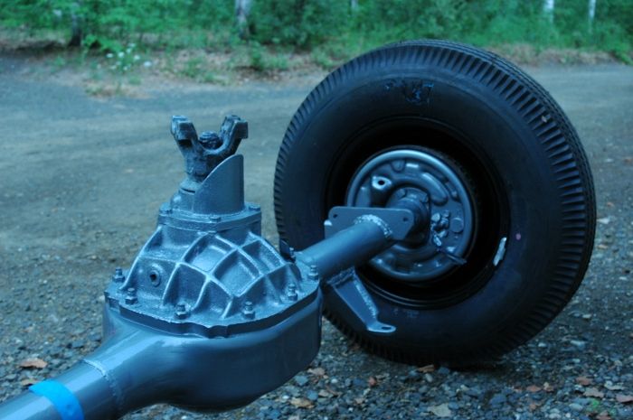

    Got my rear axle squared away today and ready for a brake rebuild. New seals all around, painted (not show quality), and new wheel studs in straight, true, and cut to length. I found out that there's a mini spool in the diff so I don't know how annoying it will be in the summer..... But it sure will help in the winter!

    I primed and painted the rear end and driveshaft with the same single stage paint as the front axle. They aren't the best because I am the orange peel master! If orange peel was cool, I would be the king haha. they look good enough for what they are though. I only sanded enough to clean the metal... All the nicks, crappy welds, and flap disk mark are still there under the paint.

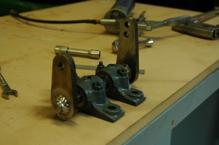

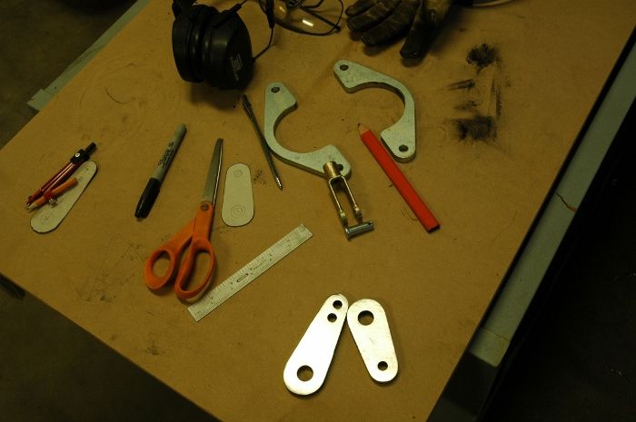

    On the other hand, I am pretty proud of the clutch linkage that I made. I started with two really cool 5/8" split bearings and shaft that I found. I have always liked split bearing for some reason so I couldn't resist using them. The levers are made from 3/8" plate and 3/8" fine all thread and clevises. The pivot balls between the rod and clutch fork are the little dome bearing/washers that go under the nut of a regular 302 ford rocker arm. Pedals are modified '52 F-6. I don't know how long the bearings will last-- but I can always replace them with bronze if they fail. Just for someone else's sake: A stock 302 ford clutch fork has a max travel at the pivot ball of 1.125 - 1.25".

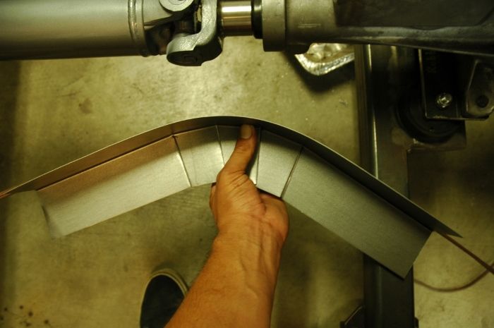

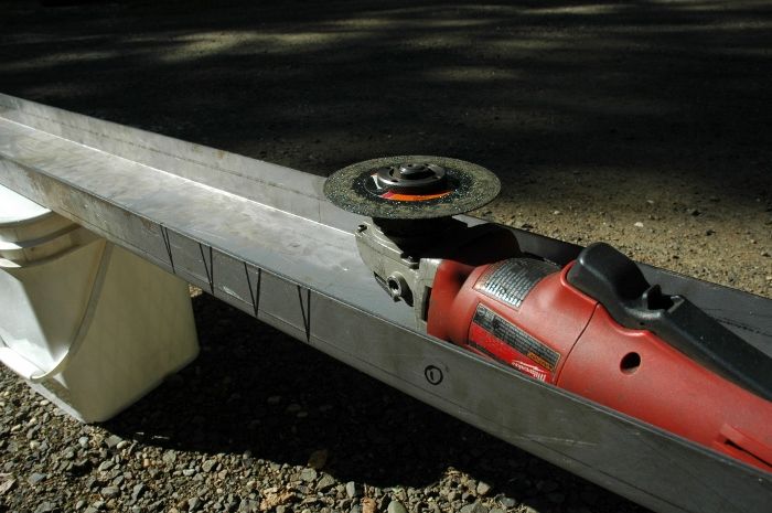

    Next on the list is an X member to strengthen the frame and my pedal bracket. This I made of 10 gauge "pickled and oiled" steel and bent on a big brake... Unfortunately this cost me money because I don't have a brake, but I'm happy with the way it turned out. I used the bobbled pie cut method and it turned out pretty neat.
    The thin l metal was cut and the overlaps were traced with a sharpie for the pie cuts. I marked the extension cord at the c-clamps and at the first cut, then measured the length afterward.
    Pie cuts...
    And here is the finished product.
