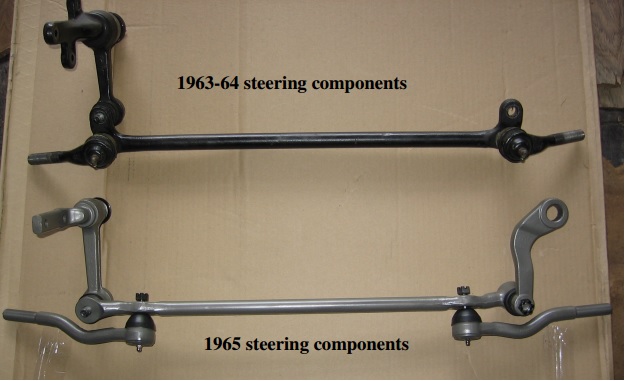

The '64 Comet used the quick-ratio box with both power and manual steering (one of the myriad small differences between the Falcon and Comet), so swapping to a Mustang box won't improve that aspect. It should be noted that late production '64 Comets used the better Mustang-based '65 steering, if you have the late steering the Mustang box will be a easier swap.
I have seen quite a few ‘64 Comets in my life and I have never seen a ‘64 with the ‘65 style steering unless some had converted it. The ‘65 steering design is superior in that it does not have the bump steer like a ‘64 does. I have installed a ‘67 Cougar manual box and tilt away column in my Comet along with the ‘65 steering components. I found this photo on line which shows the difference in design of the two years of Comet.
Hmmm... Thanks for this, which effectively answers my question. Looks like the only way for me is to eventually go with a rack kit (RRS in Australia offers one which corrects all of the geometry issues you mentioned, although it's a bit OT for this forum). There are a number of things which suck in the EU, and not being able to easily and cost effectively source parts like you mentioned is one of them lol.
