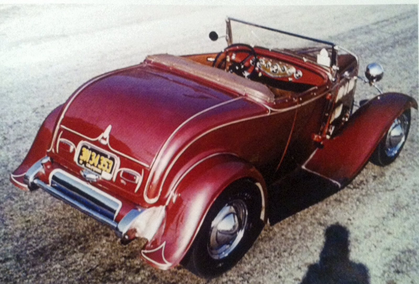

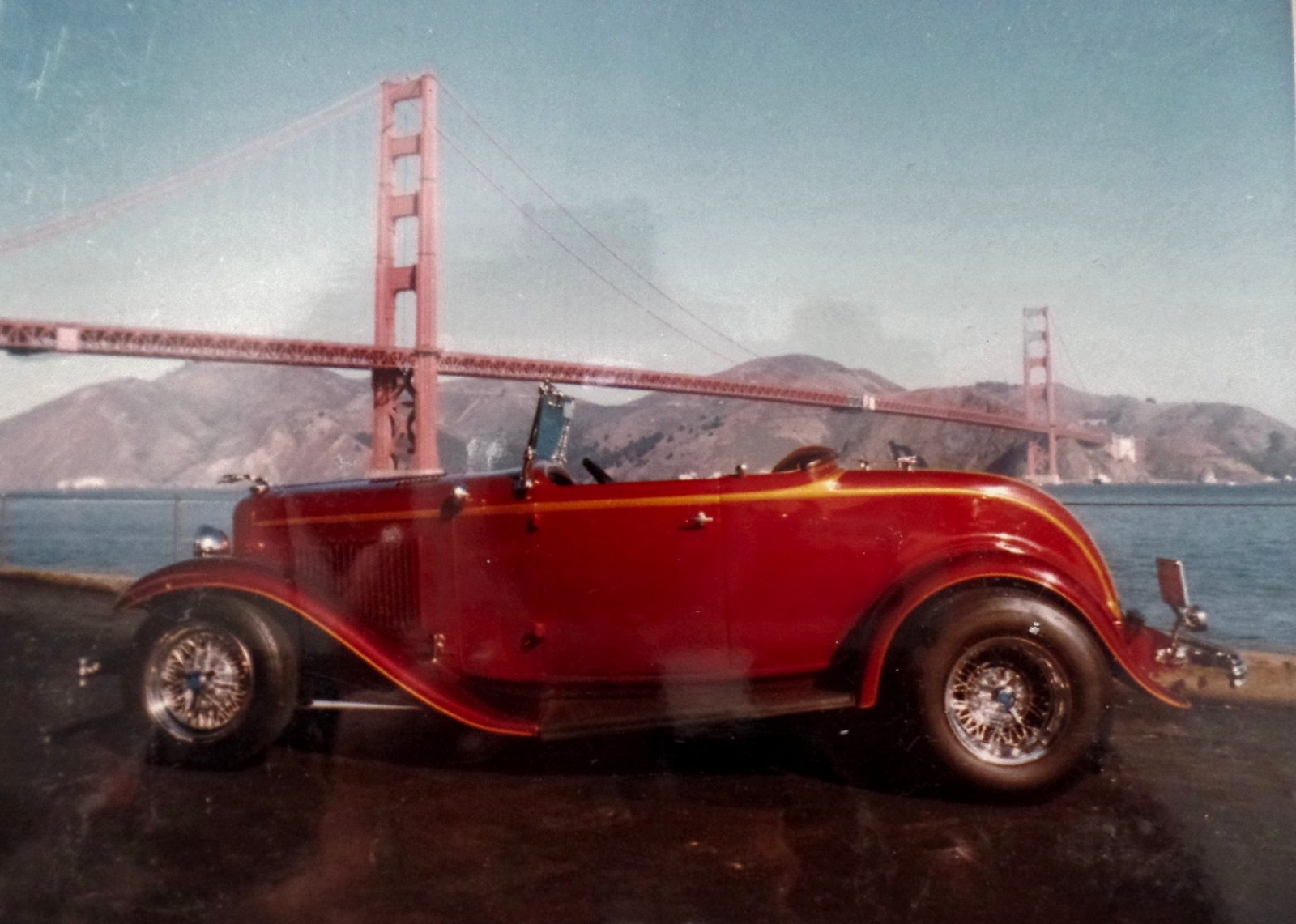

    I think it was the next day back that I received a private message right here on the HAMB, from Flip "Deadfast 33". The content of that message basically laid out an idea to trade the complete, titled rolling chassis under the '32 Tudor for his roadster body. I had to ask to make doubly sure that I was on the same page...was this the '32 Roadster body that he had scored not all that long ago?
    http://www.jalopyjournal.com/forum/threads/need-help-with-history-bay-area-32-roadster.865305/
    Indeed it was. There are photos on that link, but I'll save you some trouble and post a couple.

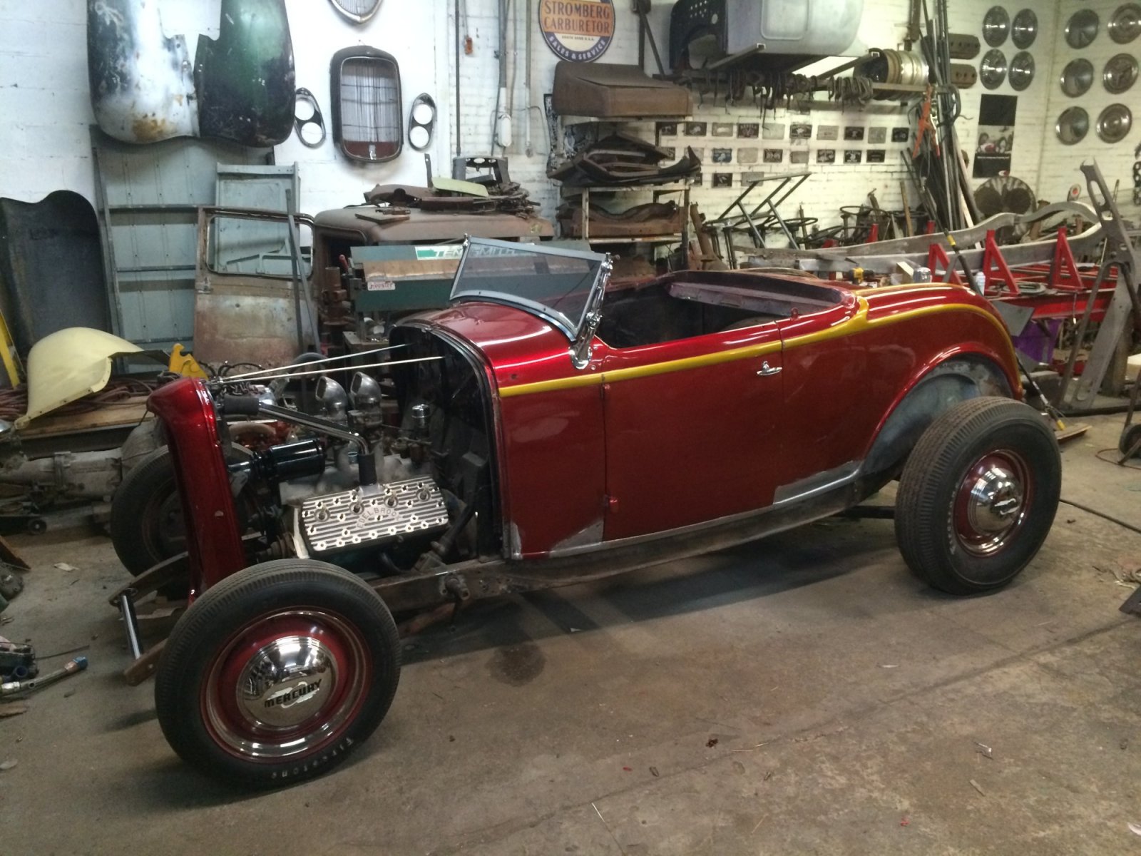

    In the meantime, I searched for any history of the car that I could find. No one seemed to remember it. By a stroke of luck, Flip ended up finding photos of the car from when it was last running and driving, in 1981, so I at least had some old photos to go by.
    Much later, I would find out that Rod Weltz of San Francisco had rebuilt the car into its last form before selling it to a nice couple that kept the car up until recently. I was able to contact Rod through the help of Marcus Edell, and Rod was nice enough to send me photos of how it looked when he bought it, in about 1979 or 80. I was surprised to see that the car not only had a Red Ram Hemi installed in it at that time, but it also had a '55 Dodge dash!
    Any history prior to this is still unknown, so if you can help, please get in touch with me. I found a 1947 Los Angeles newspaper in the driver's door, so I think it has been a hot rod since the '40s. I don't know when it was channeled, or when it came to San Francisco, but I think it was redone in about 1968, and stayed in that form until Rod bought it.

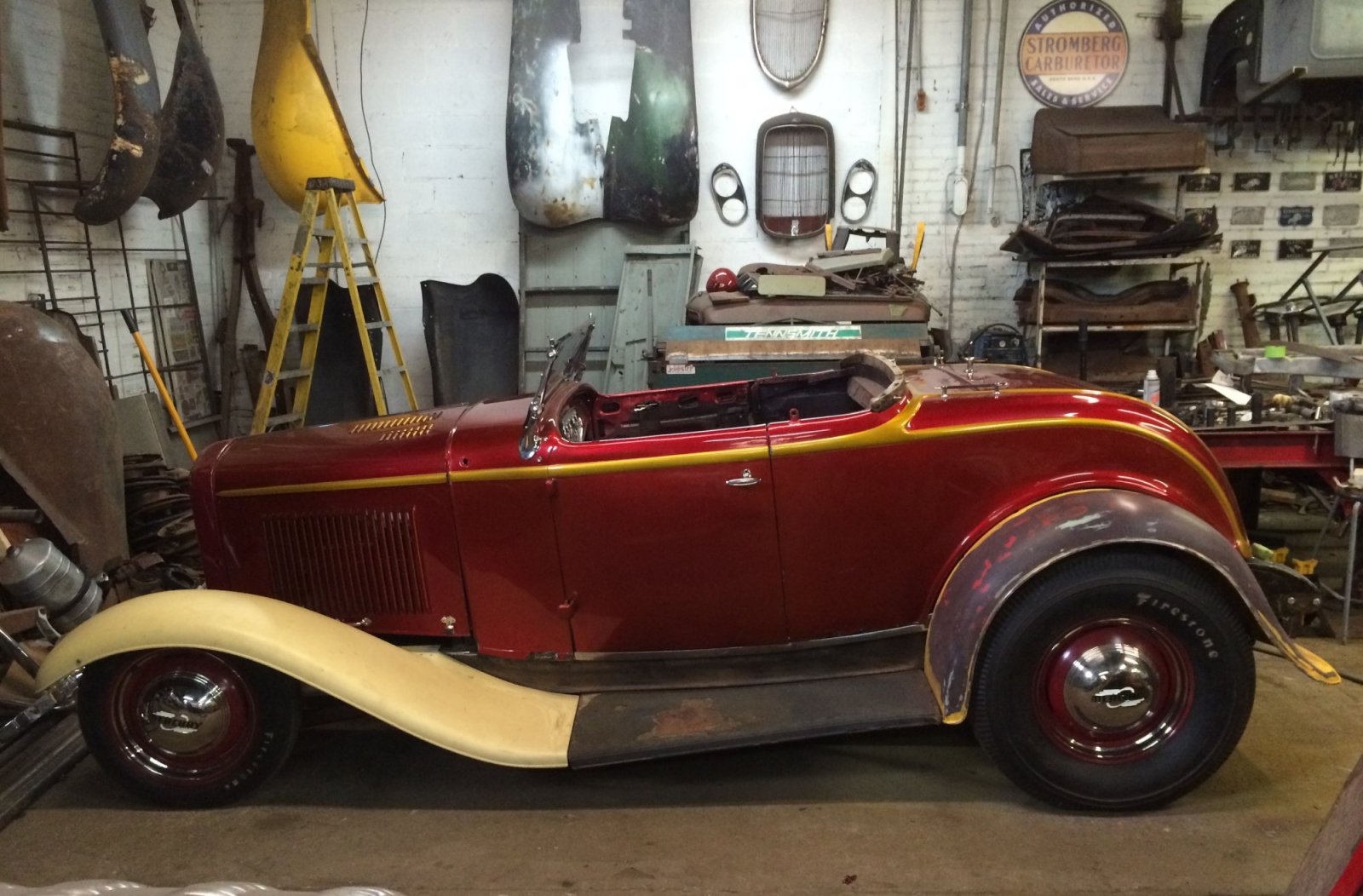

    WEEK 1
    Fast forward to March of this year. Actually, it was Saint Patrick's Day, if I'm remembering correctly. I was having lunch with a friend, and he asked what I was going to take to the Lonestar Roundup, which was exactly a month a way (starting on April 17th). The project that I had been working on with hopes of a debut at the show was looking like it wasn't going to make it, no matter how hard I worked, or how many hours I put in. This was disheartening, because I really wanted to bring something new to the show. Thinking out loud, I said "you know, I think I have almost everything I need to throw my roadster together...maybe I should bring it." The more we talked about it, the more feasible it started to sound. And we weren't even drinking.
    The style of the car would be something similar to the Price/Hellmuth roadster. I'd be able to keep as much of the candy red paint on the body as possible, and end up with a car that would be early-mid '50s style.
    I came up with a plan to basically build a "bolt together" hot rod '32 roadster. Something I wouldn't have to spend a whole lot of time fabricating pieces and parts for. A basic traditional hot rod. This meant a good original '32 frame, a flathead, a '39 transmission, a '40 rear, dropped axle, unsplit wishbone, stock firewall, etc. I'd already been collecting all of those parts for my '32 5-window (that still isn't built), and most of the parts I had multiples of. This illustration of the McGee Roadster from Hot Rod Magazine is pretty close to what I envisioned.
    If I played my cards right, I could have a roadster that would look good both with and without fenders.
    The biggest question mark was the engine. There was no way that I would have time to either rebuild or find another engine and still make it to the Roundup. I had two flatheads set aside in my shop, and both were supposed to be good engines...but I hadn't torn down either of them. The flathead that I really wanted to use was a '46 Ford/Merc 59L that I had bought several years ago from my friend Ricky.
    It was pretty much complete and "ran when parked." We've all heard that story before, so I was expecting the worst. But when I started cracking it open to check condition, I was blown away by how nice and clean it was inside. I took a wire brush and knocked off the carbon, and I was shocked to see that it was STD bore as well. And even better still, this was a factory relieved block.
    I took this as a good omen...a sign that I should go forward with the idea that I could just bolt the thing together and get it to the show.

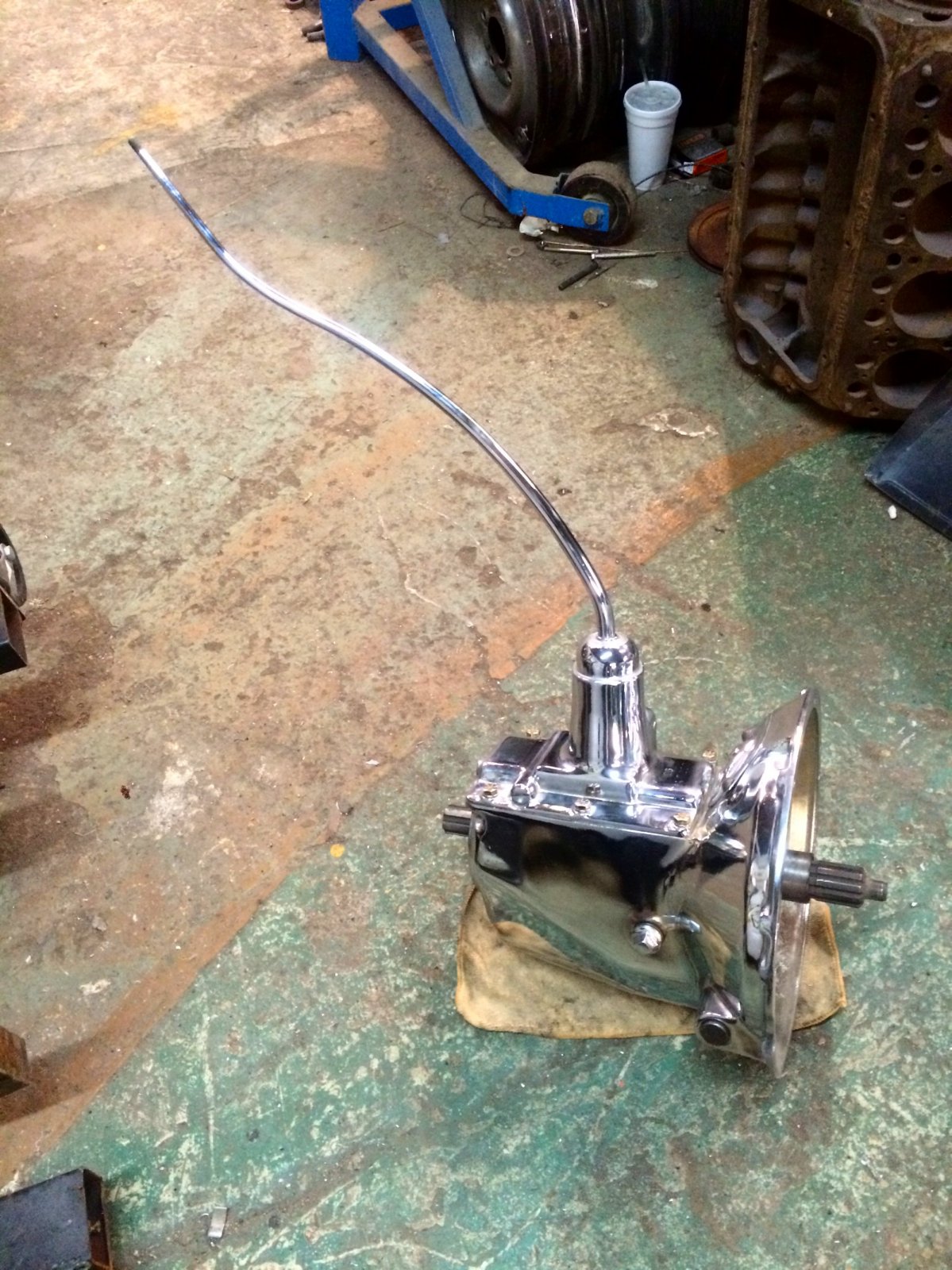

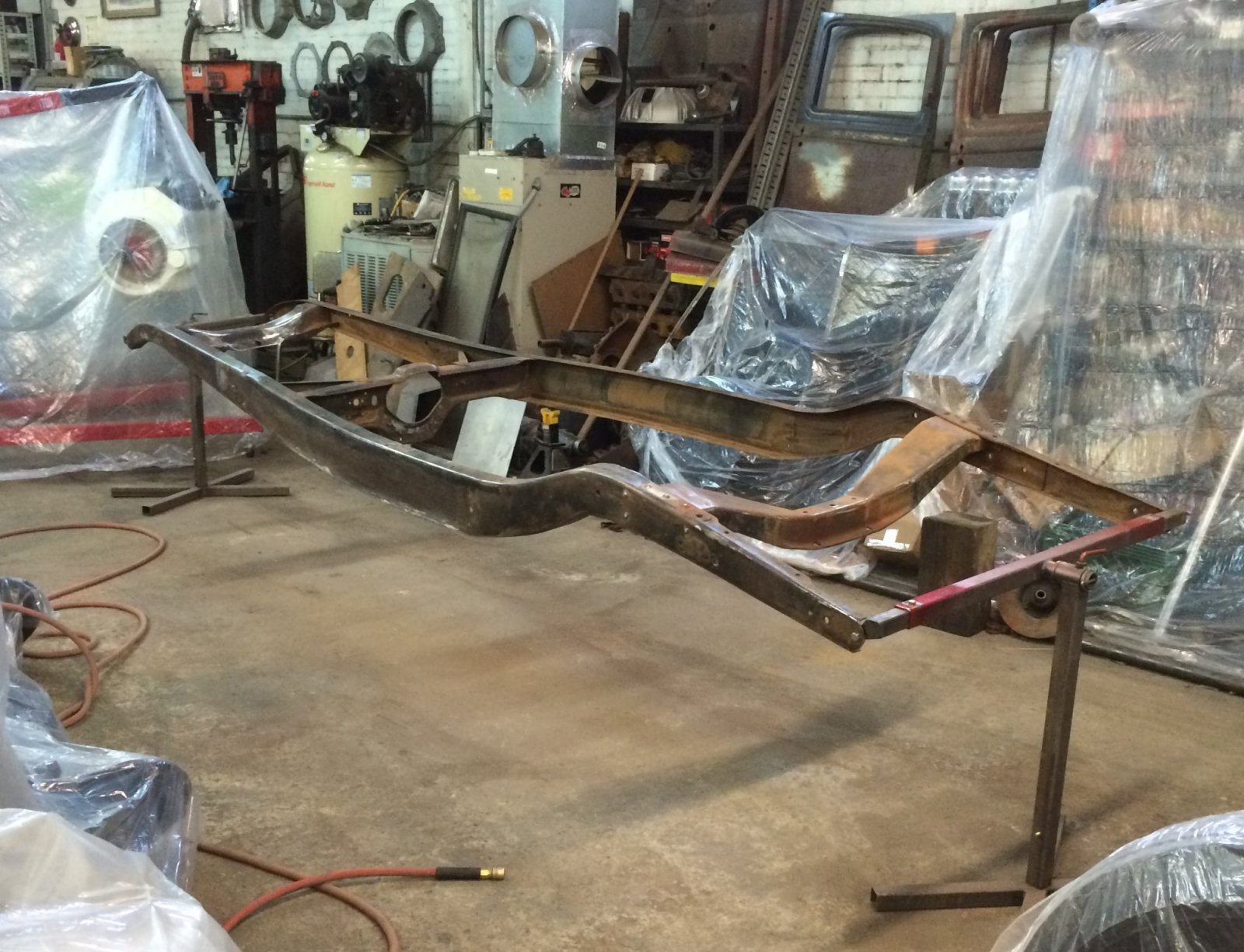

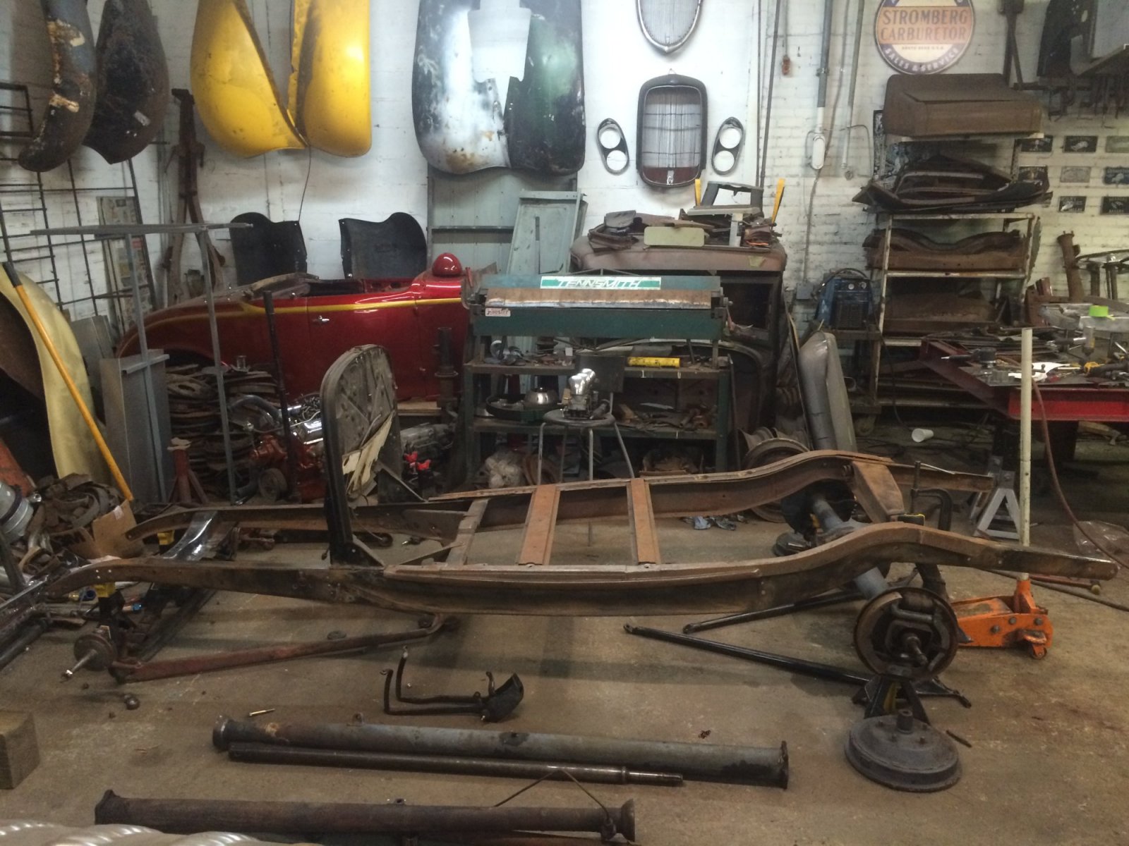

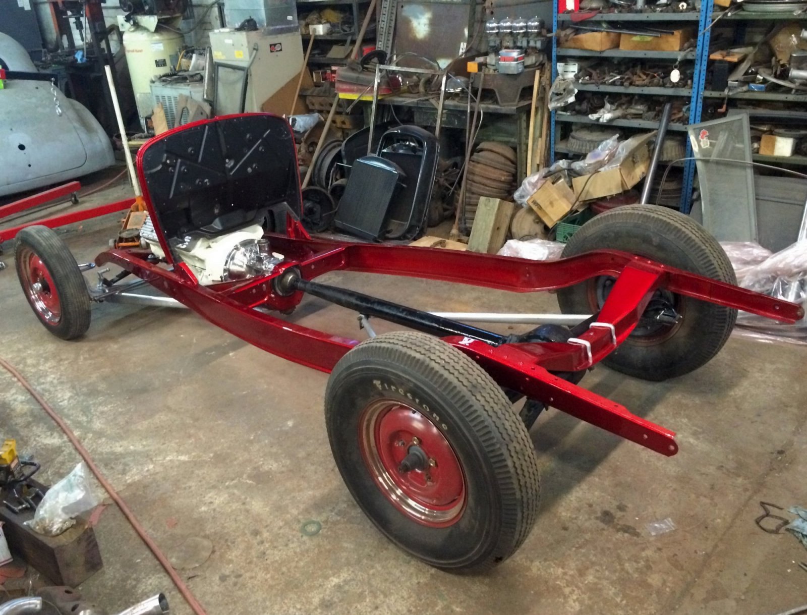

    I'd been saving this '39 transmission that I had chromed and rebuilt back when I started building my '29 roadster. I didn't use it in that car, but it seemed like a perfect fit for my '32.
    Before long, I had the frame taken down from off of my shop wall, and mocked up. The frame was a pretty nice piece, but the front crossmember was only hastily bolted in. So I replaced it with a '32 front crossmember with a Model A center section spliced in. The chassis formula was super simple. I shortened a '40 torque tube, and used '46-48 rear radius rods.

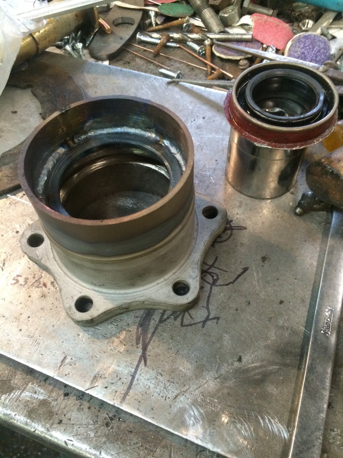

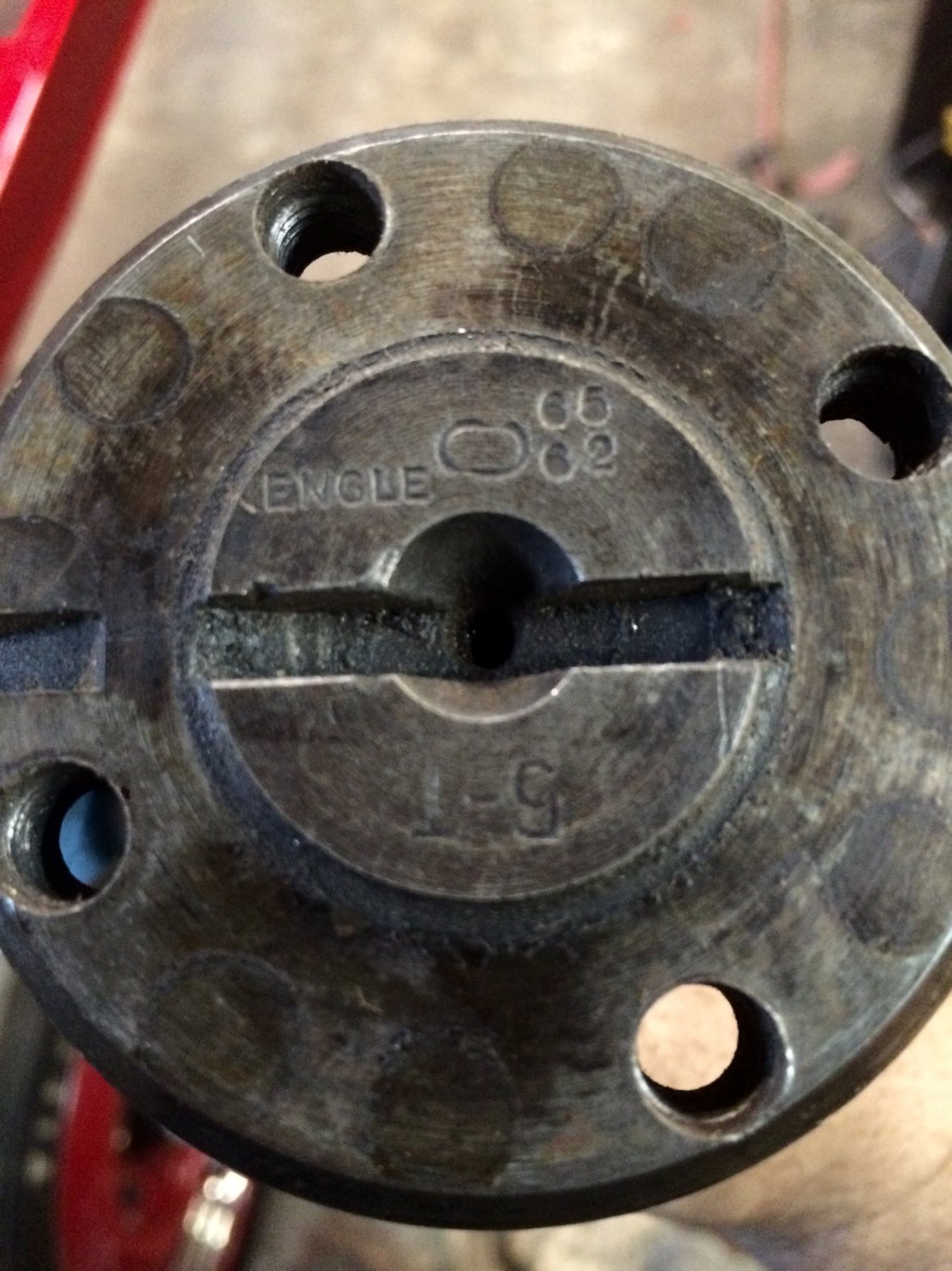

    While I had the torque tube apart, I welded in a retainer to hold a lip seal that would ride on the driveshaft or coupler.
    From there it was time to bolt it all up and see what I had.
    I enlisted the help of some friends to come help me set the body over the subrails so that I could see how difficult it was going to be to put the body back together. And then of course, I couldn't resist mocking up some fenders and a hood.

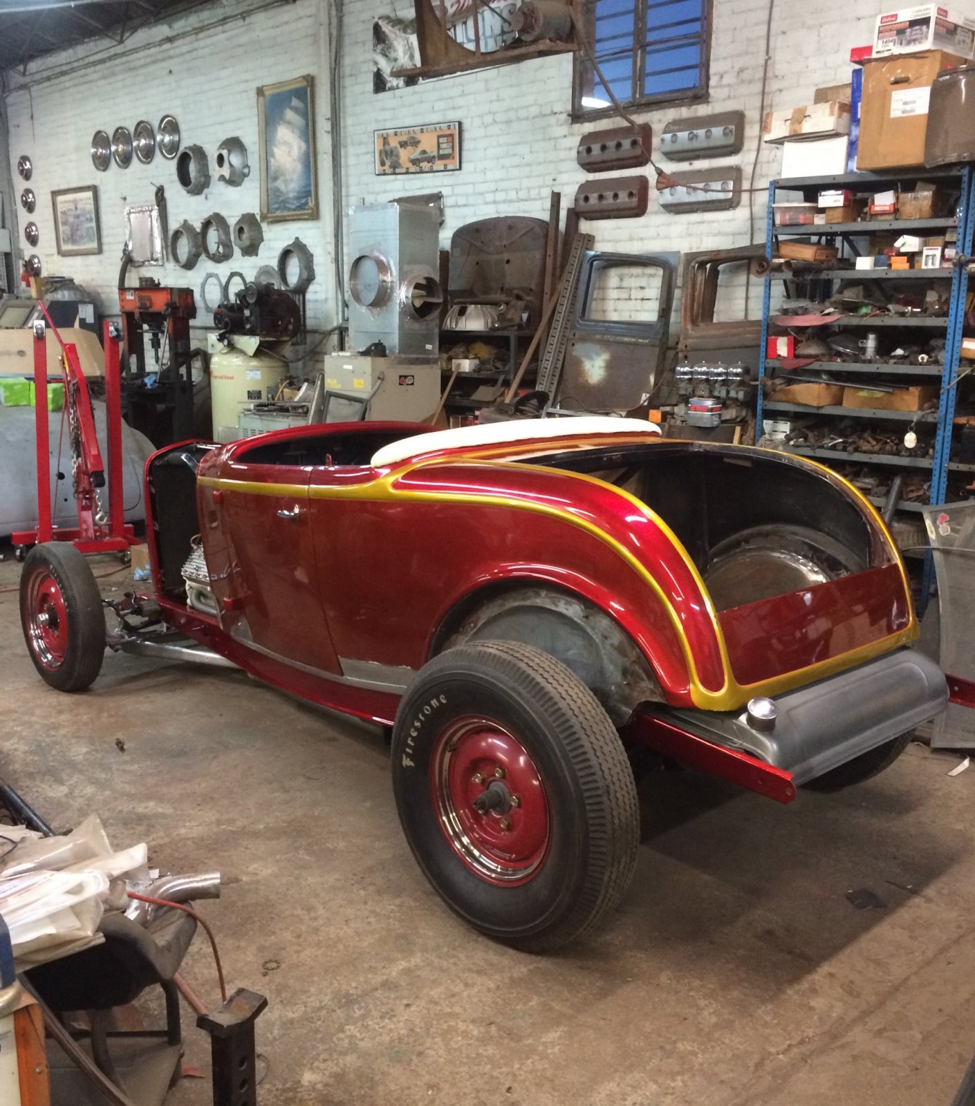

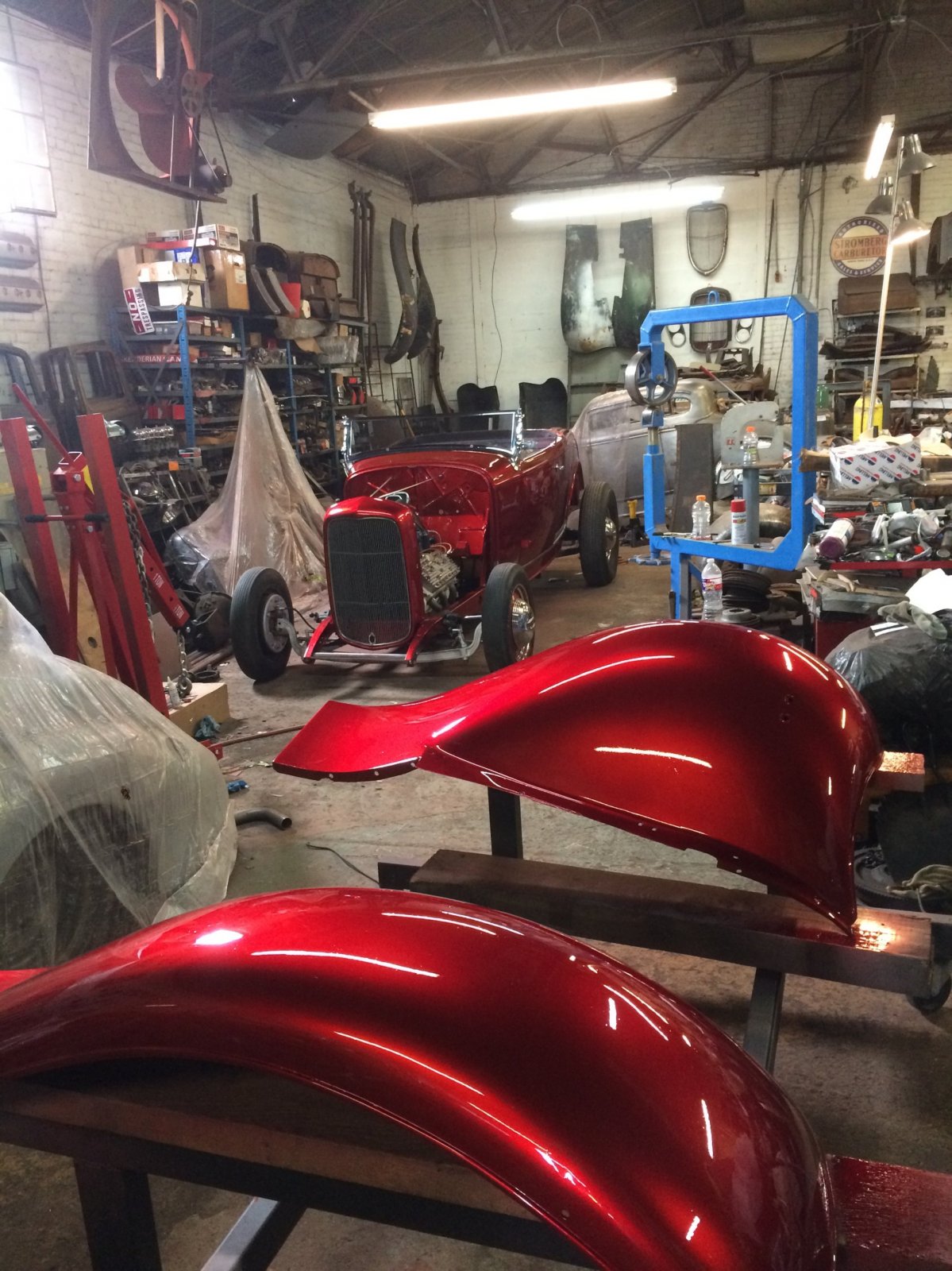

    Once I had it all mocked up, the real work could begin. The fenders I was planning to use had come off of my friend Don Lofton's '32 Roadster that he drove from Southern California to Dallas in 1969. They were in pretty decent overall shape, except the passenger side rear fender had been stored outside, and had rusted out at the bottom. I had a beat up Sedan fender that had a good bottom, so I used it to replace the bottom of the roadster fender.
    I did a little work on both the front and rear fenders, and shot them in a coat of DP epoxy primer.
    I thought that it was already starting to look really good, and I was excited that I was able to get to this point so quickly. The new Edelbrock heads that I ordered had also come in, and I'd just mocked one of them up in the previous photo.

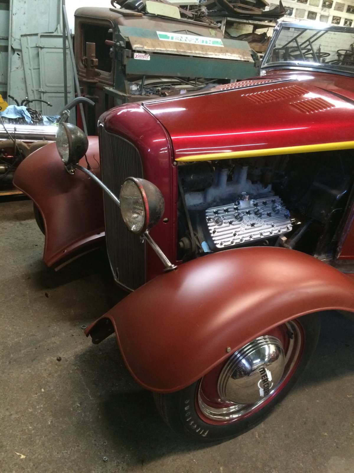

    The next morning I spent a couple of hours deciding on headlights, and I landed on King Bees mounted on a chromed original 4-cyl headlight bar.

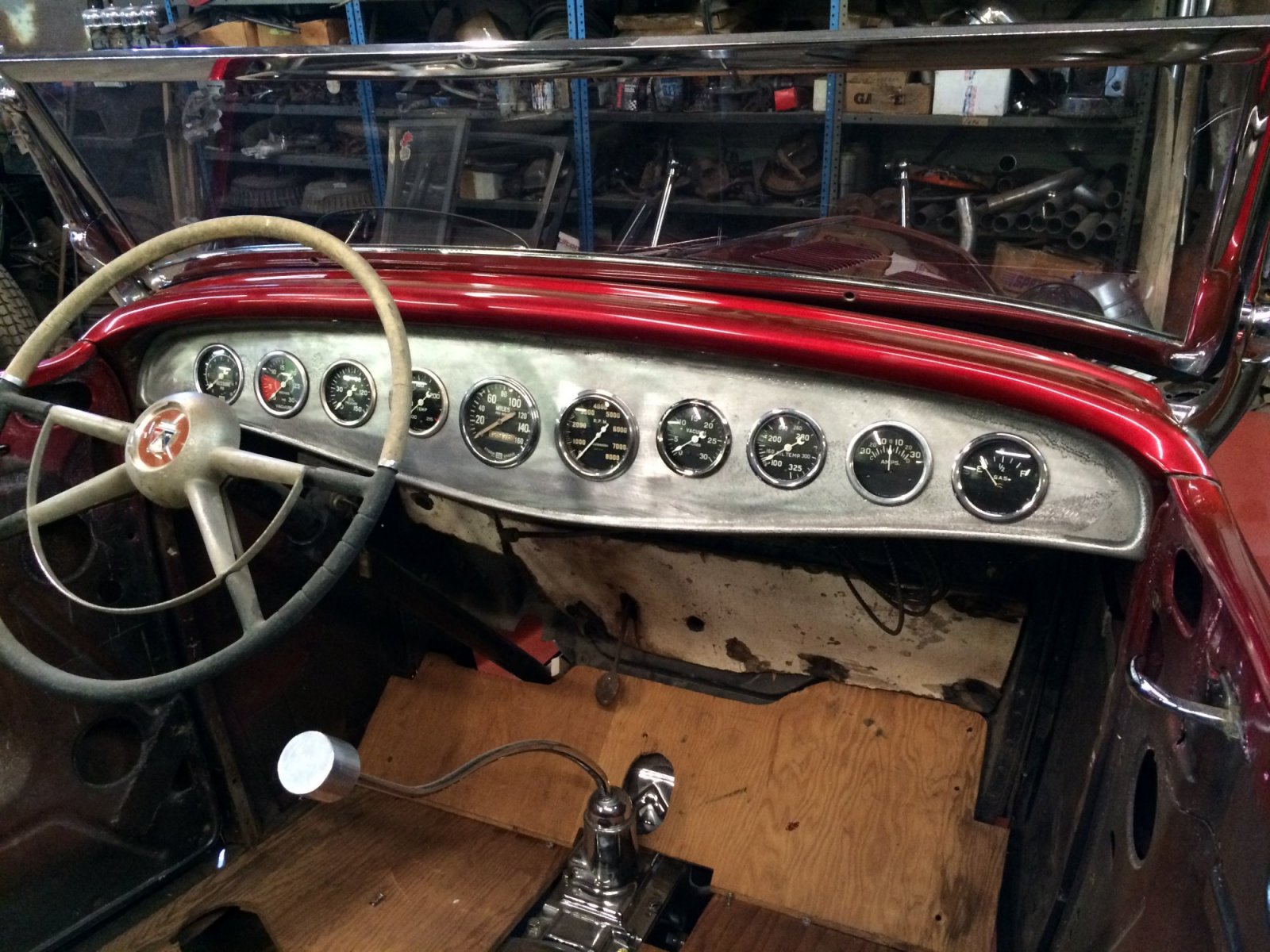

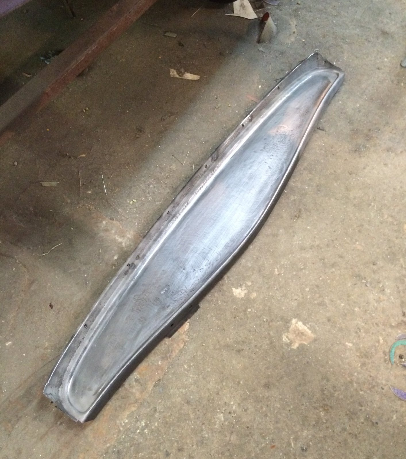

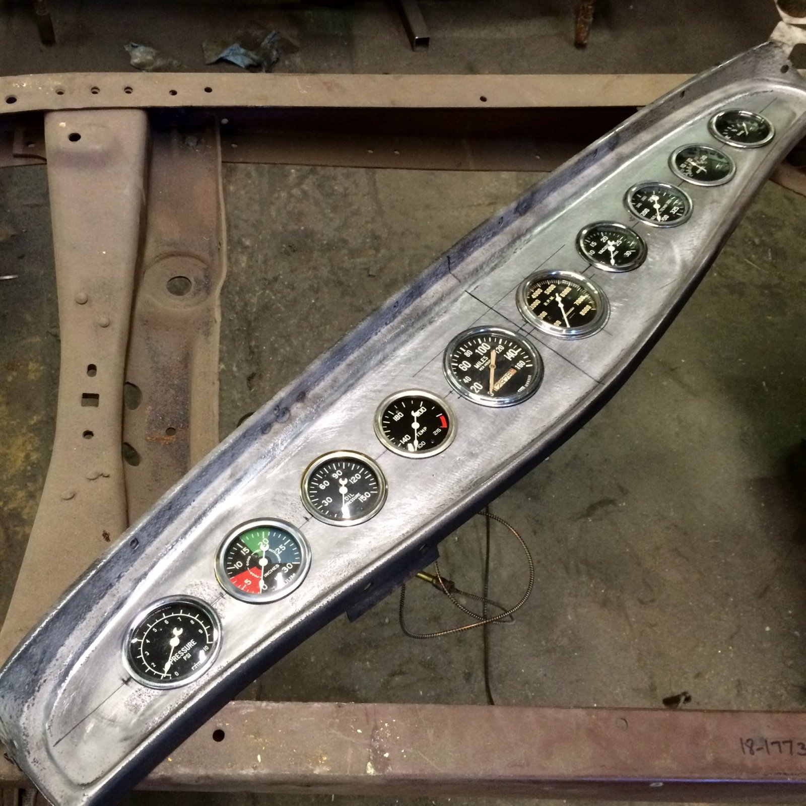

    The dash that came with the car was fiberglass, and of course I wanted to change it. I put out the word that I was looking for an original dash, and John Joyo from Austin Speed Shop graciously sold me the one he didn't use in his roadster.
    I filled the gaping hole in the middle, and metalfinished it in preparation for what was to come next.
    As I was laying out where I needed to cut the dash for the gauges, I stopped and wondered if it was just a little obnoxious to run 10 curved glass Stewart Warners in a single '32 dash. Then I said "screw it", and did it anyway.
    There are several years worth of gauge collecting represented in that dash.

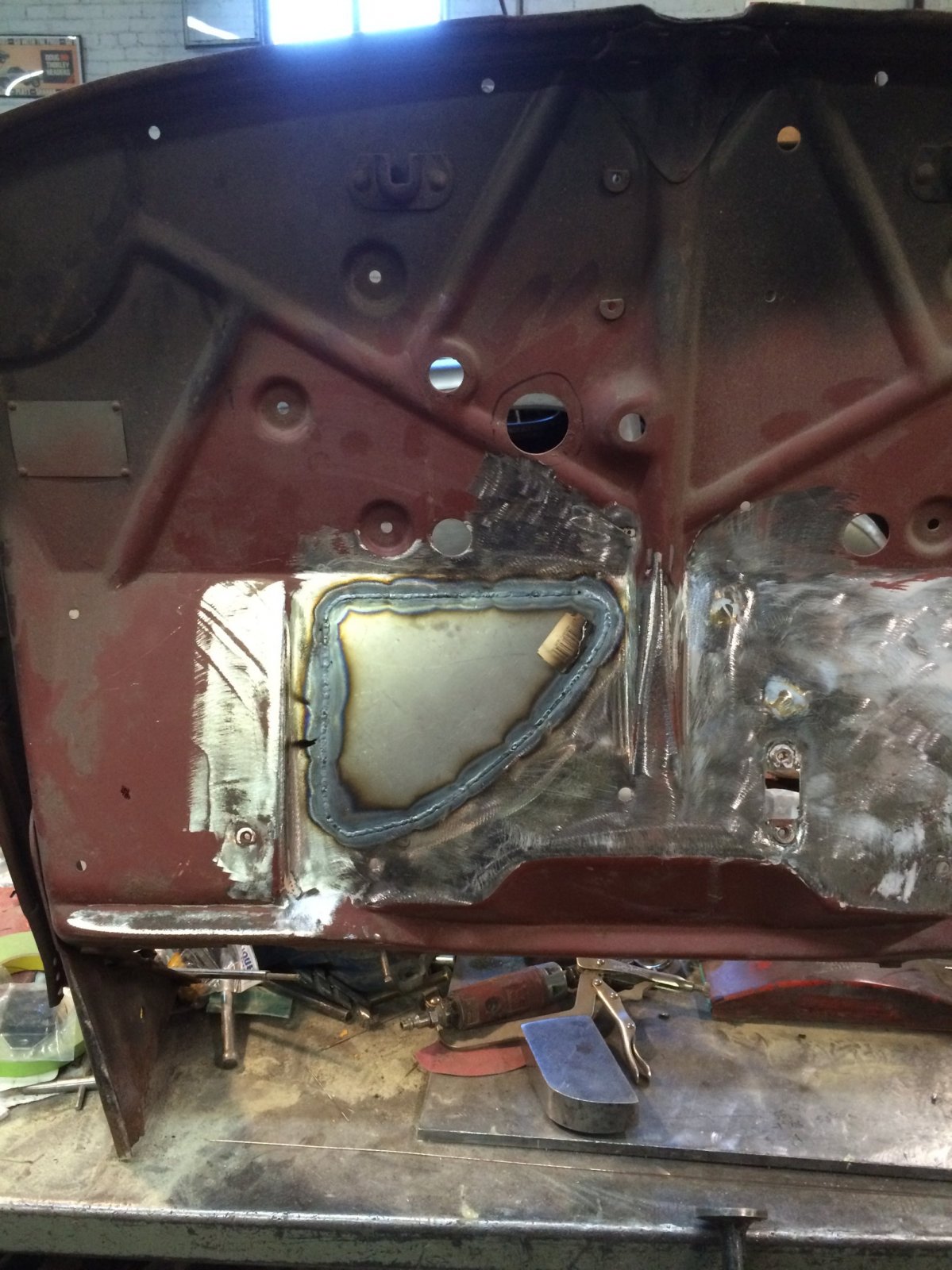

    I had a pretty good firewall set aside for this car, but it did need some work. There was a really bad patch in one spot that I just had to cut out and replace.
    After metal finishing the firewall, I put it in DP epoxy primer. I didn't use any filler on it...because as I had to keep reminding myself...I wasn't building a show car.

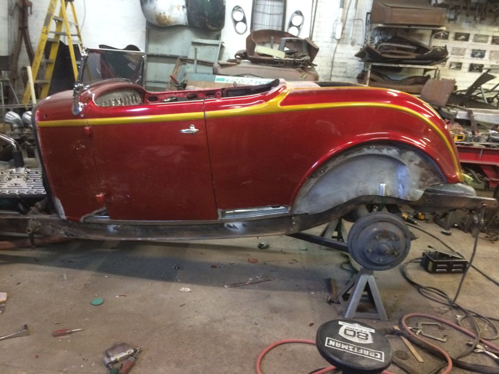

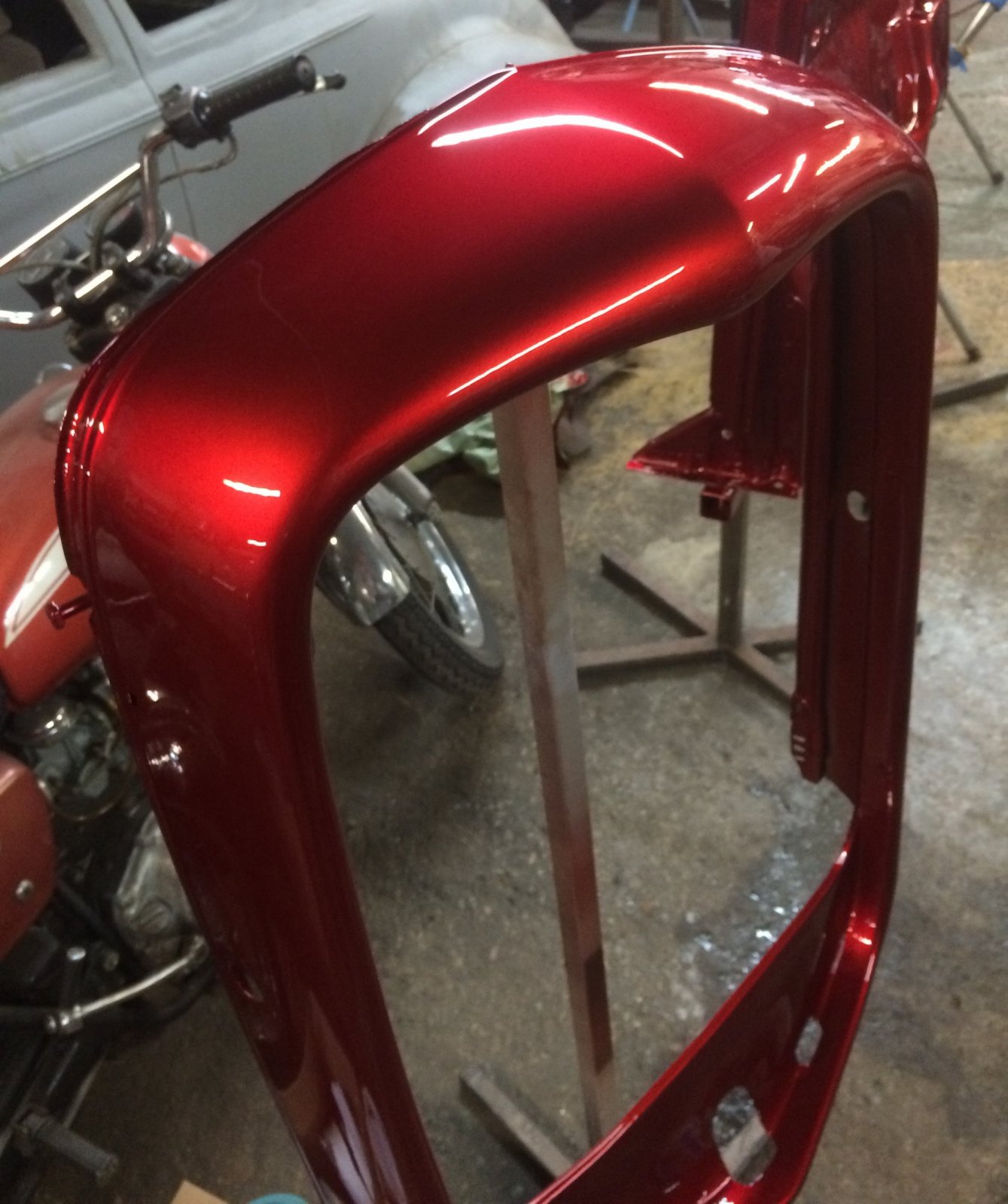

    I also filled and peaked an original '32 grille shell for the car. The shell that came with the roadster just needed too much work to get it back to where I needed it. So it was better to start with a different one.

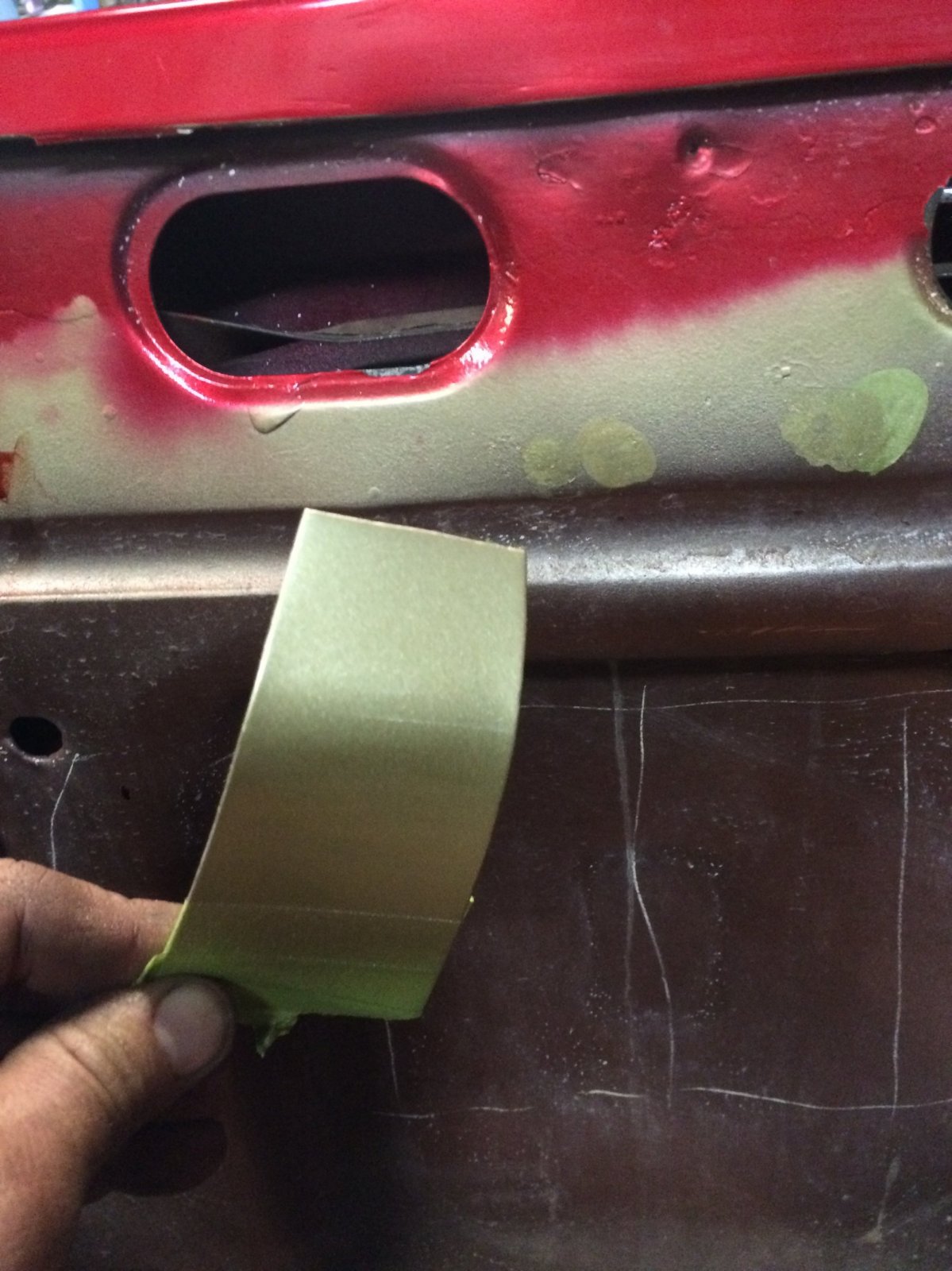

    Now that I had the grille, firewall, and headlights ready to paint, I had to figure out how I was going to match the candy on the body. Fortunately, there was a spot on the inside of the driver's door that I could use to match the base color. I mixed up a color that I felt was close enough, and then took that to the paint store to have it matched.
    I sprayed the headlights first as a test panel.
    They matched pretty well, but the color on the body was a little faded. And on top of that, it was lacquer...and nearly impossible to match. I liked the color that I sprayed, so I just went with it.
    A little later, I had the firewall and grille shell both in paint. They came out really well, and I was starting to wonder if I had made them "too nice" for the rest of the car.

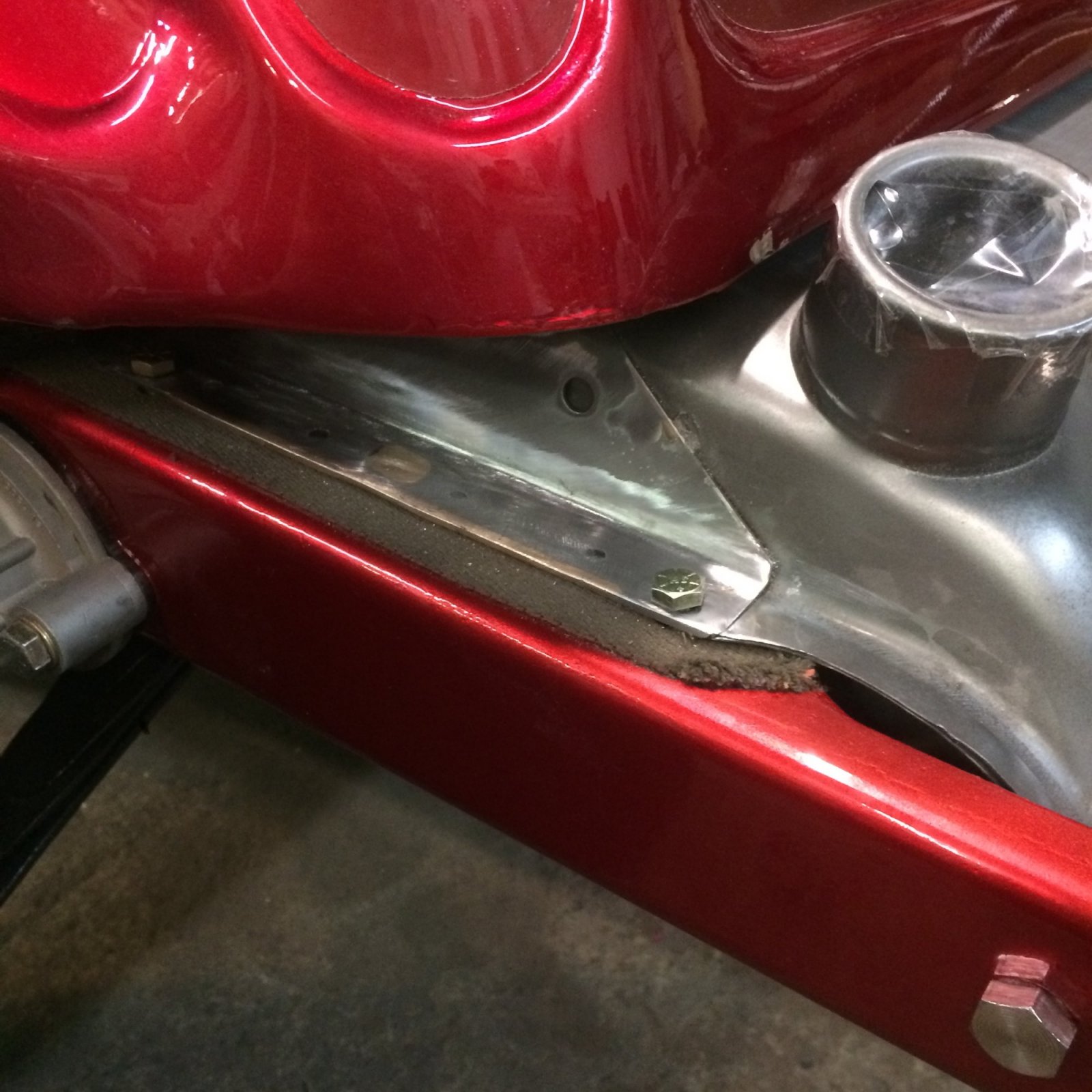

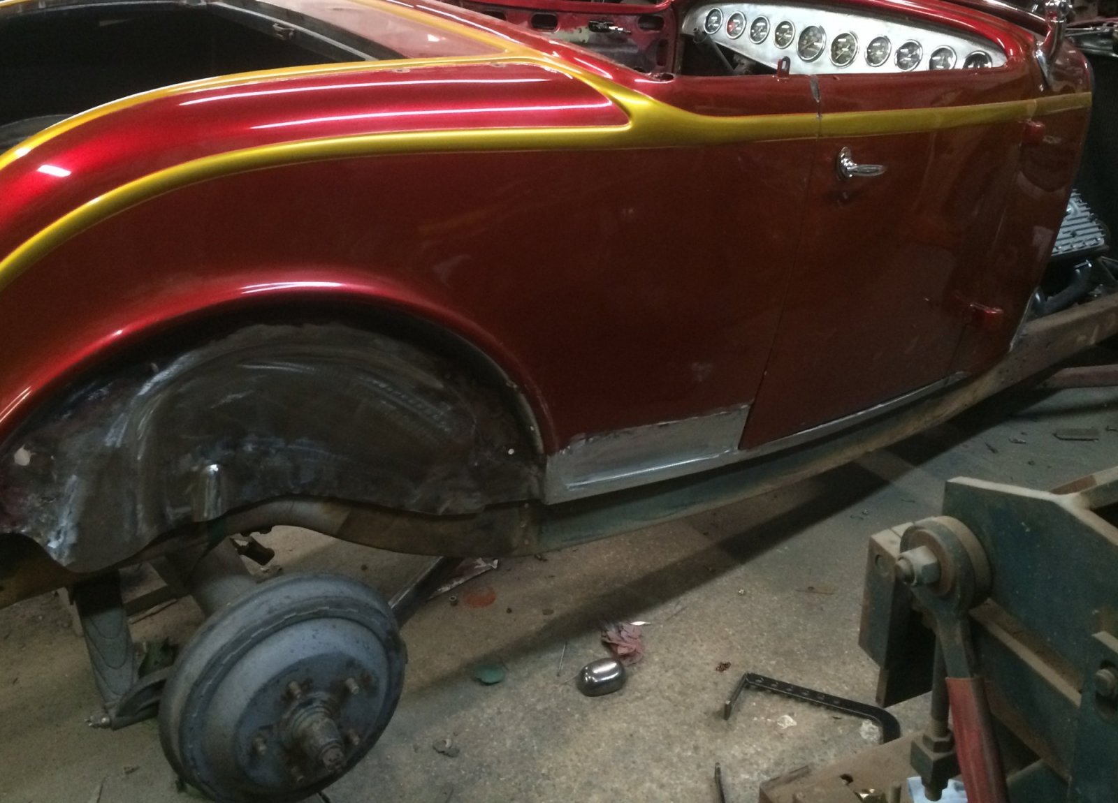

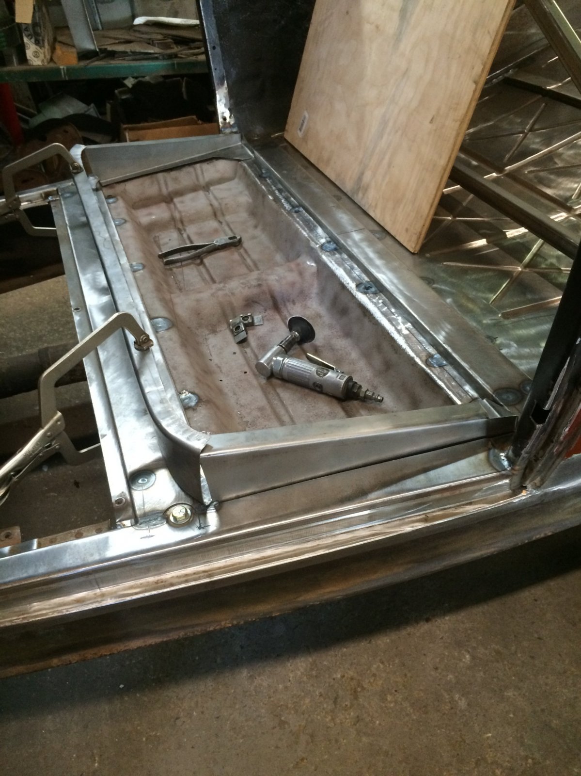

    With those pieces painted, and time already running very short, I needed to get the patch panels and floor in the car ASAP. I pulled the fenders off and got everything ready.
    Then it was all assholes and elbows.
    In two very long days, I had put all the necessary patches in the car, as well as the new subrails, and new rear floor.
    Standing back and looking at it, I felt pretty good about how the car was coming along.

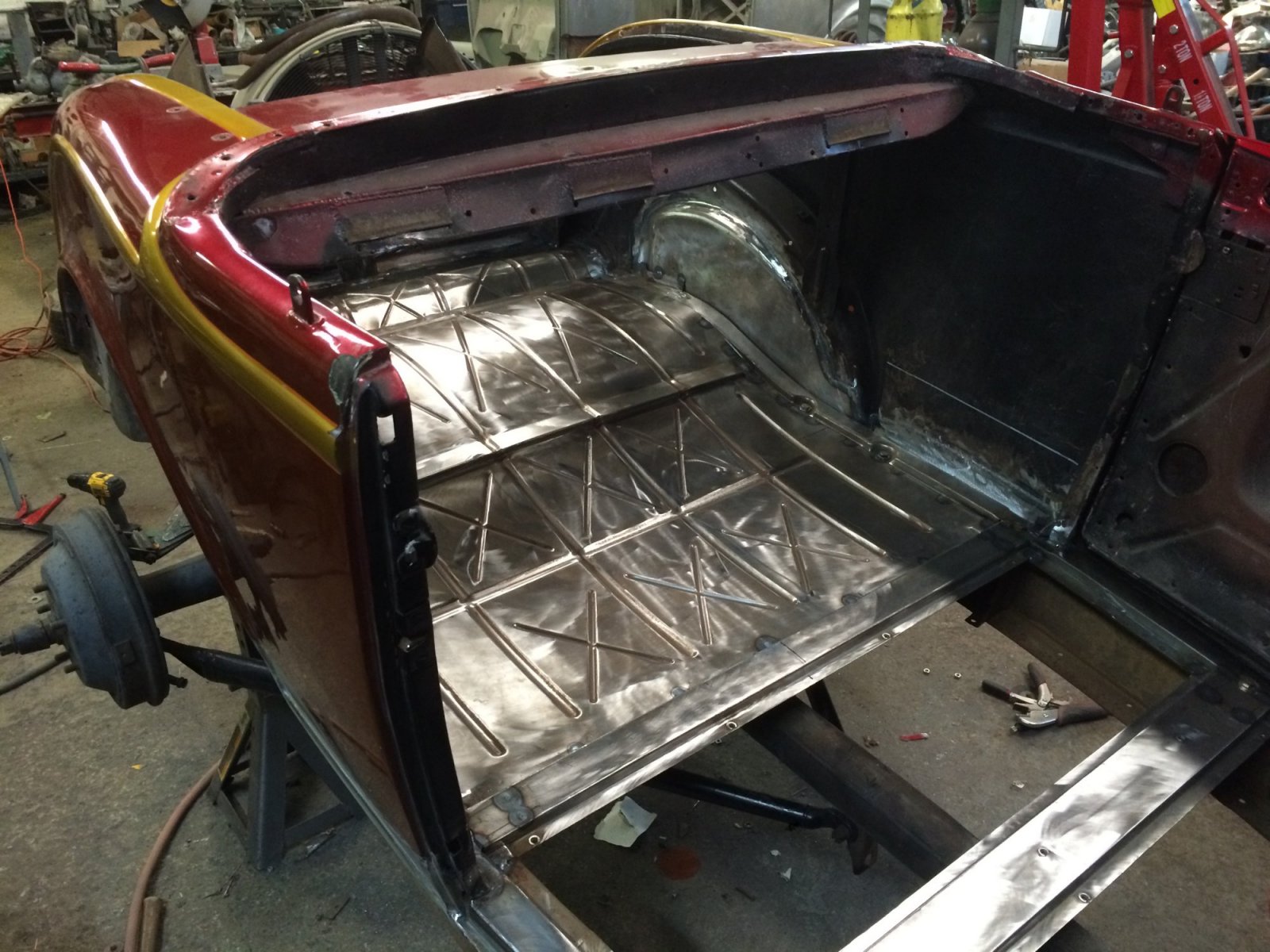

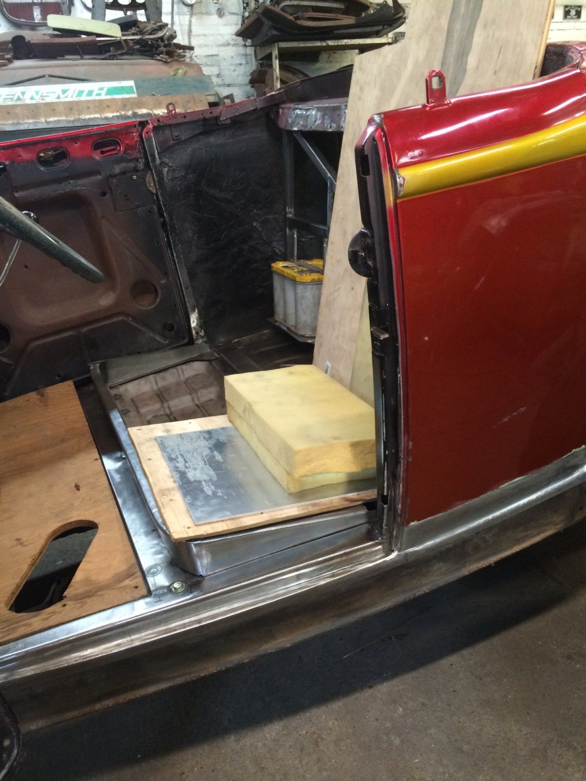

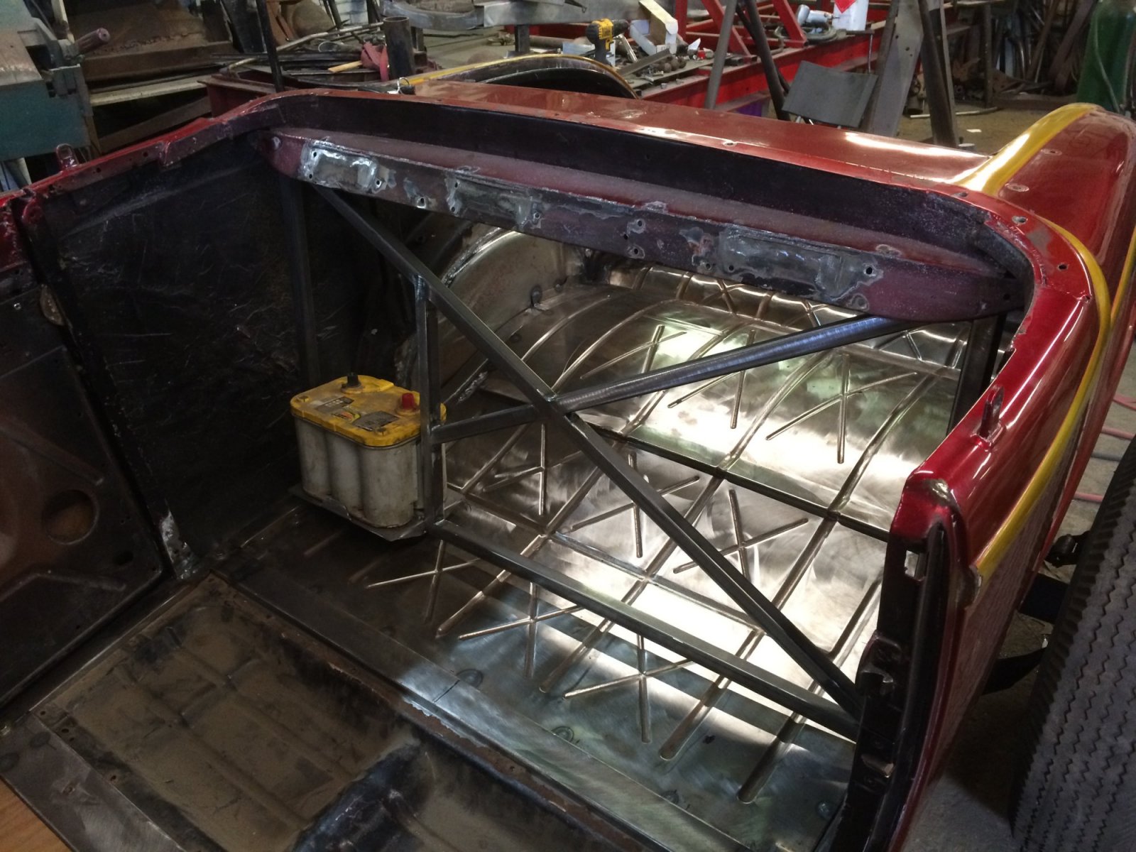

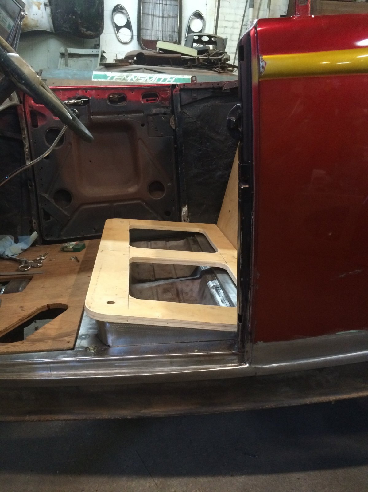

    Before I could go any further, I had to brace up the body and build a seat. I first made the body bracing out of 1" tubing and built in an integral battery mount.
    Then I made a seat pan.
    Test fitting it to make sure I like where it's heading.
    I then cut the seat bases out of Luan plywood. (It actually was an Ikea craft table that we didn't use at my house anymore, but the top was a nice piece of Luan plywood.)
    To get the "roadster roll" on top of the seat back, I removed the tack strip, and used the existing holes to mount a strip of 5/16" Luan plywood. This was nailed to the seat back, and bolted to T-nuts through the body. I also made sheetmetal corners to reinforce that area.
    Then I 'glassed it all together.

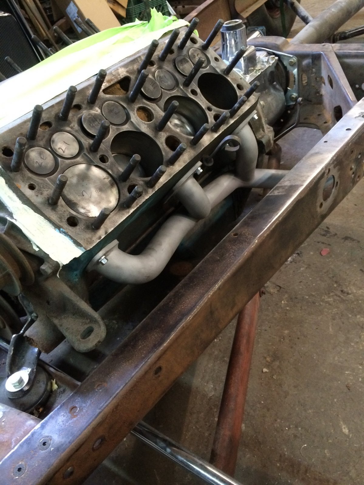

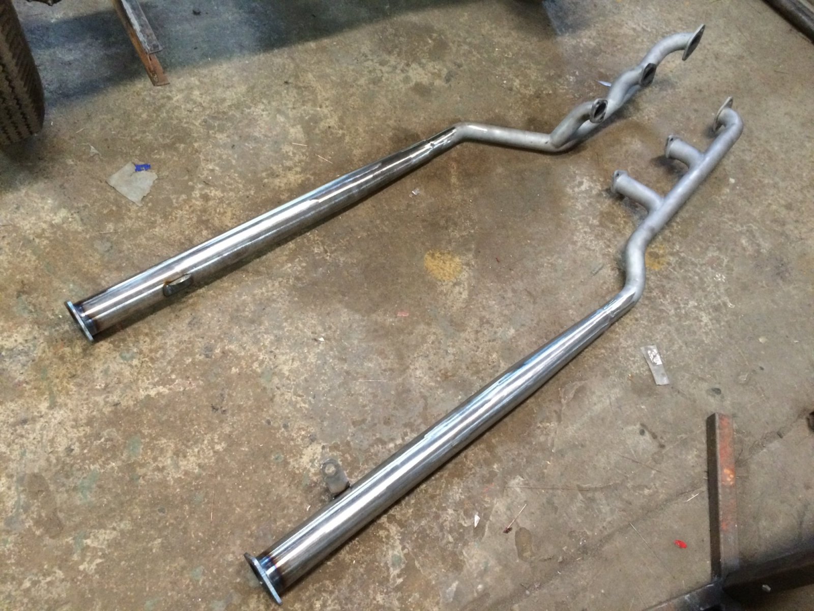

    I then pulled the body and started getting the exhaust built. I started with a set of cheapo Speedway headers, but they were going to run smack dab into the steering box on the driver's side. I ended up cutting them apart and rebuilding everything from the front primary back.
    The passenger side was a little more straightforward. All I had to do was get it to clear the K-member. I cut up two '35-36 Ford driveshafts to make the lakes style headers, and made a pair of 4-bolt square flanges for the ends. Eventually these will be capped up, and then exhaust will run all the way out the back. I was so short on time, that I decided to save that part for later.
    Exhaust finished (for now), engine out and painted, and I need to get some paint on the frame. Since I was starting with a pretty nice original frame, I decided I was just going to prep, seal, and paint. Sure there were a few pits and imperfections, but again...I wasn't trying to build a show car. I sanded the frame with a D/A, cleaned it really well, epoxy primed it, sealed it, and then painted it.

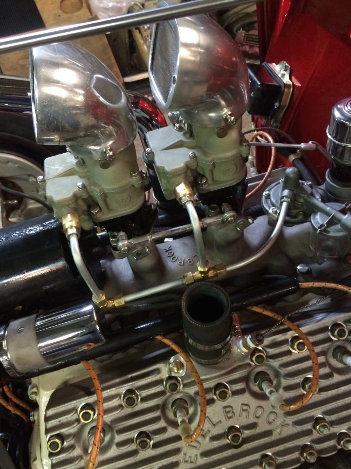

    I waited until I had the engine and trans mounted in the chassis before I changed the cam and lifters in the flathead. I used an old Engle cam that I bought at the LA Roadsters swap meet. The old timer that sold me the cam said it was the "same as a 400jr". New Johnson adjustable lifters went in along with the cam and an aluminum timing gear. The rest of the valve train is stock '46 Ford.
    Over the next few days I ran the brake lines and fuel line, and got the chassis ready for the body. The Tuesday before the show, I was pretty much drained and exhausted...but I kept pushing.

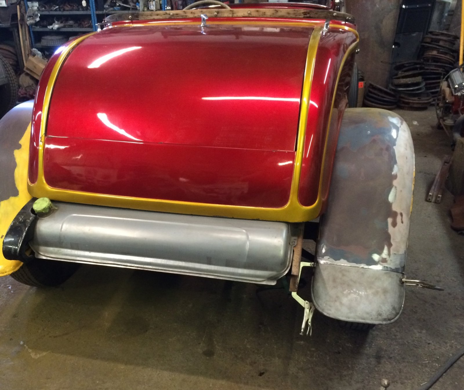

    We also painted the front fenders, and started painting the rear fenders when we ran out of candy. So I just accepted the fact that the car would be a highboy for now.

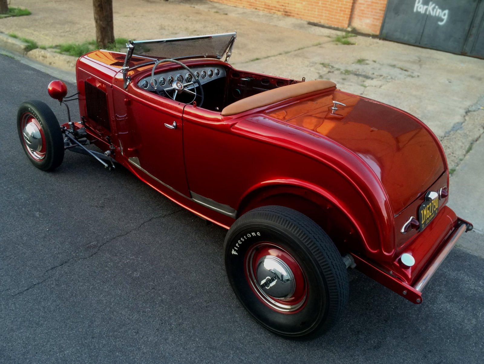

    Friday morning at sunrise, I bolted the seat in.
    And here's how the car looked for the trip to Austin.
    I didn't get nearly as far as I wanted to on the car, but considering how little time I actually spent, I felt pretty good about it. And I knew once the show was over and the car was back home, I could just tinker with it here and there to get it driveable while working on other projects.
    The show went pretty well. I was surprised by the positive response that the car received, and it made me feel better about running the car without fenders for a while.

    Then I made new fuel lines.
    Since I knew that I wasn't going to have time to get the fenders on it before the car was driving, I decided to throw together a headlight bar using the original fender brace holes on the side of the frame. I made the lower part of the bar first.
    Then I used a Model A headlight bar to construct the rest.
    I mounted the headlights higher than I normally would, because I wanted to make the car as early '50s period correct as possible. The headlight laws were being strictly enforced then, and I used cars like the Walker Morrison and Nitti roadsters to determine where I should mount the headlights.

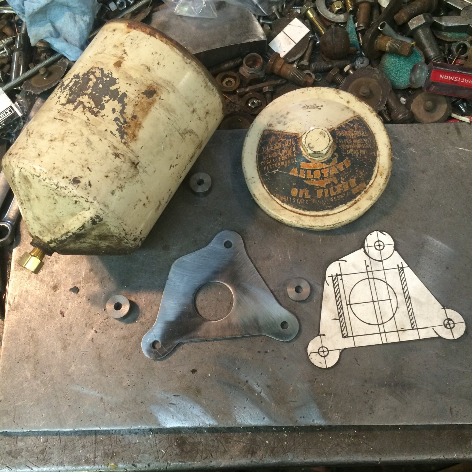

    Next I needed an oil filter. I had this NOS Allstate oil filter that I'd been saving, and this seemed like a good time to use it. I made a bracket to bolt it to some of the original holes in the firewall.

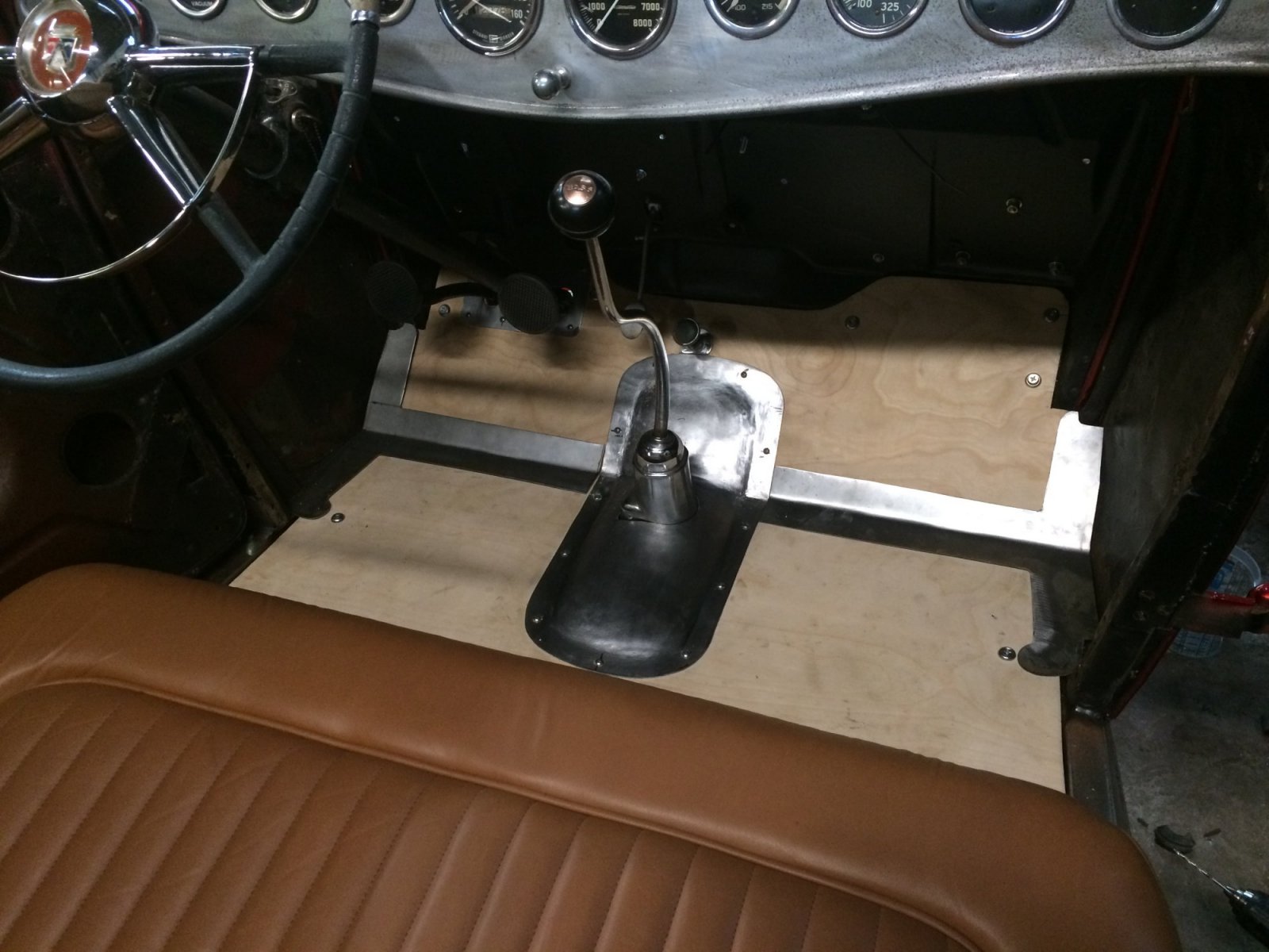

    I made new floorboards out of birch, and hammered out a trans tunnel.

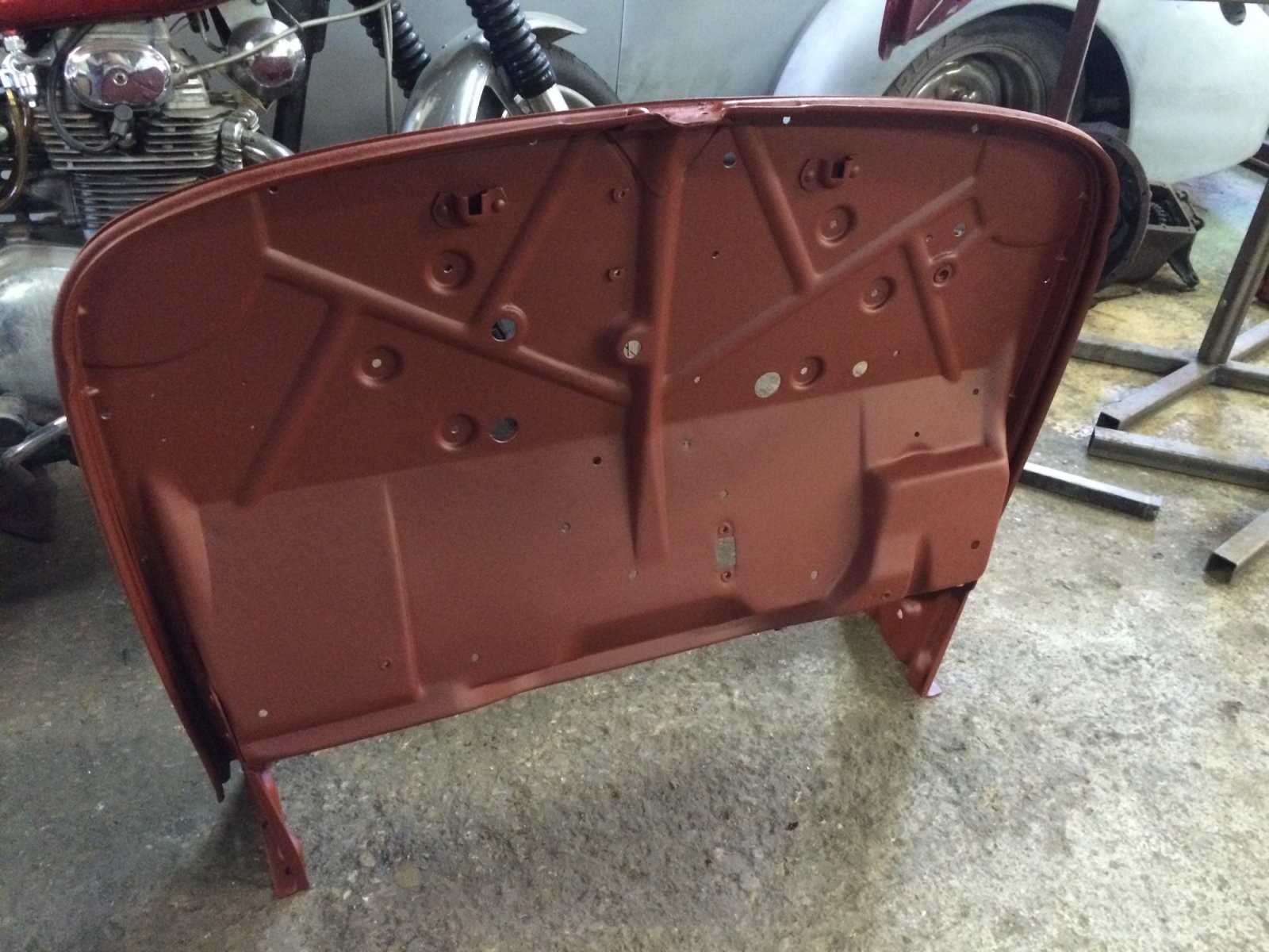

    Before I painted the gas tank, I had to work on the holes to get it to fit the original frame. I also welded up the extra holes in the Vintique tank with silicon bronze to make it look more like an original.
    I'd planned on running a full hood, combining the 4" louvered hood tops that came with the car with a set of original 20-louver sides. Here are the hood tops in primer and mocked up.
    Next, I painted the gas tank and hood.

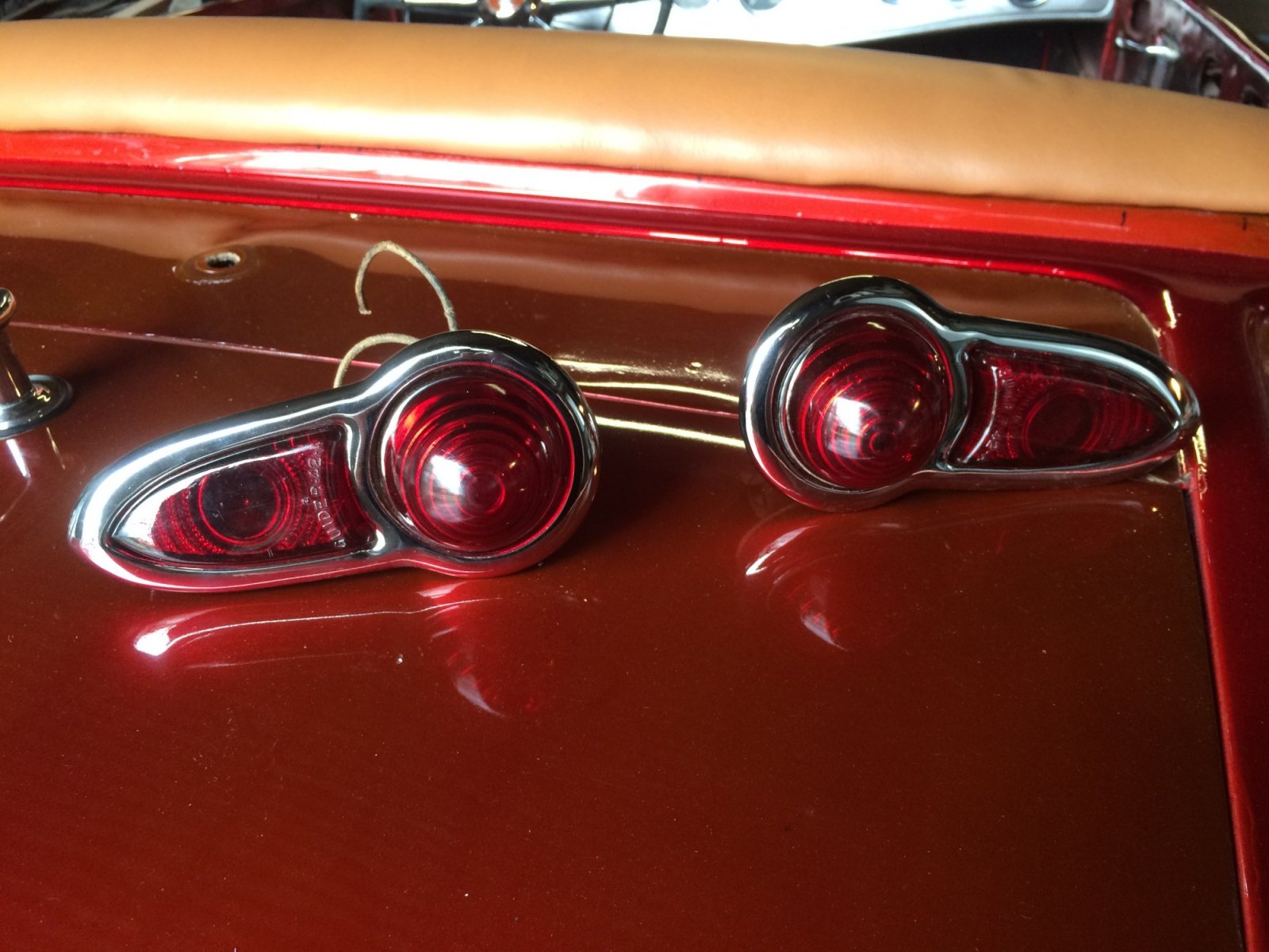

    The taillights I wanted to use are a bit unusual, and I've been hanging onto these for a while. They are '42 Buick "black-out" taillights, meaning that they only came on the no chrome, black-out Buick in 1942. There is a '46-48 Buick taillight in the foreground for comparison.
    I had the bezels chromed.

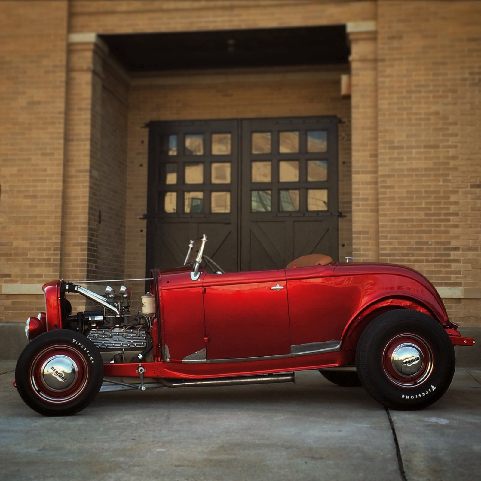

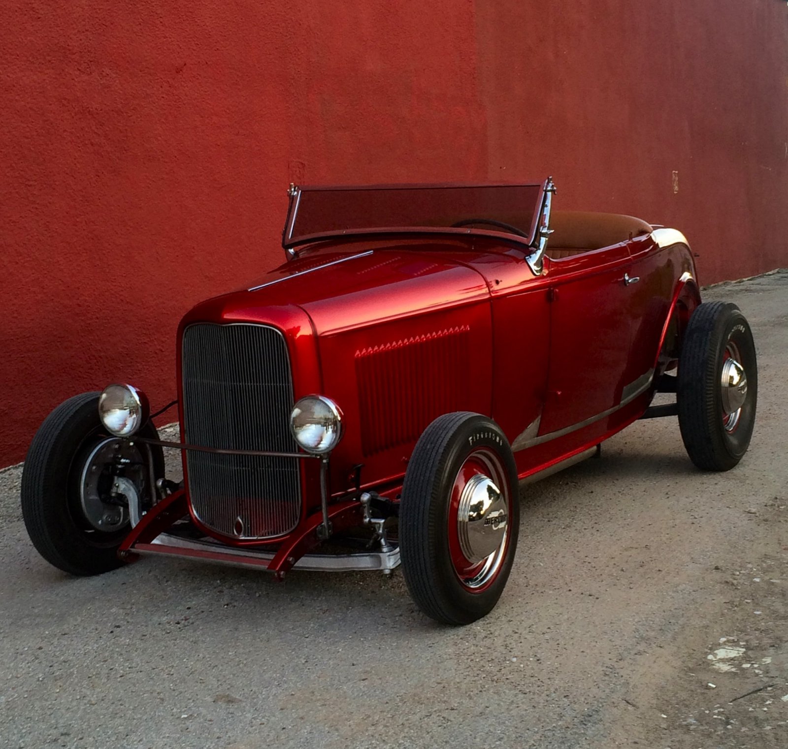

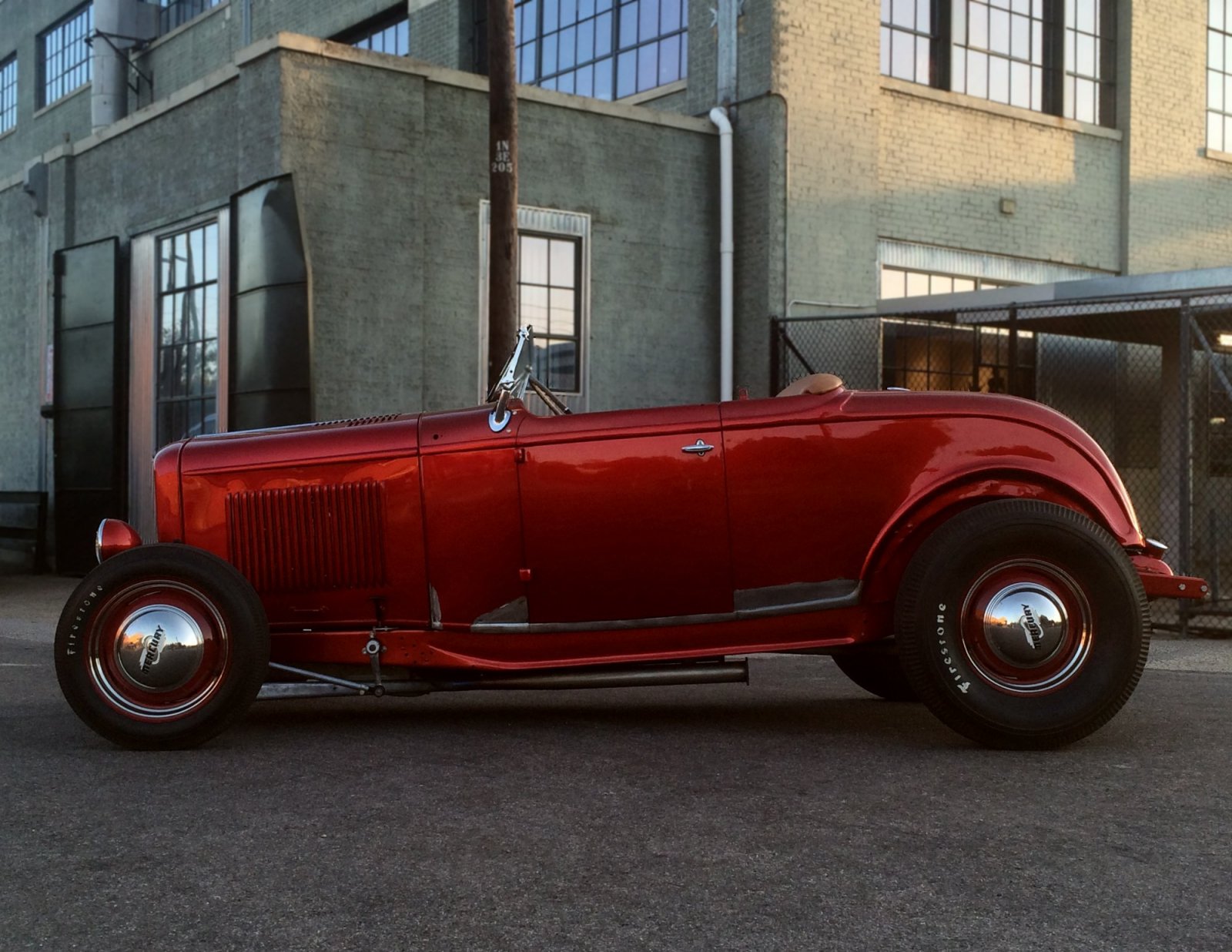

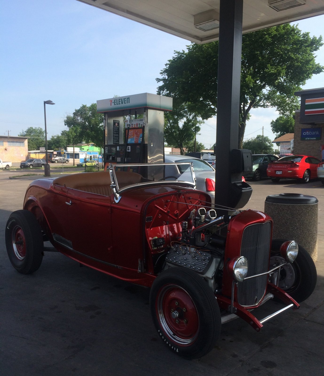

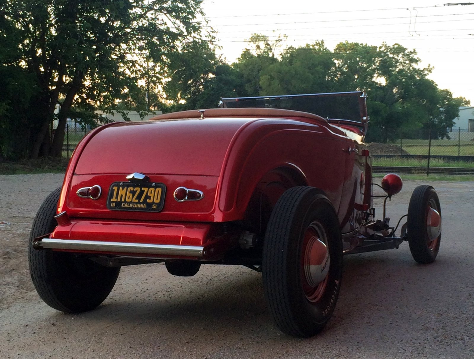

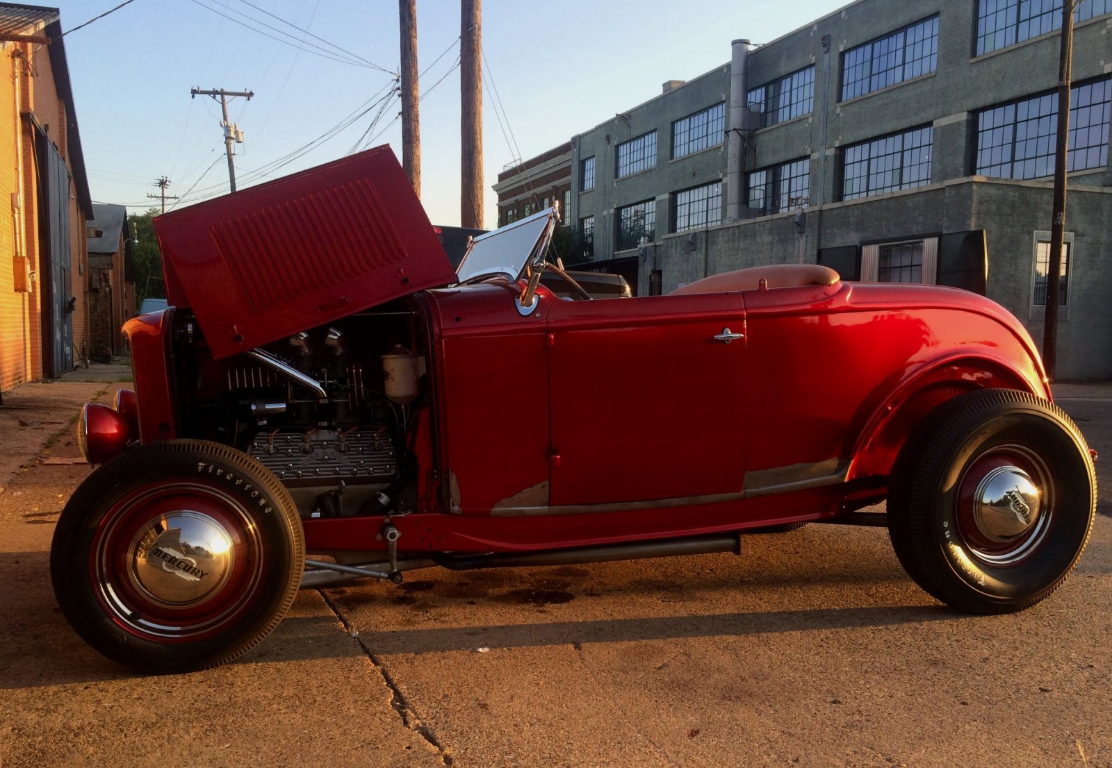

    At about 6pm on June 2nd, I celebrated my 38th birthday by driving the car to 7-11 to put some gas in it.
    I went back by the shop to check for leaks, and stuck the hubcaps on it. Then I drove it down the street and stopped to take these photos in front of an old firehouse.

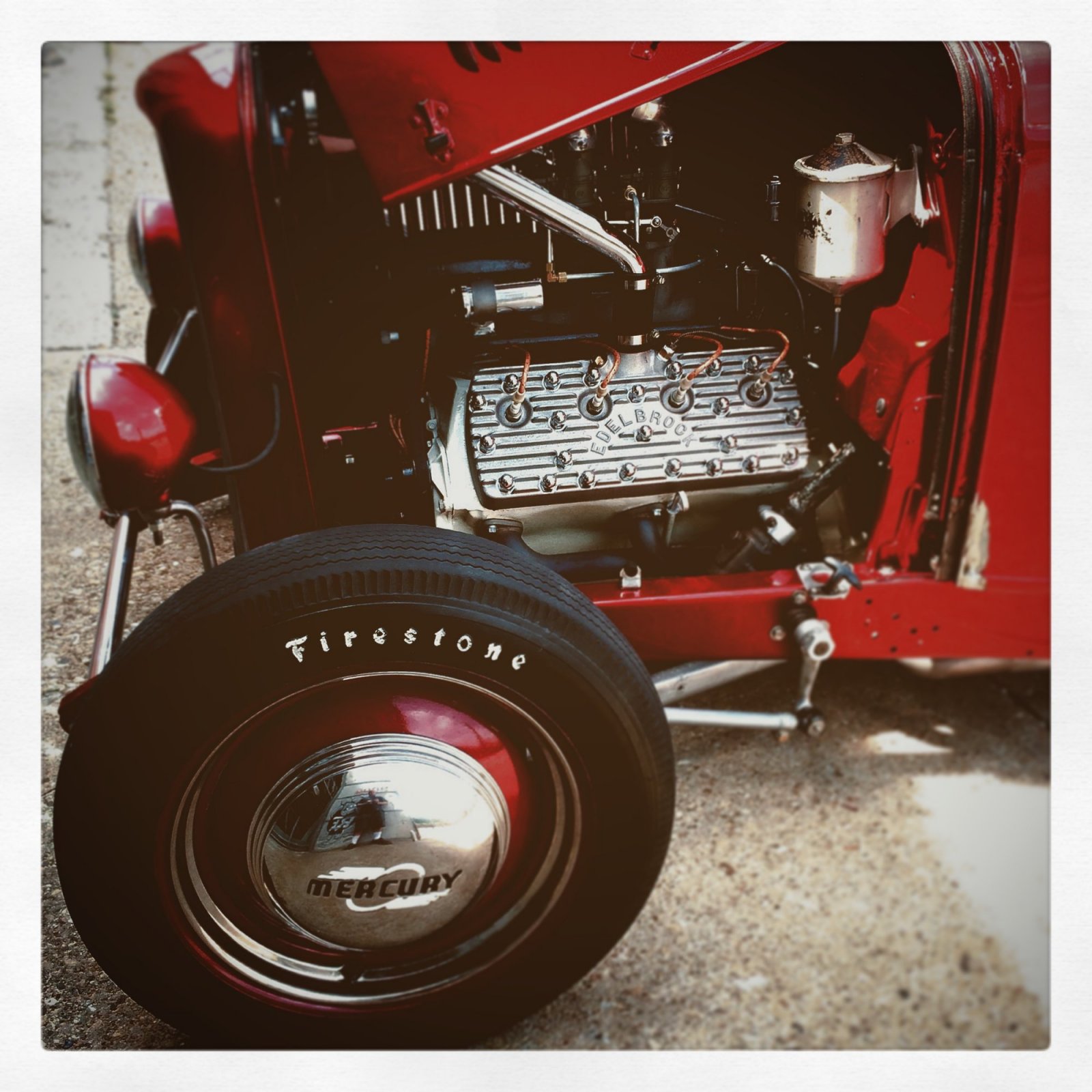

    The flathead runs really good. It revs up quickly with the Albro aluminum flywheel. The cam sounds fantastic. It doesn't smoke, and doesn't get hot. I just got lucky, I guess.
    I used 3.54:1 Lincoln gears in the rear, and the car really does well on the highway. The '37 Hudson steering box works good, and the leather seat is really comfortable. The Roto-flo shocks are starting to break-in, and the car seems to be riding better as everything takes a set.
    I made a pair of simple aluminum brackets to hold the rear hood latches, and got the hood on it a day or so later.

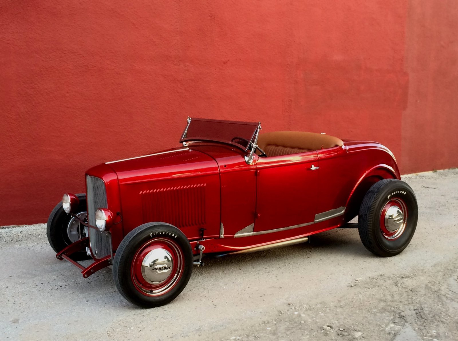

    Plans for the near future are to touch up the bare spots on the body, chrome a bunch of stuff, convert the rumble seat to a trunk lid, swap out the windshield for clear glass, and put in a full interior, among other things. I entered the car in the Hot Rod Hillclimb in Colorado, and the Race of Gentleman in New Jersey...both of which were big motivating factors in the decision to get this car on the road this year.
    Like the title of this thread says, I consider this to be "Version 1.0" of my roadster. As time goes on, I plan to make it better and better until it really is a "nice" car. The foundation has been laid, so it's primarily the cosmetics that I need to concentrate on. I'm really enjoying driving the car as-is for now, and I'm definitely looking forward to taking it up the hill and on the beach later this year. I still plan on mounting up the fenders later, but I want to do those two big events first. I'll try to update this thread as I upgrade the car. In the meantime, thanks for looking and feel free to ask questions if there's anything I missed.
