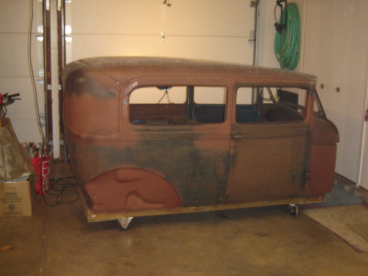

  1. 1. I made a plywood template; one edge matches the stock roof’s lengthwise crown, the other follows the lateral crown….

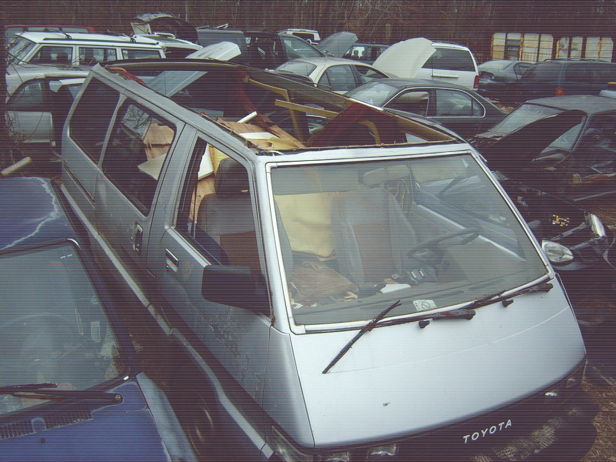

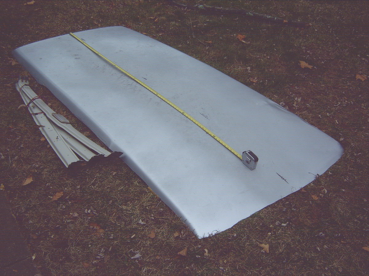

    2. …and took it to a local junkyard to shop for a matching donor roof ~74” x 43” with no lengthwise ribs. I was looking for a Volvo station wagon but found an ‘86 Toyota minivan matched perfectly.

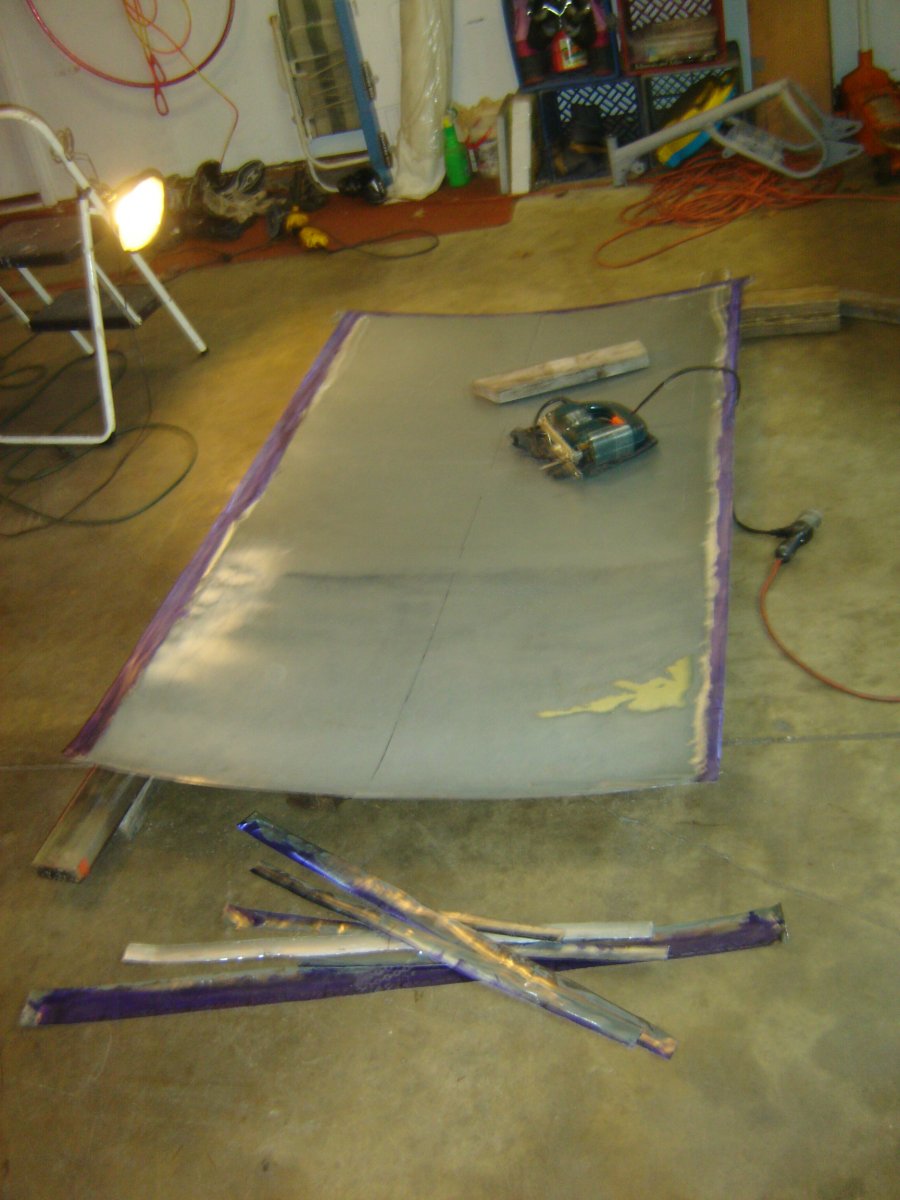

    3. A battery-powered sawzall got me a new roof and three interior reinforcing crossmembers, one of which contained a dome light and wiring. Thanks to my buddies who loaned me the sawzall and helped with the roof-lobotomy.

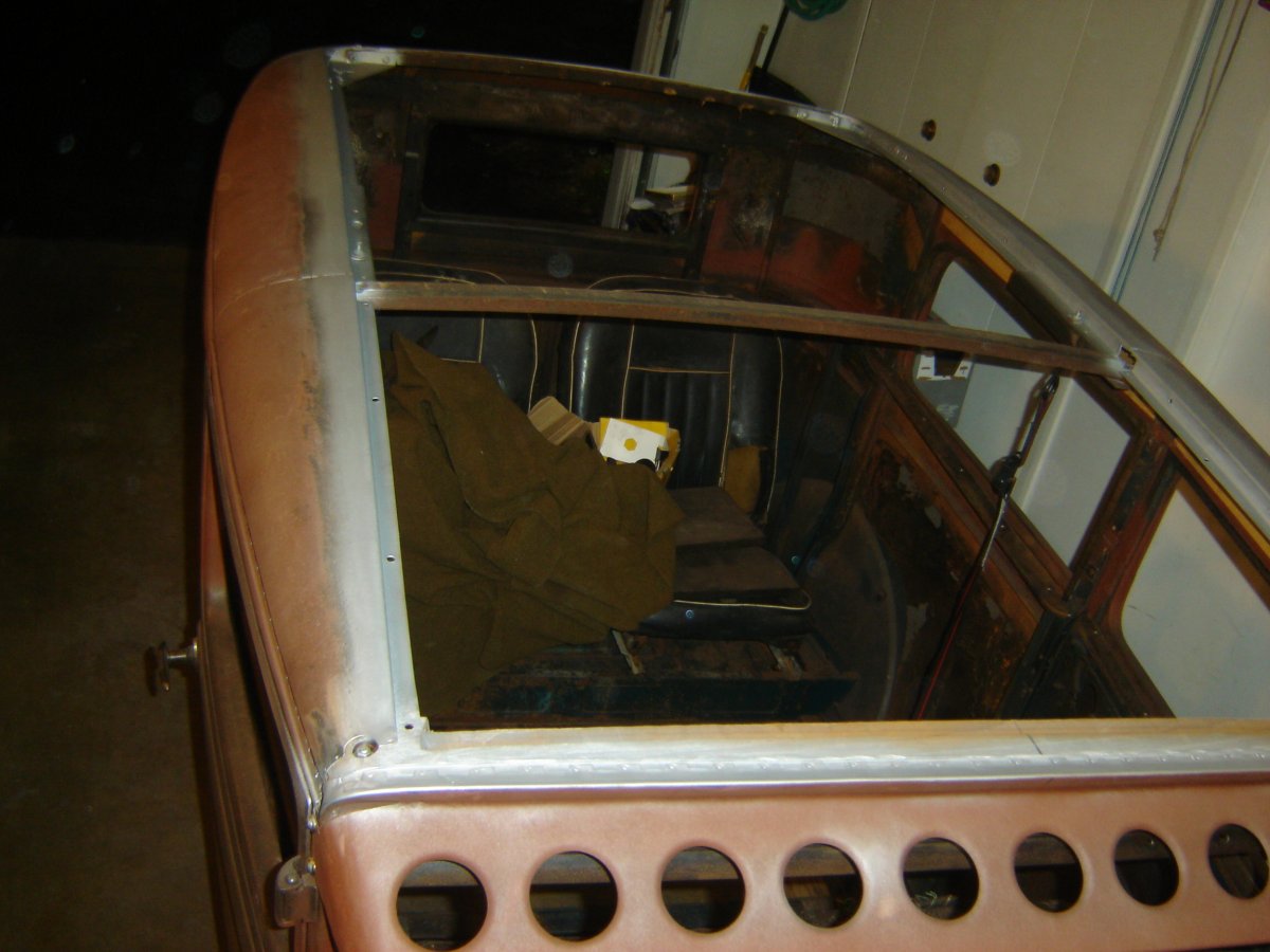

    4. There are two ways to weld the insert: You can either lap-weld the insert over the stock hole, leaving the stock lip where the wood slats used to rest. Or you can remove the lip and butt-weld the insert.
    Since I was using a MIG welder, I chose the former, because (a) there’s no gap between the patch and roof for the welder to blow through, (b) vinyl will cover the seam anyway, and (c) the lip’s rigidity helps minimize warpage, which was a huge concern.

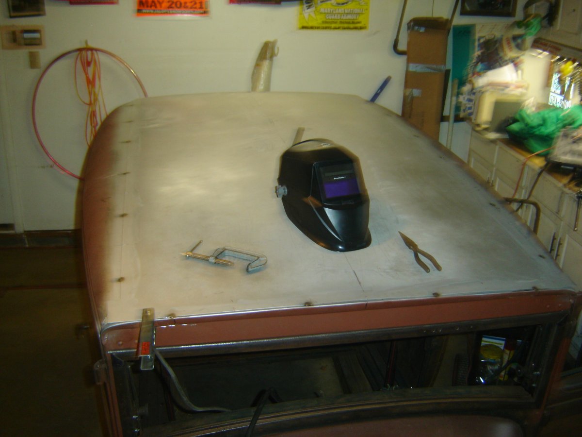

    5. I applied Dykem, then measured and marked scribe lines and cut it with a jigsaw and new blades. The patch overlaps the stock sheetmetal hole by 0.25” on all sides.

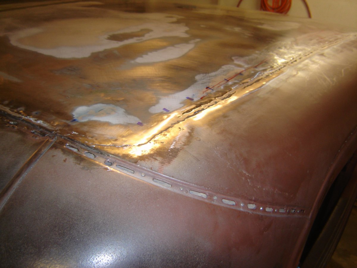

    7. Tack, check, pound, grind, repeat… All welding was done with my small but trusty Lincoln 140C with Argon/Co2 mix and ESAB “easy-grind” 0.025” wire.
    8. The long weld seams shrank a lot. I minimized it with short tacks and moved around to prevent heat buildup, but the shrinkage around the patch’s perimeter raising a noticeable “bubble” above and between the rear windows.
    9. I alternated between ~20 minutes of tack welding, followed by ~three hours of hammering on-dolly around the perimeter to stretch it and drawing down the bubble with a shrinking disc, then checking my progress with the plywood template and repeating the tack weld/hammering/shrinking process.

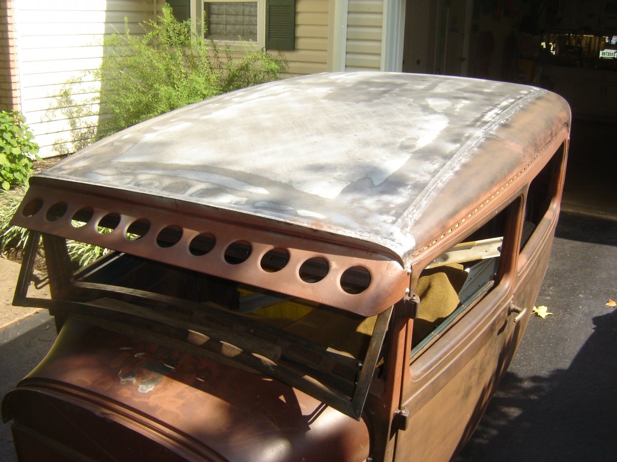

  2. 10. I rolled the car outside for a better view of its silhouette. Once the bubble was eliminated and the weld seam was complete, I ground it down almost flush and sanded it with a 4.5” sanding disc.

    12. I sprayed a light rattlecan primer guide coat and sanded the roof with 80 grit on a longboard. This exposed the remaining highs and lows that my clumsy hands couldn’t detect.

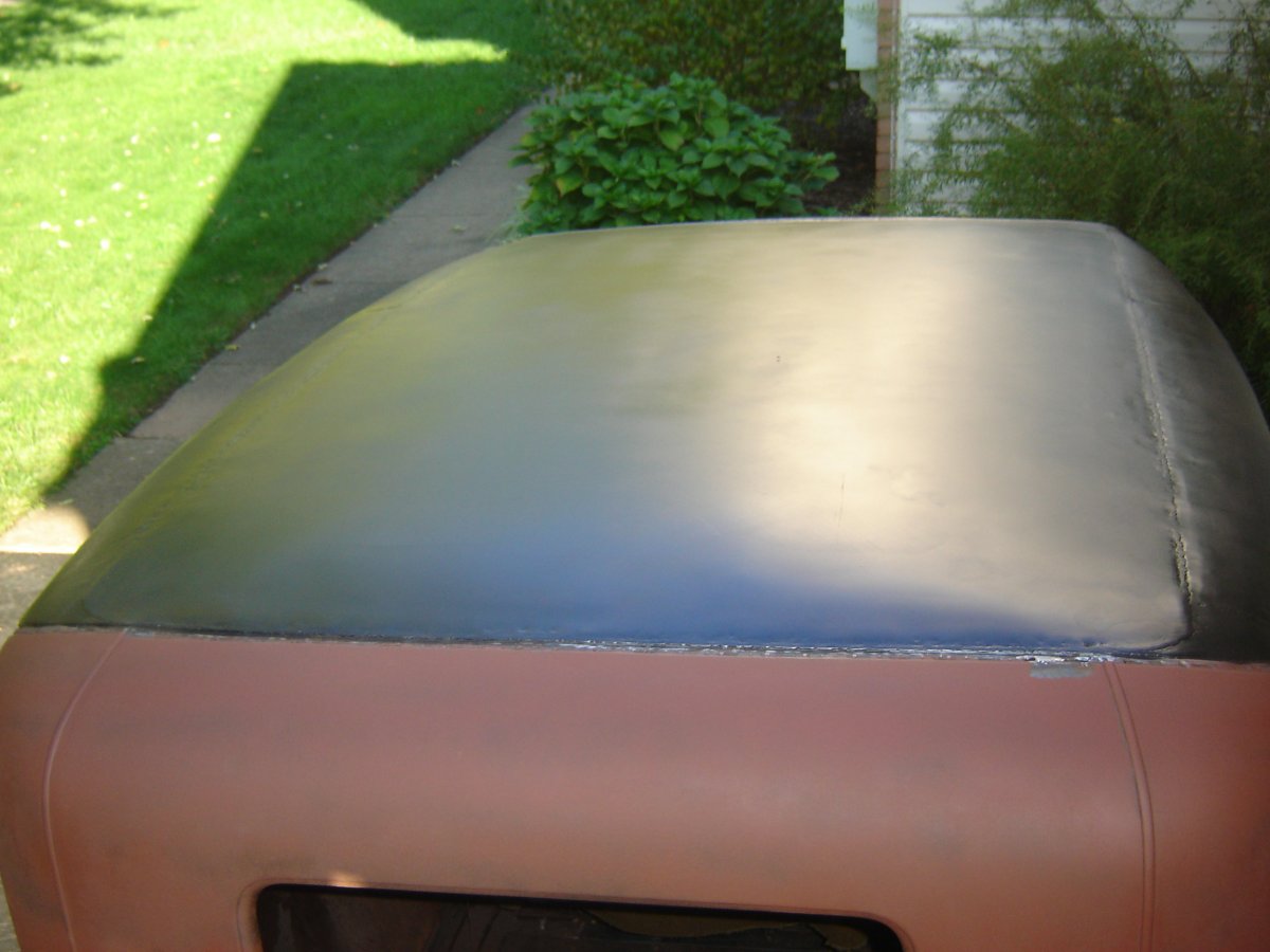

    13. More hammer & dolly and shrinking disc work, followed by a temporary coat of black rattlecan primer to protect the bare metal from our northern Virginia humidity.
