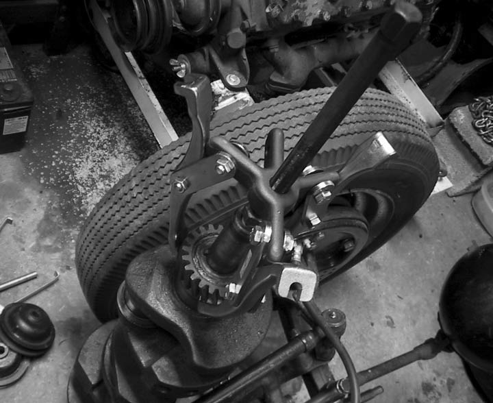

    And here's a picture of a big gear puller doing what it does. It's amazing what the right tool will do. I'm cheap but have no problem spending money on something like this. It's just vicious looking... savage. I bought this from the coolest hardware store in Kansas City. It (the store) is a recent find for me. I forget the name but it is right in the middle of downtown and has been in business since 1933. GREAT place.
    FYI - A flathead crank fits pretty well right between the front wheel and split wishbone of your hot rod. Reach over and give the steering wheel a crank to keep everything in place while wrenching on the gear puller.
    Look at the floor next to the water pump pulleys and you can see the ends of the five dollar puller in a tweaked and bent heap.

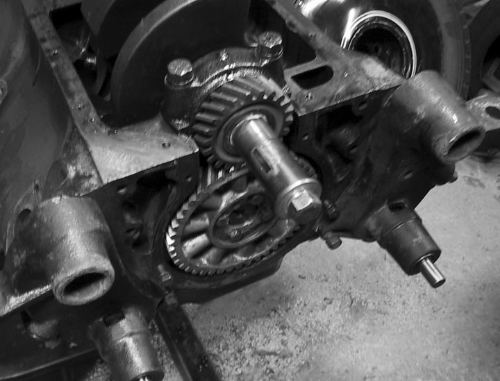

    And here are the gears and cam installed. Things got a bit heated and I forgot to pick up the camera for a few steps but it went like this.
    1) Give the crank snout a light coat of grease in preparation of installing the crank gear. I wanted to get the crank gear on first as I thought it would be much easier to spin the cam to line up with the crank than the opposite.
    2) Realize you have nothing to drive the gear home. Search frantically and find a scrap of your old exhaust (made from EMT) and cut a 10" length off.
    3) Slide it over the snout and keep hammering until the gear is fully seated.
    4) Paint the piece of pipe red and hang it on your wall. It is now a flathead tool.
    I had to spin the motor over to get the cam in the last half inch or so. Make sure to line up the timing marks on the two gears. My crank gear had a dot (on a peak) and the cam gear had a slot (in a valley)

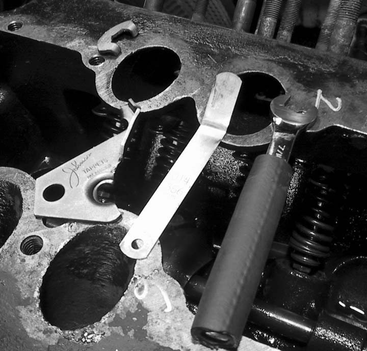

    Here are the tools from left to right.
    Johnson tappet wrench. There is a left and right. You are looking at one of them - not sure which - the other is somewhere in the valley already.
    Feeler gauge - .014.
    Modified wrench. This has had some time on the green wheel to thin it down and shorten the throat so the ends don't extend past the adjuster when in use. So now it's high speed/low drag. I also chopped it off at the recommended five inches which seems like the PERFECT length. And yup, that's fuel line slid over the handle. Comfy.
    Now look up above the intake port. That was a flat washer. I had initially forgotten to order a set of wrenches with my lifters so when it came time to adjust them I thought I'd just make my own. That piece you see got a test run clamped in a pair of vice grips and that's as far as it went. I ordered the correct wrenches that day.
    I had heard the stories about adjusting flathead tappets with these wrenches and was prepared to start off by smashing the backs of my hands and knuckles into the corner of my workbench to get them acclimated to the work. Turned out not to be the case for me - read on.

    I've seen the drilled lifter bores and the other little tweaks to the block to make adjustments easier. And after fitting my modified wrench in the tight space left above the lifter bore but under the valve assembly I can see how av8's method of knocking the edge down a bit could be very beneficial. BUT, that is not to say I was bleeding tonight. I had a pretty easy time of it overall.
    Now for those who have never seen it, here is a wrench in place. It's really pretty smart. The shape makes absolutely no sense until you see it in context. You have a bit that sort of snaps around a lifter and a bit which extends to the lifter next to it with a tab that reaches into a hole in the top of that lifter and holds it from turning.
    From there you just use the modified wrench and fiddle with the adjustment screw until you have proper clearance. I turned until I could just slide the feeler into the gap with alittle push - and always made sure that when I wiggled it all I could feel was the flex of the gauge and absolutely no "rocking" sensation.

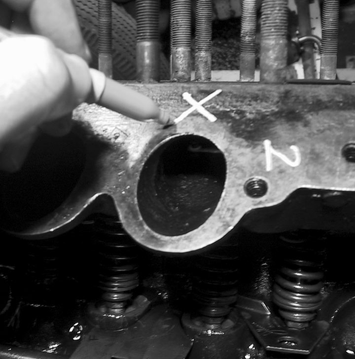

    Silver Sharpies rule. I marked each valve after finishing. Be sure to remove the wrench before turning the motor over to make your next adjustment. I only had to make that mistake once.

    That's it. Fifteen more times and you're finished. Keep in mind that the specs for my intake and exhaust were the same. Some cams require a larger exhaust gap. I that case I would do all of the intakes assemblies first and follow with the exhaust to keep cofusion to a minimum.
