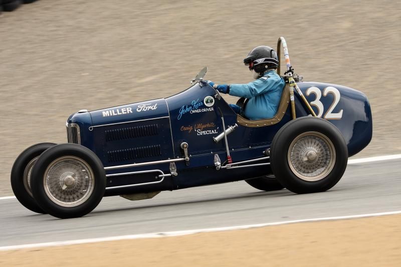

  10. Bob,
    Sorry, I haven't seen that car!
    I don't know the heritage of my car. It, like most, is a no-name, unsung vestage of a long past time. All I know is: It lurks in my garage, sucking up tons of dough! :rolleyes: But, we should have it ready for Buttonwillow Raceway on May 4th and 5th!

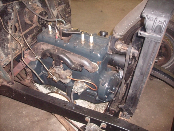

  17. Although not quite as fancy as a race car. I picked up this dual updraft setup, a Police head, and a B dizzy this month. I dropped the pan for the first time to check the bearing clearances and check for sludge. Everything checked out and was sludge free. The good news is I have adjustable lifters! I hoping to have the pan back on this weekend and the valves checked and adjusted as needed. I still need to pull the head off the motor it came on and my head also. There's also the crappy repo muffler that doesn't fit right that I need to deal with. Its like 1/2" short between the engine and the hanger bolt. I'm really hoping to have the car back on the road by the end of the month.
