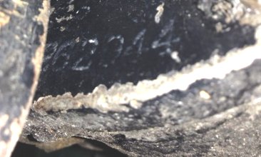

    I surely removed this from 1930 chevy at Desert Valley Auto Parts in Arizona 10years ago.
    Probably it's Saginaw steering box.
    Though I rubbed a worn gear together, it is not smooth.
    And, there is not no clue for rebuilt gearbox or rebuilt kits.
    It is smaller than Vega and 32 Ford steering box.
    And my Hot Rod cannot put on a big gear box any more.
    Although I have seen this by some 1930s to 1940s Auto repair manual of Motors by chance, it is difficult to find here.
    I don't have Auto repair manual of Motors...
    Help! Does any of you have the info?

    Look here for the "identification" numbers, you might or might not be able to find them.
    http://chevy.oldcarmanualproject.com/parts/1929_54/821.htm
    if you look for 262944 you find that it's a 1936 FB

    With those casting numbers it does look like a 1936 1/2-1 1/2 ton steering gear. Is the casting number on the other part of the housing 260367?
    The first 2 ebay links for the pitman shafts are correct for that box. The worm gear shafts are not correct. The original part number for the worm shaft should be 261489.

    24riverview is right , the steering box is # 260367 I just checked and thats the number on the one in my 36 1/2 ton.
