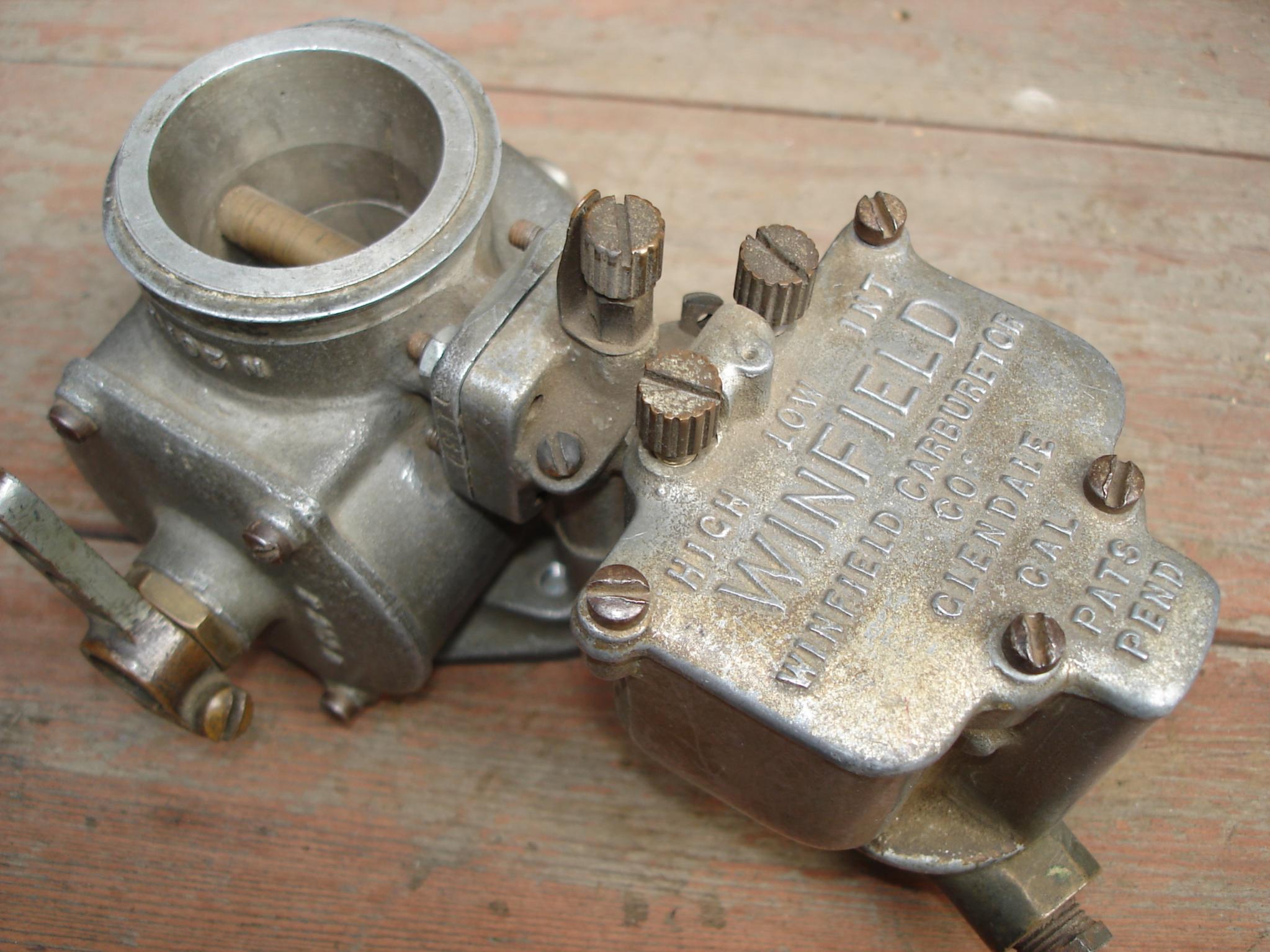

    anyone have pics of 2" Winfield carbs?
    I found castings with 1-7/8" hole, assuming 2"

    Are you looking for the S/SR carbs or the earlier ones with the rotary throttle butterfly?
  5. CDO,
    early rotary valve/ BBL design.

    John, Here are some pics of the Model N Winfield. Aluminum castings, they came in 1 3/4, 1 7/8, and 2 inch sizes. All used the same casting with different bore sizes. The early ones had the rectangular float bowl. This is the Winfield that can be used as a updraft, downdraft, or sidedraft.

  8. Yep, that sure looks like the pieces.
    Now to find one to use as a model.
    Thanks, J

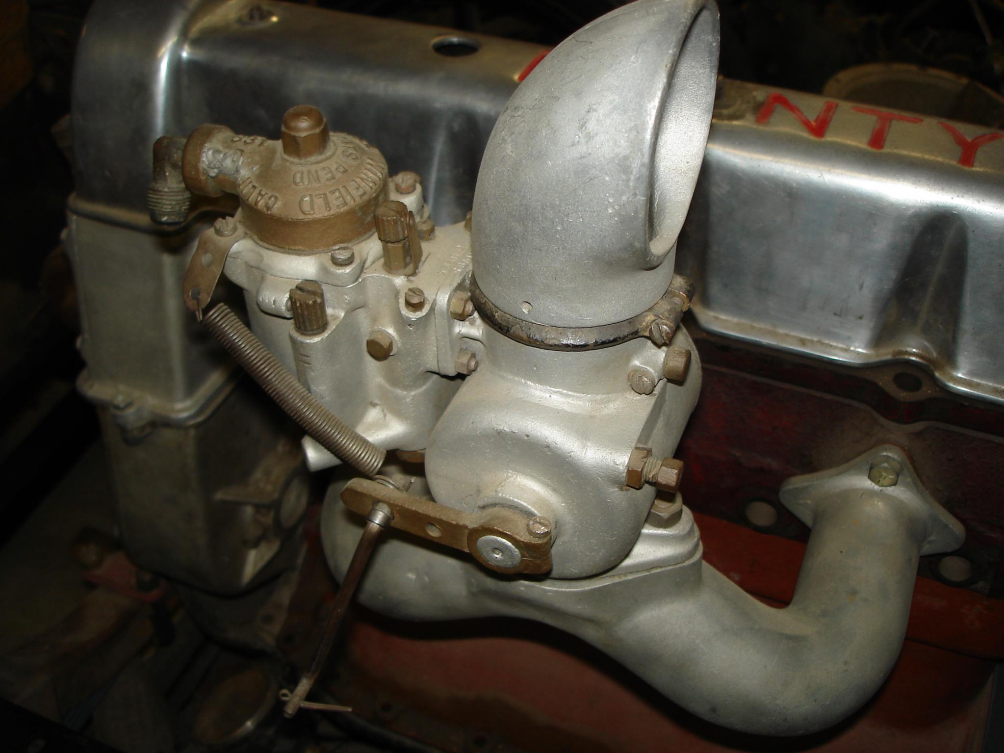

  23. Thought you guys might want to see this.

    Oh Man....that looks SWEET!!!!!!! :D

    interesting how many different choke setups for winfield SR carbs
  26. Thanks dude!
    Yeah, I always wondered why?
