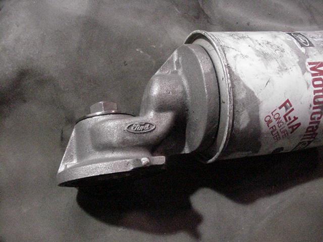

    Ford also had a 90* & 45* oil filter adapter - I believe the 90* is still avail from Ford Motorsports or SVO or Ford Racing or whatevery they're calling themselves these days...

    Good stuff guys. Any idea on the part no. for that 90 deg. adapter? That looks like it would work great!

    Ragtop, the Ford part is # F4UE6884BA and it can be moved in any position [​IMG]
