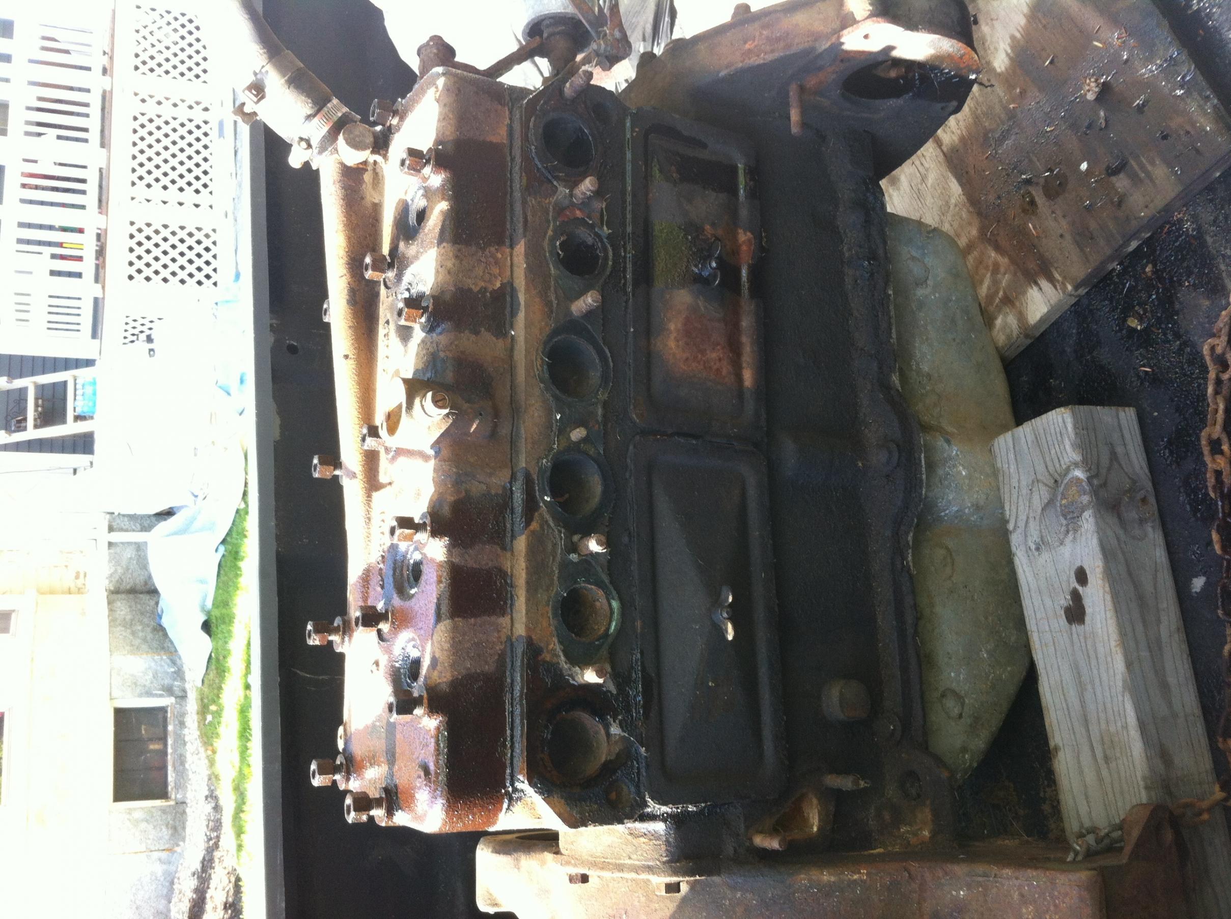

    Just brought home a 27/28 dodge fast four engine. Stock 44 hp , I'm hoping to get another 20hp with all the stuff I'm doing to it.

    Watcha going to put it in?
