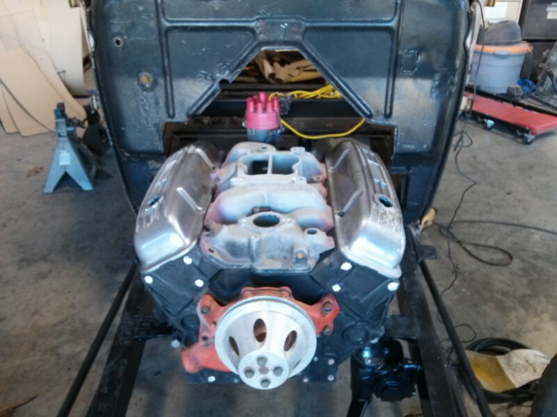

    Then i got to do some cutting and welding on my A. Got the firewall cut and notched out for the sbc. Still got some finishing to do the make it straight. A buddy that builds drag cars loaned me a foam mock up block to get things set . I tell you a 10 pound motor is a lot easier to handle!

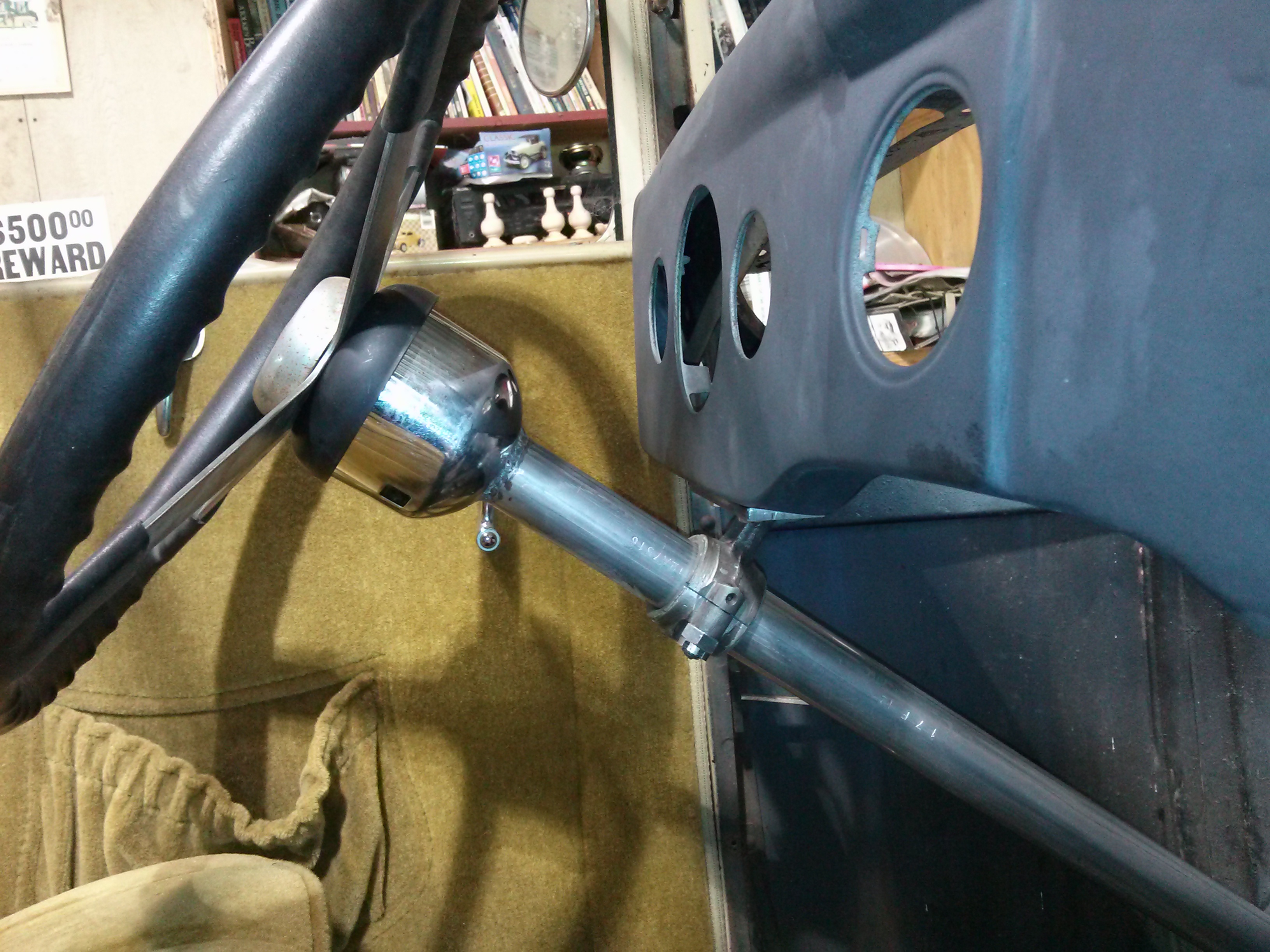

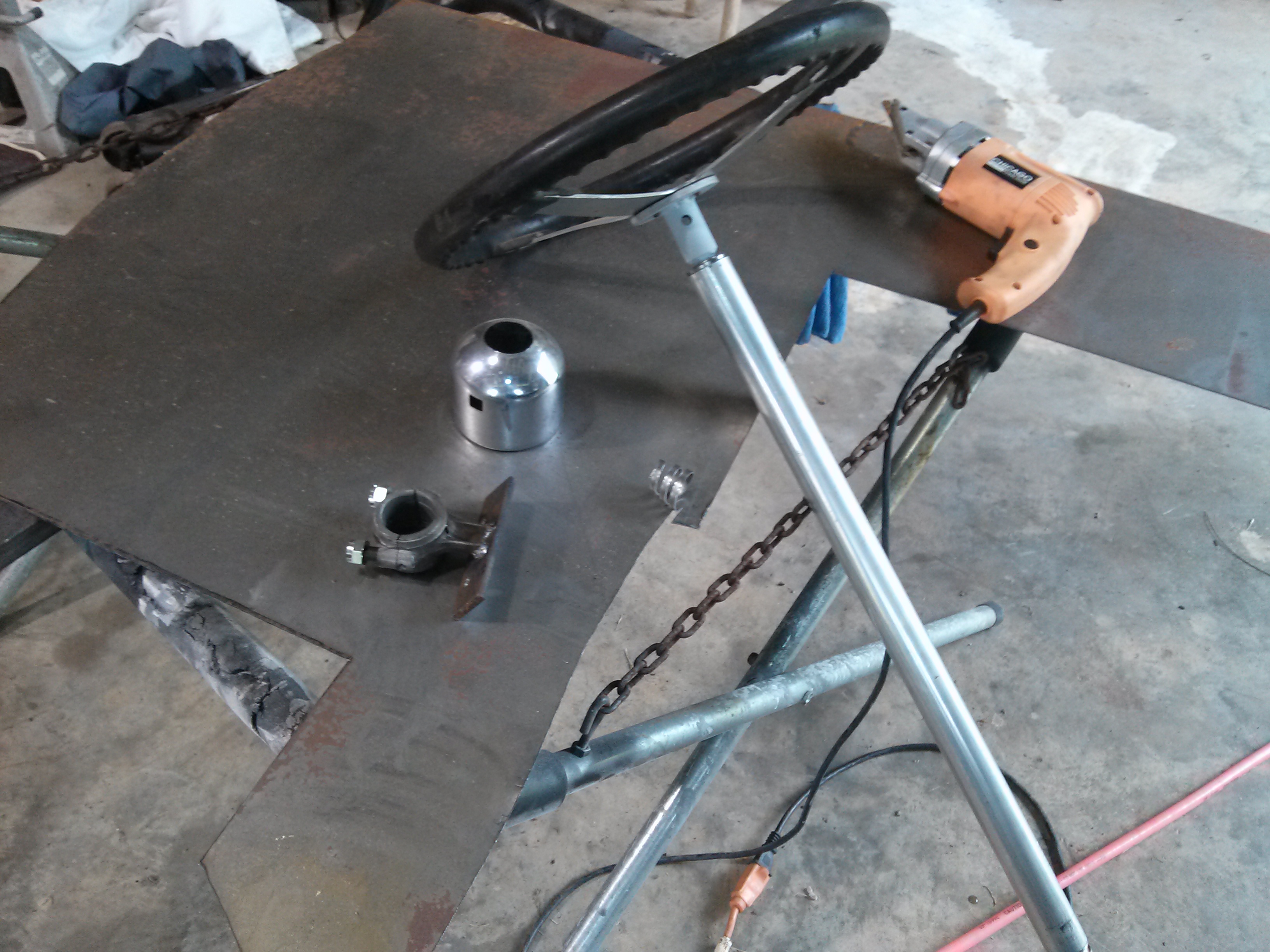

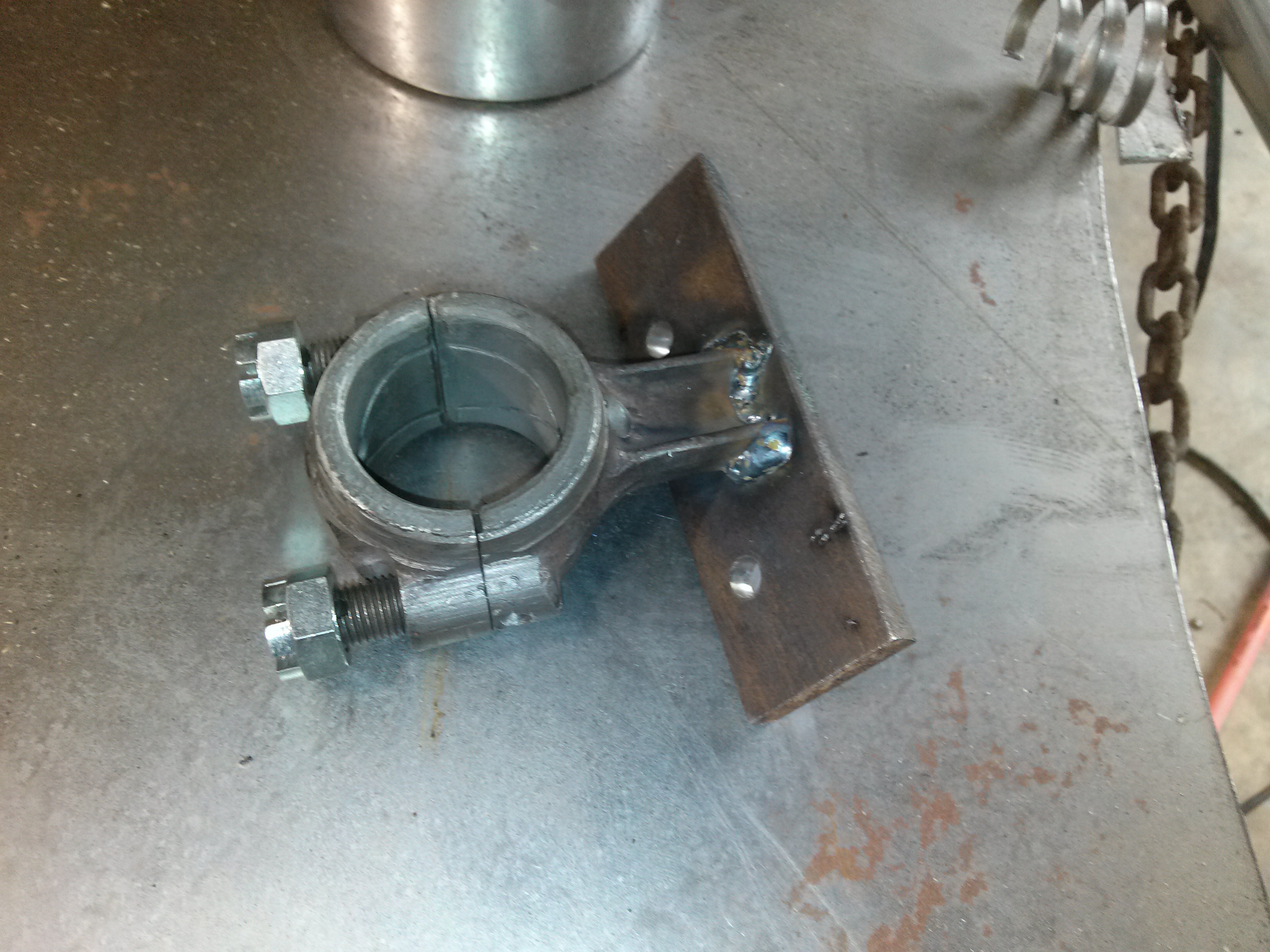

    Was able to make the column drop and get my steering column installed. I built this using a piece of exhaust tubing and some bearing . Had a 3/4 round stock and made an adapter for the wheel i got at a swap meet. The exhaust tubing has a 11/2 inch diameter and i found out that a Model A four banger rod is 11/2". So i made up this little drop. The bell under the wheel was an old tach housing i drilled out and weld on. 0622141020a[1].jpg

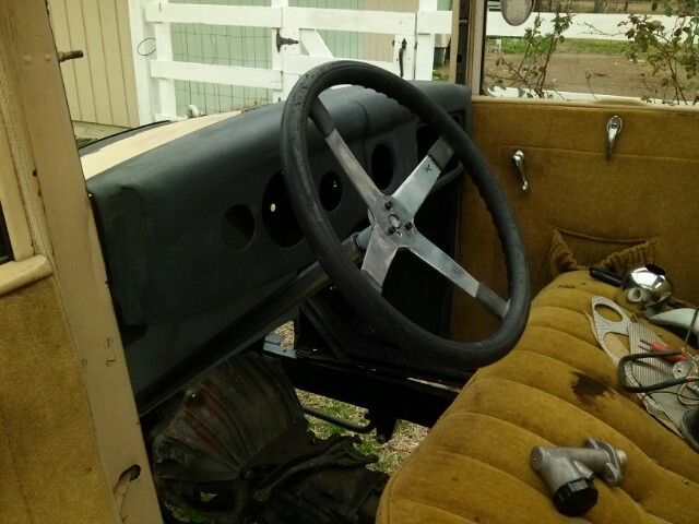

    mocked up the dash. Welded up the 3 original holes and replace with theses new Marshall gauges. Still have a few warning lights and switches to figure out , but im happy with the look.
